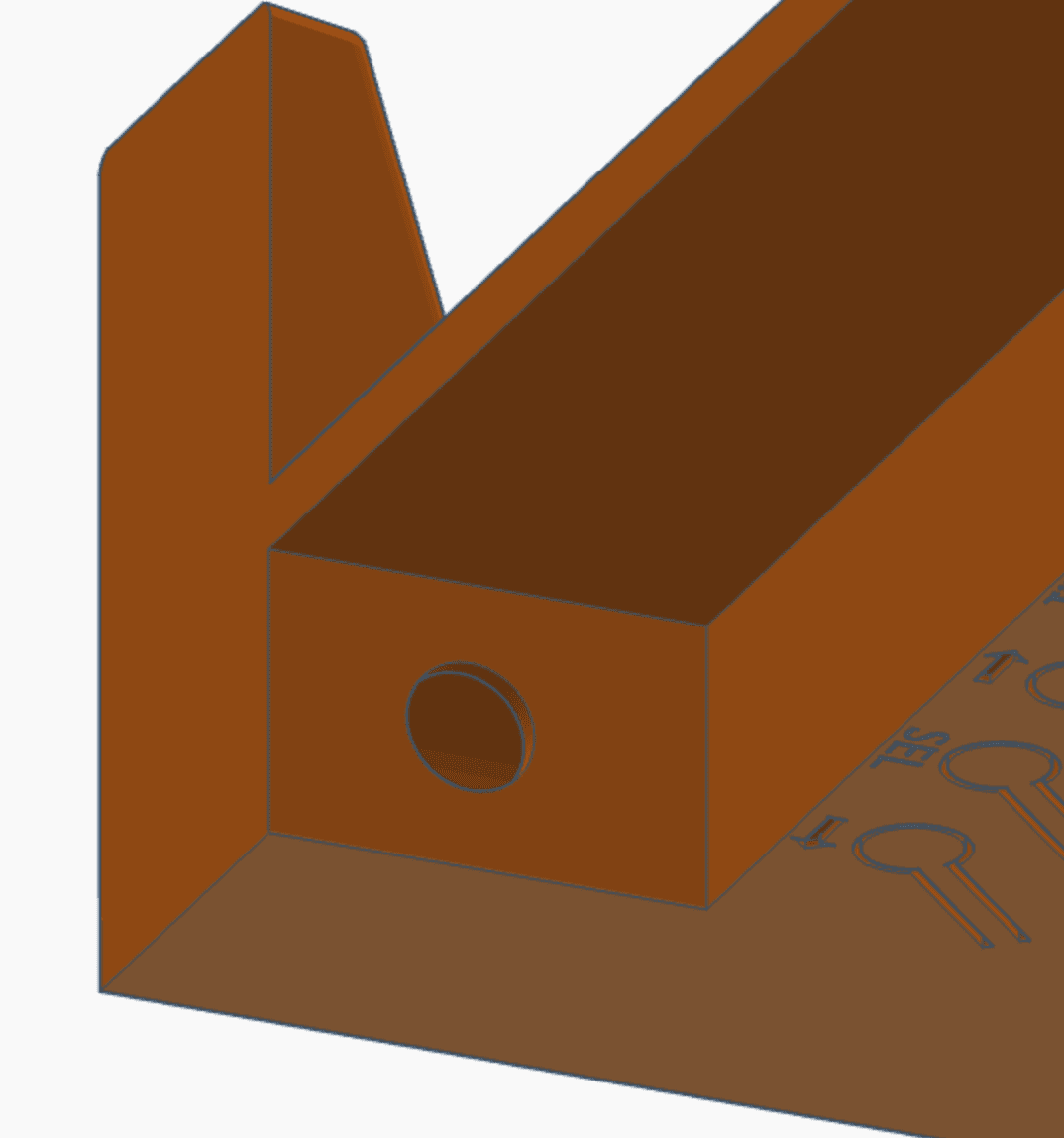

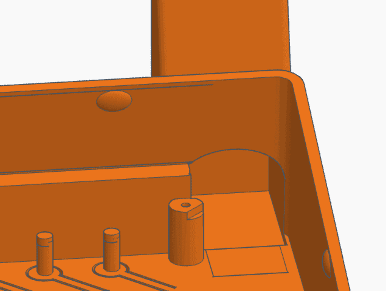

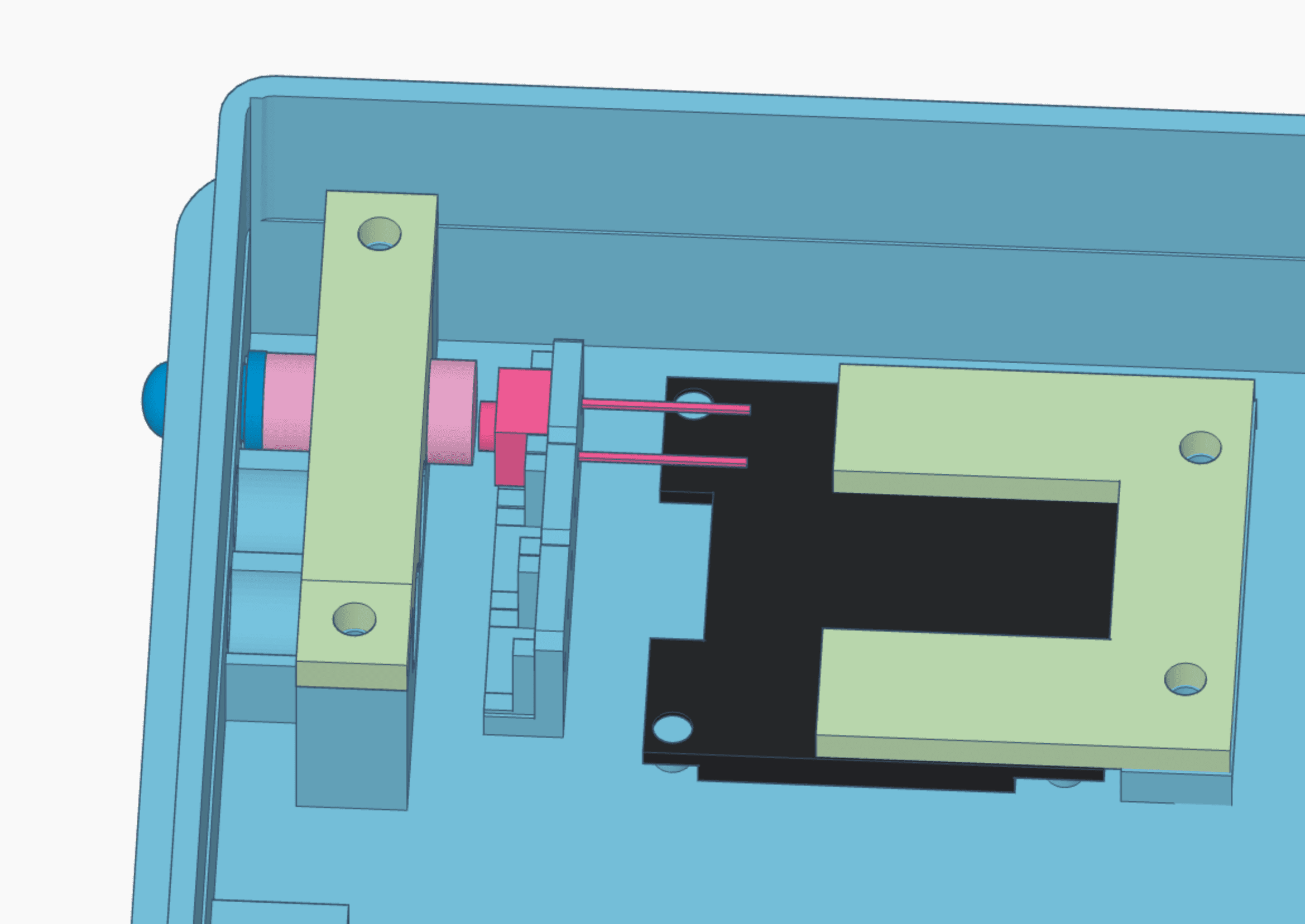

Yeah, there are going to be some compromises for adding support for the lighted power power key to the LisaFPGA version. The back is no longer symmetrical, which bothers me, but is probably acceptable.
Also. the 12v power jack cannot stay where it is because that's where the enclosure for the switch will need to be. So I had temporarily moved it to the top back of the machine (not nearly as clean with all the cables going into the port cutout along the bottom of the back). Along with adding the rocker switch to the top of the back as well, allowing for easily powering off the LisaFPGA and LCD together. I'm going to see if it would be possible to squeeze the 12v DC jack in elsewhere in the port cut-out.
I actually just thought of a possibility for embedding it in the left leg, and hollowing out a chamber for securing it sideways into the leg. It looks like it would work and would be printable with minimal supports. seems like it would work and actually be better than my current location (except maybe trying to secure the nut on the inside of the barrel jack connector) .
Screenshot 2026-09-28 at 10.18.26 AM.png Screenshot 2026-09-28 at 10.18.48 AM.png
When I get back from my trip, I'll see about moving the Floppy screen and buttons, and re-doing the power inputs and testing the lighted power button.

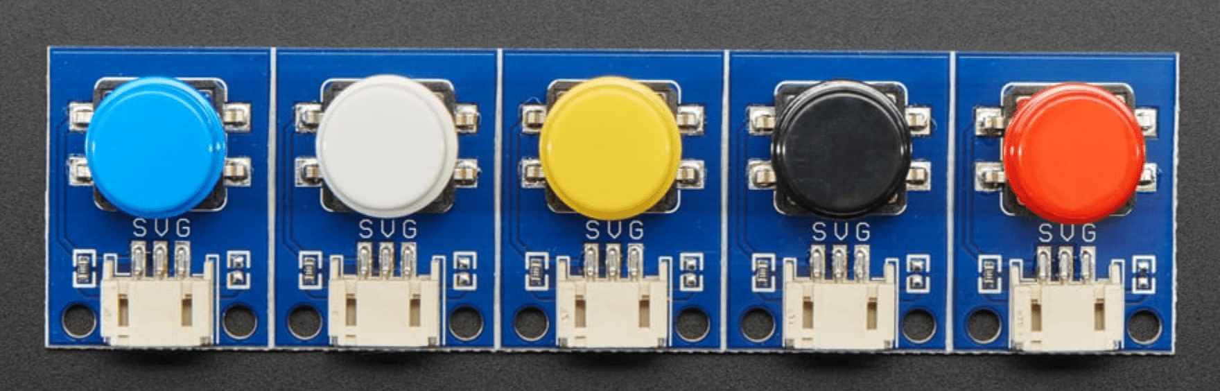

If anyone knows of a good solution for pre-made momentary switches that can be wired in easily, and secured in some mounts in a 3d printed enclosure, let me know. I was thinking about these? I would wire them to be remote buttons for the 3 ESFloppy buttons on the LisaFPGA. Then add little buttons underneath the chin for navigating, with the LCD now exposed on the front of the case. Then I would seal up the opening on the back, and remove those buttons.
https://www.adafruit.com/product/44...w7nygIZXNhkvKhReXbNd_P8QXpscUIFAi2n-GWhE_-o_Q
Now that I'm thinking about it. I might be able to put the 12v input where those ESFloppy buttons are today. IF that and the screen is moved, it opens up the space on that side for the power. I'll tinker with it when I return. This gives me a lot of respect for engineers building physical devices...

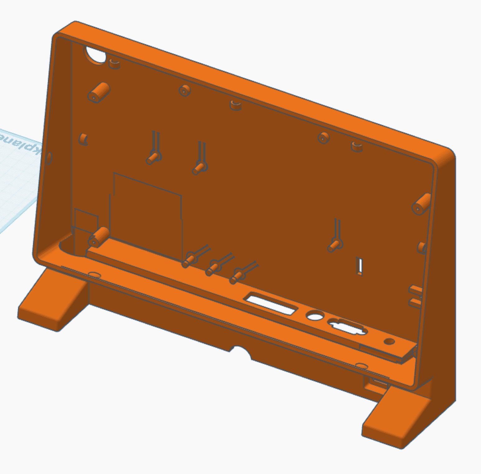

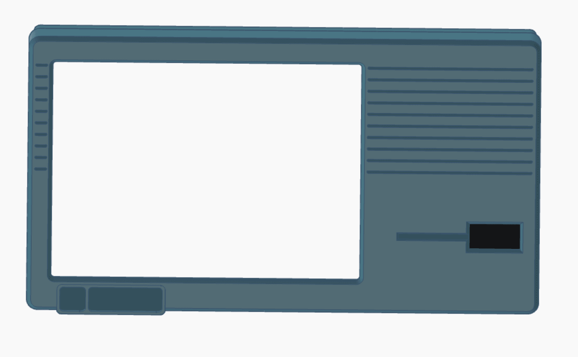

I got back from my trip and I'm trying to get this project across the finish line. I re-worked it to move the ESFloppy LCD to the front of the case (although I seem to have broken my LCD during the removal process, so if you choose to do this, be careful with the LCD when you're removing it from the L:isaFPGA). I also have moved the ESFloppy buttons to the chin of the case, right under the LCD so you can manipulate it from the front of the machine more easily.
Screenshot 2026-10-04 at 2.22.18 PM.pngScreenshot 2026-10-04 at 2.22.45 PM.png

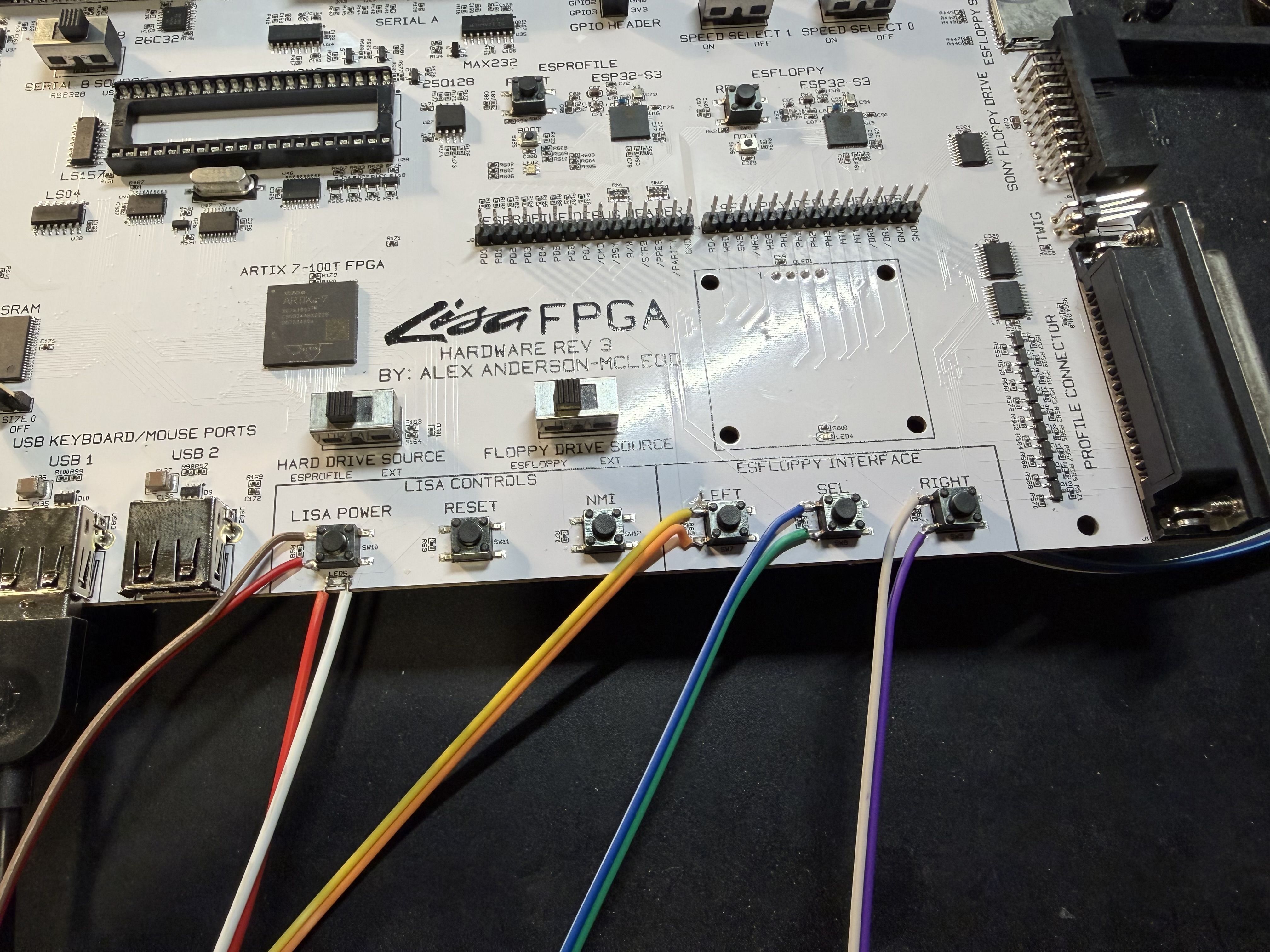

Unfortunately, moving the LCD and the buttons (and the power LED) aren't necessarily for the faint of heart. You need to remove the existing power LED (under the power button), then solder wires to those pads, as well as two legs for the power switch, the left, select, and right ESFloppy switches. Then you need to solder on some header pins in the place of the removed LCD. I'm just using Dupont wires for connecting things. All these cables need to be removable because the LisaFPGA is screwed to the back case, and the ESFloppy buttons and the LCD will be screwed to the front case.
I've done a test print of just that section of the case and it worked well in terms of button fit and LCD position. I'm waiting for my replacement LCD and the switches to arrive before I print my official case pieces. With the ESFloppy LCD and buttons moving to the front, I now have a new back case that removes those buttons and the screen cut-out. It also relocates the power jack input to one of the legs (because the lighted power button needs to be placed where the old power button was) and adds the lighted power button that I used for the Pi version. The new bump for the power button makes the back no longer symmetrical, which I don't love, but I think it's a good compromise - the sideways oriented jack means my 12v USB-C power adapter won't be bent as harshly, and I added a master power rocker switch to the upper corner on the back so you can cut power to the LCD when not in use. That means multiple power switches/buttons (one master power switch, one switch on the LisaFPGA, and the Lisa power button).
I also added a few zip tie rings around the inside of the case to help with cable management. Flexible and basically free. Optional for people who want the wires to be better secured.

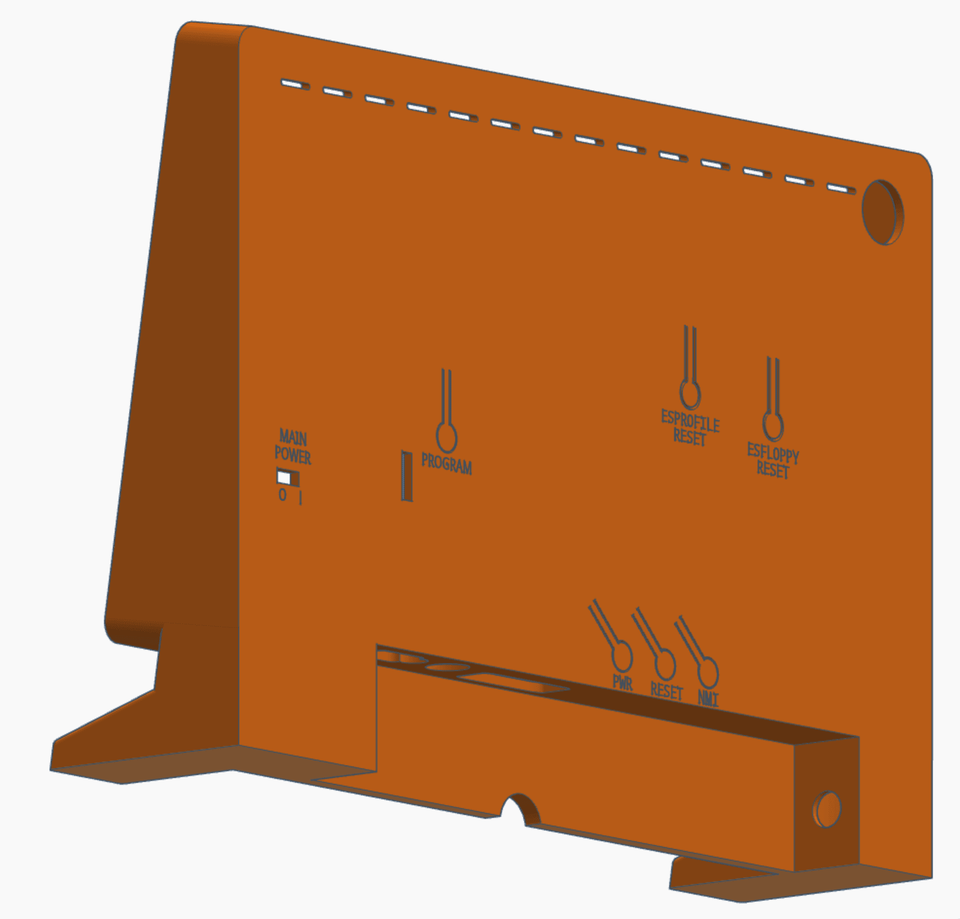

Once my new LCD arrives, as well as the momentary switches, I should be able to call it a wrap on this.

Got the switches in today and the button components work really well. The buttons barely stick out, so it is very subtle, but easily findable by touch.
Here's the new front plate. Also, I've spent some time trying to address one of my pet peeves about the LisaFPGA - it's support (or lack thereof) for more USB input devices. It basically only supported low speed USB HID devices with no hubs built in. This ruled out most wireless keyboards and mice, as well as every Apple USB keyboard (since they all have built in hubs). So my fork of the LisaFPGA software has full USB hub support as well as support for low and high speed USB devices. I've tested it on a variety of my USB devices and it worked on all of them.
The new front case with the buttons built in and ESFloppy screen on the front is really nice, and once I replace the LCD I broke during removal, I'll demo it with the new keys on the front chin of the device. I'm working on some improvements on the back case before I print - namely a way to access the microSD cards without opening the case and having to unscrew the LisaFPGA board to access them. I'm leaning towards an opening in the side of the case (with a cap that could pop on and off to cover it when not needing to access them. But I might add a pair micoSD extension that would allow me to cleanly mount to the side of the case and make it a cleaner look (just a thin opening for the microSD cards themselves. That just add complexity and cost and I feel like it may be overkill.
Here it is in action (minus a working ESFloppy screen).
