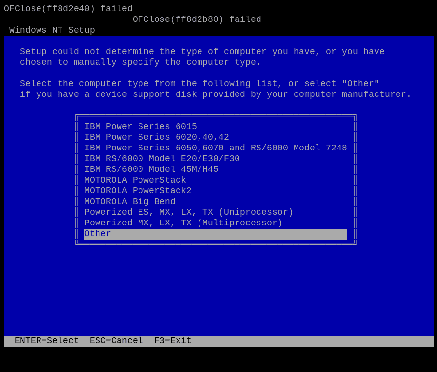

I put an agent on the task for a few hours. You can see/follow the result here: https://github.com/pappadf/granny-smith/pull/135
Update: It actually seem to load the NT kernel now (though not yet boot it) - it asks for the HAL. This one will be tricky to pass.

New update (sorry for spamming, but I wanted to share latest):
NT kernel running, uses the Cirrus graphics card in text mode, crashes on INACCESSIBLE_BOOT_DEVICE:
