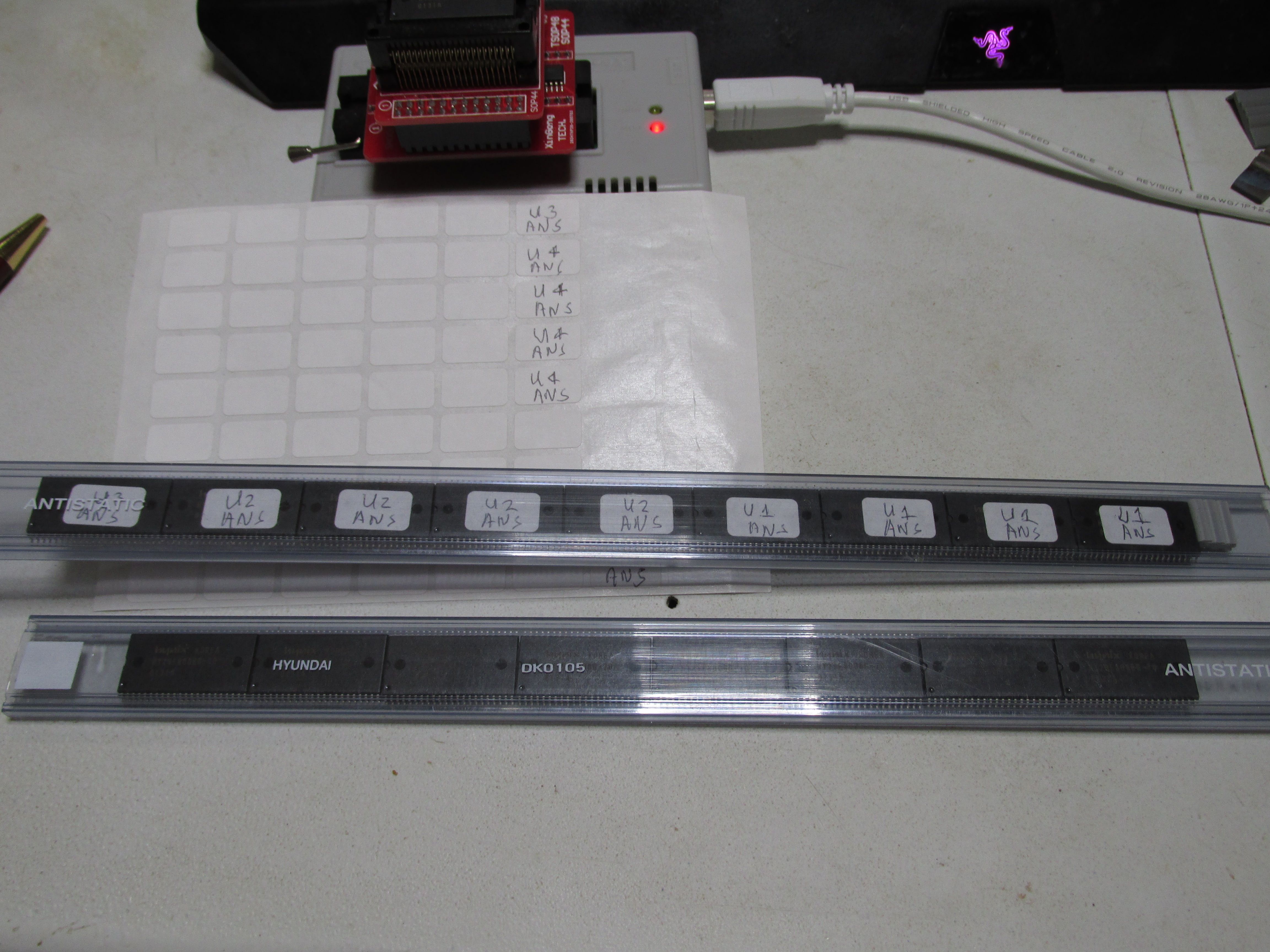

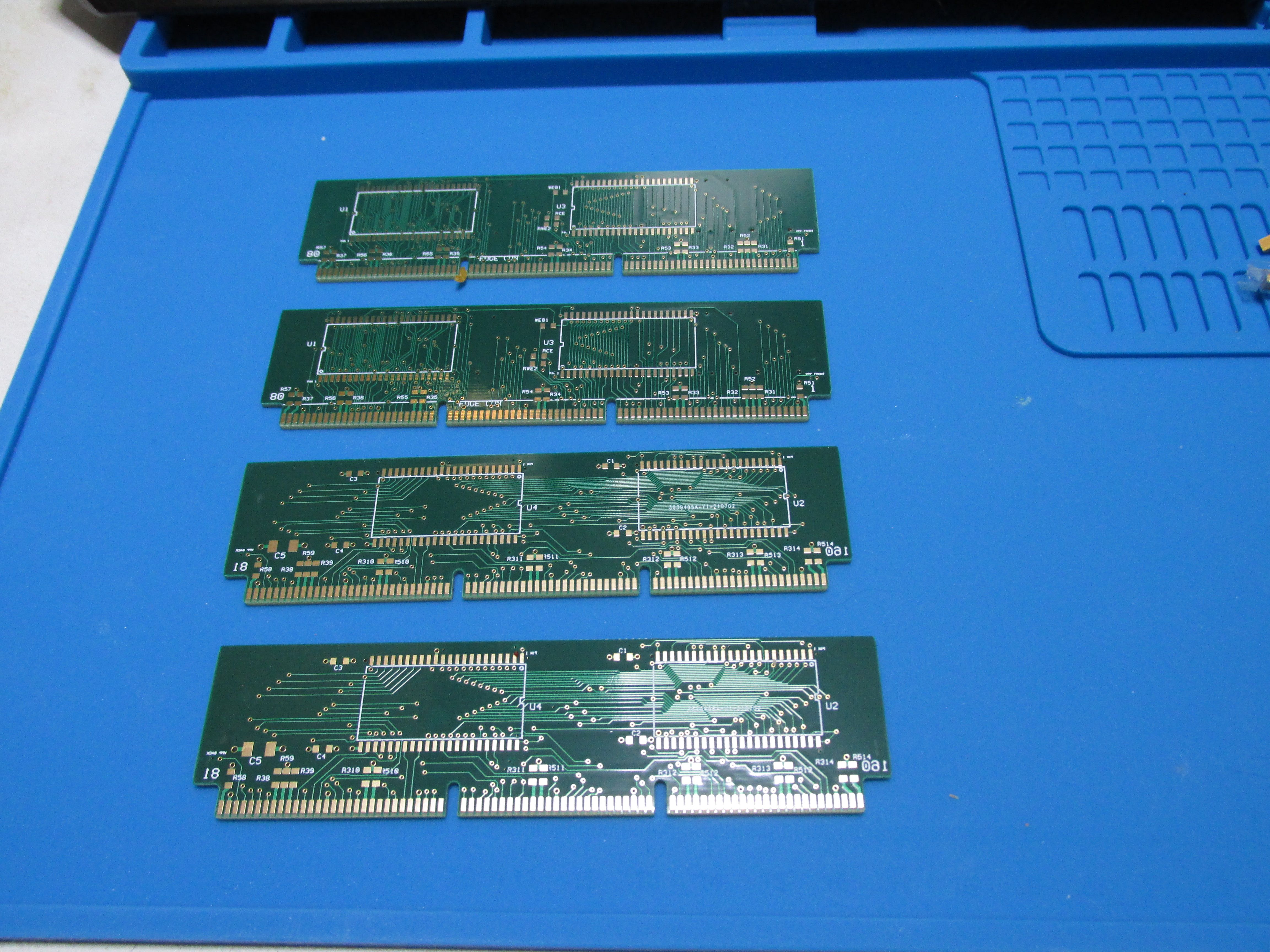

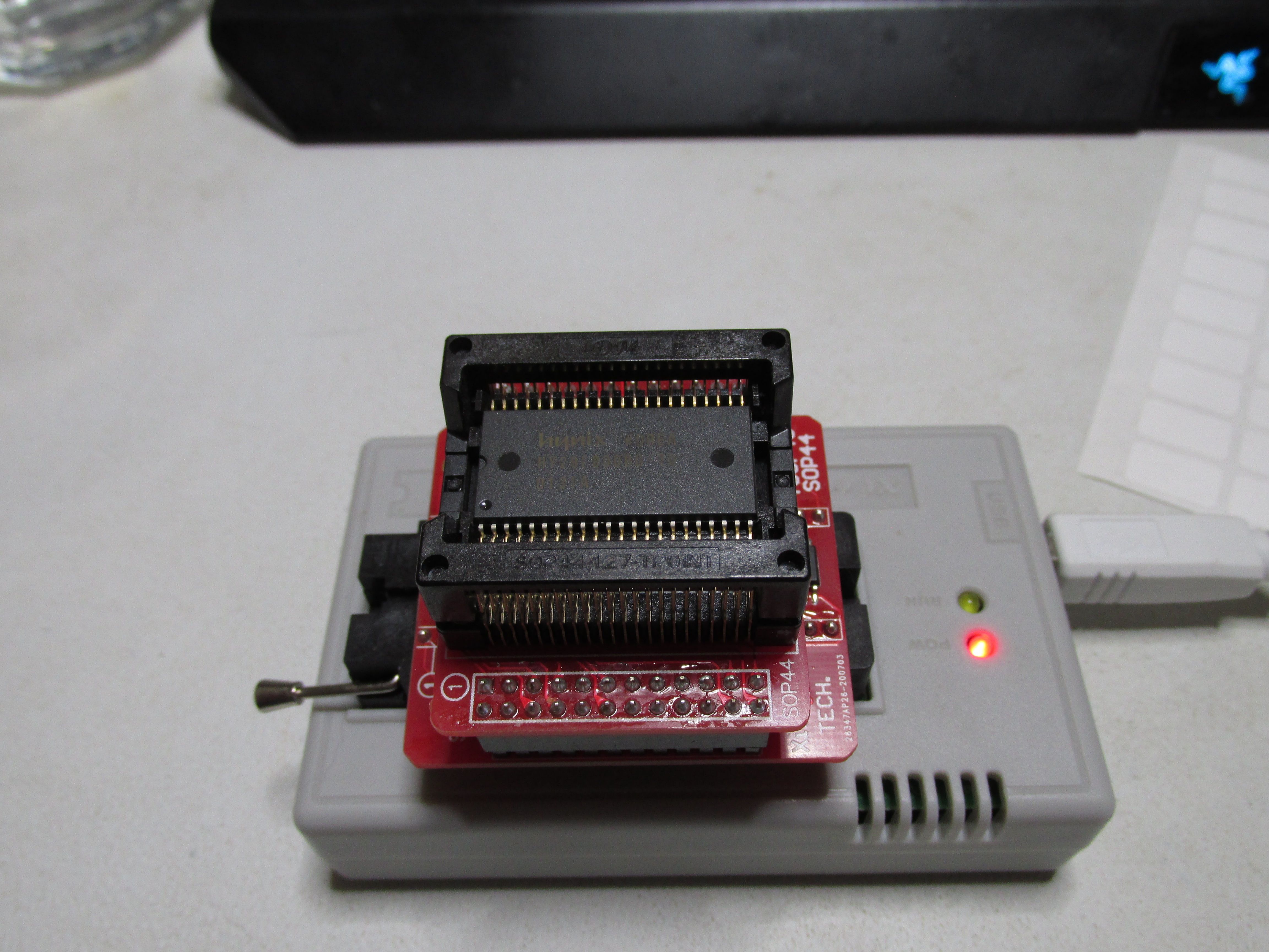

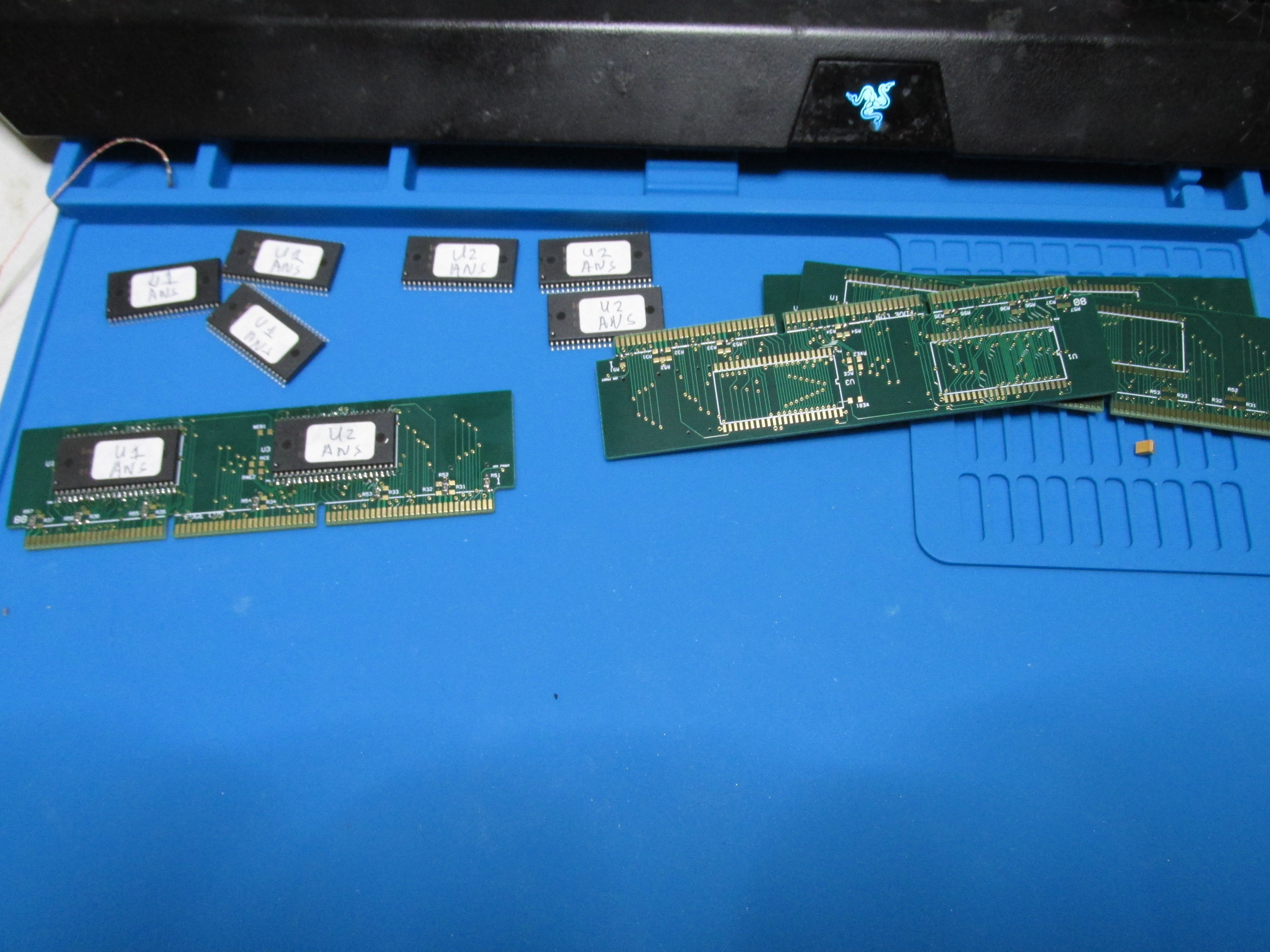

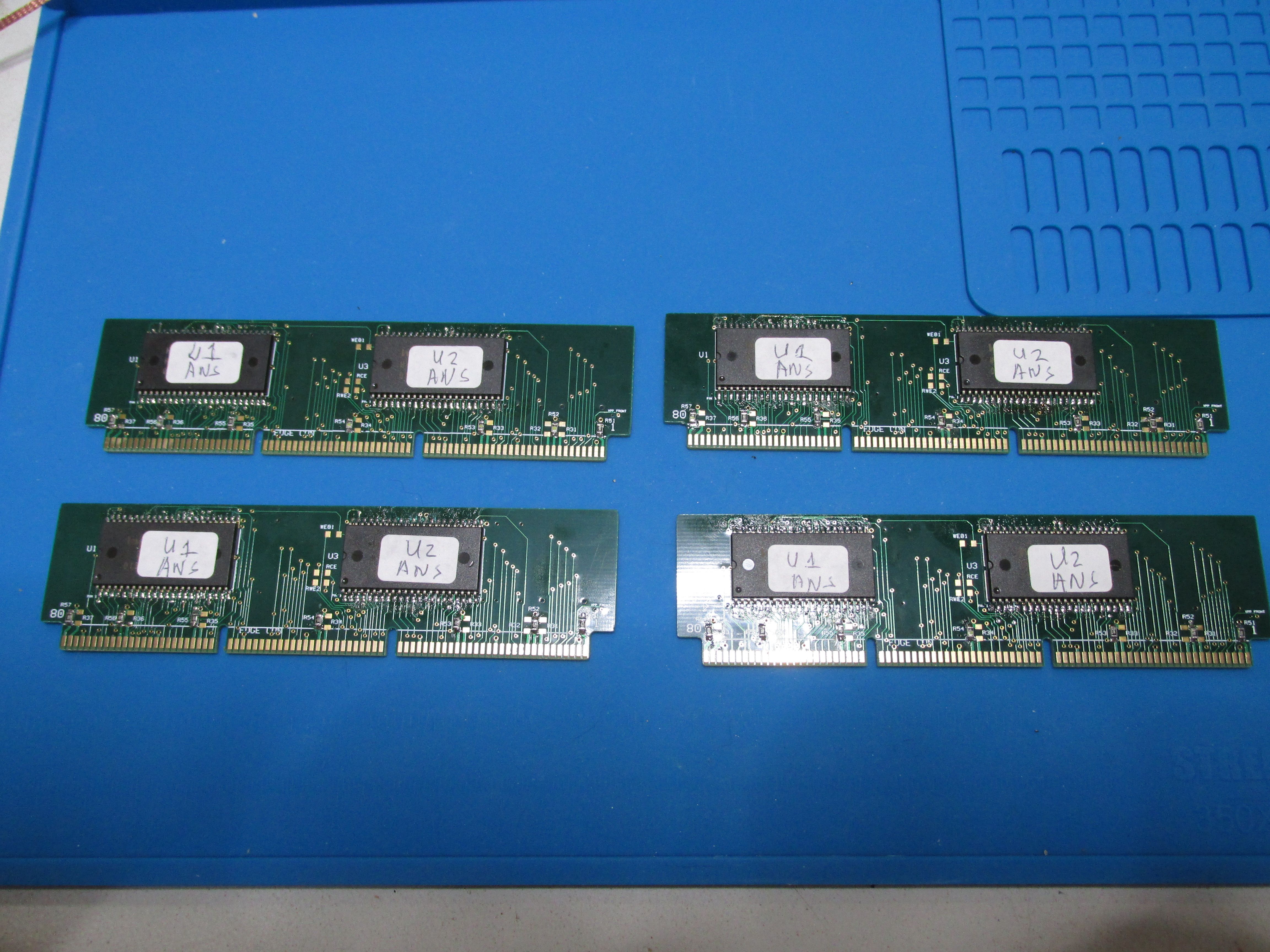

Let's let ClassicHasClass do his testing first, to determine whether I made any fundamental errors. I would hate to start assembling these for folks only to find that every single one has some fatal problem.
I made four because that way, if they all fail, it's probably a procedure flaw. If one or two fail, that's probably just an assembly error.
When I was making Rev. C Beige G3 ROMs (over 100) my failure rate was about 1 in 20. But I'm older and my eyes and hands are not as good as they were 20 years ago...
There shouldn't be any problems. I've used this board to make ROMs for the 7200 through the PEx. But there can be odd things. For example, on all the X500/X600 and Power Computing ROMs I examined, pin 122 is tied to ground and it doesn't seem to do anything. It's not connected to anything on the DIMM. But on the Beige G3, if you leave pin 122 tied to GND, then the Beige G3 will not see more than 512MB of RAM. I guess it's signaling a register in the XPC106.
Hopefully there isn't weirdium like that in the ANS.
Anyway, after CHC has tested, and assuming good results, I'll put you at the top of the list. Sad for an ANS to be sitting ROMless.
I'll be sending out the ROMs I make untested, so I'll ask for patience if there are any individual failures. It's too big of a chore to dig my ANS out and get it going (probably have to recap the LB). Plus I'm not sure I left a CPU card in it. Those may be in a box in the attic, because the last time I really messed with it I was trying to get a Mac to ANS CPU adapter working.
Found in my notes from about 20 years ago when I was pinning out various ROM modules by hand, that Pin 28 of the ANS ROM is tied to GND through a 10K resistor.
I hope that isn't necessary for them to work because the modules I made don't do that...
I think I see a way to add a bodge, if necessary, but the modules would need to make another round trip.
Anyone with an ANS ROM handy want to take a close look at pin 28 on your module?

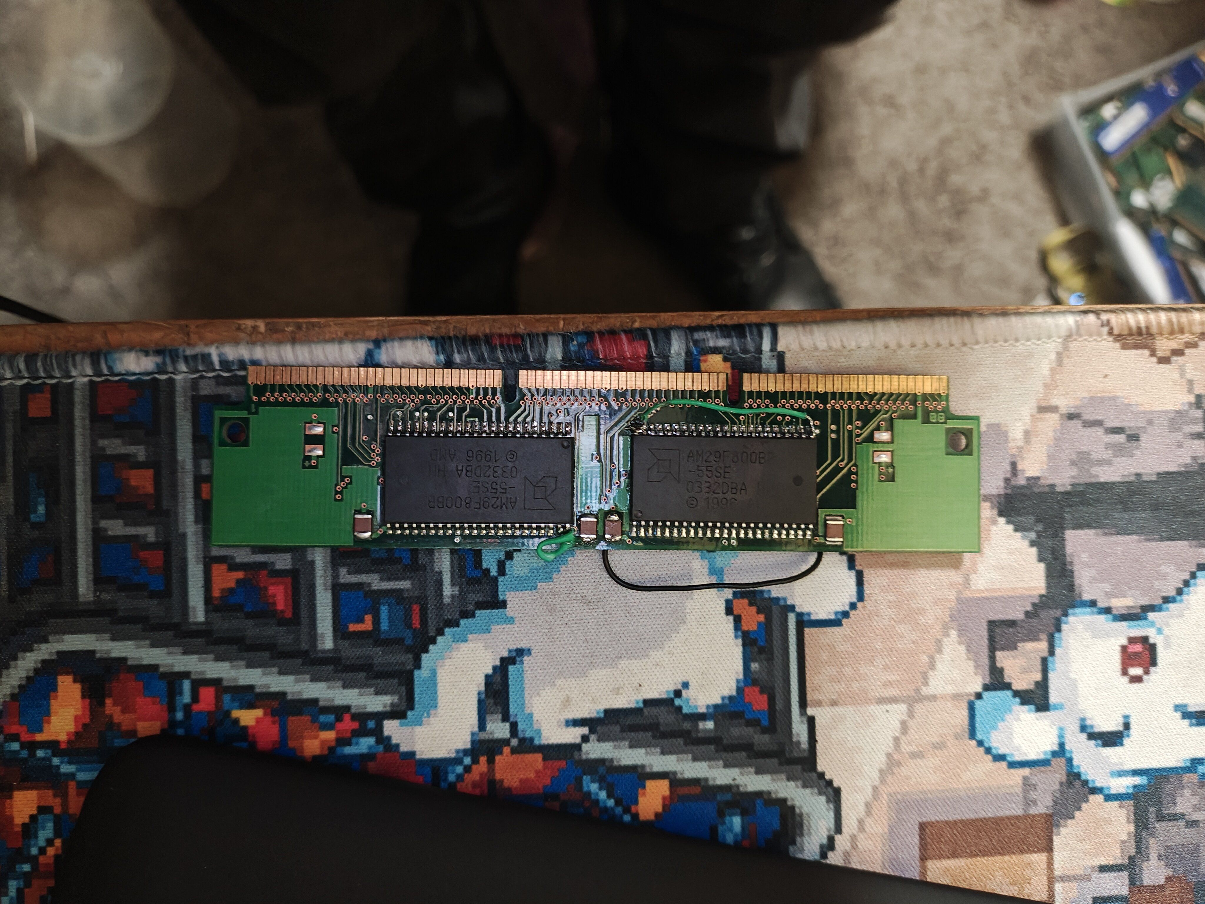

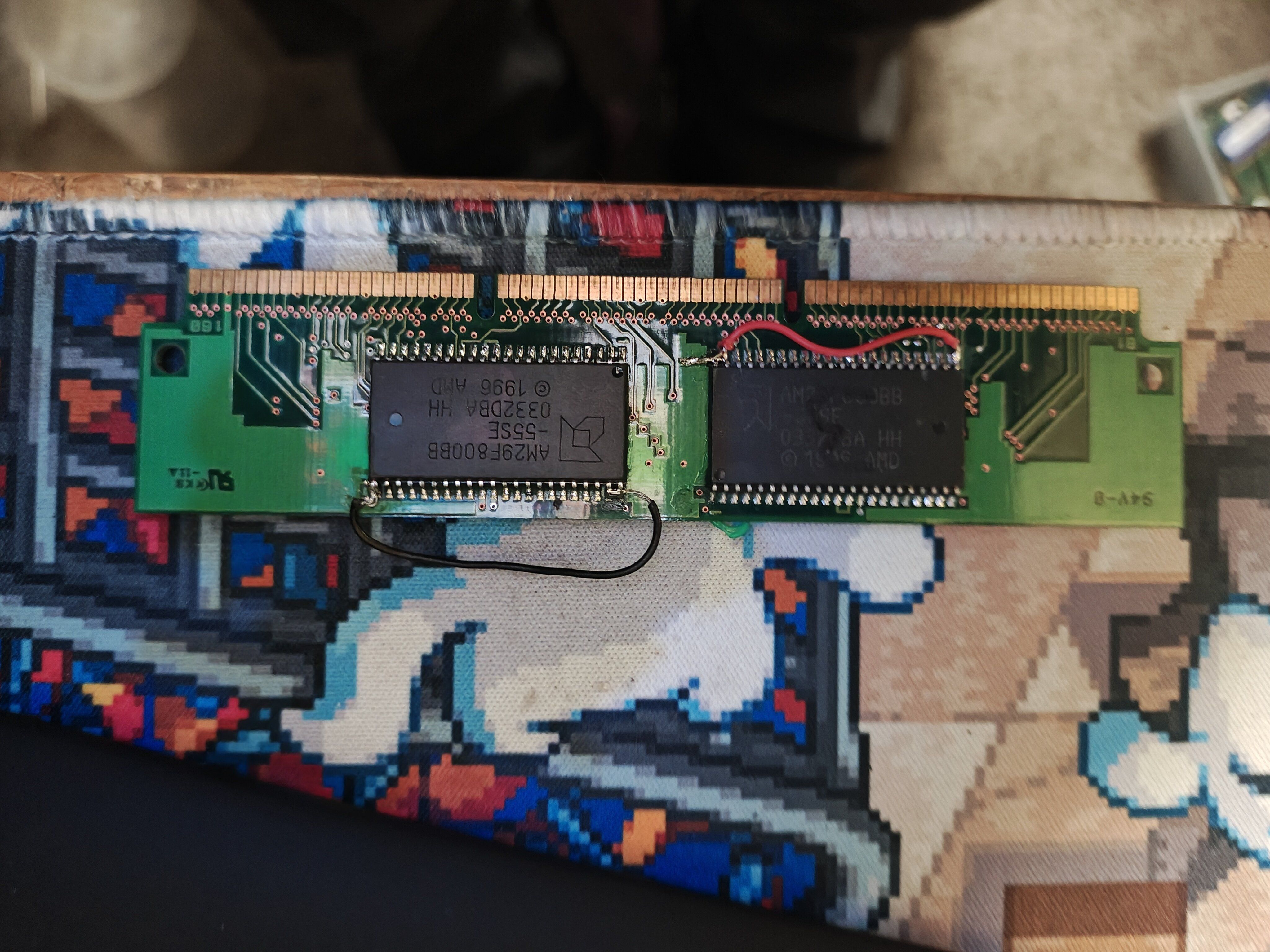

A new thread describing conversion of a 7100 ROM DIMM to ANS 2.0 ROM DIMM with more pictures:
https://68kmla.org/bb/threads/my-attempt-at-an-ans-rom.52132/

Those conversions really shouldn't work, unless the 7100 ROM DIMM is supplying 5V on pin 33 for each of the chips. Perhaps it is. Now I wish I hadn't put that 7100 ROM away. I don't want to dig it out again. At least I know where it is...
These chips (AM29F800/HY29F800) can work in 8 bit or 16 bit mode and this application requires 16 bit mode. The mode is controlled by pin 33 and it needs to be high to tell the chip to operate in 16 bit mode.

Oh hey, my rom got mentioned!

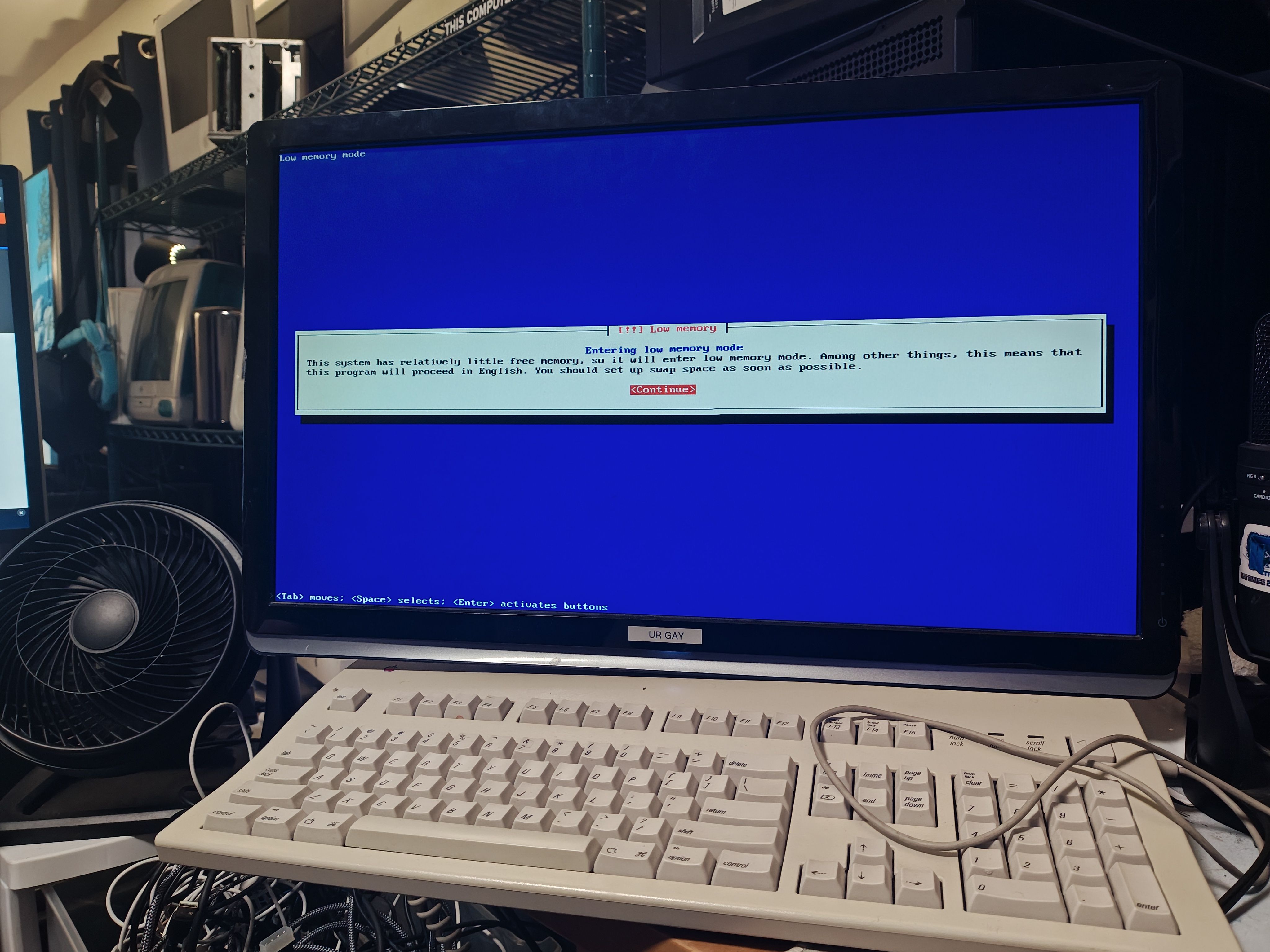

Boots Mac os 9.0.4 great, couldn't get it to boot into 9.1 at all
Did get it to boot Debian 12, via bootX, but it crashed at the internet device finding state, didn't try it again cuz it was late, will try again tn
Currently has 200mhz, 196mb ram, and 256ks of cache, ordered 512mb, and a 512k cache sim, that'll probably help. Oh, as well as a ATI rage 128, dunno if that's been tested yet, but I will.
Not sure, did someone say the 100/10 Ethernet card works or nah, it recognizes mine, but won't dhcp or let me manually set it :// (in mac OS)
