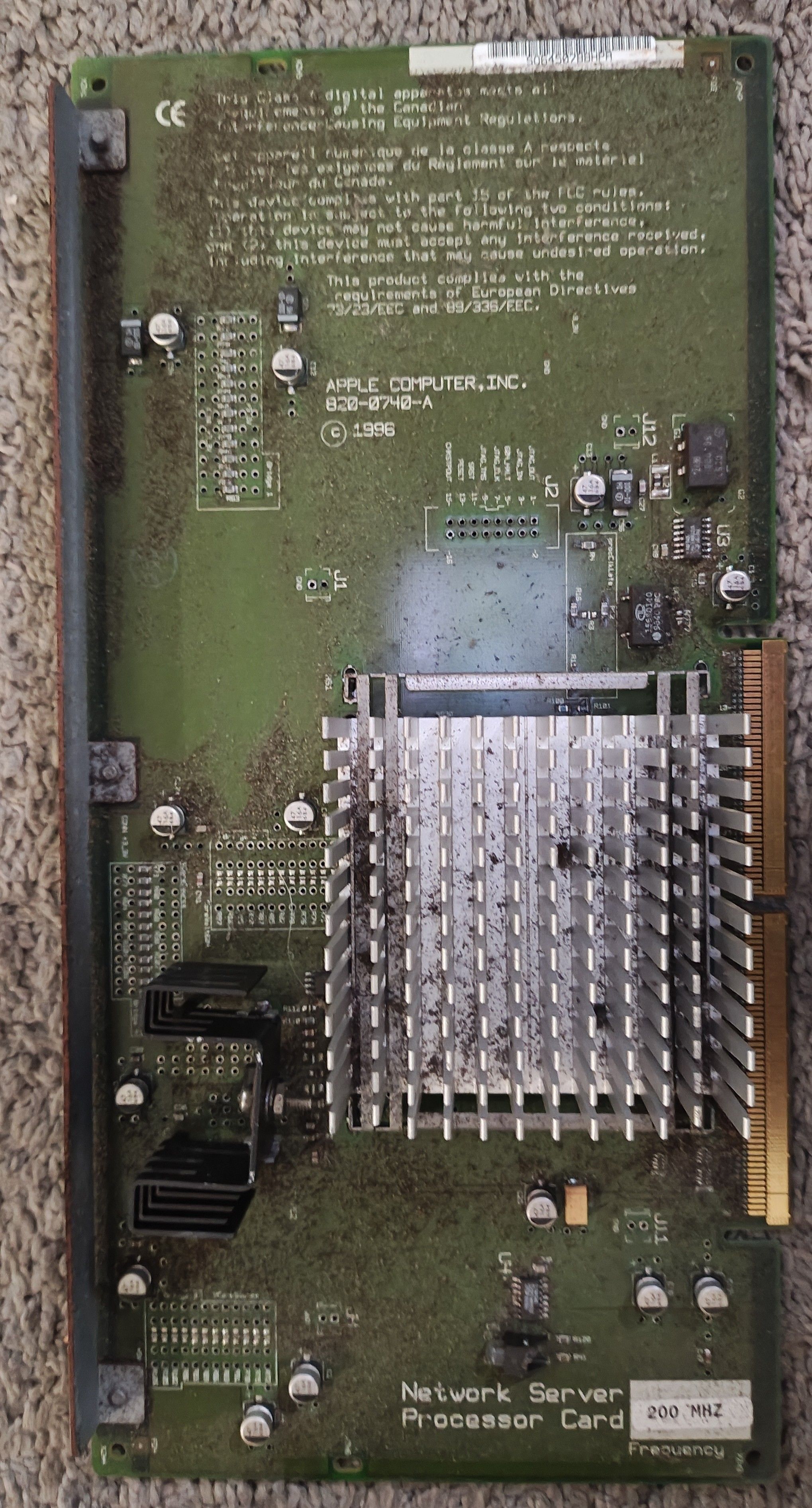

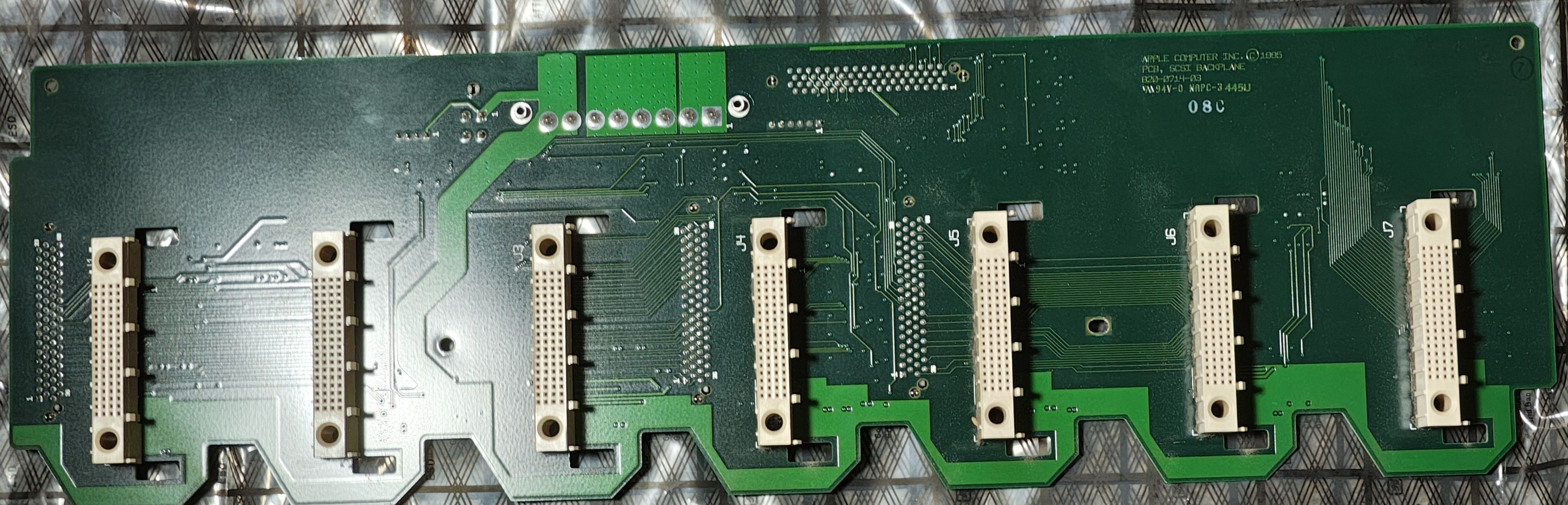

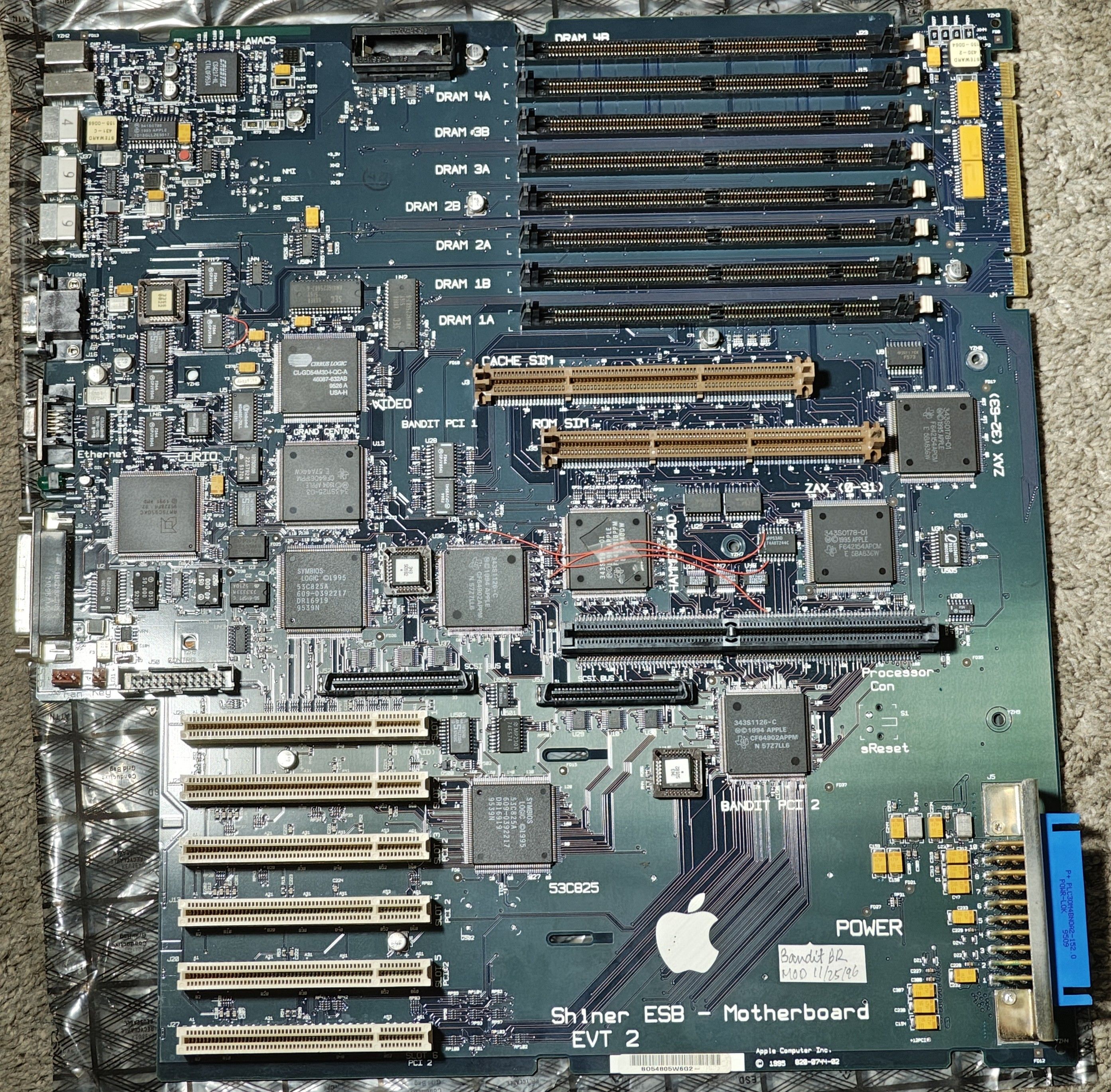

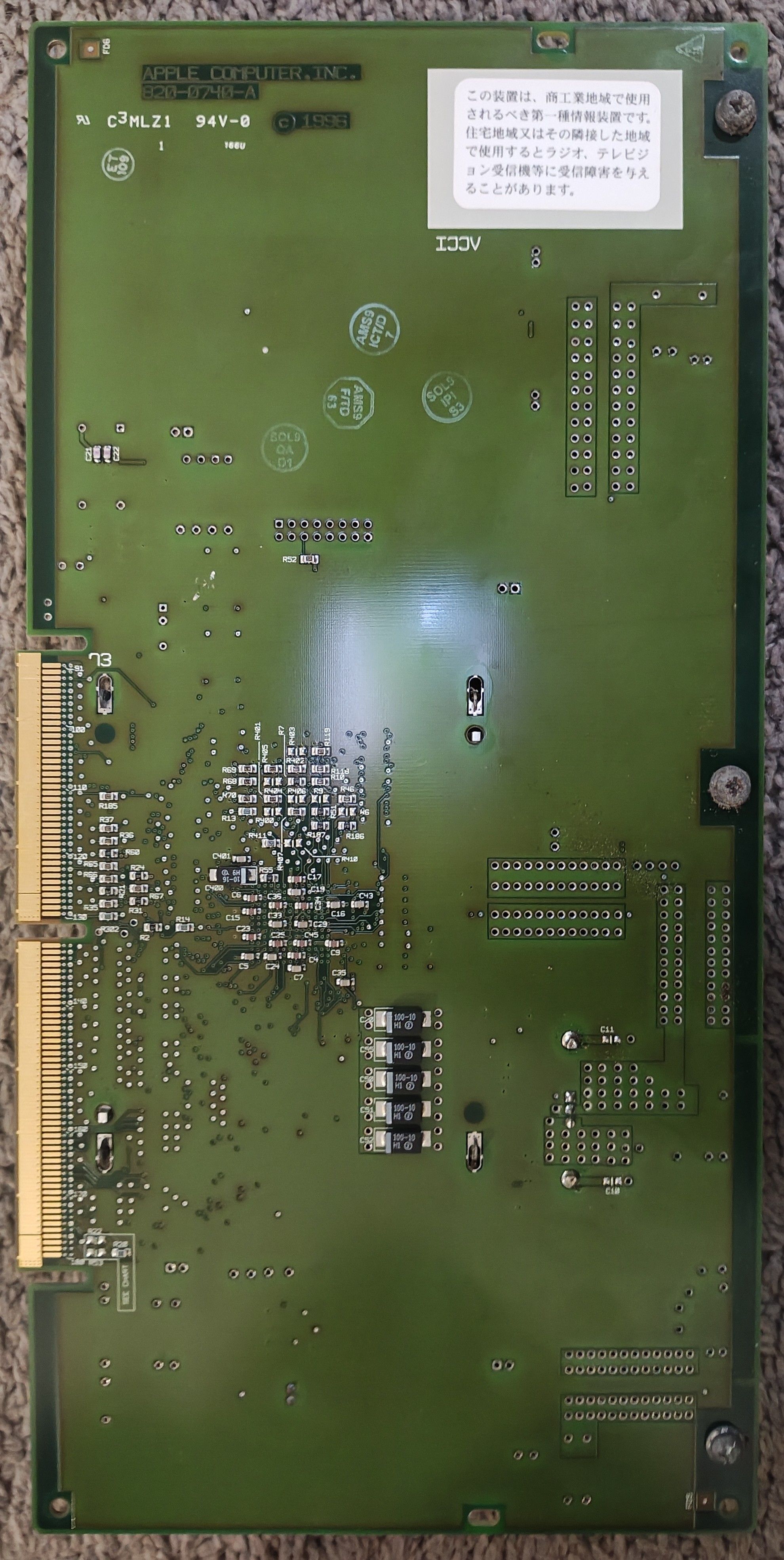

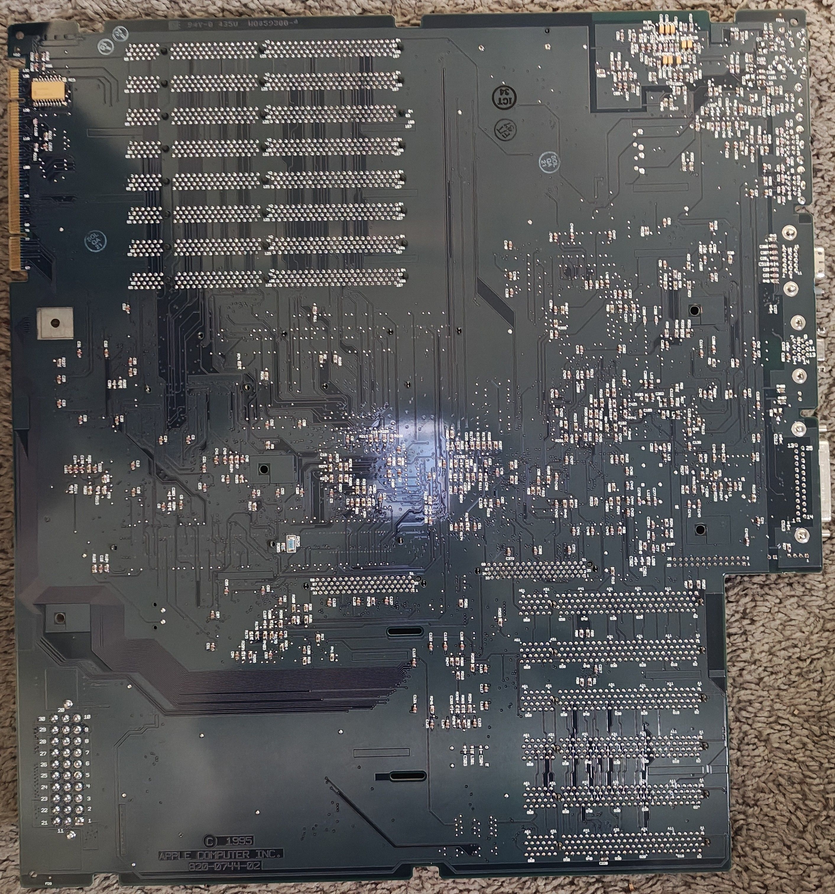

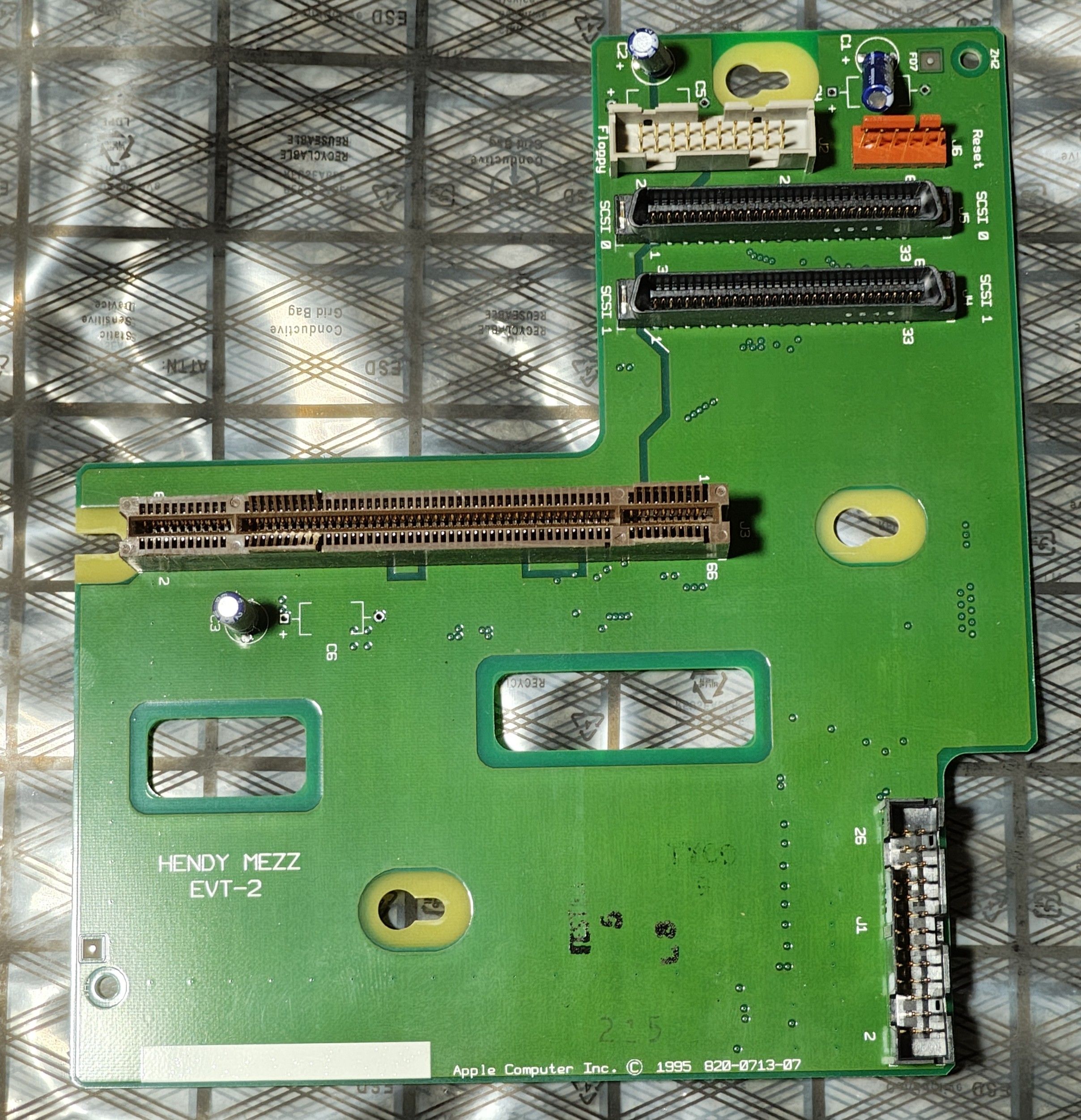

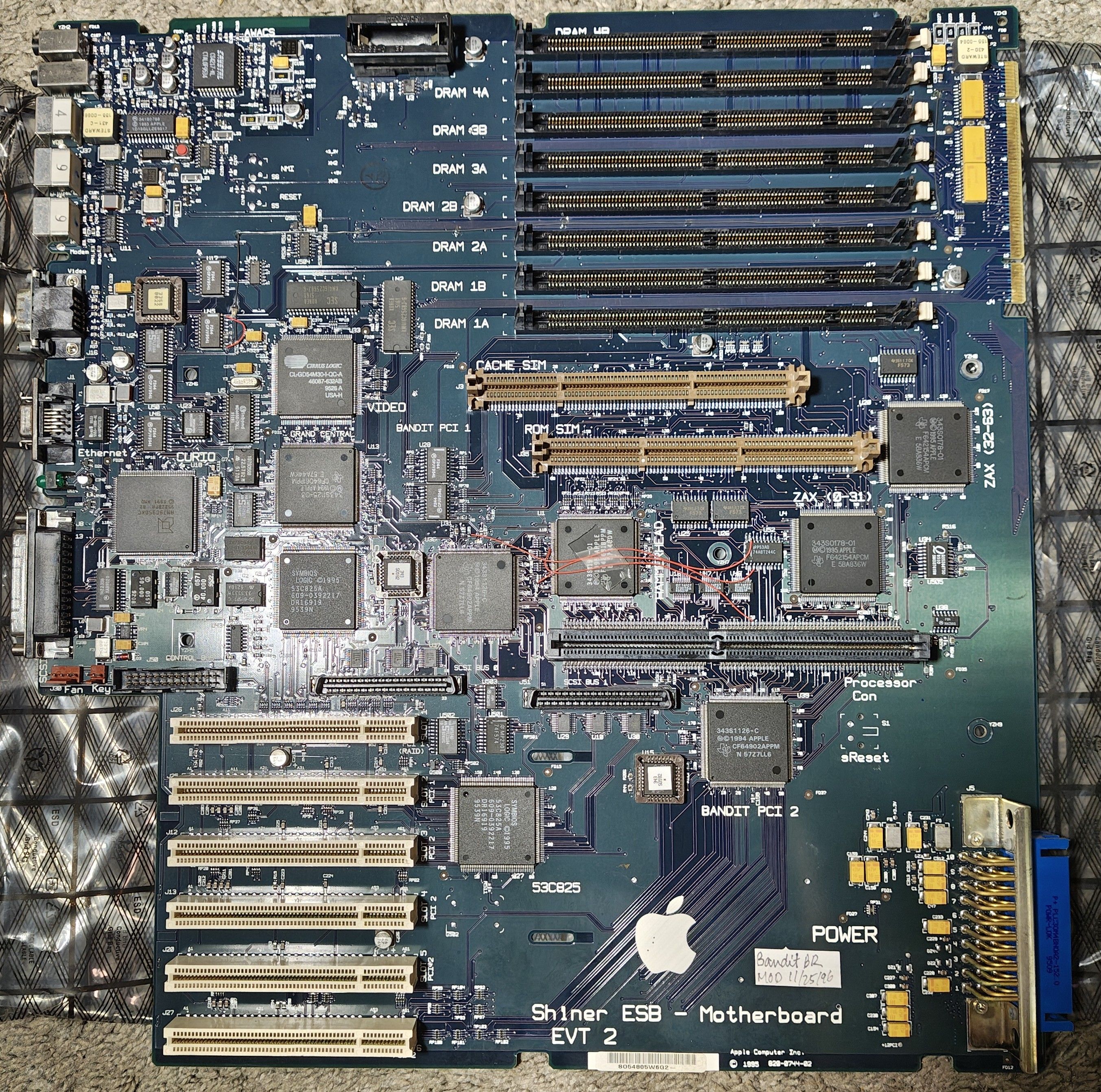

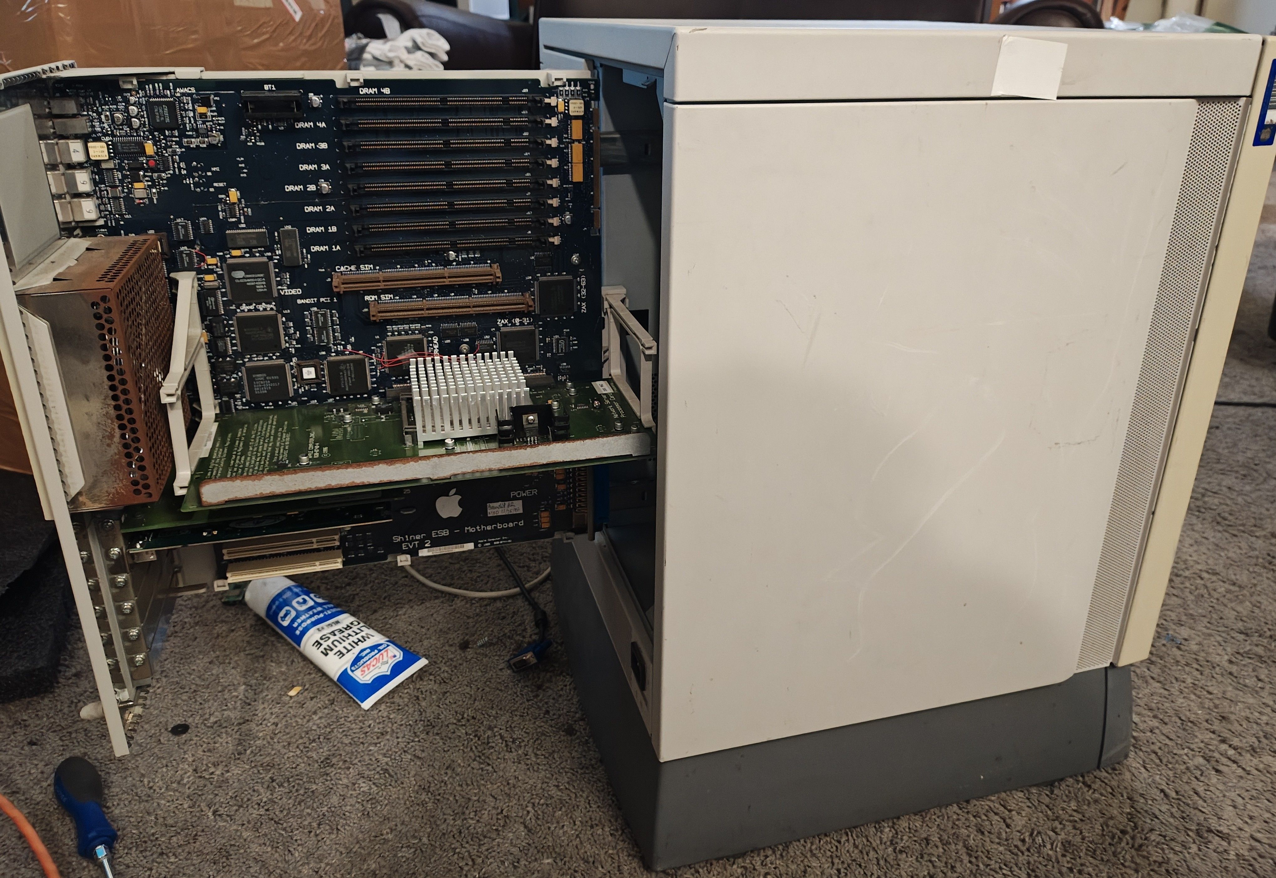

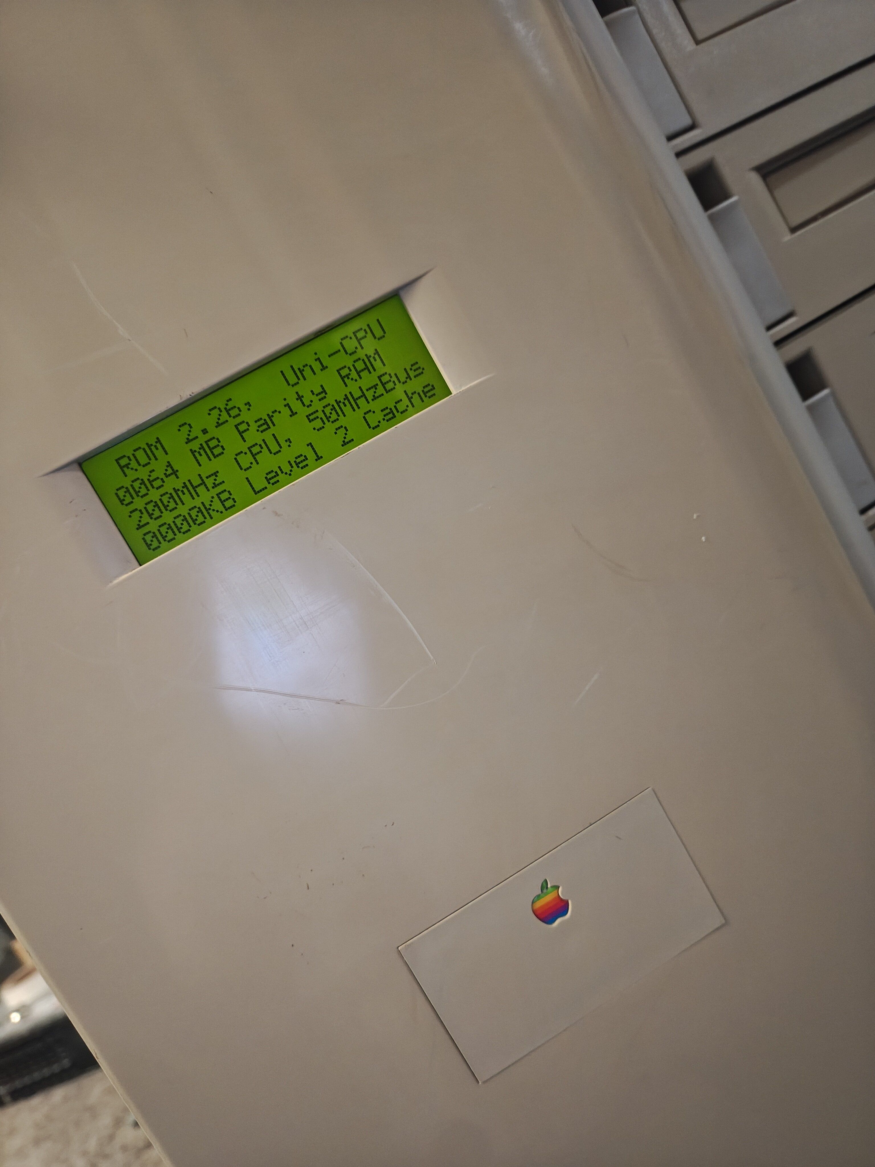

Not sure if this is a good time to say, hi! I'm new!
I found this evt2 ans 700, and it looks like it has the same rom.
Please forgive me if this is incorrect, I know nothing about this board outside of very basic Mac collector knowledge lol.
Recapping today or tomorrow, will let y'all know if this is the case.
Rom chips are the same AM28F020
mizerable
Apr 11, 2026
39
14

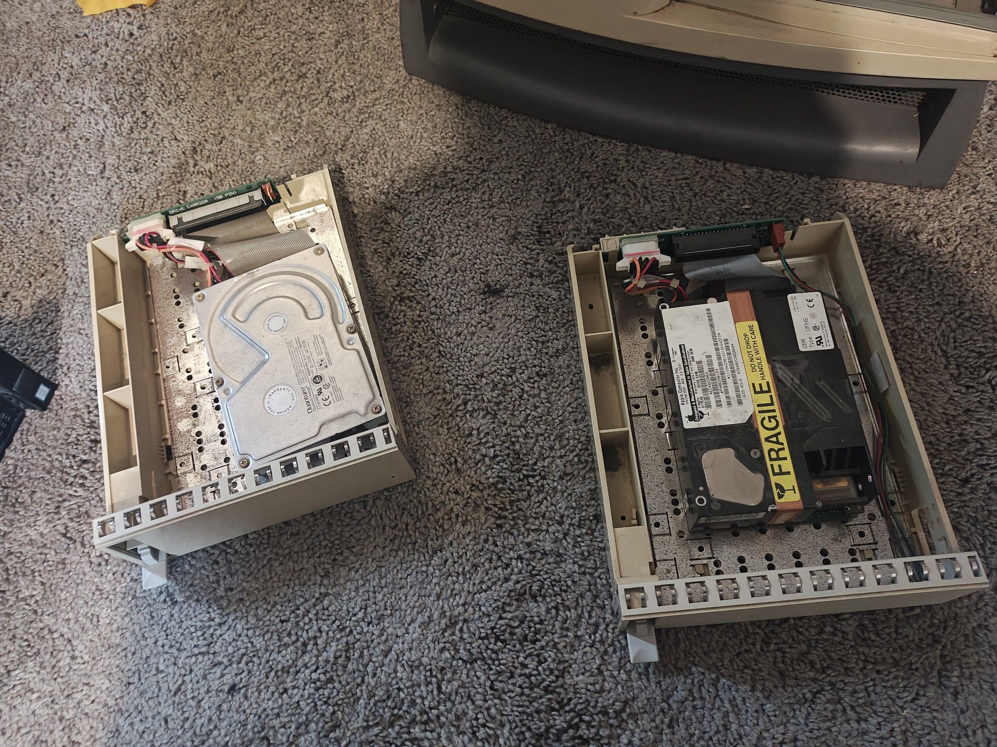

Ezpz, although I do not have that specific kind of serial cable :((( will have to order.
There were drives that came with it, going to set up the PC to copy the drives later tonight.

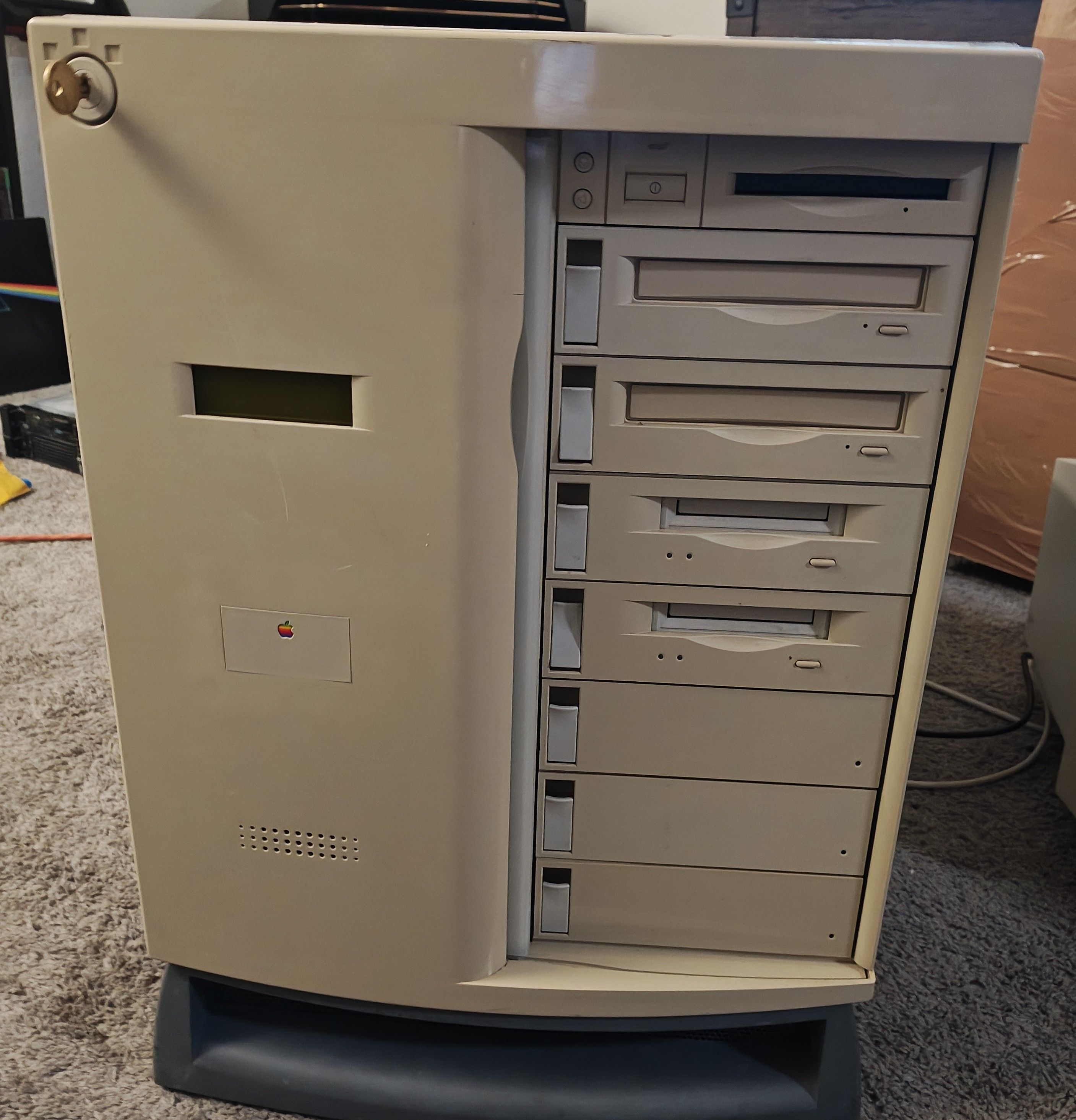

Much later ROM than I would have thought. It would be very interesting to see what's on those hard disks.
Yeah, seems like my dreams of being able to just boot Mac OS is a bit of a fetch haha!
Linked is my archive page for it, one drive doesn't work, I think, still tryna work on it, the other was read by my PC, and I was able to turn it into an ISO, but honestly have no idea really how to view the data...hopefully one of y'all smart cats can figure it out n lmk if there's anything cool!
It came from Texas, presumably where it lived it's entire life, I purchased it off eBay a while ago, and now I feel as though I have highjacked the post haha.

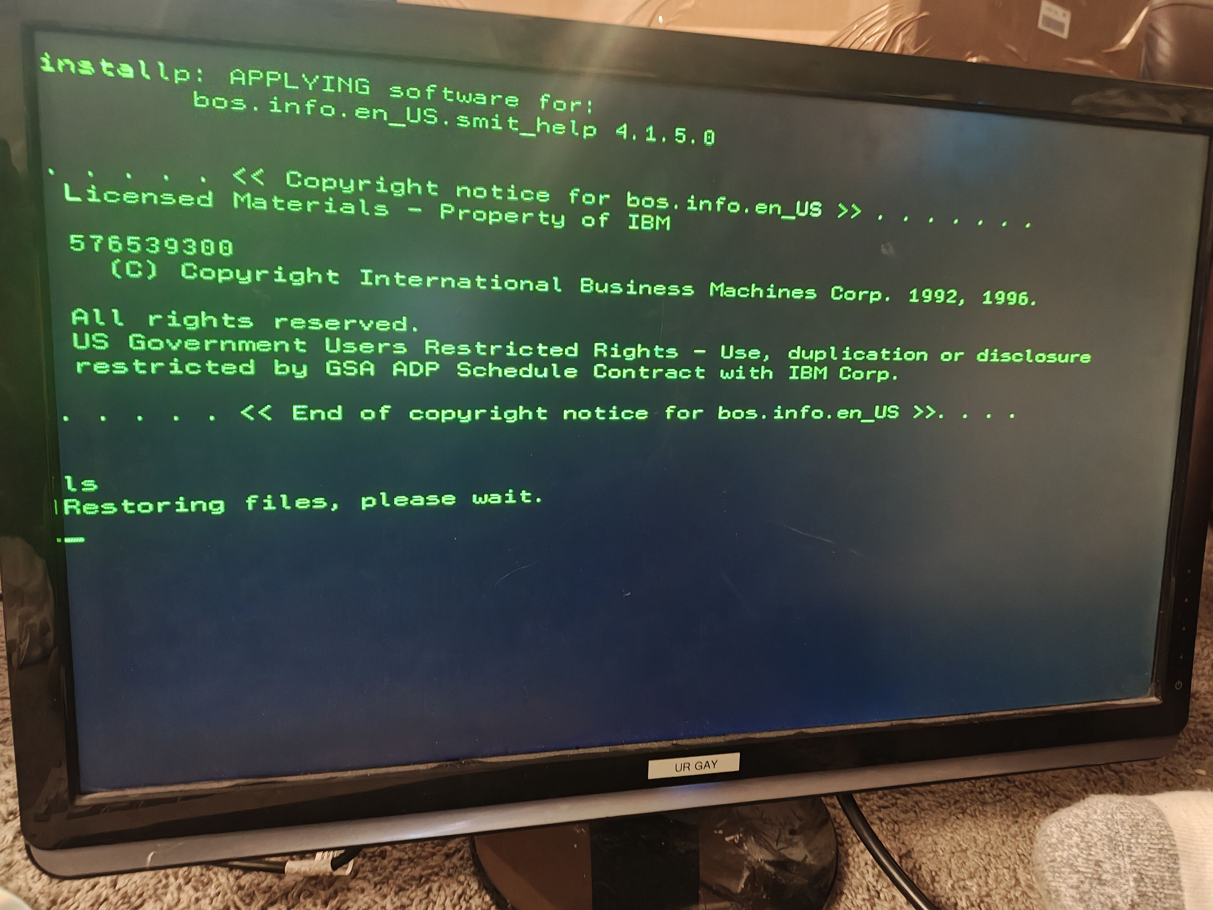

Got it to boot into AIX, nice.
I found a apple ii style printer/modem cable and a serial to USB adapter, to try and run that script...if that's still even a thing ide need to do...
having some large difficulty getting my computer to connect to it, what is required for it?
I ended up booting into Aix, it recongnized it and surprisingly worked, although no data was on the 4gb drive from what I could tell digging around in it... the quantum has been turned into an iso as previously mentioned. installed AIX to bluescsi.

The Quantum image appears to be HFS+. It is named "dStore."
Apple Driver Map, blocksize 512, blockcount 2503871, devtype 0, devid 0, driver count 2, contains[@0x200]: Apple Partition Map, map block count 6, start block 1, block count 63, name Apple, type Apple_partition_map, contains[@0x400]: Apple Partition Map, map block count 6, start block 64, block count 54, name Macintosh, type Apple_Driver43, processor 68000, boot arguments ptDR, valid, allocated, in use, has boot info, readable, writable, pic boot code, real driver, chain driver, contains[@0x600]: Apple Partition Map, map block count 6, start block 118, block count 74, name Macintosh, type Apple_Driver43, processor 68000, valid, allocated, in use, has boot info, readable, writable, pic boot code, real driver, chain driver, contains[@0x800]: Apple Partition Map, map block count 6, start block 192, block count 512, name Patch Partition, type Apple_Patches, contains[@0xA00]: Apple Partition Map, map block count 6, start block 704, block count 2503158, name untitled, type Apple_HFS, valid, allocated, in use, has boot info, readable, writable, pic boot code, real driver, chain driver, mount at startup, is the startup partition, contains[@0xC00]: Apple Partition Map, map block count 6, start block 2503862, block count 10, name Extra, type Apple_Free
It will mount, but it doesn't look like there's anything in it other than the Desktop Folder, so it would not have been bootable. It may not have been in use - possibly a pull from something else that they were planning to repurpose and never did.
You haven't hijacked this post at all - it's good to see an Shiner ESB system running again. Since you bought it from Texas, you may have one of the Apple Austin systems here. Those were among the last stand of ANS systems at Apple, and ran parts of www.info.apple.com as late as 2005.
