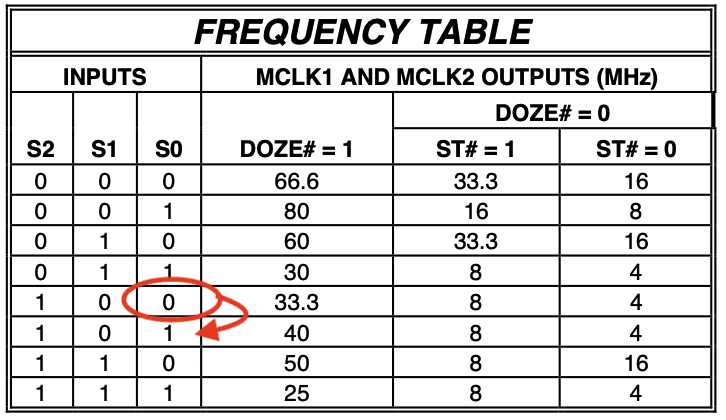

I have successfully changed the bus speed of the 7" Card from 33MHz to 40MHz, resulting in a 120MHz CPU speed (stable as it seems).
On the back of the card, turn the resistor R69 90 degrees to the left (connect it to 5V) onto the bottom pad of the resistor R72.
This changes the input S0 of the SC464 to high which results in the following:
Not every 7"-card may take 120MHz. But i have an IBM 5x86 which are known to be binned better than Cyrix own CPUs. AN IBM 100MHz part is basically comparable to a Cyrix 120MHz part.
Quake went up 19% from 9.8fps to 11.7 fps and the super scape benchmark goes 25% up from 50 fps to 62.5 fps which is more than expected.
There seems to be some more tweaking possible since writing is not cached at all and this reduces memory throughput to about half of what is normal.
PS: i have set the CPU back to 100MHz since the gain was not really worth the possible instability

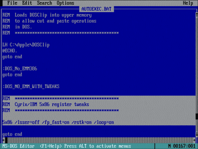

I have tinkered a bit with chipset registers and drivers.
The 5x86 can be tweaked a bit with these tools:
Cyrix5x86_Utilities.zip

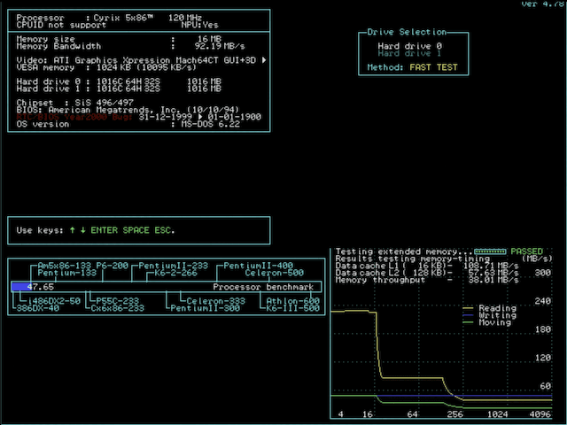

L2 Cache problems:
The L2 cache on the card is set to Write-Through but setting it to Write-Back freezes the machine.
The engineers may have intentionally forced Write-Through for the Apple bridge chip to work.
The limits of the cache are limiting further enhancements...
The 128K L2 Cache does only enable cacheing of 16MiB of system memory which further limits the cards usage.
