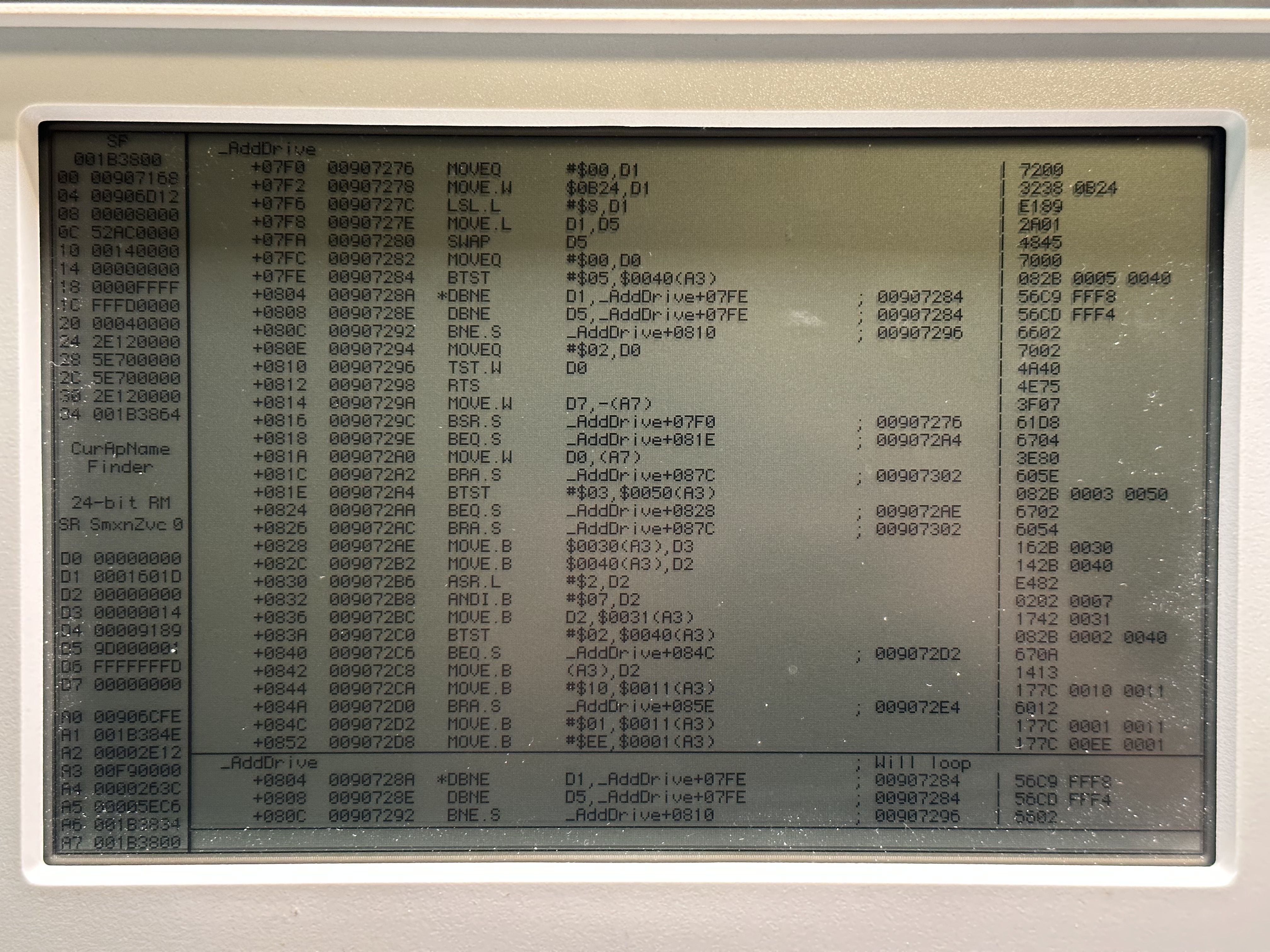

Just ran a test, here seems to be where it's stopping:
Seems to be looping at 0x907284, which I guess is checking 0xF90040 which is a SCSI controller address, and decrementing D1 and D5 for reasons I'm not sure why.
The other odd thing with the three minute wait is it's based on execution time, not real time, so that three minutes doesn't count down while the system is halted.

wow interesting so you are seeing the same issue. Is it the BlueSCSI? I just made a RAM disk and woke from sleep and tried to launch an app from the RAM disk and it behaved the same way with the delay.

I can't find a BlueSCSI around at the moment to test with.
Just out of curiosity, see what happens if you hit the interrupt button and type G 900732 when it's stuck, that gets it going on mine.
