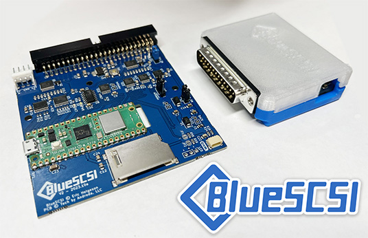

I'm pleased to announce that the BlueSCSI now supports DaynaPORT network emulation over the Pico-W WiFi interface! This has been in the works for a few months now and lead by @jcs with help from @Androda, @jokker and myself. Also huge shout out to Tony from @landogriffin for doing the initial work in PiSCSI and documenting the DaynaPORT commands!
If you're interested in trying out this beta and providing feedback please see the wiki page for details. I've provided a drive image with all the utilities you'll need. https://github.com/BlueSCSI/BlueSCSI-v2/pull/59
