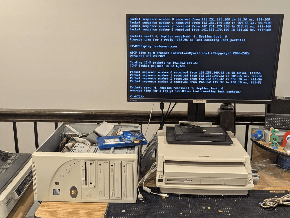

@RetroTechChris wrote a packet driver for the BlueSCSI in DOS, and has more plans for it, stay tuned! We'll update our DOS premade SCSI images soon!
