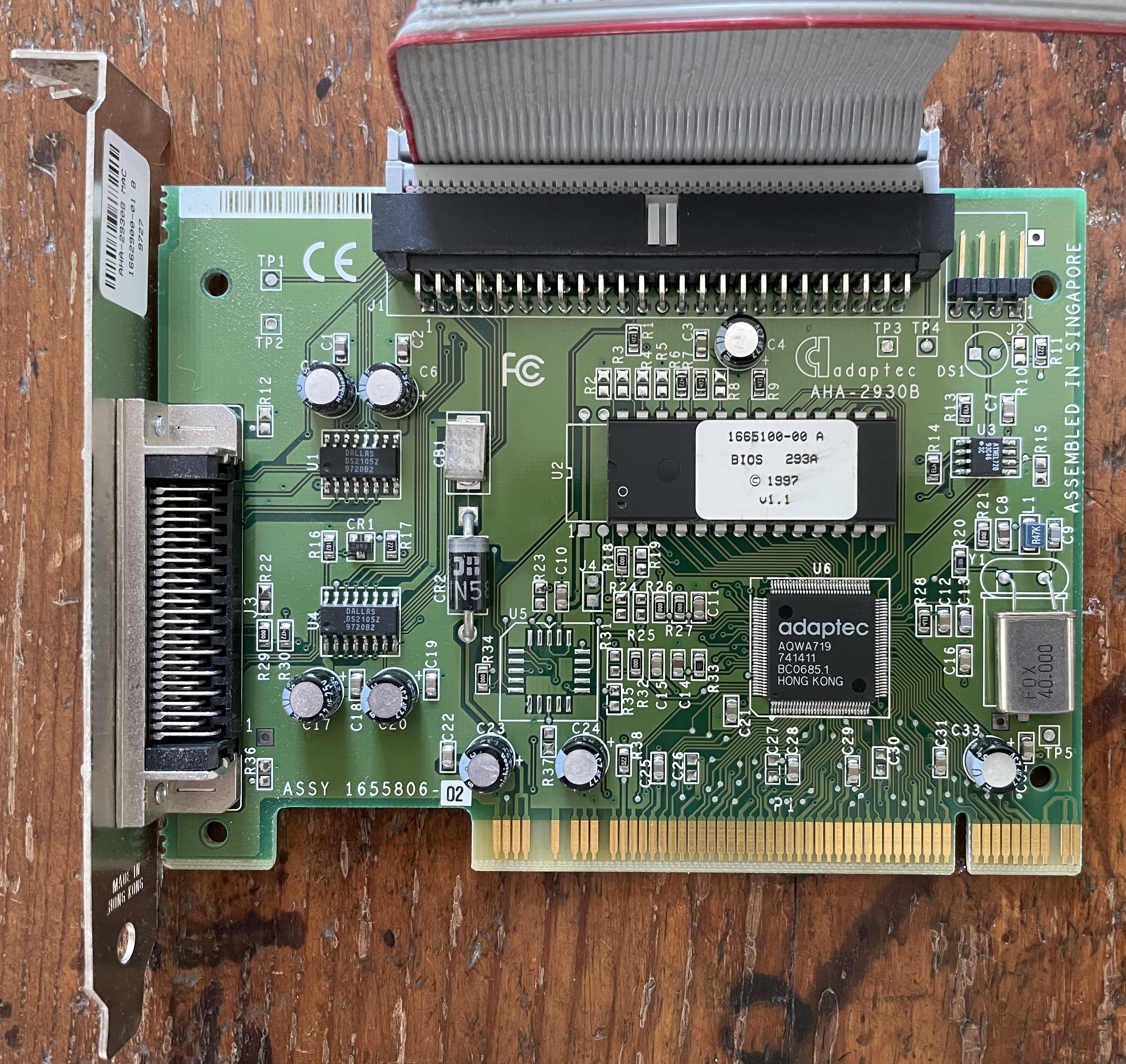

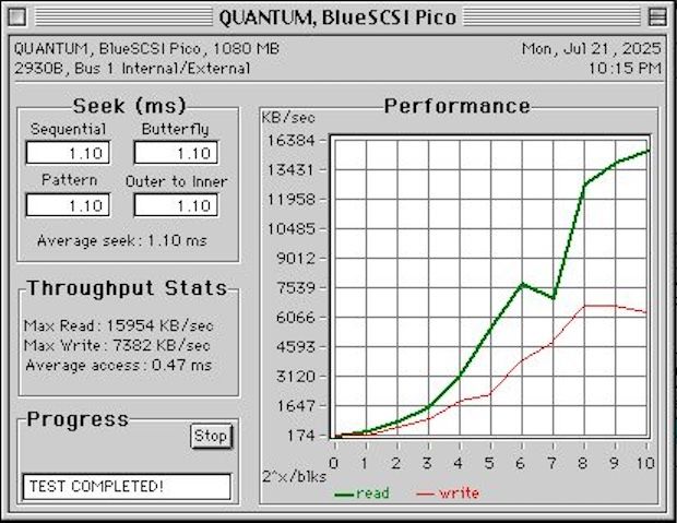

Power Computing PowerCenter Pro 180 with stock bundled Adaptec 2930B SCSI card (AHA-2930B MAC).
- Desktop BlueSCSI 2022.12a - Pico 1
- SanDisk Industrial 16GB Micro SD Memory Card Class 10 UHS-I MicroSDHC
- FWB Hard Disk Toolkit PE 2.0.6 SCSI driver
15.954MB/sec read, and 7.382MB/sec write.
For this Adaptec 2930B SCSI PCI card I needed to use an Adaptec control panel to enable "UltraSCSI". I can't find mention of needing to do that in the Power Computing docs so I wonder if the one I have was disabled in the past, perhaps for compatibility with a different drive.
This ever so descriptively named "Board Control" control panel (version 2.0.1 A, 1996) for the 2930B can be downloaded from the Macintosh Garden: Adaptec 2930BU Driver (PowerComputing). To enable (or check) the speed, open the control panel, select your card then choose "Target Options..." from the Special menu.

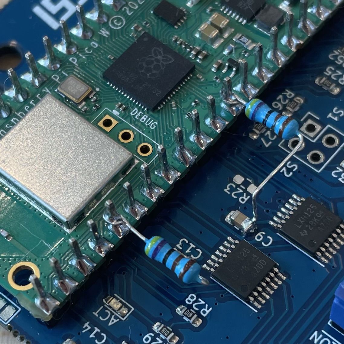

I had an unassembled BlueSCSI v2 PowerBook / 2.5 Inch SCSI 2022.11b kit that I finally got around to building (it's going to go in a PowerBook 165c I'm fixing up). I put in a Pico W in anticipation of using the DanaPORT WiFi feature and also did the "wake from sleep fix" for older BlueSCSI boards documented here:
I had some 1/4 watt resistors that I'm sure were overkill but with some careful lead bending I'm pretty happy how it turned out!

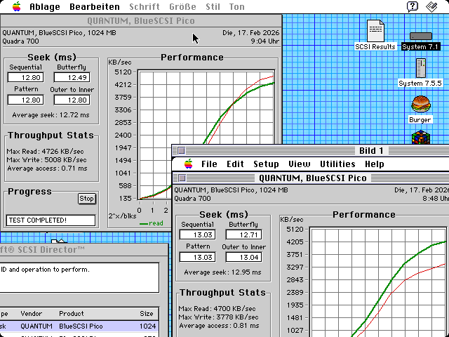

Write performance has improved a lot - not sure which version was present before though as I hadn't updated for some time. But thought anyways it's worth sharing. BlueSCSI v2 with Pico1 (left is with the latest update, on the right is the state before)
