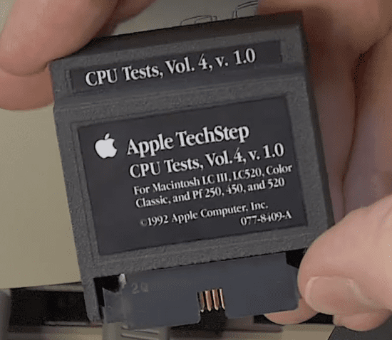

If you own a Color Classic with the stock motherboard and also have a TechStep along with the required Vol.4 Cartridge for testing the stock CC M.B., I've love to hear if you are able to perform all the tests.
I have the 84V 640x480 screen mod, which allows me to use the stock CC motherboard. However, I found I was not able to test my stock motherboard using a Vol.4 TechStep cartridge recreation. However, I also have the LC520 board and was able to use the same Vol.4 cartridge to diagnose that motherboard just fine, so I'm guessing it's probably not a bug in the cartridge recreation. It very well could be the existence of the 640x480 screen mod; but in order to find out, I need to call upon my fellow Color Classic and TechStep owners to do further testing.

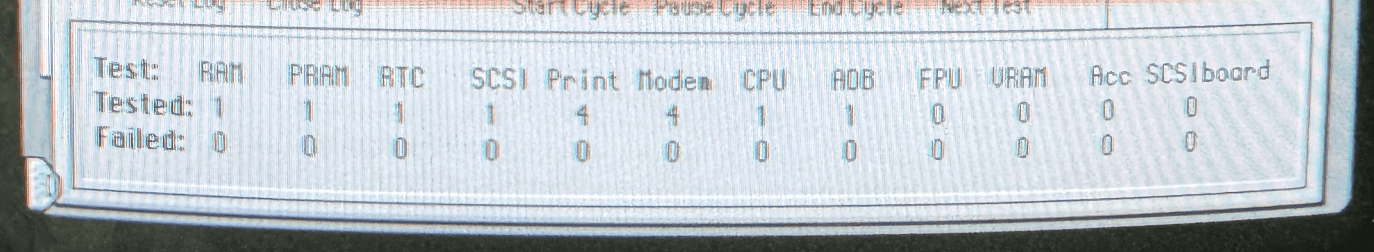

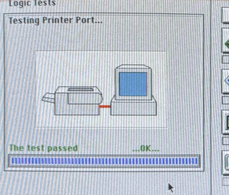

Mine works fine on a stock CC with no mods. All tests pass except for sound on my board, though maybe I just have something broken there.
Are you able to test to make sure serial is working properly, or check the -5V somehow? It did look like the TechStep was putting it into test manager fine, but wasn't able to reach it over serial maybe.

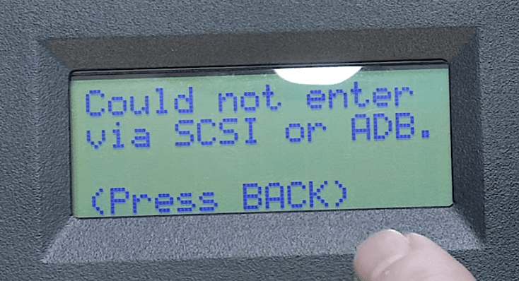

If it were serial port related, that still doesn't explain why accessing Test Mode via ADB and also SCSI didn't work in my case. If you skip to 40:57 in my video, you will see it says "could not enter TstMd via ADB." It then presents me with the option to access Test Mode via SCSI. I show myself attempting that, but it then says both methods of accessing Test Mode failed...
I know ADB works fine because when I remove the TechStep and setup the machine normally with the stock CC M.B., I can connect an Apple IIgs keyboard to one ADB port and an Apple mouse to the other, and both mouse and keyboard work fine.
You said that with the stock CC screen resolution your TechStep and cartridge Vol.4. works fine to enter Test Mode, so that seems to give strong evidence to support my theory that the VGA modded resolution of 640x480 must somehow be interfering with the Vol.4 cartridge diagnosing the stock motherboard.

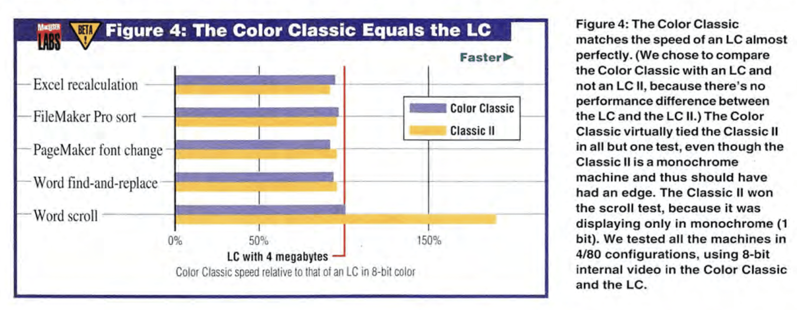

The stock CC is more like a Classic II or LC II
Indeed, and we see that in the April 1993 issue of MacUser magazine (which I subscribed to back in the day, and which later was rolled into Macworld, the digital version I still subscribe to today)...
And of course the same painful limitation...
And performance...
But how does all that factual knowledge about the similarity to an LCII help explain why my genuine Apple TechStep with a Vol.4 cartridge recreation (which tests both the LC520 and CC motherboards) could diagnose the LC520 just fine, but could not initiate Test Mode when used with the CC motherboard?

I did use an original TechStep, but I'm not sure where my original Vol. 4 cartridge is so I just built a new one yesterday. There shouldn't be much difference between the cartridges though, there isn't much going on in there.

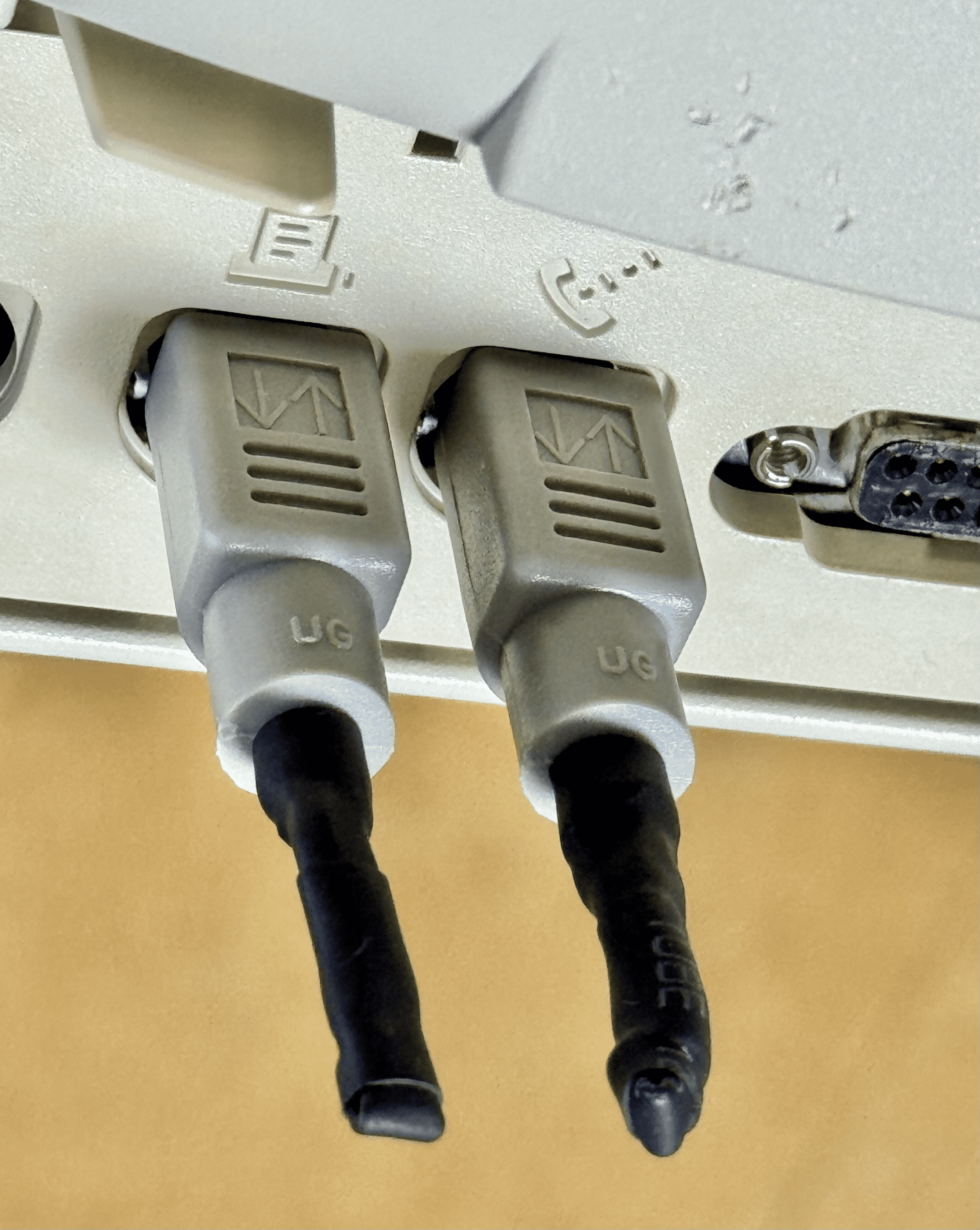

I have a stock CC and a TechStep replica. At first, it didn‘t want to enter test mode, but I had just one ADB cable attached. When I tried with two ADB cables, it worked with no issues. All logic tests passed.
