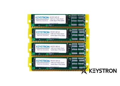

@LongAlphabet, right. The more RAM, the more options software wise. Can even do a RAM disk. :sneaky:
The IIci is already 32-bit clean, so no Mode 32 INIT is needed. It can access 128 MB of RAM just fine. :) As for the 30-pin non-parity RAM SIMMs, I get mine from Keystron:
