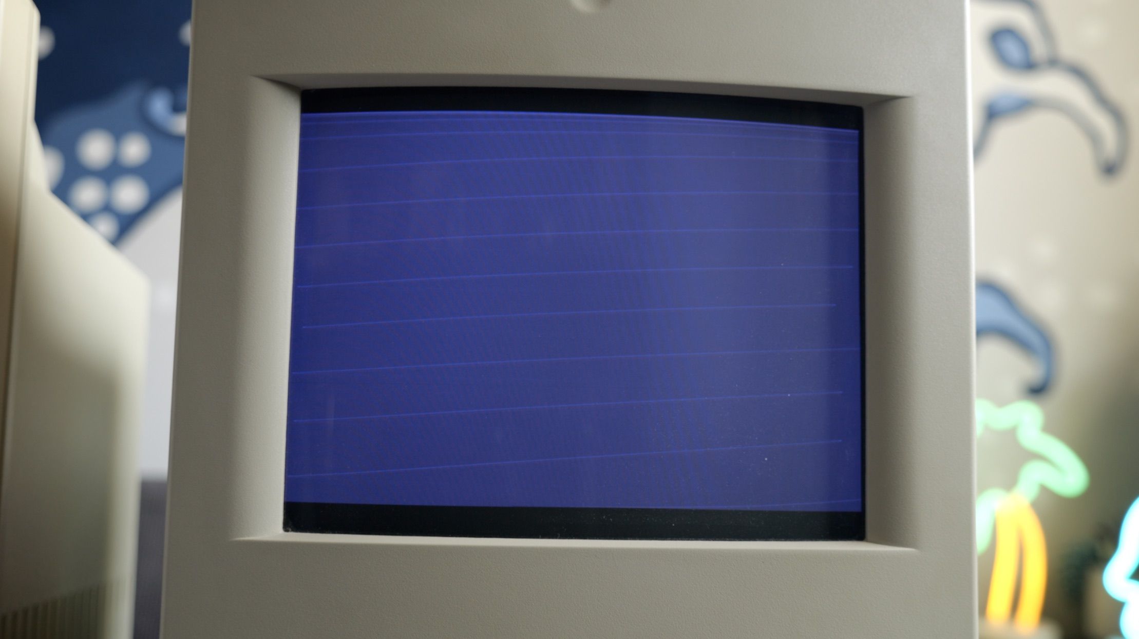

Okay, that is quite different than what I was thinking it was. That doesn’t really look like the board is even starting to try booting into the ROM at all. My version of the grey screen problem looks like this……

I've experience many (most?) of the problems of this thread, AFTER a full recap of both boards. The best way i'll show it is with some footage.
I also have a LC550 board but that didn't insulate me from having similar problems.
