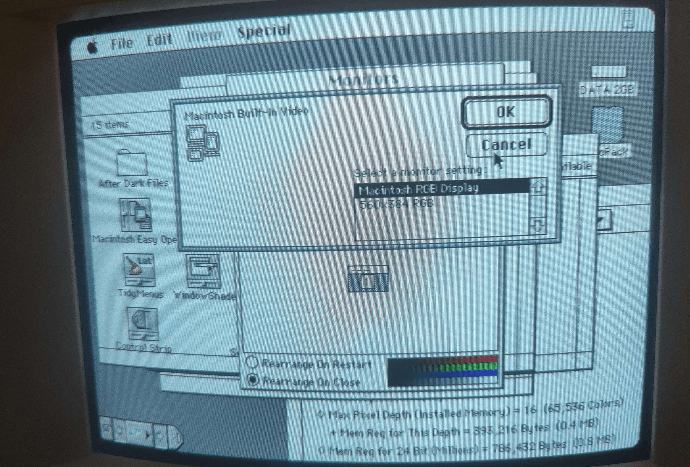

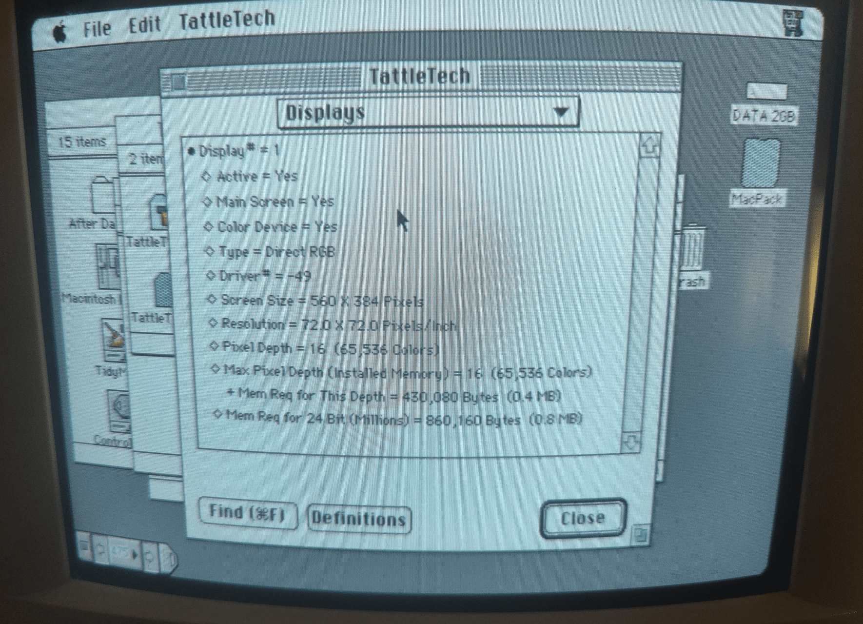

I am currently filming a new video about the Apple IIe Card in my Color Classic Mystic. As many of you know, I performed the VGA mod on this CC earlier this year, which boost the stock resolution of 512x384 to 640x480. Smaller pixels means everything is smaller, but the upside is you can run many games and other apps which require VGA as the minimum resolution. Even so, aging eyes line mine prefer larger pixels, and I always thought it would be neat if we could switch back to the stock 512x384 on the fly.
One thing I have learned in my testing of the Apple IIe Card is that it switches the CRT screen resolution to 560x384, regardless of whether you have the stock 512x384 or the 640x480 mod! The IIe Card proves it is possible to switch resolutions without having to hack anything on the hardware side. I don't think the IIe Card has any video control circuitry on it, and instead it is just sending some kind of command to the Mac to perform the resolution switching. Would any of you know if that command is something hard coded in ROM?
I'm just trying to brainstorm about whether it is possible to use the same trick to alter the resolution to something else, such as going from 640x480 to 512x384 and back. It would be SUPER NEAT if that was possible!

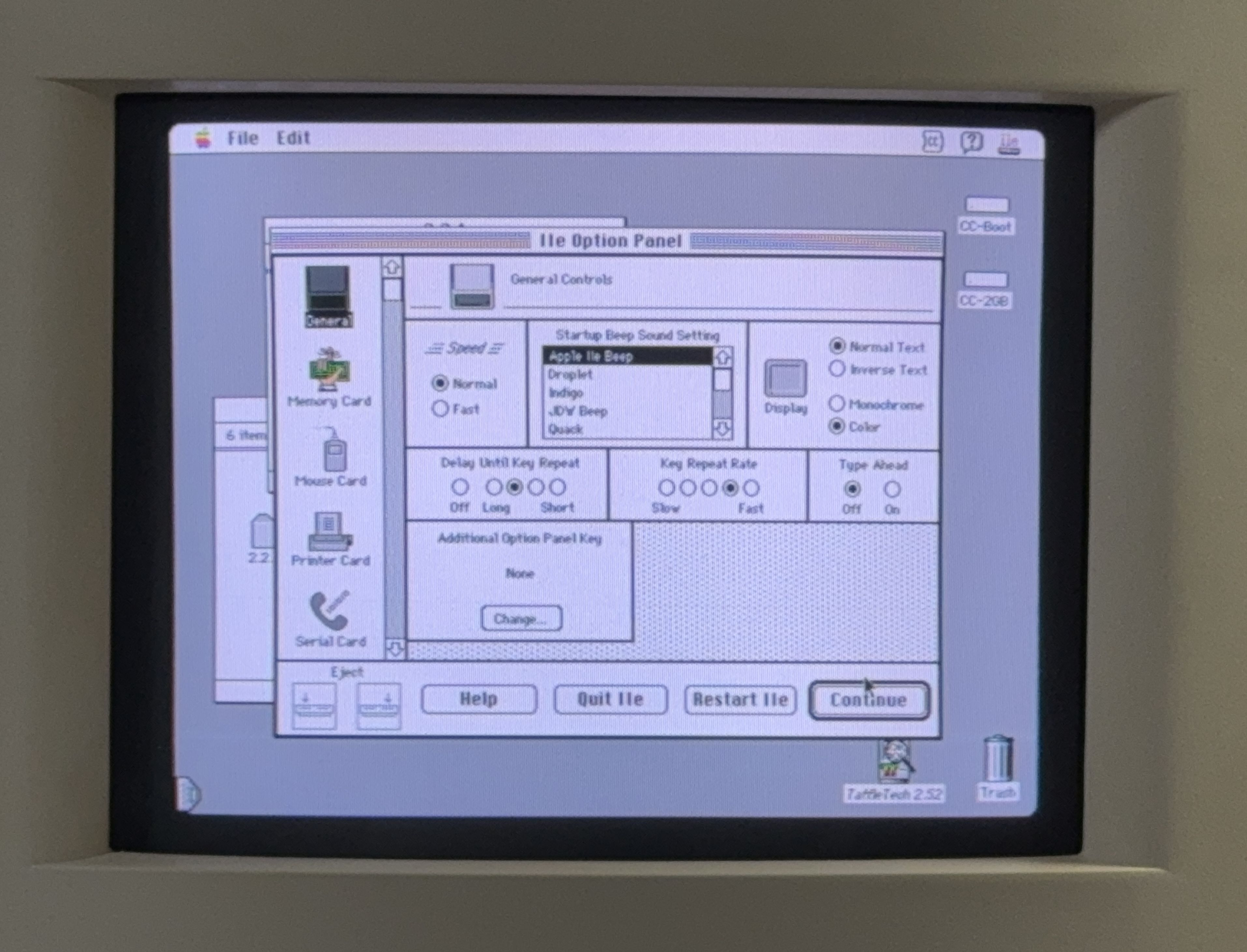

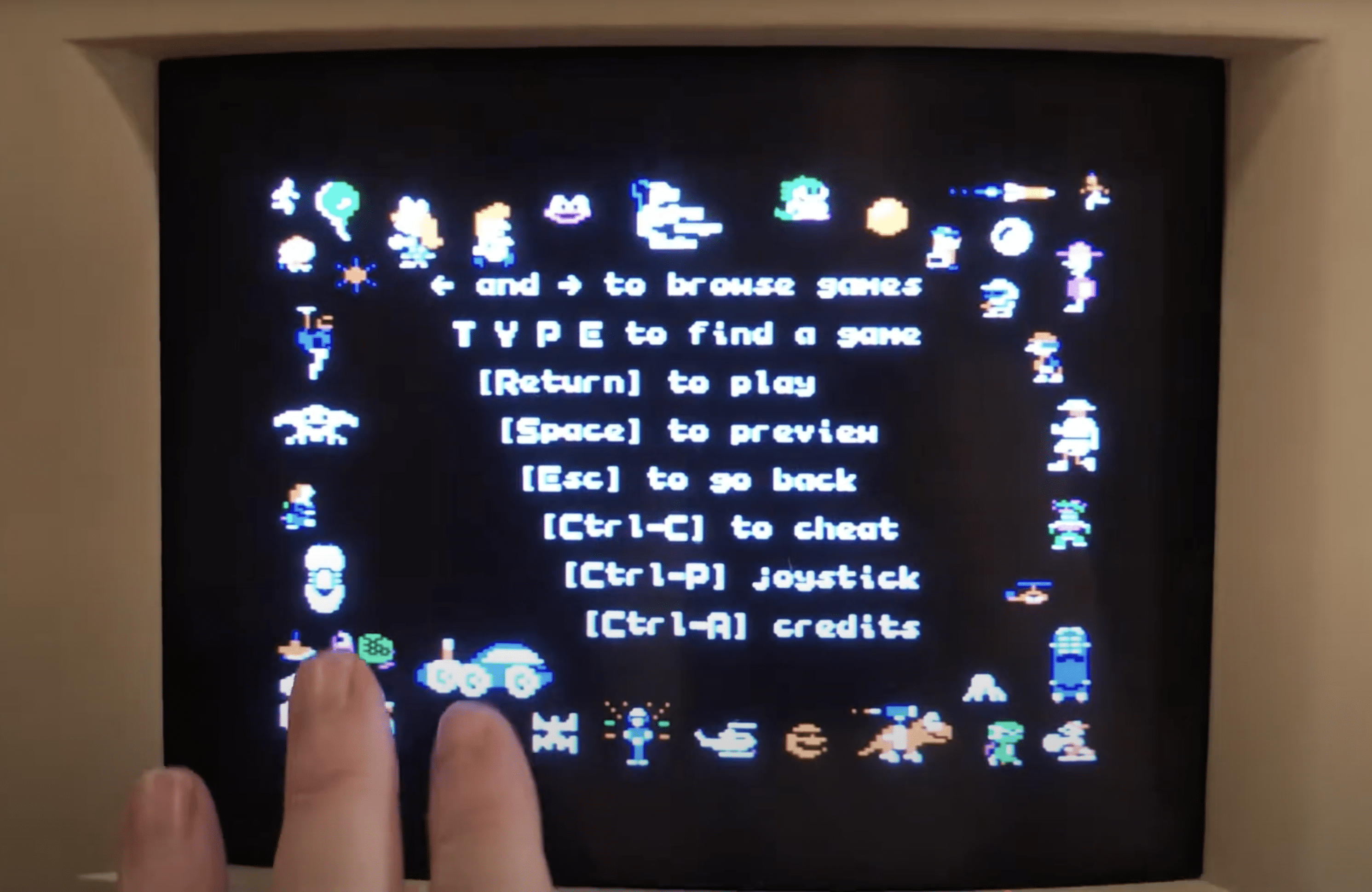

Now that I've done the 84V Mod, I can answer my own question.
I only did a single test with the IIe Card installed on the stock CC motherboard, and the Mac's resolution is now 640x480 with the 84V mod. But for reasons unknown, the left/right black borders are thicker than when I have the LC520 or LC575 boards installed. Meaning, I installed the 575 board initially and made my CRT adjustments so the black borders all around were between 5-6mm thick. But then when I put in the CC motherboard, those borders thicken to be like this...

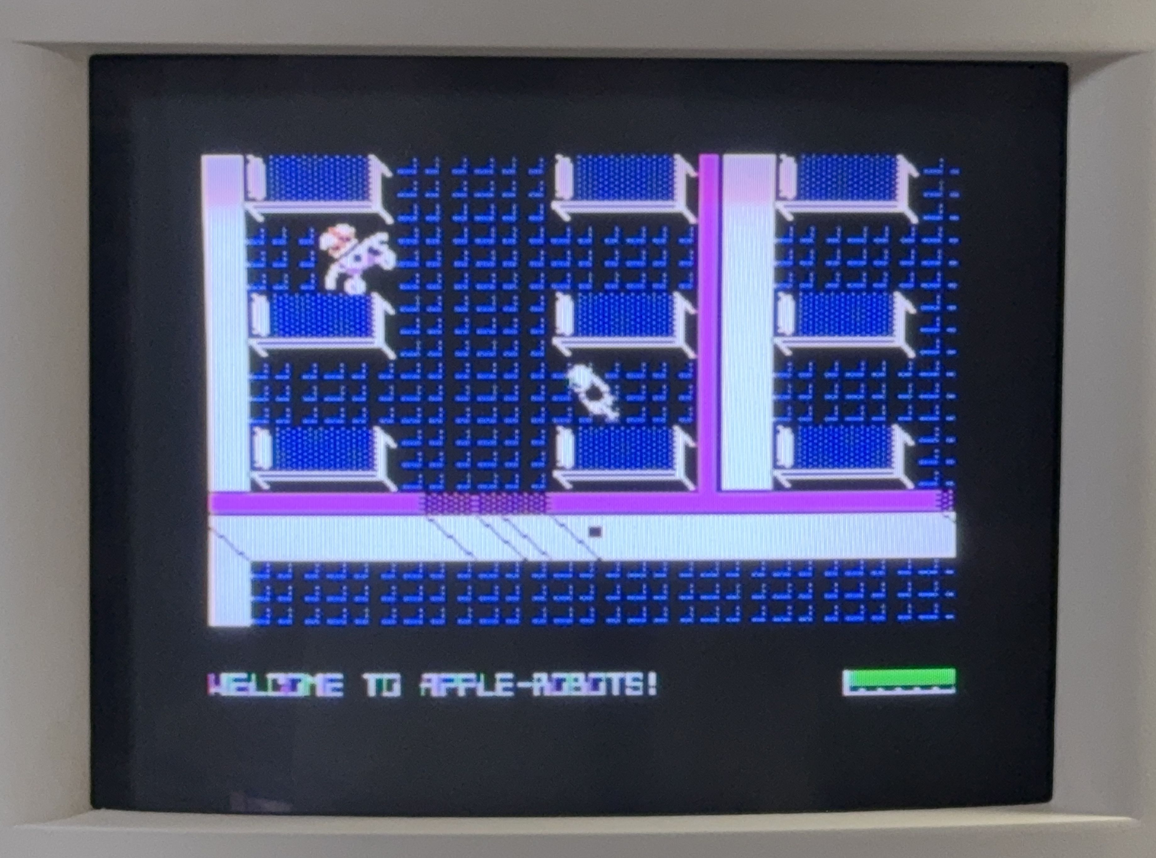

And when I enter IIe mode (A2robots game), the resolution does change to 560x384, but with even thicker borders all around as shown below.
But the borders were thick even when I had the 68.4V VGA Mod and used my LC575 Board with the IIe Card...
Border thickness aside, resolution switching does indeed work when using the 84V mod.

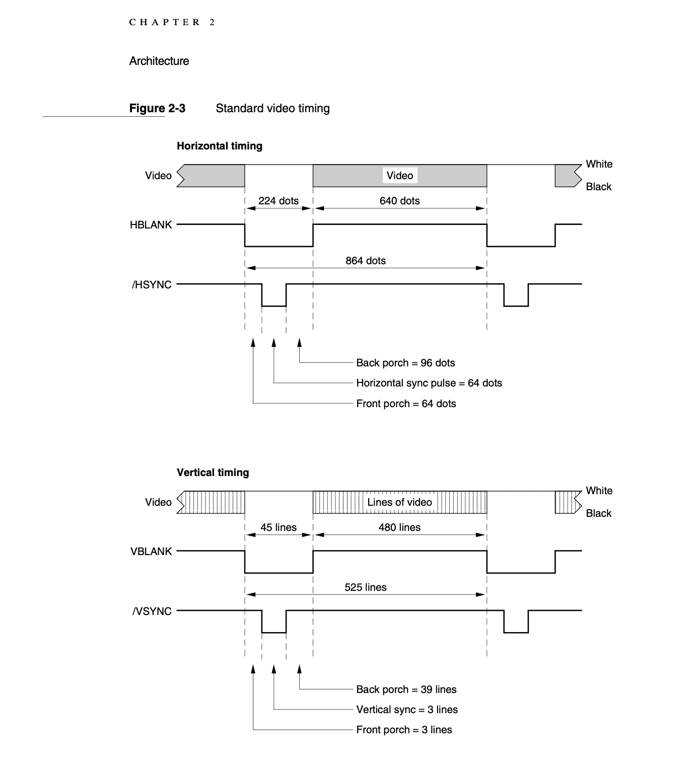

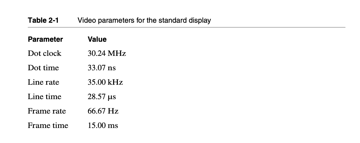

After going back into the Apple Developer Notes for the IIci, LC, LC III, and LC 520, I discovered something I overlooked when doing that research: the timings for the 640x480 67 Hz mode are different on the LC! The LC III and LC 520 match the IIci with the following specs:
Dot Clock: 30.24 MHz
Dot Time: 33.07 ns
Line Rate: 35.00 KHz
Line Time: 28.57 microseconds
Frame Rate: 66.67 Hz
Frame Time: 15 ms

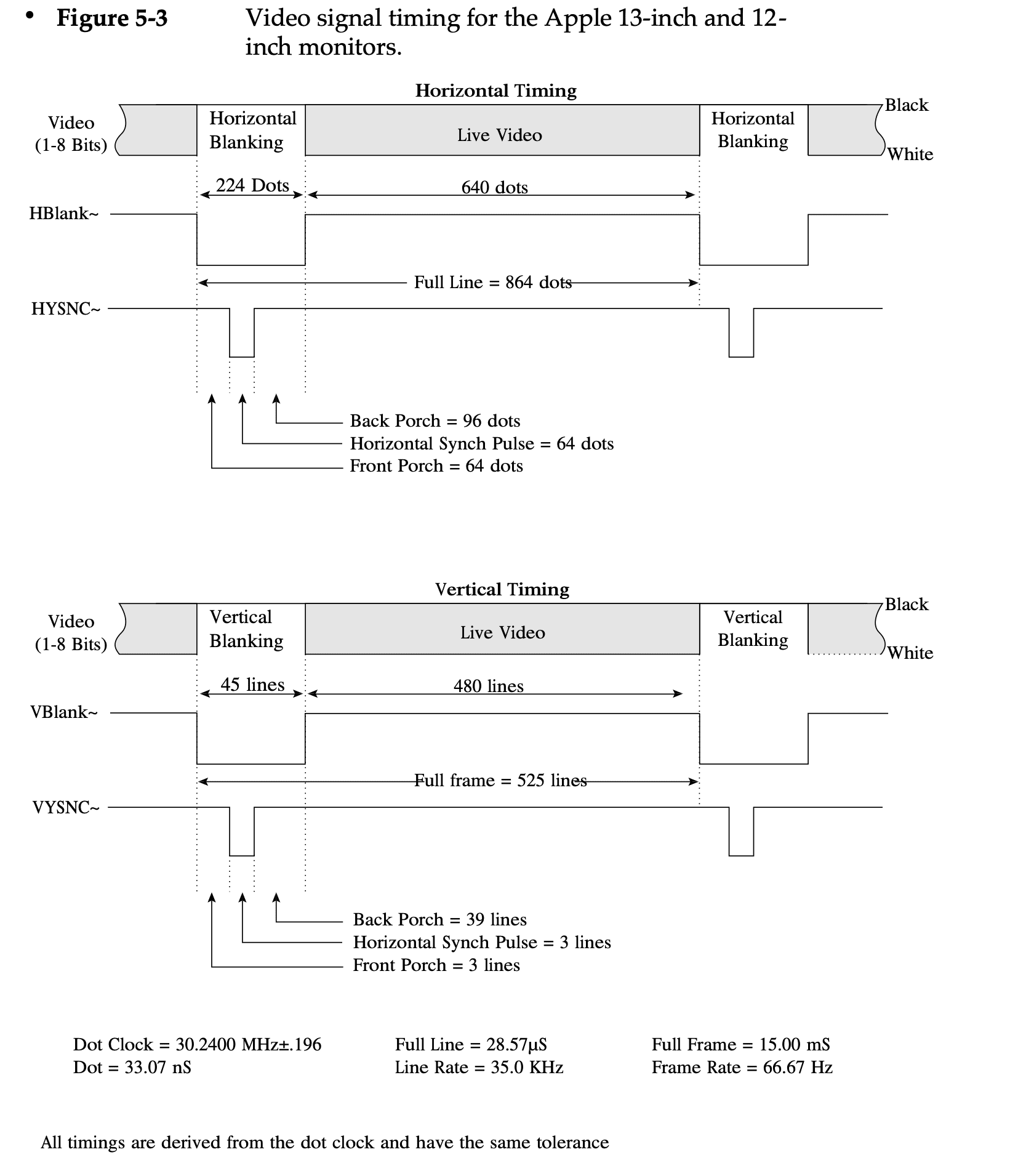

Here's the diagrams:
IIci:
LC III:
LC 520:

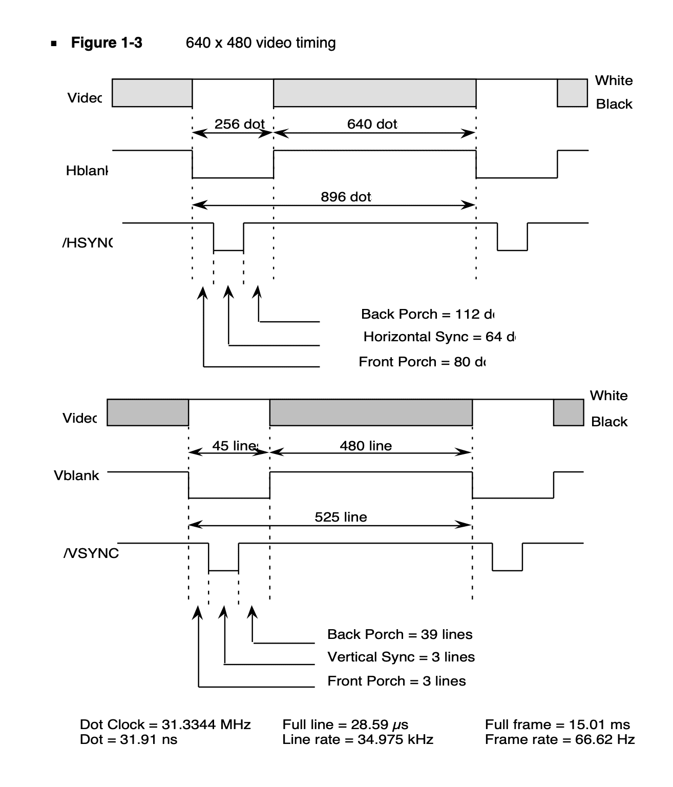

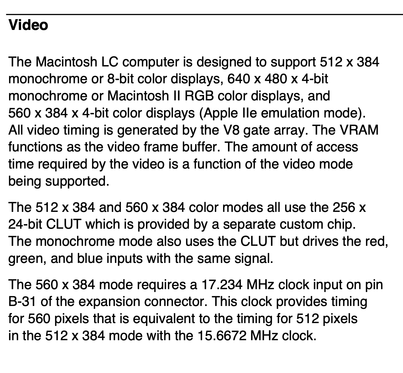

However, the LC / LC II is clearly different. Although there is no Mac TV dev note and the Color Classic doesn't mention 640x480 mode, I have a hunch that their timings match LC / LC II based on what we've observed.
Dot Clock: 31.3344 MHz
Dot Time: 31.91 ns
Line Rate: 34.975 KHz
Line Time: 28.59 microseconds
Frame Rate: 66.62 Hz
Frame Time: 15.01 ms
Based on these timing diagrams the difference in geometry we're seeing when using a Color Classic or Macintosh TV logic board in a Hook chassis versus versus an LC 520/550/575 board makes perfect sense. The horizontal blanking interval on the LC / LC II / Color Classic / MacTV is longer, resulting in the image being shifted over to the right. Conversely, using a LC 520/550/575 board in an 84V modded CC will result in the image being shifted to the left.

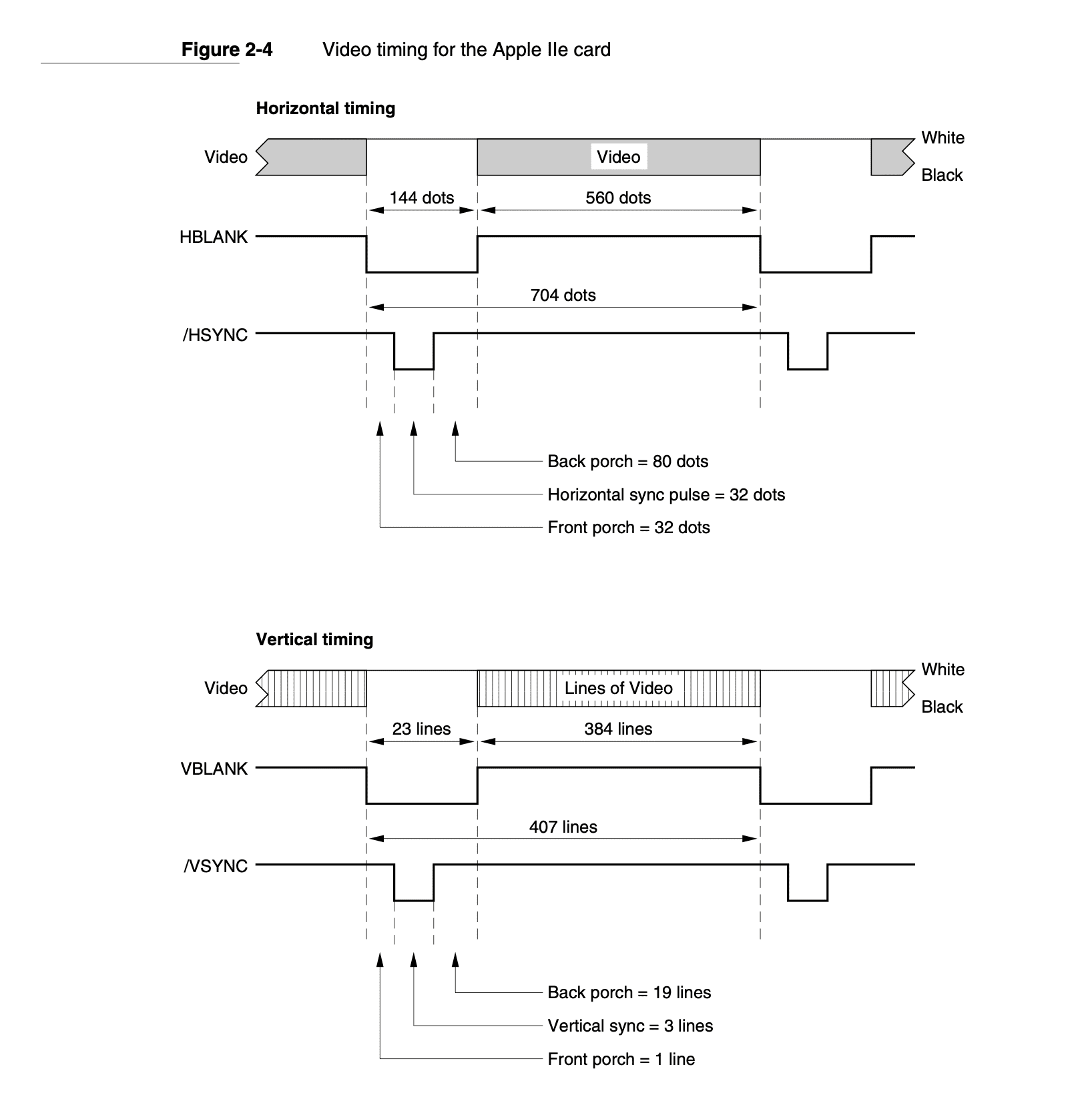

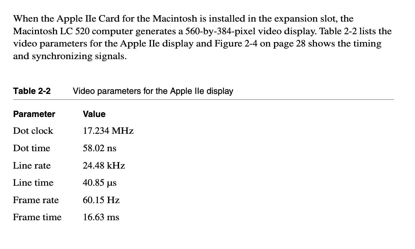

Now we're on to the next bit: the quirks of the Apple IIe card's video modes. The computers that are compatible with the card all have slightly different handling of that mode depending on what monitor (or all-in-one) is used.
LC / LC II / LC III / Color Classic / LC 475 / Quadra 605 with 12 inch RGB monitor: special 560x384 60Hz mode. Note: When the IIe card is used in the LC, LC II, and Color Classic the timing signal for this special mode is generated by the IIe card itself and transmitted over pin 31 of the PDS slot. This signal ignored in the LC III and later because the IIe video timing is generated by the Sonora/Andberg/MEMCjr ASICs.
Color Classic / CC II / LC 520 / LC 550 inside a Color Classic: special 560x384 mode (same as 12 inch RGB monitor).
LC 520/550: Apparently the Apple IIe mode on these machines is supposed to switch to an actual 560x384 60 Hz mode. I don't have a IIe card to test this. It won't take up the whole area of the display; it would be a bordered mode (similar to what JDW saw in his video). I'm wondering if this is an error, given how other headless LC machines operate with 640 x 480 67Hz monitors and Apple IIe cards, as we'll see below. But I am curious.
JDW, can you try the combination of LC520 board with Apple IIe card in your VGA modded CC and see what happens? I don't recall seeing you post it here or in the video. I'm curious if it behaves differently than your LC 575 board with Apple IIe card.
LC 575: Unlike the 520, the 575's tech note specifically declares that it uses the standard 640x480 67Hz mode but displays the 560x384 mode in the middle of the display.

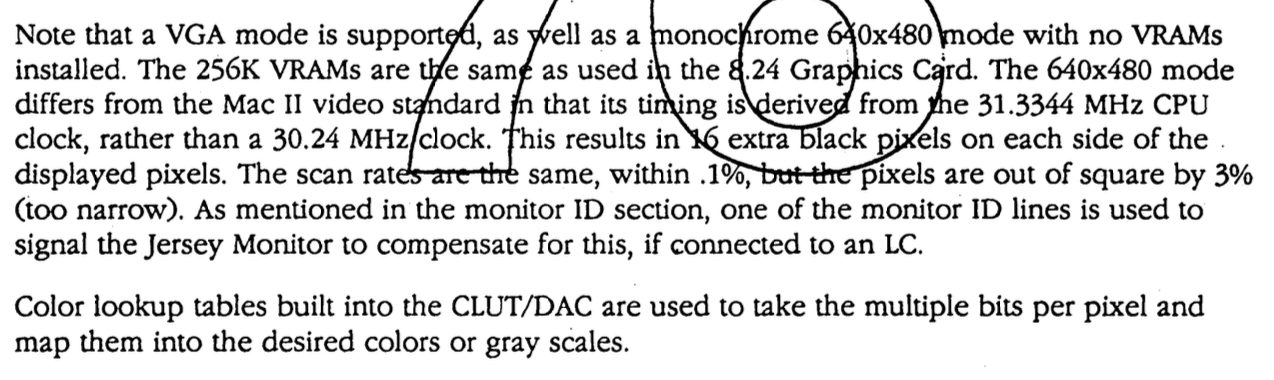

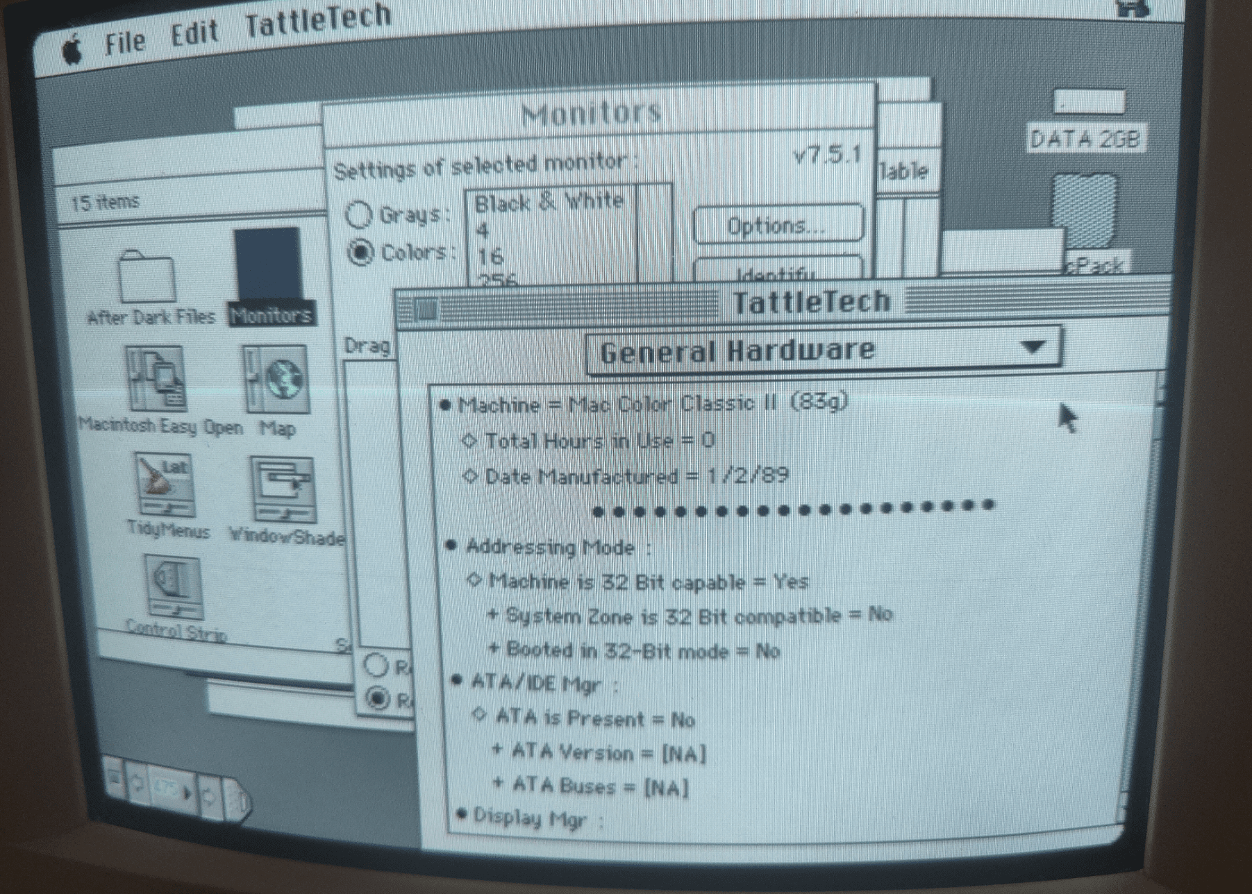

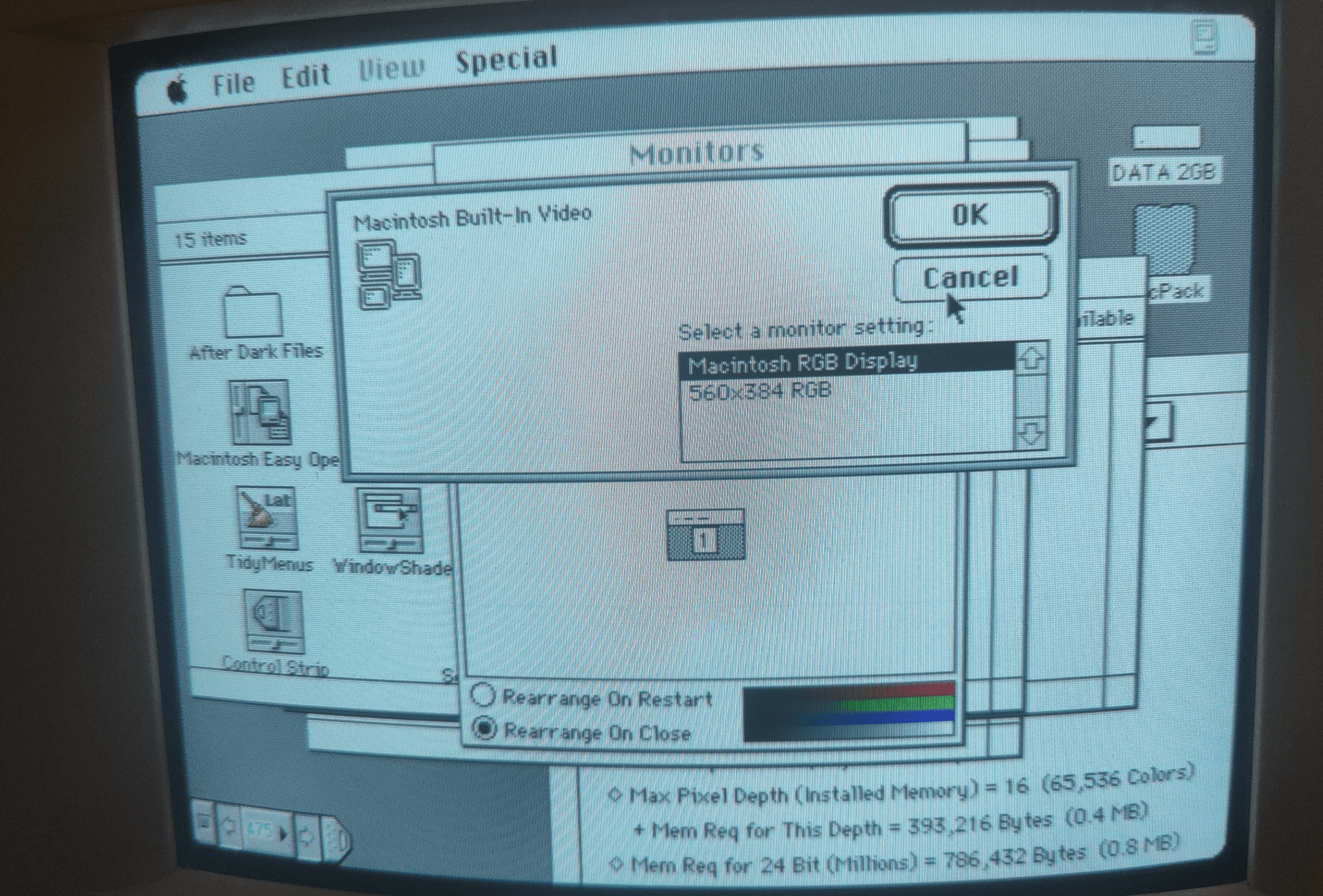

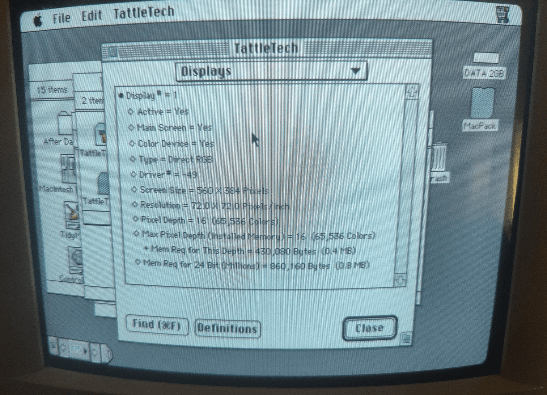

Bumping because I'm working on a color classic video myself, and I noticed that when I have my (unmodified) LC 550 board installed my CC I can set the monitor to 560x384 in the Monitors control panel. I had System 7.5.3 loaded at the time. Its slightly squished without a geometry adjustment but it does work. The original CC board still doesn't expose it under system 7.5. I have a hunch that this is because of the 520/550's LC III roots—the LC III's developer note does mention 560x384 as an available standard output mode. So if you want slightly more horizontal res and a slightly squished display, Color Classic II owners (or folks who put in a 520/550 board) can switch to the 560 mode.
Incidentally, don't insert a Macintosh TV board into an unmodified color classic. While an original Color Classic logic board will work at 640x480 in a Mac TV or other Hook chassis just fine, the Mac TV board apparently doesn't connect the sense lines for 512x384 to the edge connector, and it's stuck at 640x480 inside a CC! The display is very ugly, but still readable enough to shut down (and check the monitor control panel to see if I could manually change it. I could not).
Also, to update on the timing difference between the LC II 640x480 and the LC III 640x480 timing, it turns out this is because there's a difference in how the LC systems derived their dot clocks versus the Mac II. From the 1991 Apple Macintosh Hardware Overview document:
The LC / LC II use the 31.3344 MHz CPU clock to derive the timing instead of a separate 30.24 clock. This results in the extra black pixels seen in the timing charts and why the CC board is "wrong" inside of a Hook chassis (and vice versa). Apparently the Apple Macintosh Color Display M1212 RGB monitor (I believe that's the Jersey monitor mentioned) compensates for this difference somehow.
This timing difference was abandoned with the LC III and later LC Macs. Only the LC, LC II, Color Classic, and Mac TV have the extra black pixels.
