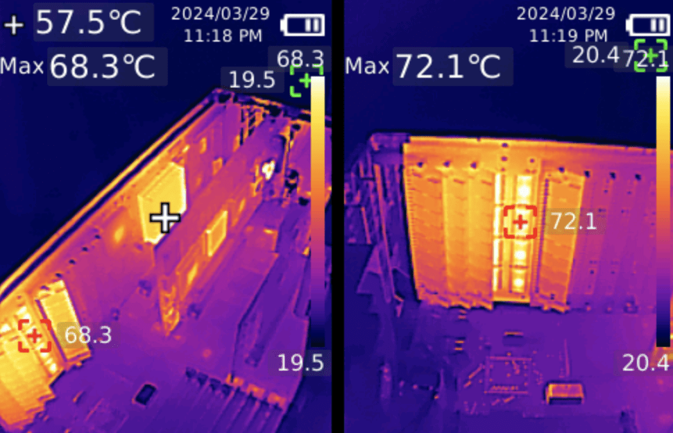

What you really need is a thermal camera. Then you can leave the back case off and check temperatures inside.
I have a UTi260B, and here's how the inside of my Mac IIci look when I check its Radius Rocket card:
The downside is they are a bit expensive, even if you get the iPhone attachment kind.

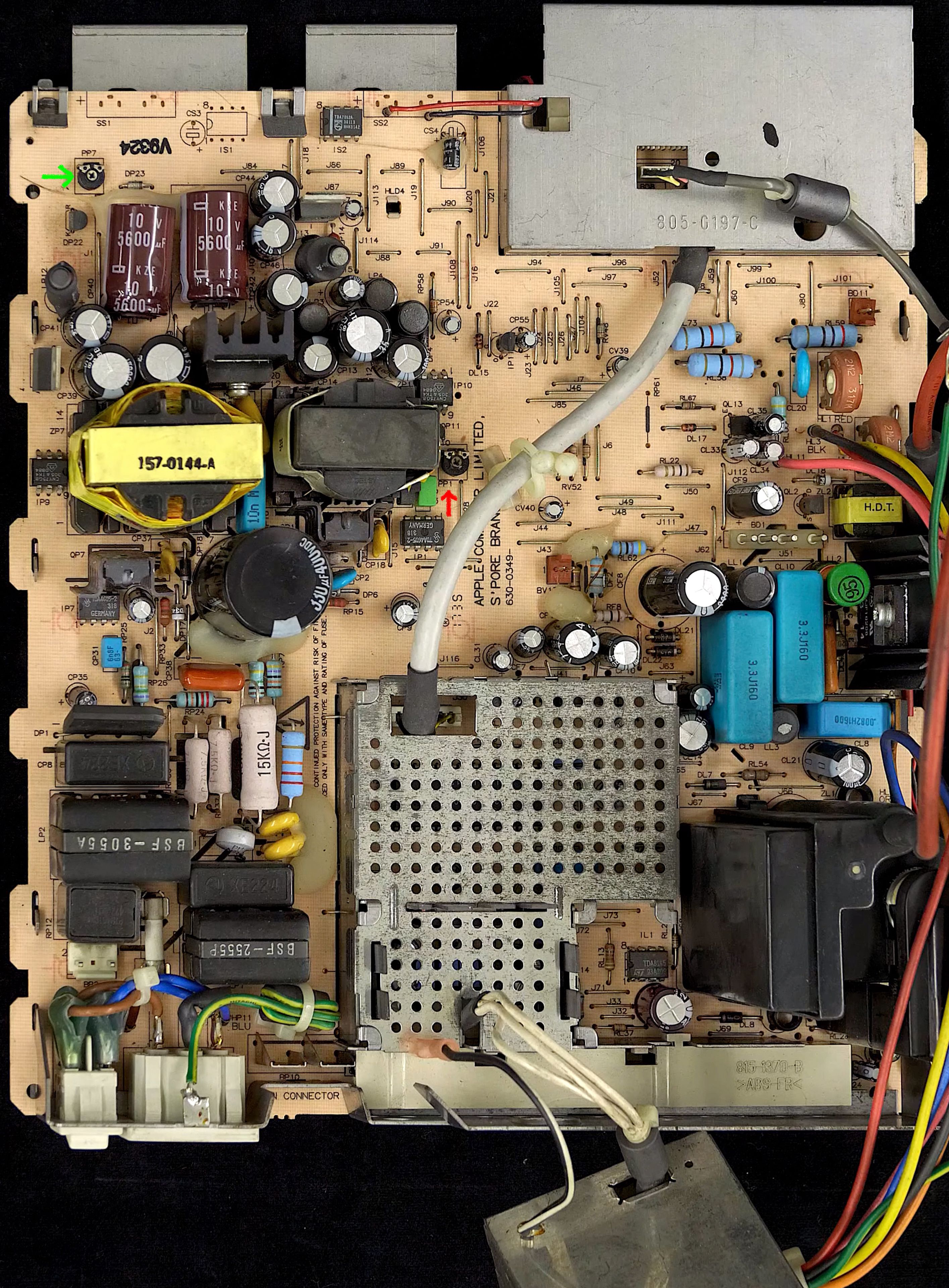

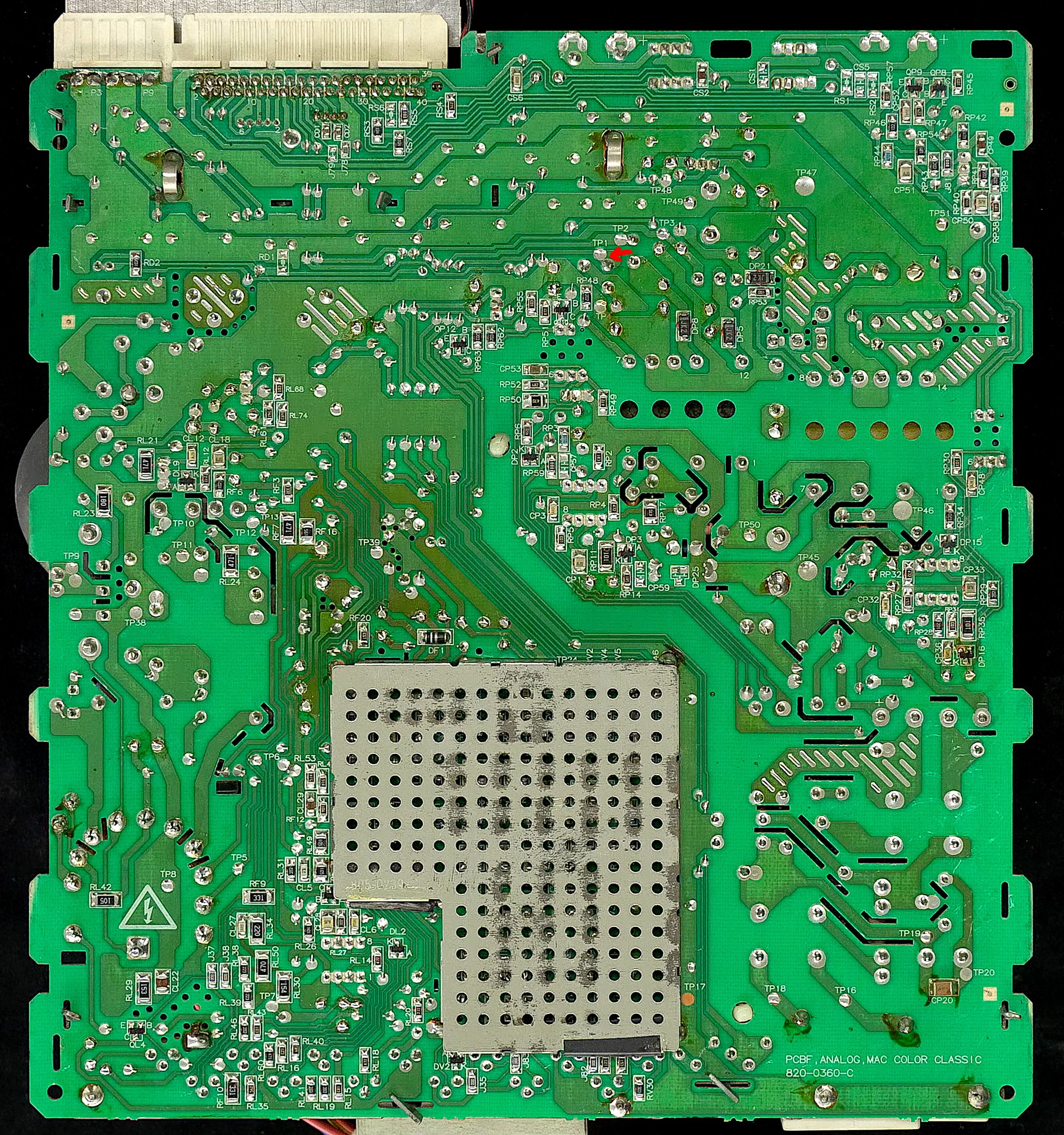

I found out where TP1 is and what it's connected to, so I can measure it from the top of the board.
I'm assuming I would measure between TP1 and say metal shielding that's connected to the ground? Would I be looking for 68.4V DC or AC here?
I want to check this because even though the computer now can seemingly run for hours, it eventually does shut down on its own. Yesterday it was running two rounds for three hours each (with a brief manual shutdown in the middle) but eventually it shut down on its own. I guess even if it stays like this, I'll take it as a win. I doubt I'd ever use the CC for more than an hour or two at a time.
*edit* So I measured 70V DC between TP1 and ground while there was a picture on the screen, and 84V for a brief period right after the bootup where there was still no picture on the screen. I guess that seems normal, so I probably shouldn't touch PP1 pot.

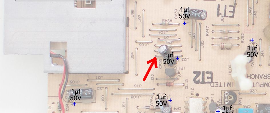

For the sake of people who later find this thread, below is crystal clarity as to where TP1 is located on the bottom of the Color Classic's ANALOG BOARD (marked with red arrow)...
... I probably shouldn't touch PP1 pot.
Again, for clarity I have marked PP1 with a red arrow below...
(I also marked PP7 with a green arrow.)
That's where it is, yes. I have found that it leads to J23 jumper lead on the upper side, and measured between there and the metal cage, while the computer was running:
