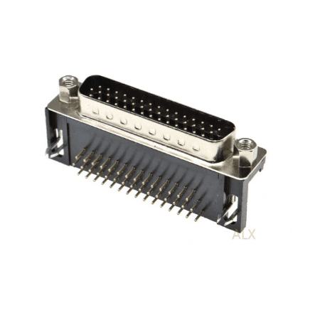

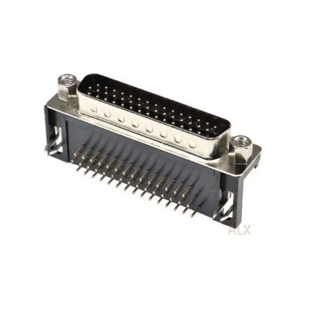

Worse comes to worse can do something funky like add a db37 female connector to card and then put the esp32 on another card you connect with a male db37 connector:D
https://www.aliexpress.com/item/32972036701.html
Or yeah antenna... but that's not as fun.

How many pins of the esp32 module would you need to use? I'd still be tempted to design it with the module on a dongle or daughter board and use a connector like this:
Logic being that the card won't have anything sticking out besides connectors when installing into the computer. More importantly you'd be able to change the ESP module with different ones without having to modify the main board. You'd just have to make a new daughter board.
Downside is that it adds a few dollars to the cost of making the board.
Maybe it only makes sense on a dev board?
Oops sorry, I didn't directly respond to your point about the connector. The issue is sort of a long distance vs. short distance bus problem. Actually for 80 MHz operation, the ESP32 is as far away from the NuBus interface as it can be. Signals on a PCB propagate at about 0.16 nanoseconds per inch. The ESP32 is about 6 inches away from the shift registers, so that's 1 nanosecond of delay, and then another nanosecond of delay for the data out of the shift register to come back to the ESP32. 80 MHz corresponds to a 12.5 ns period, so 2 nanoseconds extra wiring delay for the clock to go to the 74xx chips and then the data out to come back is really significant. That's why I had to add the final pipeline stage at the end, to cut down on the clock-to-output delay as much as possible to make room for those two "wasted" nanoseconds going across the board.
It's really interesting how different buses solve this problem. As you approach 100 MHz, the physical size of the bus starts becoming significant even in a microcomputer system. The "radius" of a 100 MHz clock is like 5 feet. At these combinations of size and speed, you don't have system that can be considered to be all in the same clock cycle at the same time. A related topic is the DDR memory concept. Now DDR5 is going at 6.4 GHz. Multiple bits are in storage on the bus going to the RAM. The CPU is "ahead" of the RAM by several clock cycles, and it's sort of indeterminate how many clock periods of delay are consumed by the interconnect delay. Thus the RAM chips have to send a buffered version of the clock, called the data strobe, back to the CPU in order to properly frame the bitstream coming back on the data bus.

Was thinking of plugging directly to the back of the card like:
But yeah. Just did a quick check of the physical size of the connector with relation to the card and don't think it would even fit with the USB, micro sd and HD44 connector side by side. With a normal Nubus bracket you only have around 74-75mm of board space. RIght now in that image it's taking like 80mm.
The connector itself would add roughly 25mm or 1" of length to lines going to the esp32.
Basing dimensions of the connect from

It would probably be better to move the JTAG, microSD, and USB interfaces onto the dongle board. Then all that needs to go through the connector back to the NuBus card would be power, SPI, and the few utility signals.
But is it worth it? It’d be stronger and the rear panel design would be more professional, as opposed to just a board sticking out the back. On the other hand, the dongle would take up a lot more room behind the computer than just the board sticking out, so it might not fit in all the places that people are currently putting their Macs. Also having the dongle would mean we would have to use a "real" metal rear connector bracket, though of course that would be more professional.
What’s the biggest benefit of the dongle design? Is it the sturdiness and professional appearance compared to the a peninsula of board sticking out the back?
alxlab
287
312
www.alxlab.com
I was assuming there would be a bracket regardless of whatever design is used. A metal bracket would be really awesome. I was thinking of designing a reference Nubus/PDS bracket for 3D printing which would be cheaper to make.
I'm not too familiar with the designing and cost of producing stamped metal stuff. Anyone here with experience in that area?
I agree that having something stick out of the back of the wifi card can be a problem. If I wanted to go for a strictly professional appearance for a production wifi card I would probably focus on adding a antenna to the back of the card.
To me, the biggest advantage of the dongle / daughter board design would be mainly for development and testing purposes. I wouldn't use a connector, dongle or daughter board for the finished product.
On a dev board, the connector would let you test out different ESP32 modules / or maybe even other completely different modules with just replacing the dongle/daughter card and not the whole board.
A header or zif socket could probably be used to the same effect on the peninsula design, be cheaper, but would look less professional A header or zif could also be used on the card itself to attach a daughter board but then you would have to open the computer to swap.
I wouldn't consider it more sturdy since it's a removable part. Wonder what would happen if the ESP32 dongle was remove with power on? 😂
I guess what I'm basically suggesting in the end is the design a professional looking nubus to spi dev board instead of just a nubus -> spi-> esp32 board lol
From a design perspective this might not be possible. You've already mentioned the timing and such. Just getting exciting seeing the potential :)

@alxlab Hmm I have two ideas that should satisfy your desire for attaching SPI peripherals.
Keep in mind, the SPI-to-NuBus bridge is designed to connect to master devices on both sides. So the Mac addresses the bus bridge and then the bus bridge is accessed by the ESP32 to get the data out. So you can't really hook up an SPI slave peripheral such as an SD card, flash chip, accelerometer, etc. directly to the bus bridge.
What you can do with the current design though is sort of piggyback off of the microSD slot. microSD cards are SPI slaves and there are microSD breakouts that you can buy, or make your own:
So you make your peripheral microSD-shaped on one end or connect your desired peripheral to an off-the-shelf breakout, then you reprogram the ESP32 to do whatever you want to the SPI slave in response to a command from the Mac.
As for switching the WiFi module, I don't know if it would pay any great dividends to use something other than ESP32 now or in the near future. ESP32 is just so good! There is the new ESP32-S3 with Bluetooth 5 and more I/O but it also costs more. The good news about my design though is that the footprint can support both the ESP32-WROOM and the ESP32-WROVER modules:
