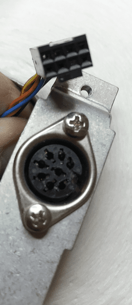

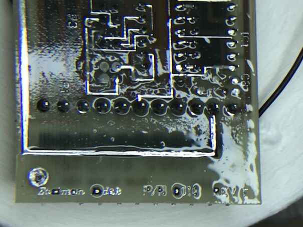

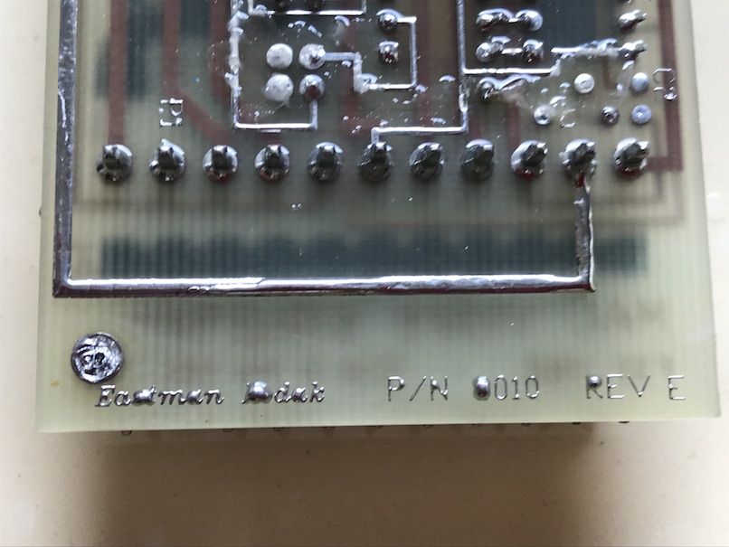

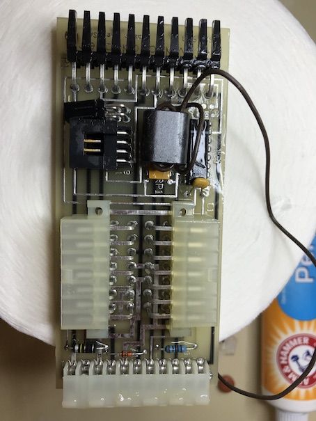

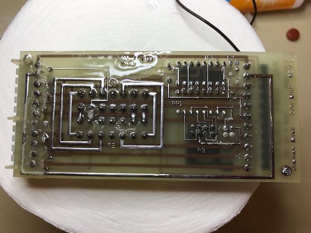

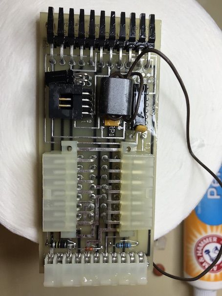

@Stephen, in June of this year, someone sent me some photos of a board he found inside his SE, which somewhat resembles your photos...
He said it clipped onto one of the LS245 chips...
He has no idea what the original function was, and there doesn't appear to be any info on it when Googling.
Any thoughts?

Here's what Elfen had to say about it at 68kmla:
There used to be an LCD Panel that you put on an overhead projector to project the Mac Screen onto a larger screen, it was for the 128K - Plus and SE Series Macs. That is the adapter for that LCD Panel. It goes onto the mother board and the analog board plugs into it so you wont lose the original video, and then a third cable comes out of the case to the LCD Panel.
The Bd of Ed used to have hundreds of those but stupid teachers would always drop and break the LCD Panel!!!
View attachment 1344View attachment 1345View attachment 1346View attachment 1347View attachment 1348
Any thoughts?
Simple TTL video adapter for the 128k/512k/Plus/SE(&30) for Kodak Projectors (specifically the Kodak Datashow).

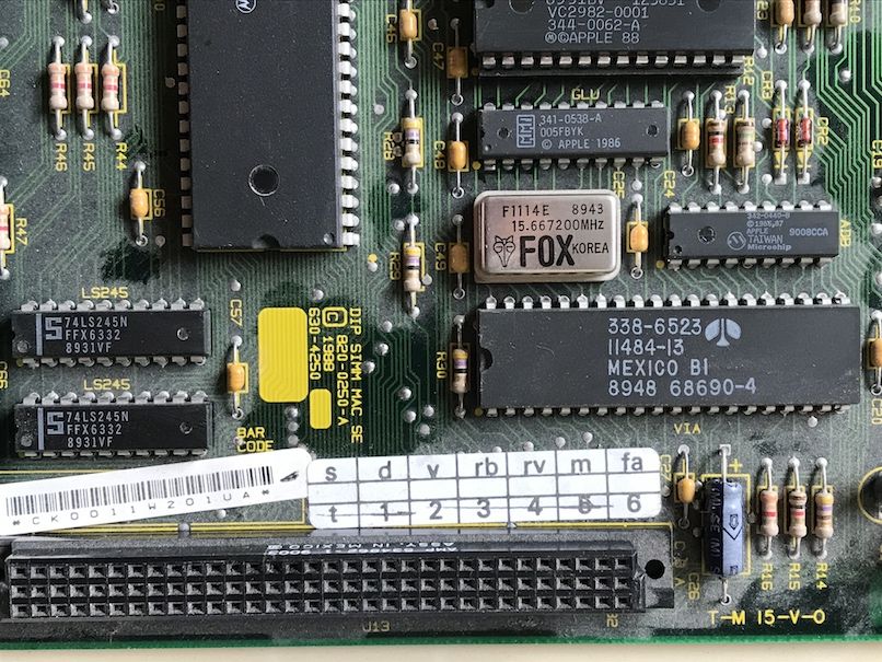

Thanks for the answer. You have shown the solution for a Macintosh Classic. I think my Mac Video Adapter FSI 1988 was installed in a Macintosh SE. I found a blurry photo on the net. There is a clip at the end of the white wire, this is probably connected directly to a chip.
But to which one and to which pin?
LG Rappi
Rappi
Jan 1, 2022
Thanks for the answers.
I have now searched further on the internet and my current knowledge is that this plastic part
is connected to one of the LS245.
After quite a deep search I have also found the associated plastic part. This fits exactly over 6 pin (3 left / 3 right). One of the middle pin has a metal connection to the white wire.
Now the only question is, which pin must be connected there? Can it be that PIN 19 is connected?
Is the clock tapped there? Or do you have another idea?
LG Rappi
