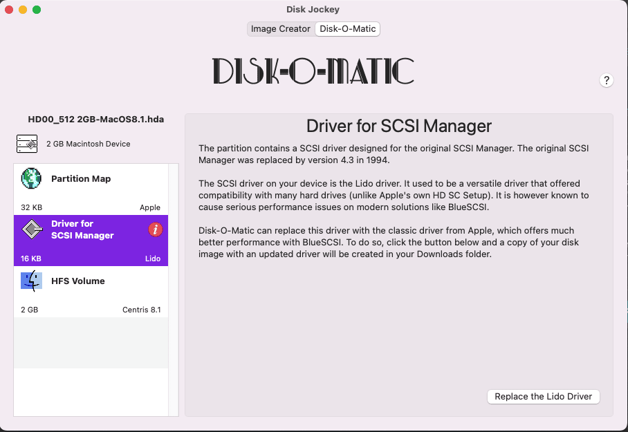

I’ll second what @retr01 said - the Disk-O-Matic part of Disk Jockey is fantastic! Here is my use case. I started with disk images over a year ago and not knowing what we all know now. I formatted those images using Lido. I also grabbed a number of disk images for which I had no idea how those were formatted or which drivers were installed. Once I saw the posts about performance problems with Lido-formatted images in modern replacements such as BlueSCSI and RaSCSI, I started formatting new disk images with other tools. However, I found issues when mixing images formatted with different utilities which I’m sure you more knowledgeable types would expect to happen, ranging from a failure to mount certain images in a mixed driver environment to death chimes on boot with certain classic Macs. I have a mix of original drives, SCSI2SDs, BlueSCSIs, and a RaSCSI.
I started a painstaking process of creating new blank disk images formatted with something other than Lido, and moving the files from the former images to the new ones using Basilisk II. I got about halfway through that process when I saw Disk Jockey 2.0 dropped with the new (at least to me) feature to read images and tell you about the driver on the image and offer to replace the Lido driver with the classic driver from Apple!
I was able to breeze through the rest of my disk images in a fraction of the time I spent using the brute force method. Now, all my images contain the original Apple driver. Thank you so much for creating Disk Jockey, @OneGeekArmy !
Thank you so much for taking the time writing your feedback.
