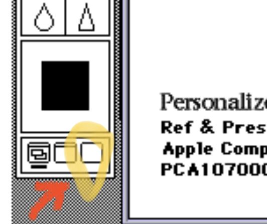

In Photoshop you select the righ icon of three on bottom of palette.
and then press TAB key to hide the pallette bar.
Thanks for the reminder. For some reason I had not been able to get it to work in the past. I did a fresh download of 1.07 from the Garden just now, updated to 1.1, and not only am I able to get full screen, but it opens TIFF files created on a modern Mac too! I've only tested in Mini vMac for now, but it only requires 2MB of RAM, so it should work on my 4MB SE.
THANK YOU!
