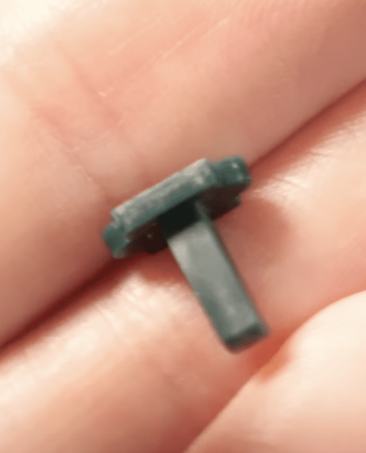

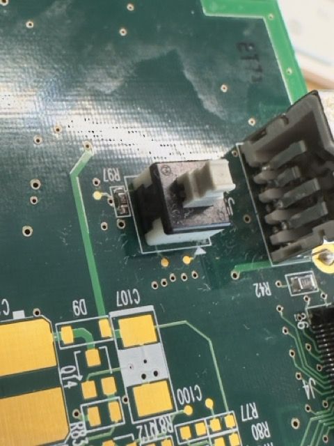

I think I have a new version of this.
I have like this square thing and this switch on the board...

No but you should be able to work backwards by measuring the hole the 'pin' goes through and the enclosure parts where it rests. Good luck!

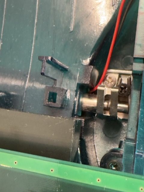

Ok, no luck at all.
I replicated the piece. I even fixed the switch on the ON position.
Still only the light turns up. No sound, no sign of light out of the screen.
