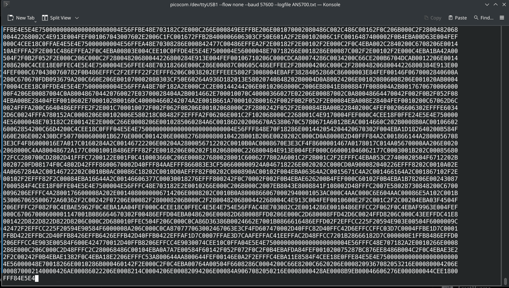

@joevt oh interesting! I (finally) tried to dump the ROM from my 700 but my collection of cables/adapters/etc must not be correct as I can never get output or input on the OF console. Is there any way to dump this while the machine is running (Is it mapped to a memory location or anything like that?)
I have two options but neither work: USB Type C to RS232 DB9 Serial Port Adapter Cable, FTDI Chipset -> null modem cable -> DB9 to apple serial adapter. I assume it's because it's RS422
And a Keyspan USB->RS422 adapter which is seen in linux as a serial tty, but i get no traffic.
Is there a way I could do this from a vintage mac with a serial port?

Success! Winning combo was it's the 2nd port on the ANS from the top and just using the kingston adapter to a serial cable:
There's probably a way but I only have apps for Mac OS 9 and OS X - neither of which is usable by the ANS 700?
The ROM is mapped to last 4 megabytes of physical memory. So, one would map it, then copy it.
RS-232 has a single wire for receive and a single wire for transmit.
RS-422 uses differential signalling. You can connect the one wire from RS-232 and ground the other wire for RS-422.
How could one call these OF ROM routines from C or while the system is running? I'm not familiar with how all this works.
I don't think you can call Open Firmware from most OS's.
If you can't find a driver or reverse engineer a driver from the OS (what does the lcdstring app use?), then you could try reverse engineering the driver from Open Firmware. The Open Firmware driver indicates that the registers for controlling the LCD are 32 bytes at 0x1c000 of macio. This is at 0xf301c000 physical address. command byte is at offset 0x00 and the data byte is at offset 0x10. There's a 1 ms delay used after every write to a register.
Are the ports not marked as modem and printer port? The default port for Open Firmware is modem port.
@joevt Attached is the raw output.
Thanks for the dump. It's identical to the ANS 500.

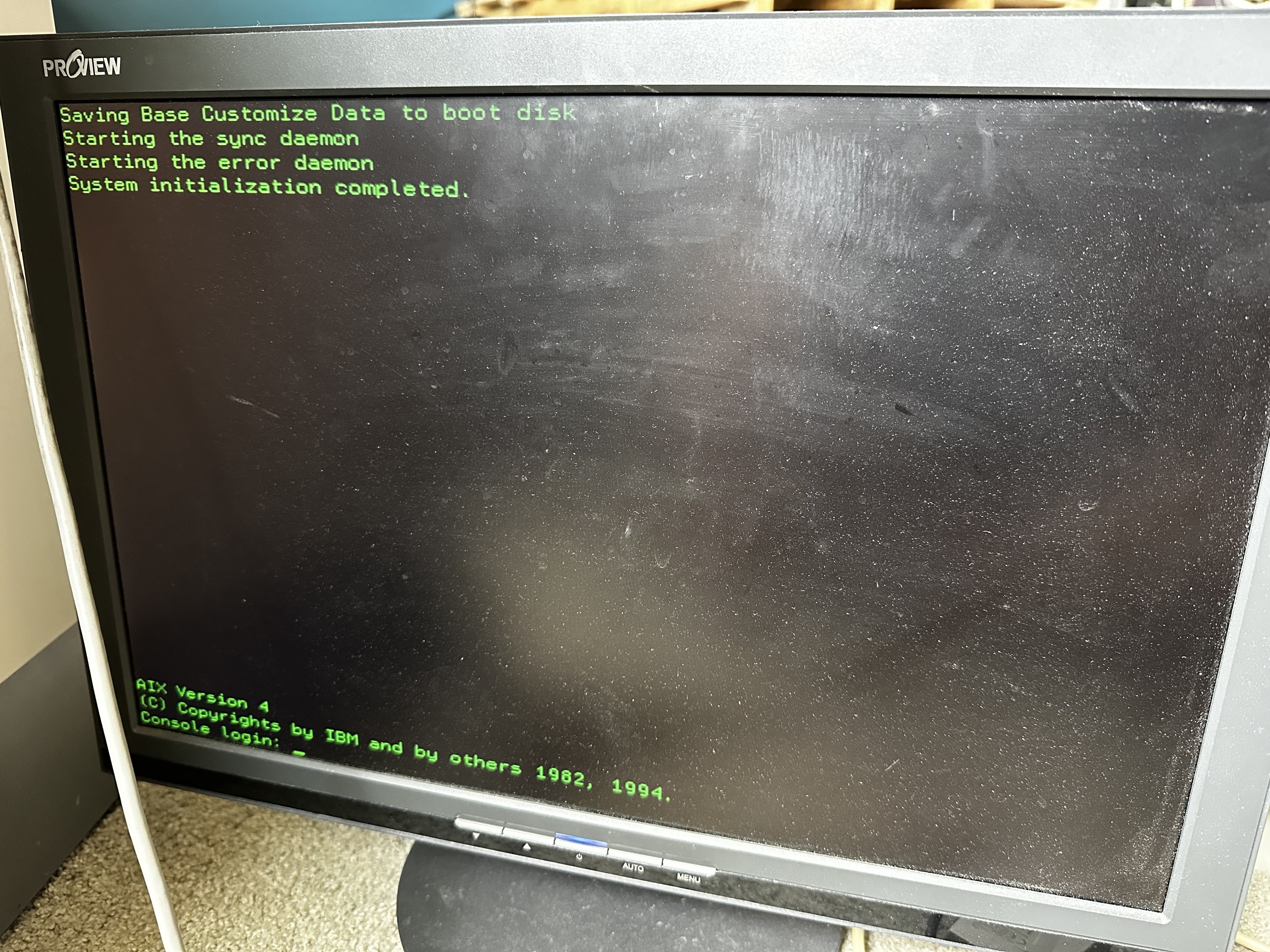

I'm running into an issue with installation now that the RAID card is installed. Booting off the CD and that step works great, but after it does the first package install it reboots before doing the second stage (and the notice to move the key to non-maintenance mode) - after the reboot it just drops into a shell that i can login with root and no password. I can start smit and oddly point the package installer to /dev/cd0 (instead of a mount point?) but there I can do a full package install. I never see the Post install guided installer gui. Also after reboot X11 does come up but no login and the cursor is an hour glass and just sits there. Really odd. I did this twice just to confirm I didn't miss something. Any thoughts on what might be going on with the installer and the RAID card?
Correct - just #1/#2
1,162
1,971
When I did animations on the LCD panel for a VCF one year, ISTR I just used a lot of spaces.
When I tried spaces to wrap i just get a triple line char at the end and nothing on the 2nd line.

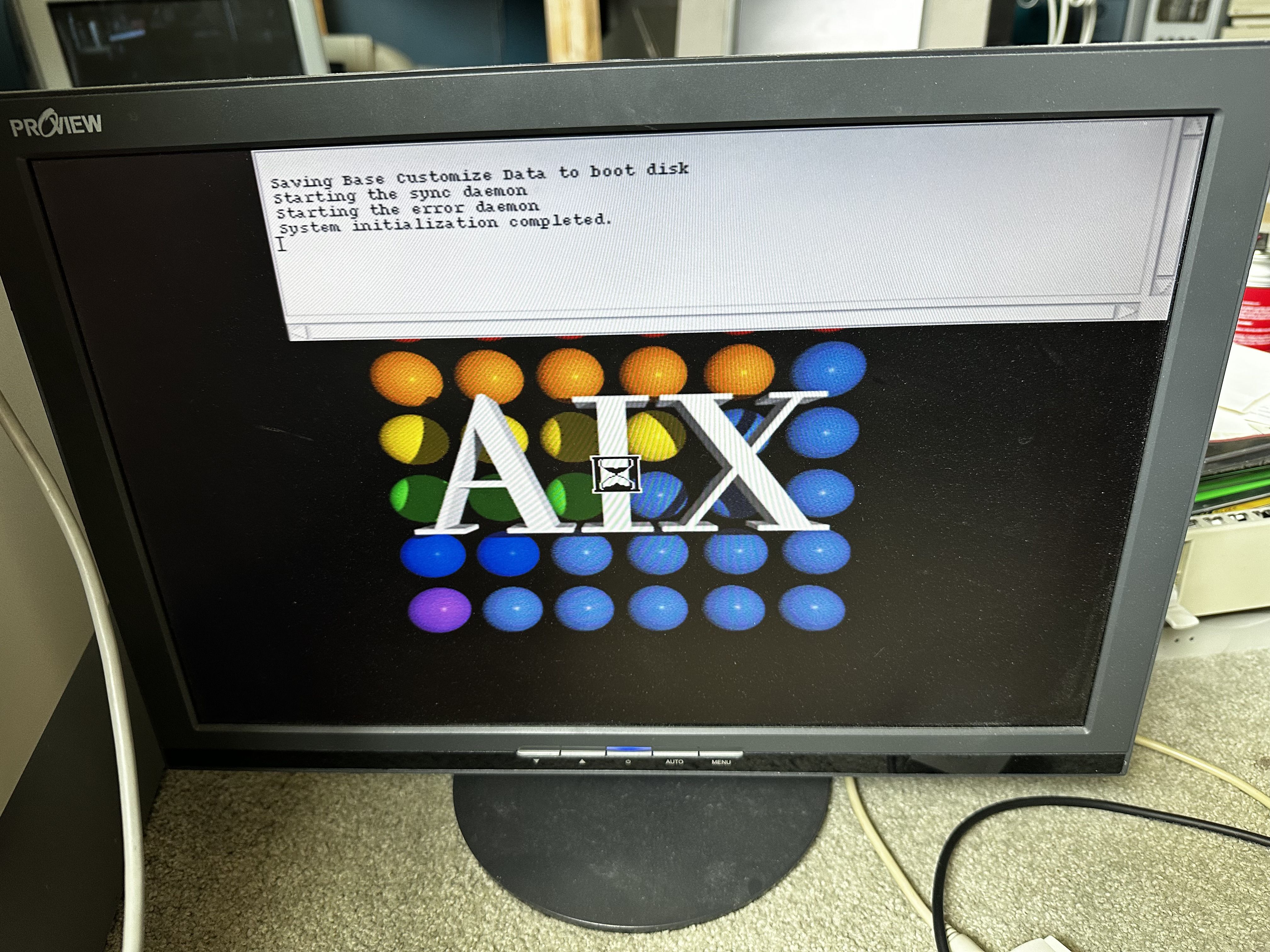

Ok fresh install again. I selected clean install, installp finishes, the next step where ig goes back to "Please wait..." it says 84% and "Creating boot image" then reboots (normally, without the SCSI RAID card it will do one more step here I believe, but dont know offhand).
Next it boots to OF, find the system drive, boots and has a gray screen, gray screen goes away to a text terminal that has this
Here is where I would expect the finalize install GUI to be as it normally is without a RAID card...
Then I can use smit to install all licensed. 271 packages
Reboot and it just sits here:
Also oddly the lcd screen has no info on it. Pretty confused!

Poked around but didnt see any errors in the logs I could find in the recovery mode.
I did another reinstall and was reading the manual and noticed I can run the install assistant anytime - "You can access the Installation Assistant at any time by entering the command install_assist" - so after i got dropped to the root login after stage 1 install i ran it, installed all packages and this time exit to AIX brought me to the CDE login! Unfortunately after login I am just stuck at the blue "Starting the Common Desktop Environment" screen. This is further than I got before but still stuck unable to access CDE.
telnetd/ftpd dont seem to be running - but I see these ports are open
PORT STATE SERVICE
1024/tcp open kdm
1025/tcp filtered NFS-or-IIS
6000/tcp open X11
Rebooted after sitting for 15 min at the blue "Starting the Common Desktop Environment" screen, after reboot it's back to the colorful AIX screen that just has a few log lines as shown in the post above. Something is not letting X11/CDE load, and the only difference is the SCSI RAID card, I'm at a loss where to look next.

If it's always halting at "System initialization completed" it doesn't sound like it's executing any of the rc scripts. What does /etc/inittab look like? What rc files are in /etc? (rc.tcpip, rc.local, etc)
1,162
1,971
:forehead slap:
Well. turns out if you have a floppy disk in while installing something is written to that disk and then the startup is different due to that (dont know the details are but it was the root of the problem)
I figured it out when I decided to dd /dev/zero my images and rebuild the raid - the disk was still in... and i recall it saying "saving to boot disk" which till now I assumed was the main boot volume hard disk, but was actually the floppy disk. Ejected it and we got the normal start and rc services started.
