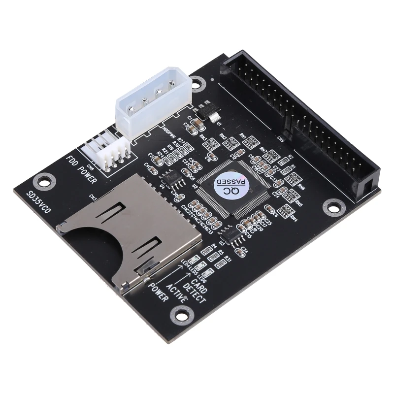

I posted it for the purpose of recycling the cards left in the warehouse. There are several other SATA cards, but I used the ATA66 card because it works well on the PowerMac9600.
I don't think you need to buy this old card, but if you have a surplus in your warehouse or closet, reuse it with SD card adapter or DVD-drive.
AEC-6880M and 6860M are raid cards. You cannot connect the ATAPI CD (DVD) drive to it. In addition, there is a limit to the capacity of HD, and large-capacity HD cannot be connected. Now that the silicon storage device is mainstream and doesn't use raids, I'll write how to flash it to the AEC-6280M and 6260M.
*The AEC-6280M(6880M) is an ATA133 card and the AEC-6260M(6860M) is an ATA66 card. The ATA133 card is useful on G3 B & W and later and on G4 machines. The ATA66 card is mainly useful for beige Power Macs. The reason is that when using a normal HD on a beige PCI Mac, disk errors occur frequently due to the slow PCI. However, in this test, I used an SD card adapter, but no error occurred with the SD card adapter.
The purpose is to use the following SD conversion card and connect the ATAPI drive at the same time.
