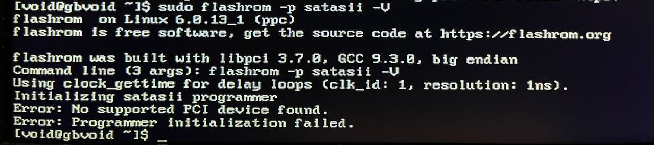

Thanks for your suggestions. Unfortunately, flasher under OS9 is freezing the computer when clicking “update firmware”. I thought it was the B&W G3 but I just read someone having the same problem with the same card on a beige G3. I will try a Debian Linux on my G5, but I am not very optimistic either. Despite all the efforts of Dosdude1 for changing the chip properties to 3112, it is still recognized as a Raid card and not a Mass storage device…

Have you tried running flashrom with the verbose switch (-V, -VV or -VVV) to get more information? It's pretty specific.
yes I did, here is copy as attachment. If you can send yours also and doing sudo, it gives the details of "capabilities" , I will compare them this afternoon, but I have the impression that they are the same.

Unfortunately, as flashrom does not recognized the card, the verbose is just one extra line with the built reference of flashrom
Have to try Debian, hopefully tomorrow
What EEPROM does your card have? It's come to my attention that the AM28F010 EEPROM commonly found on these cards is not supported by Flashrom. I'm not sure if this would be the cause of your issue, but could be. I have compiled a custom version of Flashrom for DOS with the necessary AM28F010 definition, and can do the same for PowerPC if needed. My custom DOS version can be found here: http://dosdude1.com/files/flashrom/flashrom-dos-am28f010.zip
