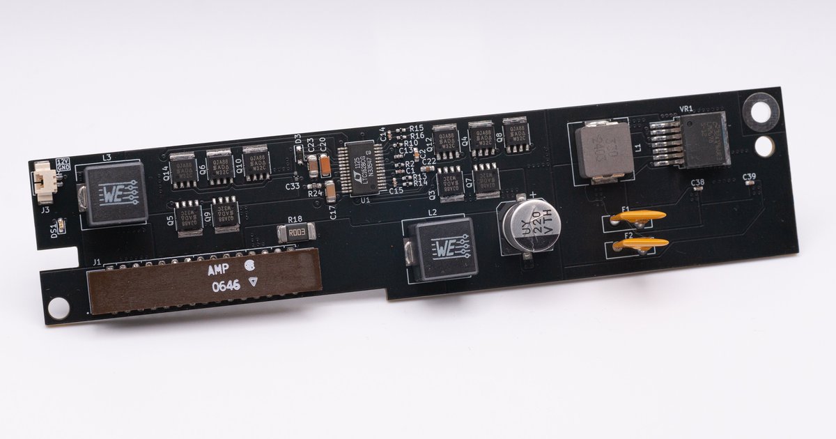

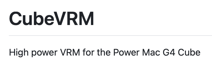

'evanboonie' has started an open source design of this VRM-board on GitHub: https://github.com/evanboonie/CubeVRM
Curious...
My question to "evanboonie" would be this: how powerful is "high power"? 150% related to stock?

My VRM in a second cube I have is pretty toasty. Some bad soldering reflow and C3 is blown. This was in a cube I just picked up and magic smoke appeared from somewhere when I plugged it in. Is there a guide to test these somehow or troubleshoot bad components? Or does someone rebuild these? I'm not looking to spend $100 or more on a replacement at the moment.

@RickM
I don't have hours to spend reviewing every design choice, but I did do a quick overview with the schematic you provided and the datasheet. I didn't spot anything obviously bad, but again, I've not pondered all the design choices made.
I did take note of this table in the datasheet, however...
Then we can look at the relevant part of the schematic...
The datasheet goes on to say this:
Setting the Operating Frequency
Selection of the operating frequency is a trade-off between efficiency and component size. High frequency operation allows the use of smaller inductor and capacitor values. Operation at lower frequencies improves efficiency by reducing gate charge and transition losses, but requires larger inductance values and/or more output capacitance to maintain low output ripple voltage.
In higher voltage applications transition losses contribute more significantly to power loss, and a good balance between size and efficiency is generally achieved with a switching frequency between 300kHz and 900kHz. Lower voltage applications benefit from lower switching losses and can therefore more readily operate at higher switching frequencies up to 3MHz if desired. The switching frequency is set using the FREQ and PLLIN/SPREAD pins as shown in Table 1.
There are 3 outputs:
  1. 3.3v
  2. 5.0v
  3. 12.0v
I personally do not consider "12v" to be classified as "high voltage," which makes me wonder why the FREQ pin was set to GND (0v), thereby making the switching frequency a very low 380kHz. (INVcc is set to Vcc which means Spread Spectrum modulation is used, with the aim of reducing EMI, which is perfectly fine.)
Nothing bad will happen with the chosen operating frequency. As mentioned above, that choice is tied to Efficiency and Component Size. And I noted that 2 of the 3 "Typical Application" circuits given in the back of the datasheet use 380kHz, while the third uses 2.25MHz.
A deeper dive requires a full read of the datasheet and analysis of each component chosen in the schematic to see why those components were chosen and how it impacts the output, but I lack time to do that. Even so, if the designer wants to come here and explain a few of his design choices, that would probably work to both enlighten everyone and put their minds at ease too.
