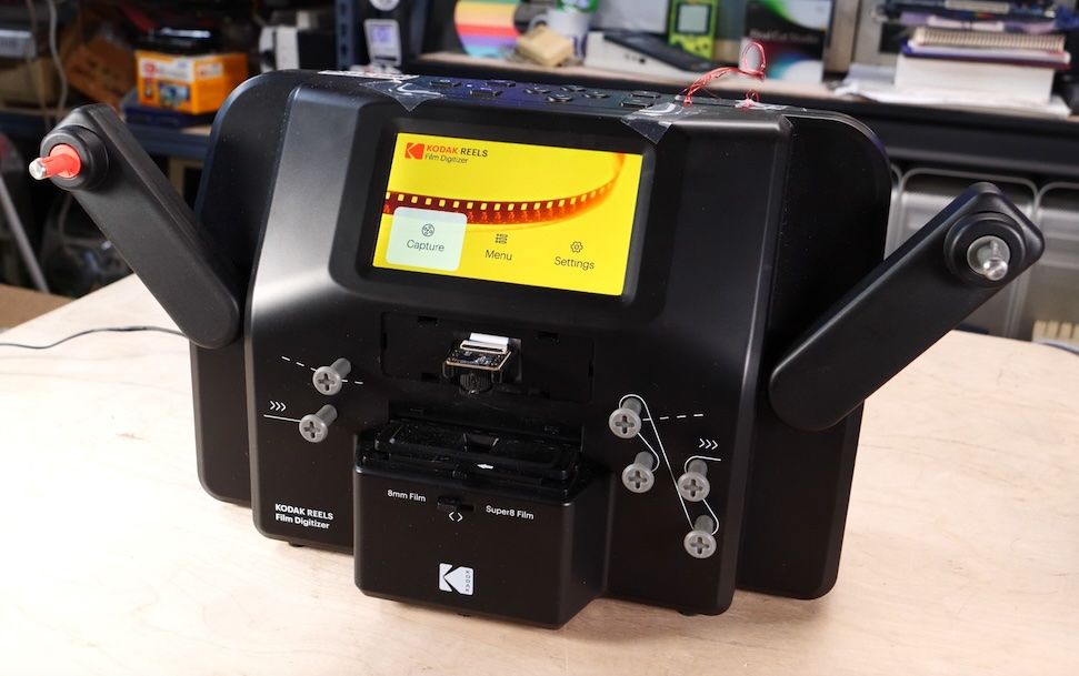

Essentially, the original Kodak Reelz/Reels unit offers zero quality controls or video capture settings. During the capture of your 8mm film the device takes hundreds of individual photos and works to build a video file out of them. As part of this process, due to limited processor horsepower and memory, the unit compresses the final video file saved to the SD card. This often results in pixelated, poor looking transfers that can throw out a lot of picture information, like film grain. These videos also have incorrect speed and altered colors or poor white balance. While some have used AI upscaling tools to try and improve quality, as the old adage goes... "garbage in, garbage out".
Worst of all, fellow user @0dan0 discovered that when capturing images and creating a video file, the device is only using a small fraction of the image sensor. Therefore, each capture only uses a fraction of the total image resolution, roughly 640x400 pixels. Then, the device upscales that image to a larger size, like 1728x1296 pixels. This discards tons of picture information and detail! Therefore, previous firmware mods that only increased the video resolution and bitrate were still limited by this internal process. Lastly, the units have an auto white balance feature that cannot be turned off, this can often cause drastic shifts of colors or tones mid-scene.

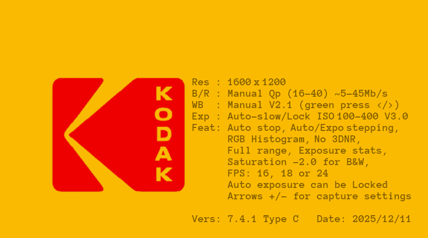

- 0dan0 Firmware (For units A, B, and C) - Download here(version 7.3, December 2nd, 2025)
- Resolution: 1600x1200)
- Video bit rate: Variable, with a peak of 35 Mb/S
- Frame rate: Variable, user can select 16, 18 or 24 fps

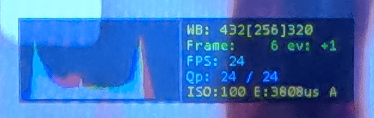

- Primary enhancements: RGB histogram, editable white balance, adjustable auto exposure, ISO & exposure statistics, additional color tint controls, advanced frame adjust (allows for additional digital zooming/cropping).
- Other enhancements: Visual histograms, MP4 metadata fix, disabled 3D noise reduction, auto stop when film reel is done, custom boot / shutdown graphic with firmware information, and many more.
- Quirks: Detailed images can overload the unit, leading to a crash and requiring a restart. 32GB FAT32 formatted SD cards are strongly preferred to reduce errors. 4GB max file sizes. Digitizer cannot playback captured recordings on the built-in screen.
