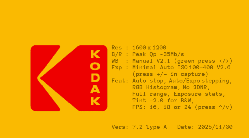

Here is v7.2, a month more of tinkering. This adds more debugging, Qp level (showing the current encoding quality) and a live frame counter (mainly showing the 25 fps update rate.) When running the English language mode, "Tint" has been replaced with "Saturation".
Hacks relates to jitter, even less is running at encoder start.

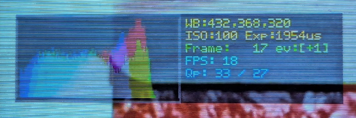

Running C v7.2. Took a gamble and put a 50 year old reel in, about 30m super-8. Loaded in PC, start of clip was excellent. Came out with much better colors and detail than the "professional" scan done by my parents years ago (expensive back then).
However, towards the end I see "jitter" in the bottom of the frame. It slowly creeps in, observable after 1 minute or so and at the end is very obvious. I put jitter between quotes, because if I step through it frame by frame, it is NOT random. It has a very distinct pattern that repeats. A frame is shifted up at the bottom about 1/3, then 4 of frames okay, then again about 1/4 up, then 4 frames okay, then 1/8 up... and so forth until it repeats after 52 frames if I counted correctly. I can DM you a link to a clip if interested. This must be something software/electronic related.

Anyone else seeing the jitter appear after the capture started correctly? I have never seen that, so I would like to see examples to understand if there is drift on some units and not others.
I messaged you a link to a recent capture file that potentially demonstrates this. (7.1.1, model C, Super8, lens mod)

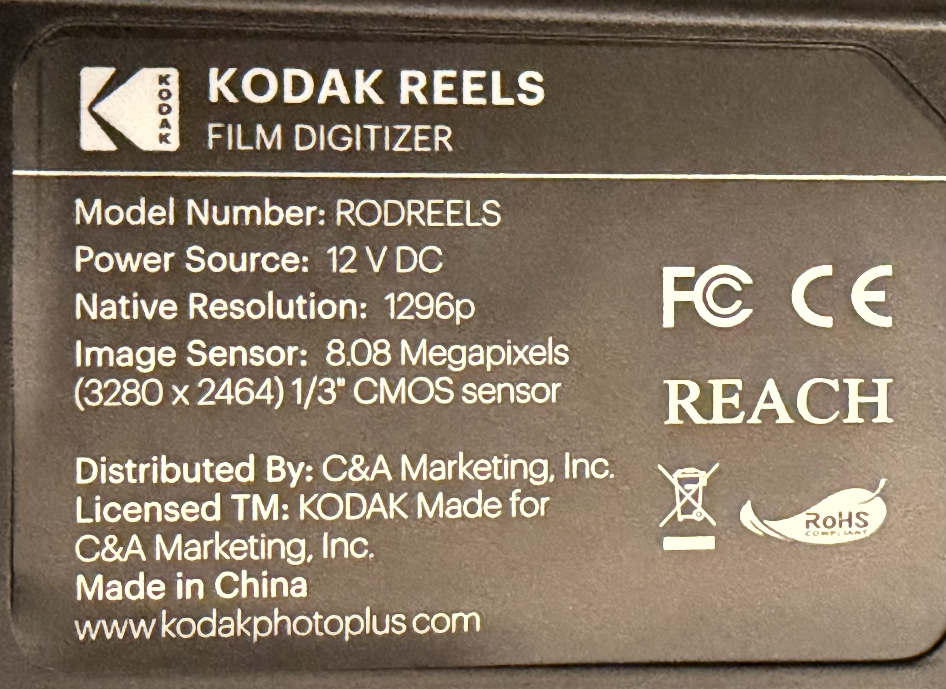

Does it say "V2.0" on the back, or only in the About screen?
If the back looks like this:
it will be pretty safe to try either Type C (first) or Type B, the two most common "REELS" units. If the display is weird using C, try Type B.
However, if you rear ID plate looks different, maybe there is a fourth variation of the hardware. This would be a far greater risk.

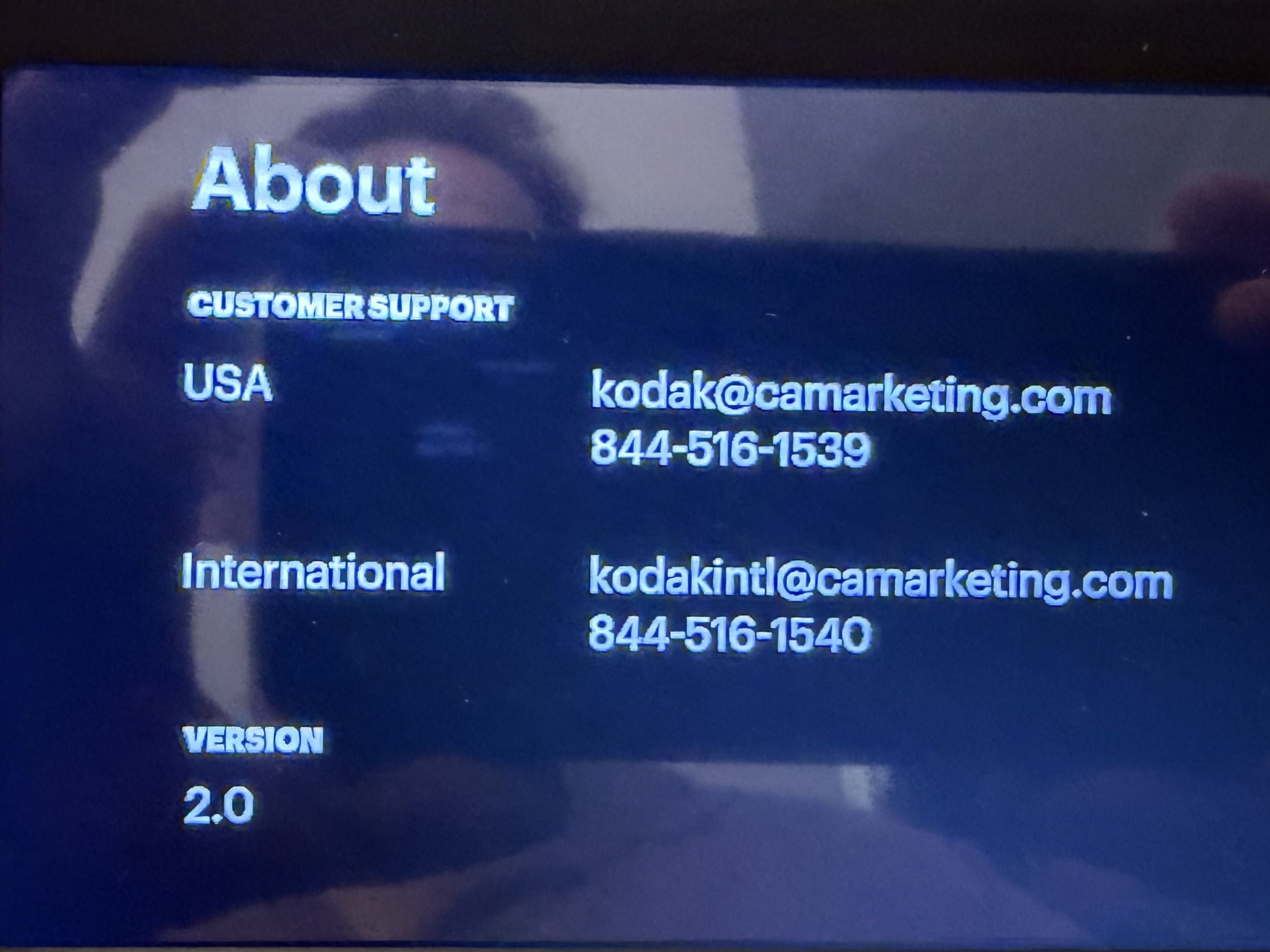

Thanks for the reply. I appreciate it!
On the display, it says 2.0. Is that the same as V2?
Our labels on the back seemed to look the same.
This seems to be the same hardware. Type C or B will likely work.

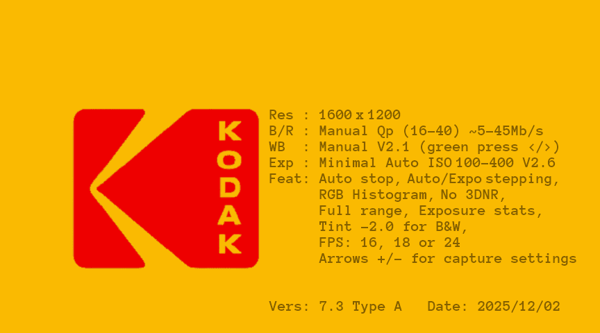

Here is v7.3, after only a day or so. This adds Qp level control, allow you to set the minimum Qp the device will try for. Previously this was fixed at 20, but this may have caused some jitter drift (unconfirmed) on some units. During capture there is a new settings controls which should be easier then remember all the buttons. Up and down arrows move the square braces between controllable settings, +/- change the settings.
Thats a nice feature, as discussed in DM for me a minimum of Qp=23 seems to work to avoid the jitter/skew in frames. But of course datarate and required processing power still depends on how much the picture changes between frames and the amount of detail and grain present. I will do a lot more scans with this setting and see how it turns out. In any case, very happy with the latest updates - Thanks!

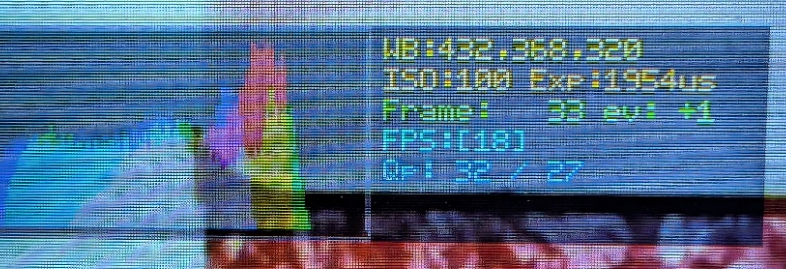

View attachment 25050View attachment 25051View attachment 25052

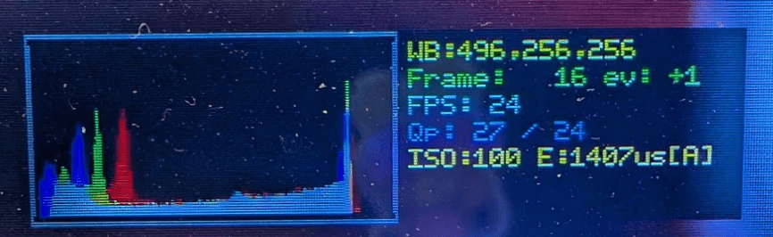

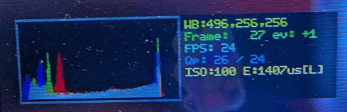

Crazy progress continues V7.4
@sheider " feature requests: ... a user-controllable exposure lock toggle."
As I have a short film project this weekend, where I will be developing and scanning about 10 rolls of Ektachrome, and I too thought an exposure lock could be very helpful.
The current exposure setting are now at the bottom of the list and I've adding [A] for Auto exposure (default.)
[l] for a Locked exposure.
The exposure lock can survive, clip capture stops/starts, power cycles and firmware updated.
I've also finally made white balance, sharpness and saturation will now survive firmware updates (for the update after this one.) I do so many updates, it is annoying to reset all my defaults.

Flashed the above 7.4, boot screen says 7.4, folder name is FilmScnC7.3. Set the Qp to 23 min, sharpness -1, loaded a reel, scanned for 90 minutes, and got 1.7GB of jittering bad scan result begin to end... sigh.. its already bad at the start, but worse at the end.
EDIT: changing minimum Qp doesnt seem to do anything. Bitrate for all clips is about 22.1 to 22.5 Mbit/s. Even if I put it on 39 (the max value). Actually the same as previous scans on Qp=20 or Qp=23. What I saw once with min Qp=39 I get a few blocky frames, but then the quality is back as usual. So perhaps the minimum value that you set is displayed but it is not respected by the encoder.
Just tried another clip on Qp=39, 180 frames, 27 MB, mediainfo reports 22 Mb/s wich is correct looking at file size.
