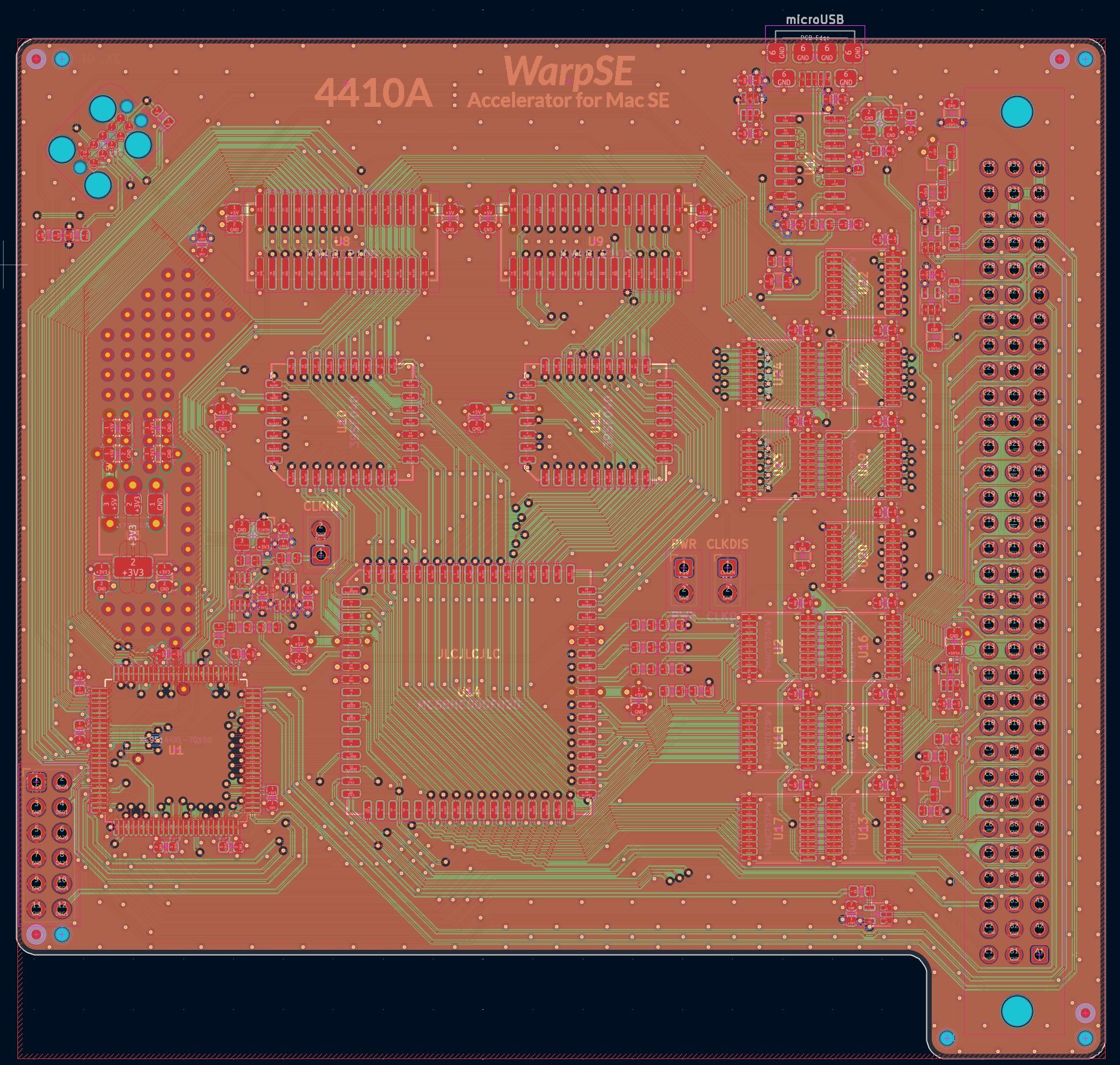

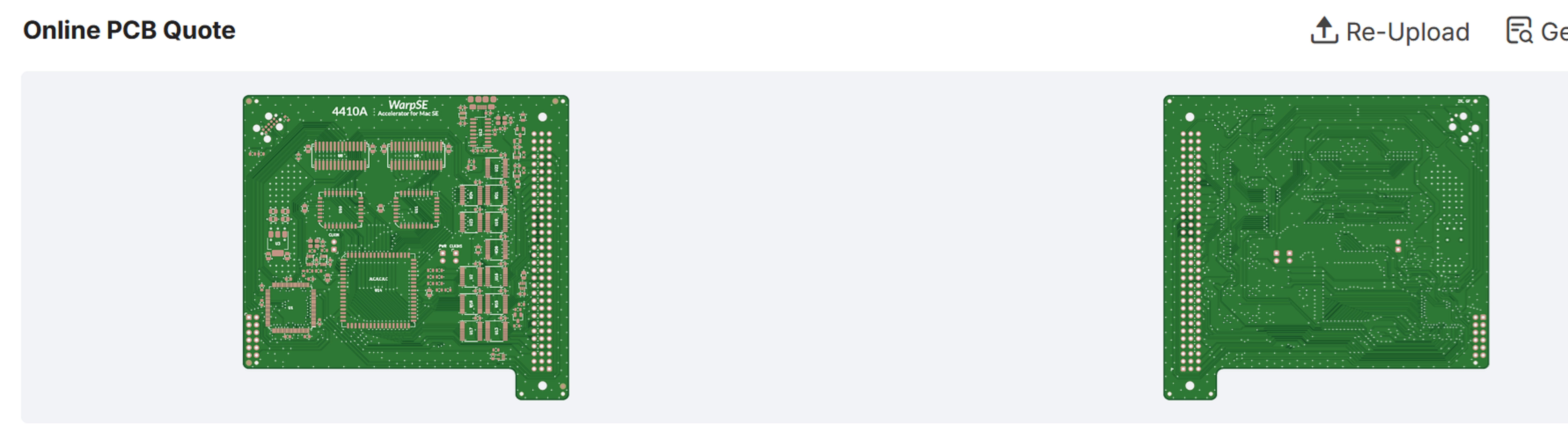

Removed the GW logo from the prerelease Rev.3 USB PCB, in KiCad:

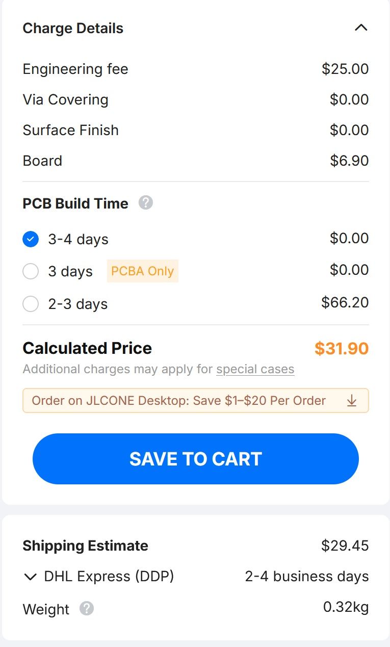

Created a new gerber from the above and uploaded it to JLCPCB:
Looks like $31.90 for (5) green PCB's at JLCPCB.

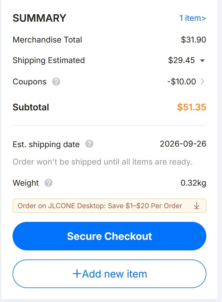

$51.35 total, with shipping, or $10.27 per individual PCB.

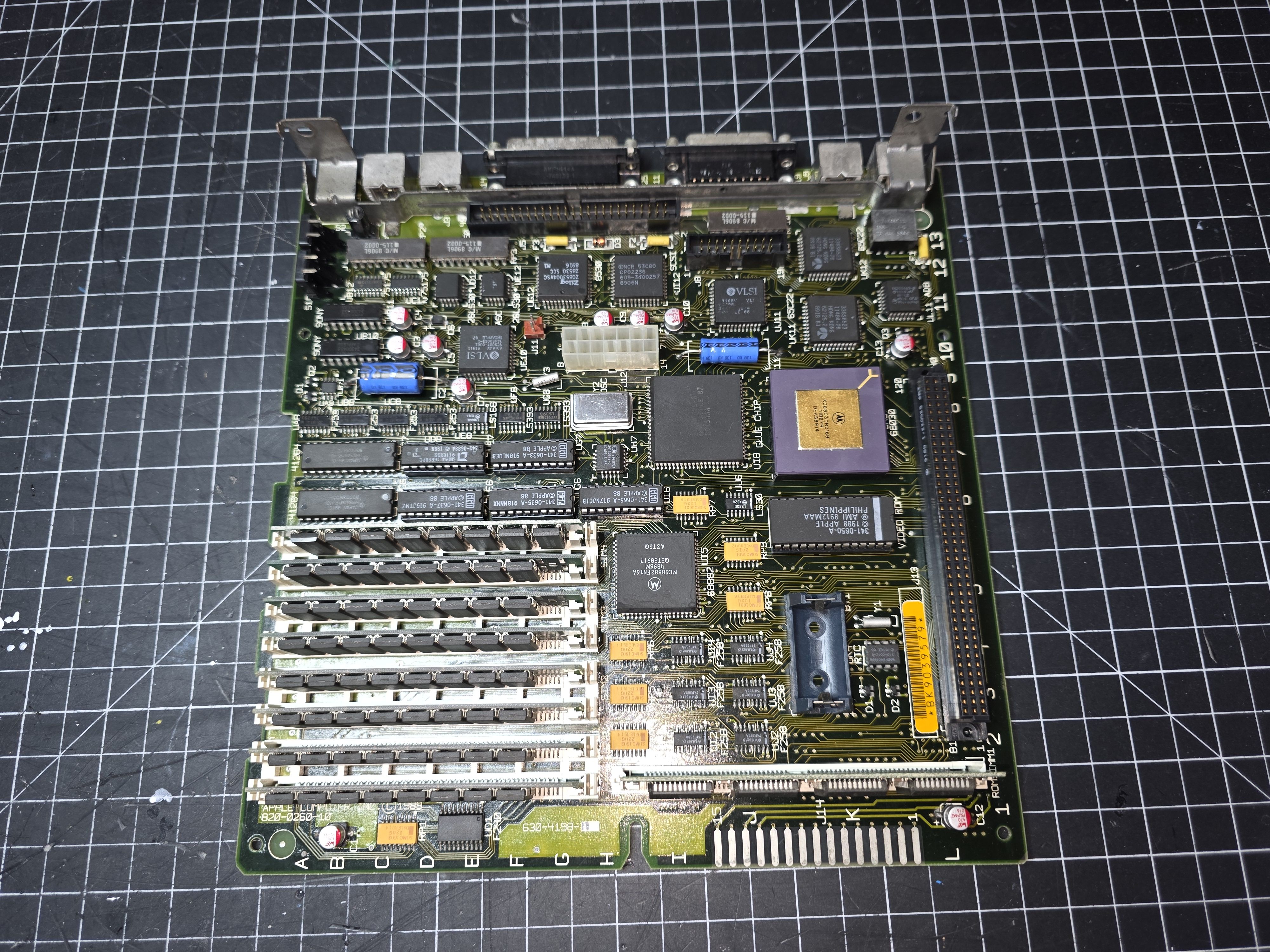

If I were to build these WarpSE boards, I'd need to sell this SE/30 logic board first, it's been recapped, ultrasonic cleaned, and has all 105°C caps; it has 8Mb of mixed RAM, and was fully tested with a TechStep, all functions work like new. Comes with PRAM also, either Pxcell lithium with the top clip, or a CR232 adapter and coin cell.

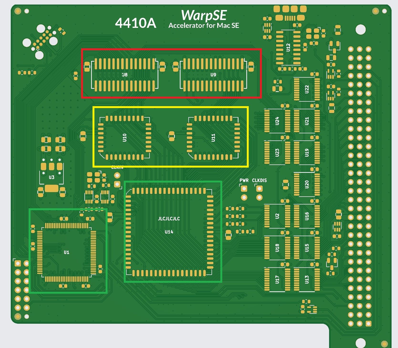

Since the WarpSE was designed to work with very specific, and out of production chips, I took a look at what would be necessary to get this project going.

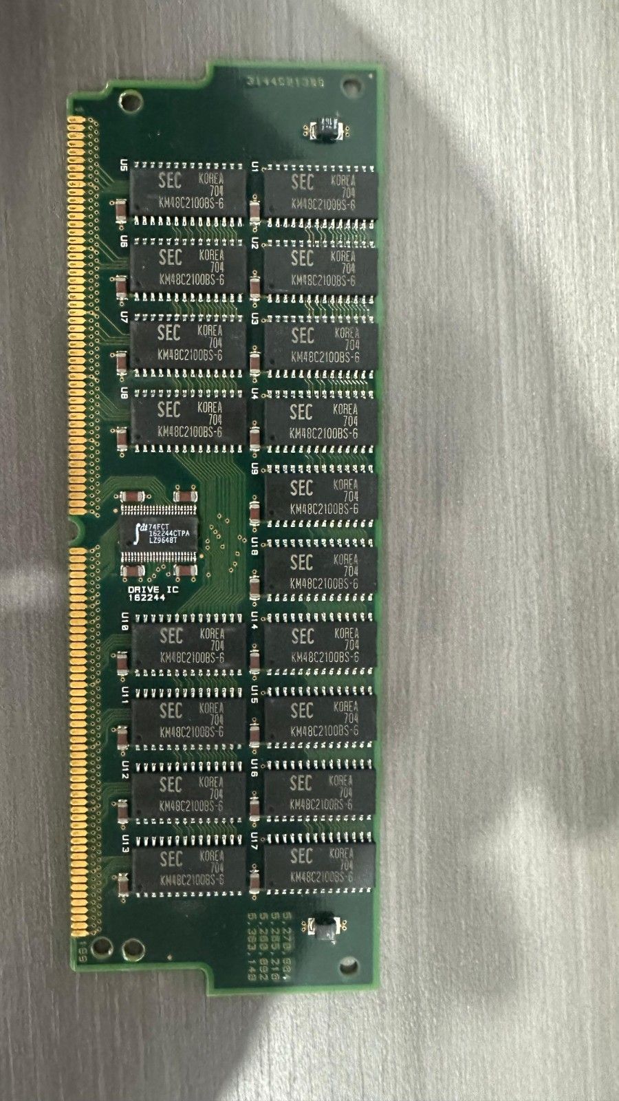

U8 and U9 require Samsung KM48C2100BS-6, or (2) 2M x 8Bit CMOS Dynamic RAM with Fast Page Mode, chips.
In order to get these, I'd need to individually remove them from a RAM module, to be sure I get them inexpensively and not fakes.
The other chips in the boxes above, are also still for sale on ebay, just need to get them from a reputable source.
The smaller chips/transitors/caps/resistors, which I've seen referred to as 'bird seed', are all still available at JLCPCB, and could be installed by their pick & place machine when having the WarpSE boards made.
Was thinking I'd have everything but the chips in the boxes above, soldered by JLCPCB, to reduce the hassle and room for error when assembling these. The micro USB connector for firmware flashing may also be a problem, as those are hard to find at the moment.
