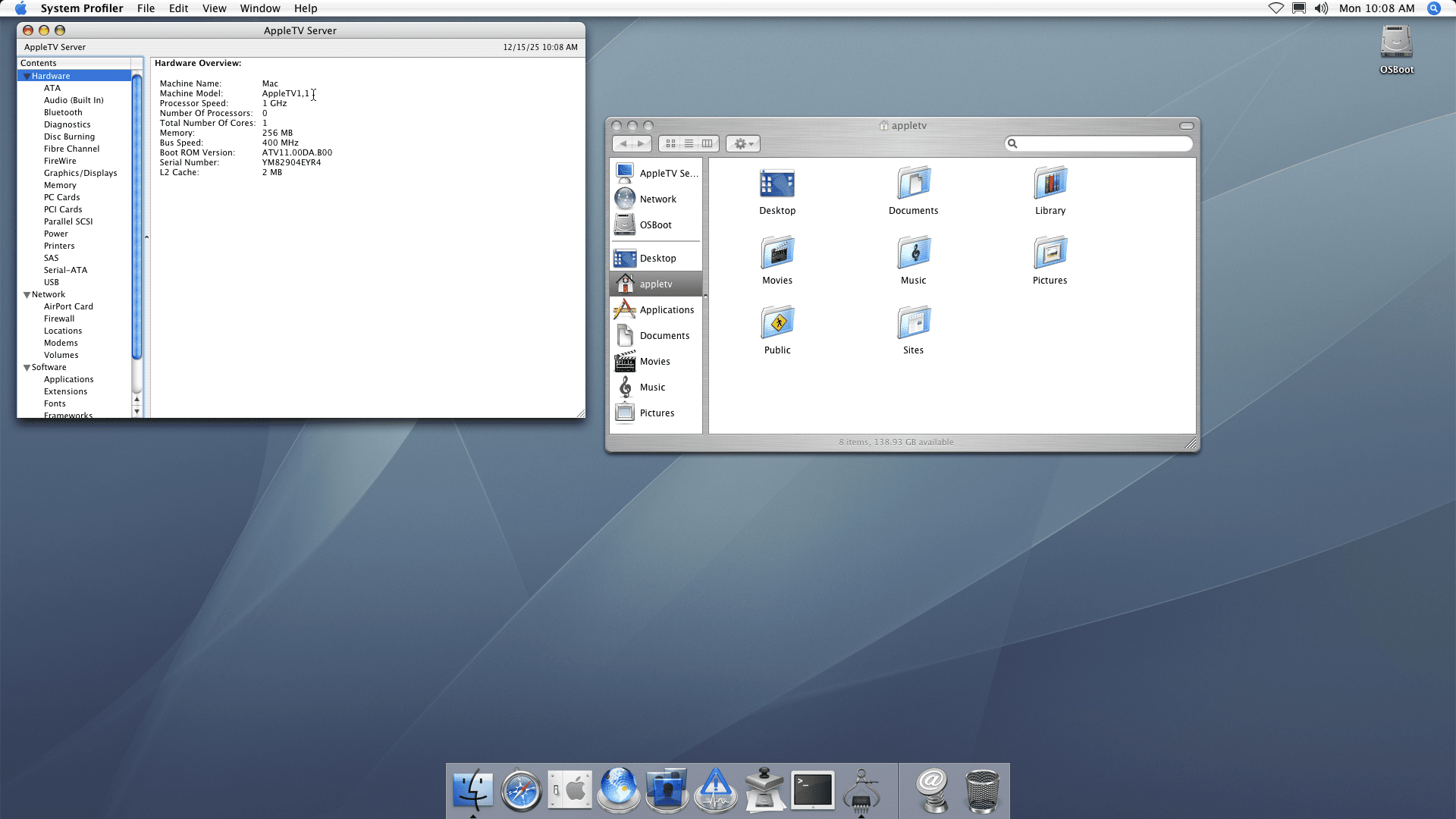

So with the mach kernel file and the boot.efi files you provided I was able to get Mac OS X 10.4.7 Tiger Server running on my Apple TV!

SteveJobs
Dec 10, 2025
^ Excellent! Have you experienced any issues?
I didn't mess with it much after install I began new project to get the client version downloaded and running on it but I'll report back in a few days.
Oh and thank you again for the mach kernel, and boot efi, i really needed those files.
