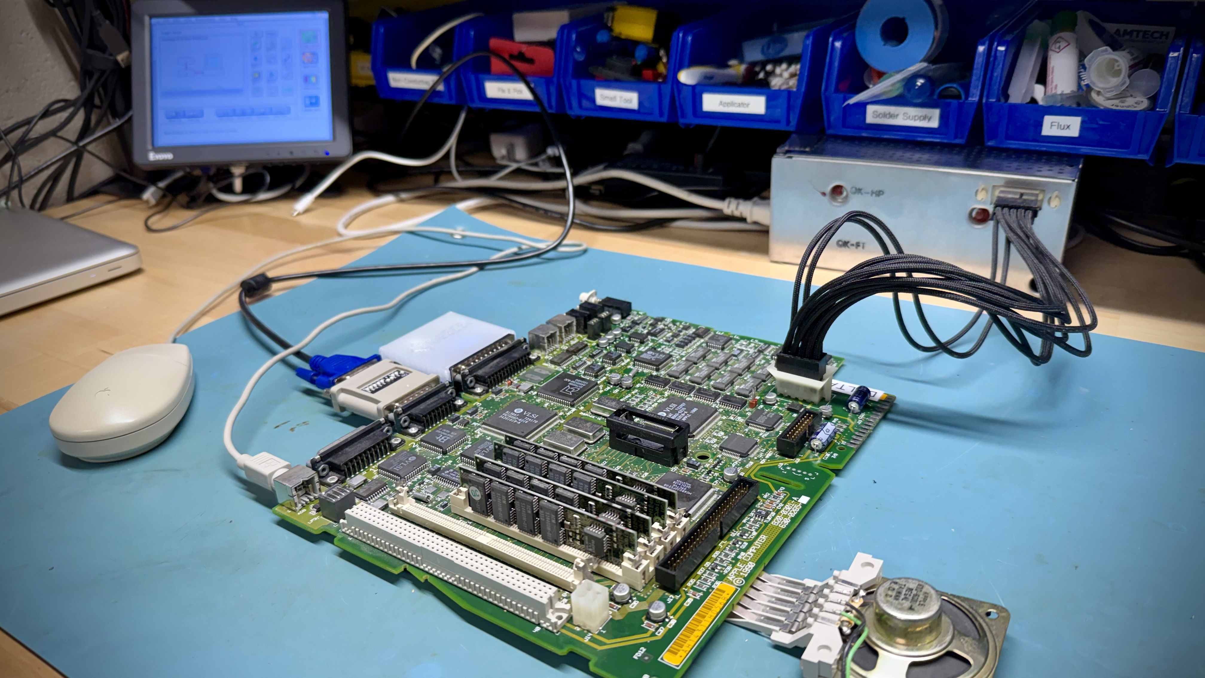

After spending time on Bravo's audio problems, I decided to check out Alpha's speaker problem while the subject was still fresh in my mind. Alpha was working perfectly after I restored it back in 2021, but I was using it as a known-good system for testing, and along the way, my sloppy probe work resulted in the speaker dying.
To get things started, I verified the signal coming out of the Sony ICs and followed it to the bottom of the board. Everything was making sense up to the TL071B op amp at UK3. The signal was coming into pin 2, but the output from pin 6 was garbage. It was coming out a -8.8V and there was just the faintest hint of a signal. All the other pins looked normal, so it seemed something had gone amiss with the op amp.
I ordered replacements, so I installed a new TL071B--and the problem remained. Maybe I ordered the wrong part; so I scavenged one off the battery-bombed Foxtrot--and the problem remained. I was now scratching my head, because all the signals and voltages coming into the op amp were correct, but output was wrong.
I pitched the question to ChatGPT and it suggested the problem was coming downstream of pin 6, keeping it from producing good output. I followed its recommendation and removed R41 to isolate the downstream circuit, and sound came out of the speaker! The sound was a bit hissy, but it was something.
So, I reinstalled R41 (not easy given how small it is) and removed Q11 (an NPN). The probem was back. So, I reinstalled Q11 and pulled Q10 (a PNP), and the speaker was working again. So, apparently I had damaged that transistor with my probe. I had ordered new MMBT3906s from Mouser, but I remembered the issue I had with Bravo, and I supected the pin orientation did not patch the footprint on the board. Since this circuit was easier to follow, I was able to figure out that collector and base were reversed on the new MMBT3906 compared with how the board is oriented. Luckily, I was able to scavenge yet another part from Foxtrot, and with its Q10 installed, the speaker sounded great.
In the end, I replaced UK3 (twice), and I had to reinstall nearby C41 when it came off while replacing UK3. I also pulled and reinstalled R41 and Q11, then finally replaced the faulty Q10. I was distracted by the odd output coming out of UK3, but after working my way down the cirucit, I found the shorted transistor.

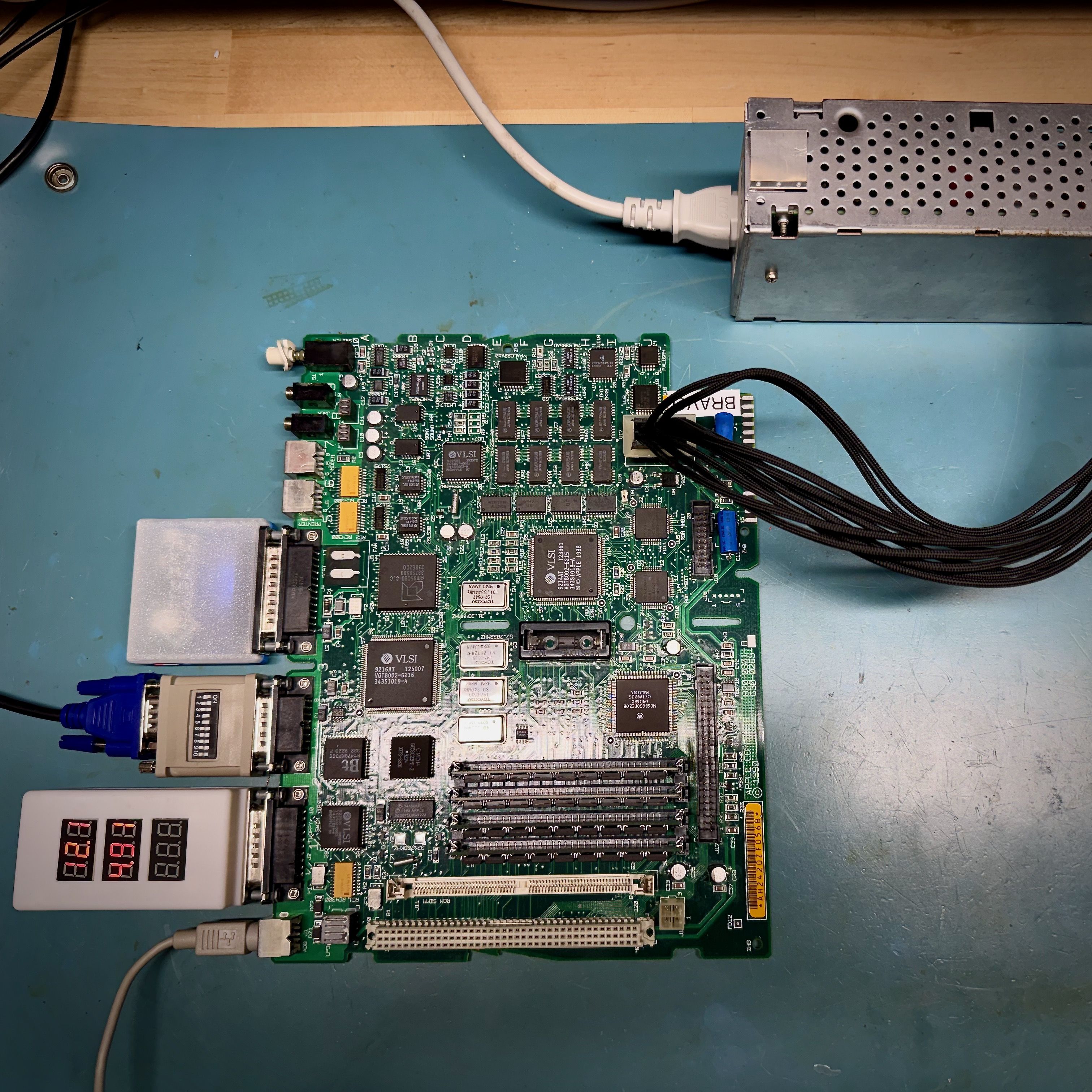

Bravo is Beautiful​

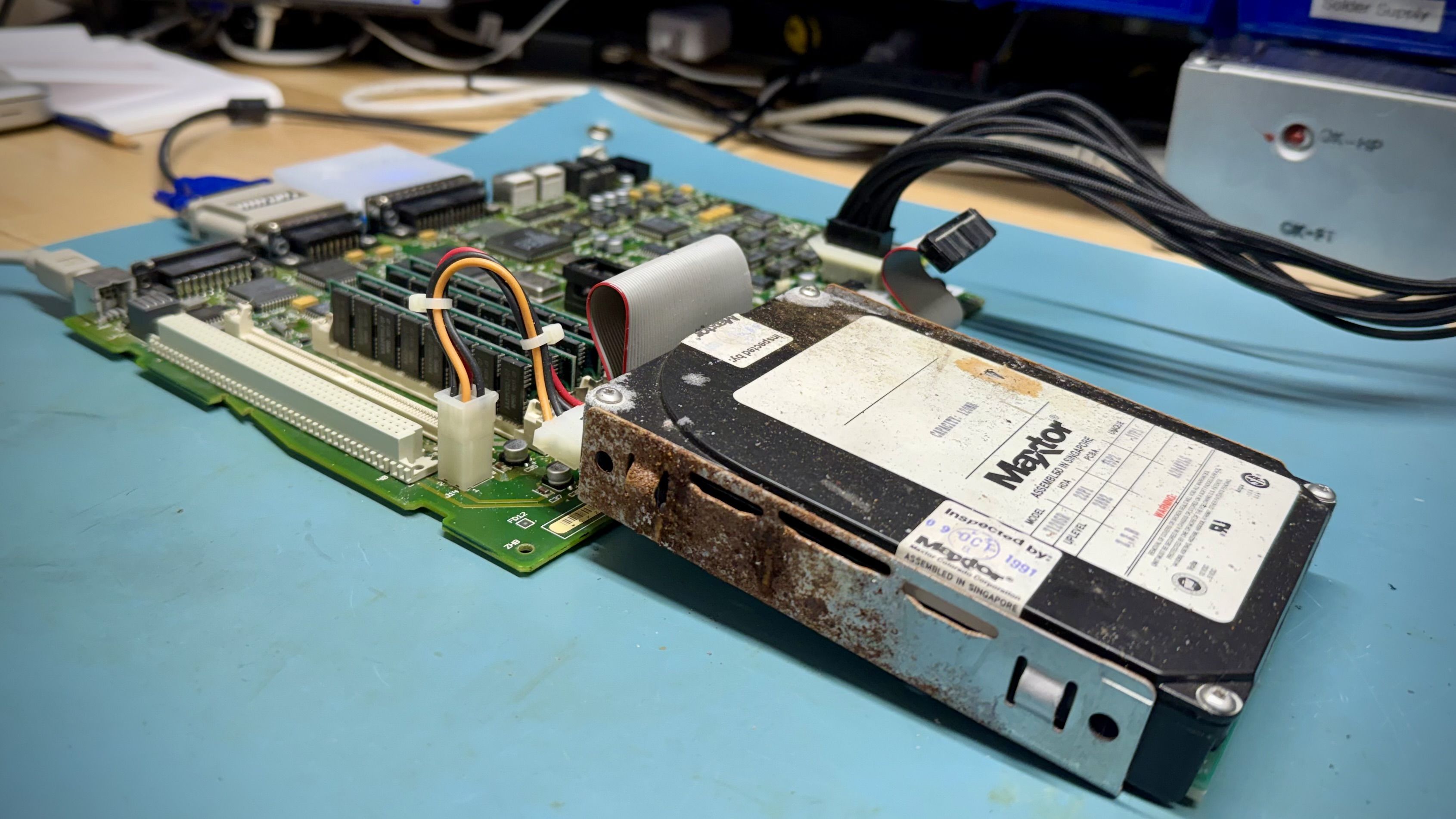

Bravo is the system I've worked on the longest (technically, I started working on it in 2021), and it is finally good to go.

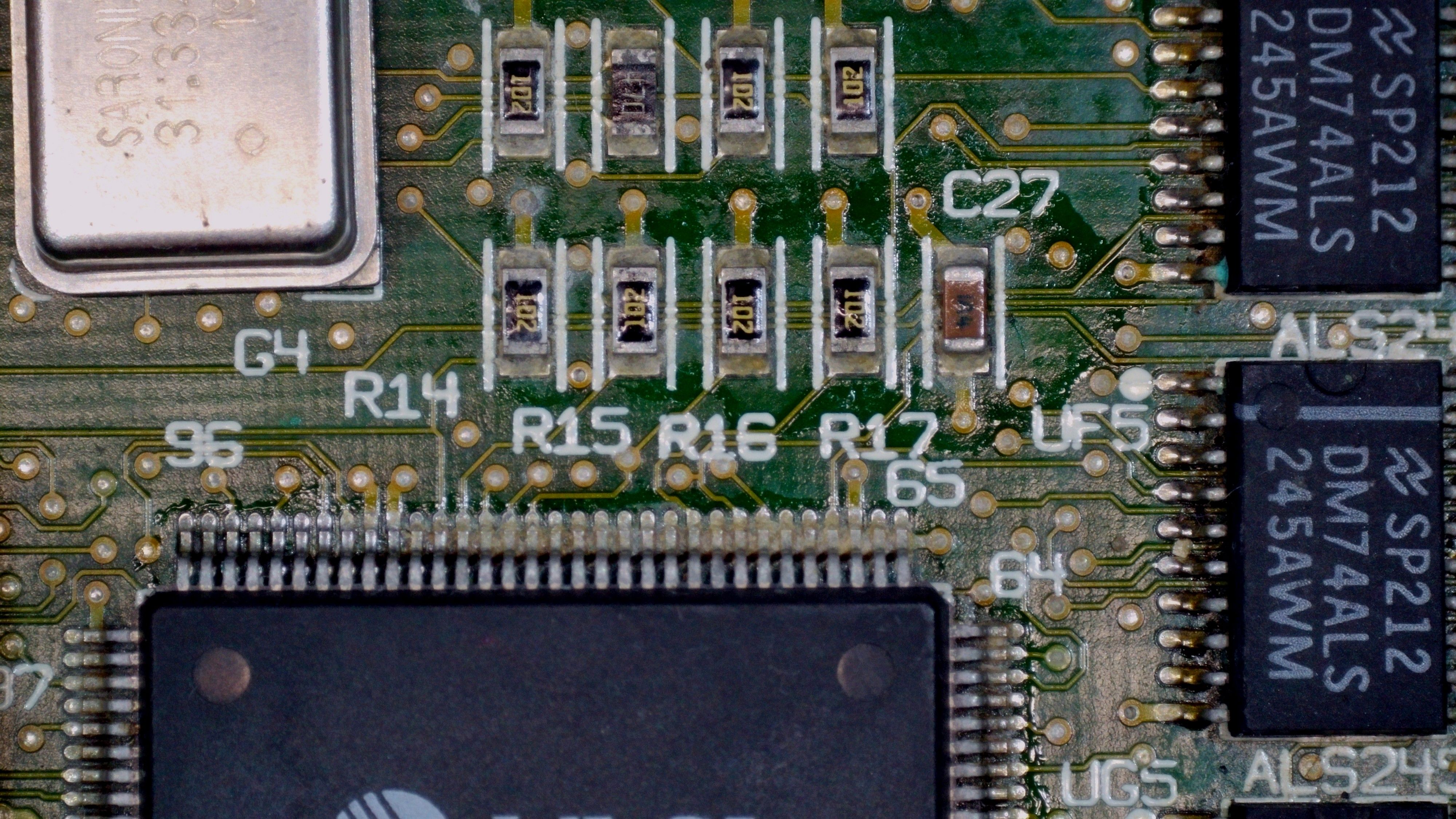

It's last problem was bad serial communication. TechStep was reporting a Serial Communication Controller test failure. Most specifically, it said there was a problem with the handshake input. So, I followed the handshake input pin on the jack to UA6, which is a 75175 (a quadruple differential line receiver). This IC is right next to C9, C10, and C11, and the legs did not look great. After some continuity testing, it looked like several of the IC's pins were not making good contact.
I decided to remove it, and yep, it was pretty dirty. It took quite a while to get the corrosion off the pads and fresh solder in place.
Once I reattached the IC, I connected the TechStep, and for the first time, Bravo passed all its tests!

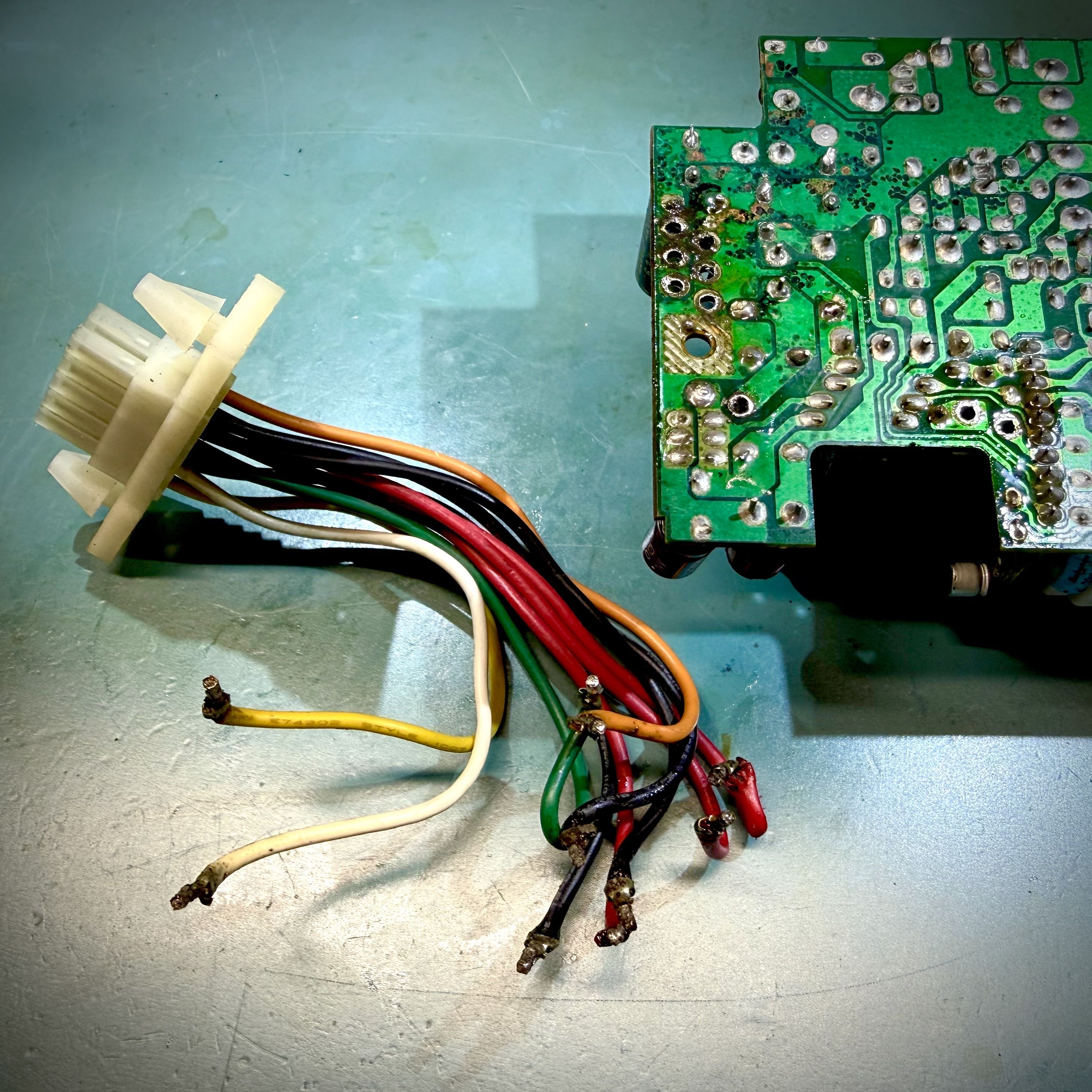

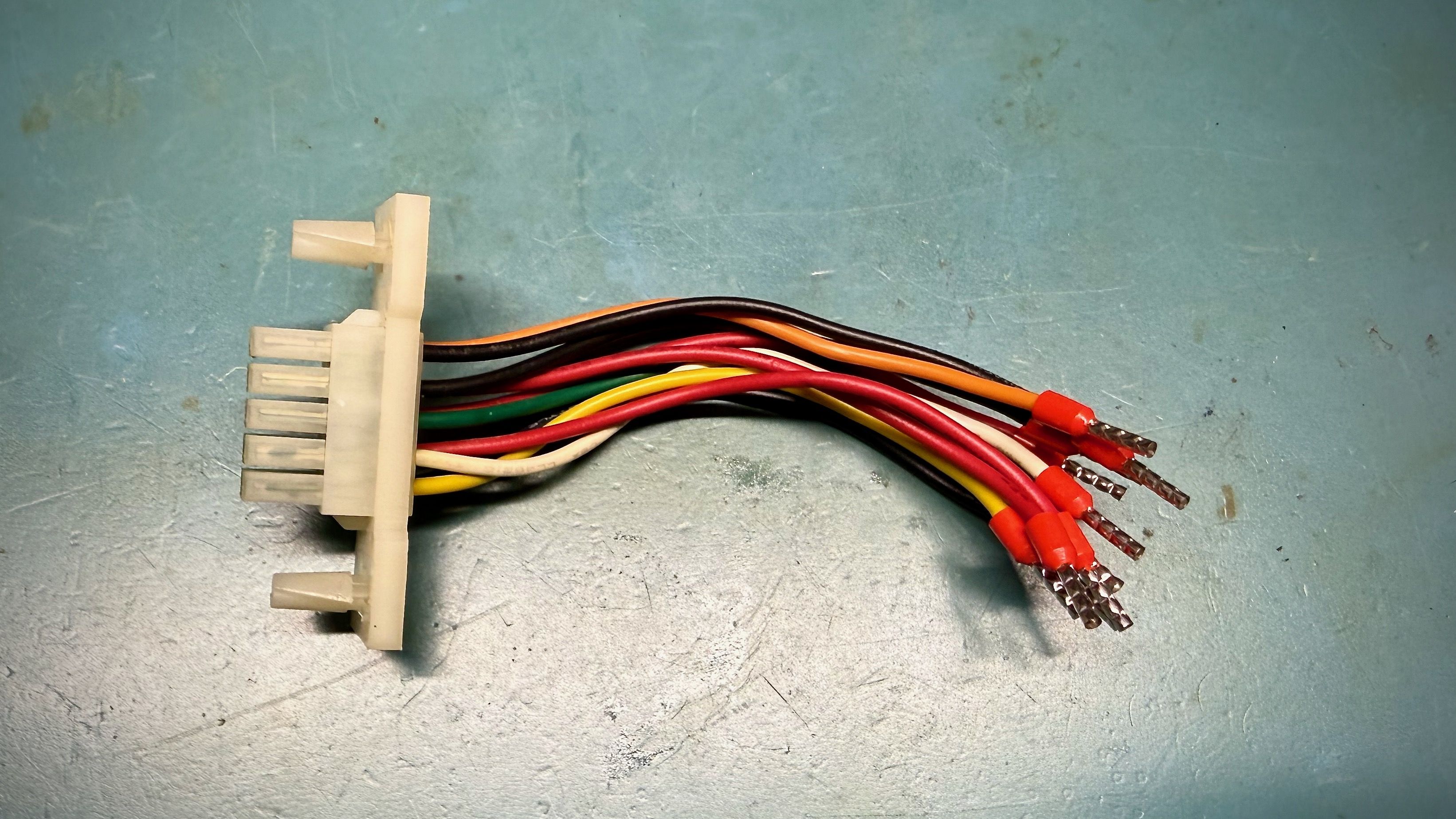

I had harvested the wiring harness off an old PSU, and the pins were a bit green. So I depinned all the wires coming from the PSU and cleaned them with a fiberglass pen and some IPA. I also cleaned up J15, which looked rough too.
After clearning, I tested again, and while the shutdown still didn't work, the power rails no longer flashed when I plugged the PSU into J15 and the sawtooth signal was gone. While cleaning helped, it did not solve the problem.
When triggering a shutdown from the Mac's menu, the signal on pin 9 dropped very briefly but then jumped back up. I confirmed that the computer would shut down immediately when pin 9 was grounded, but would immediately power back on when the ground was removed. After plugging this problem into ChatGPT, along with the pertient schematics, it recommended installing a 100k resistor between the base of Q1, a 2N4401, and ground, providing a better base pull-down. As with my eariler post on the IIusi replacement PSU, all the issues seem to flow back to Q1.
After putting that in place, the shutdown worked perfectly! I tested the new PSU on all five of the IIsi boards, and they all worked just fine.

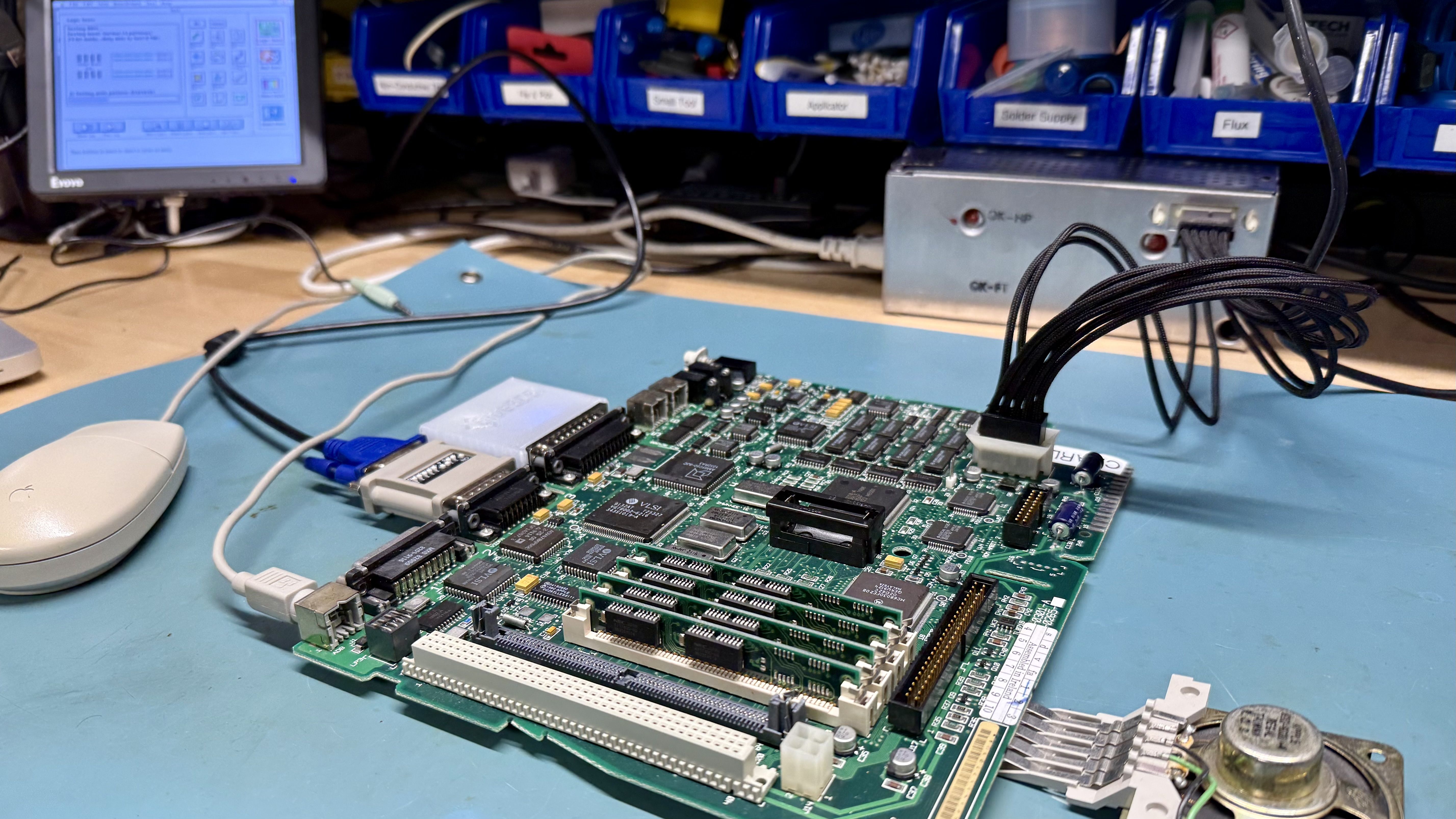

I pulled together the best of my working components and assembled a hero unit. I went with the Echo logic board because it looks clean and doesn't have any bodges. I put in four 2MB RAM SIMMs, to get the system up to 9MB. Then, I selected a clean non-yellowed case, picked a good floppy drive, hard drive bracket, fan, and the first of the Power Up IIusi replacement power supplies. I also installed the latest BlueSCSI v2 with a Pico W, providing WiFi capabilities.
To add a cherry on top, I installed my one-and-only direct slot adapter card, with its floating-point co-processor (FPU). This card extends the PDS slot at a right angle. Apple released another card (also with an FPU), to accommodate NuBus cards. When I installed the card, I heard the dreaded chimes of death, so I knew something was wrong. After looking at it for a second, it was obvious. The card's one and only electrolytic capacitor had leaked.
I replaced the cap, and I also pulled the nearby tantalum capacitor, to re-flow its solder. After replacing the electrolytic and reinstalling the tantalum, I cleaned up the nearby vias and removed any visible corrosion. I put the card back in the IIsi, and it chimed happily. However, I ran the FPU tests in Snooper 2, and the FPU failed. So, I pulled the card again, this time paying close attention to the FPU. I added flux and went around the chip with my iron, keeping a bit of fresh solder on the tip. The side of the IC next to the leaky cap was dull and questionable. I worked on all the vias until they were silver again. Then I checked for shorts on the FPU. I had to bring up a datasheet because there are a number of ground pins, but it toned out properly--giving me hope the chip had not shorted internally. So, I put it back in the IIsi, and this time Snooper reported good test results!

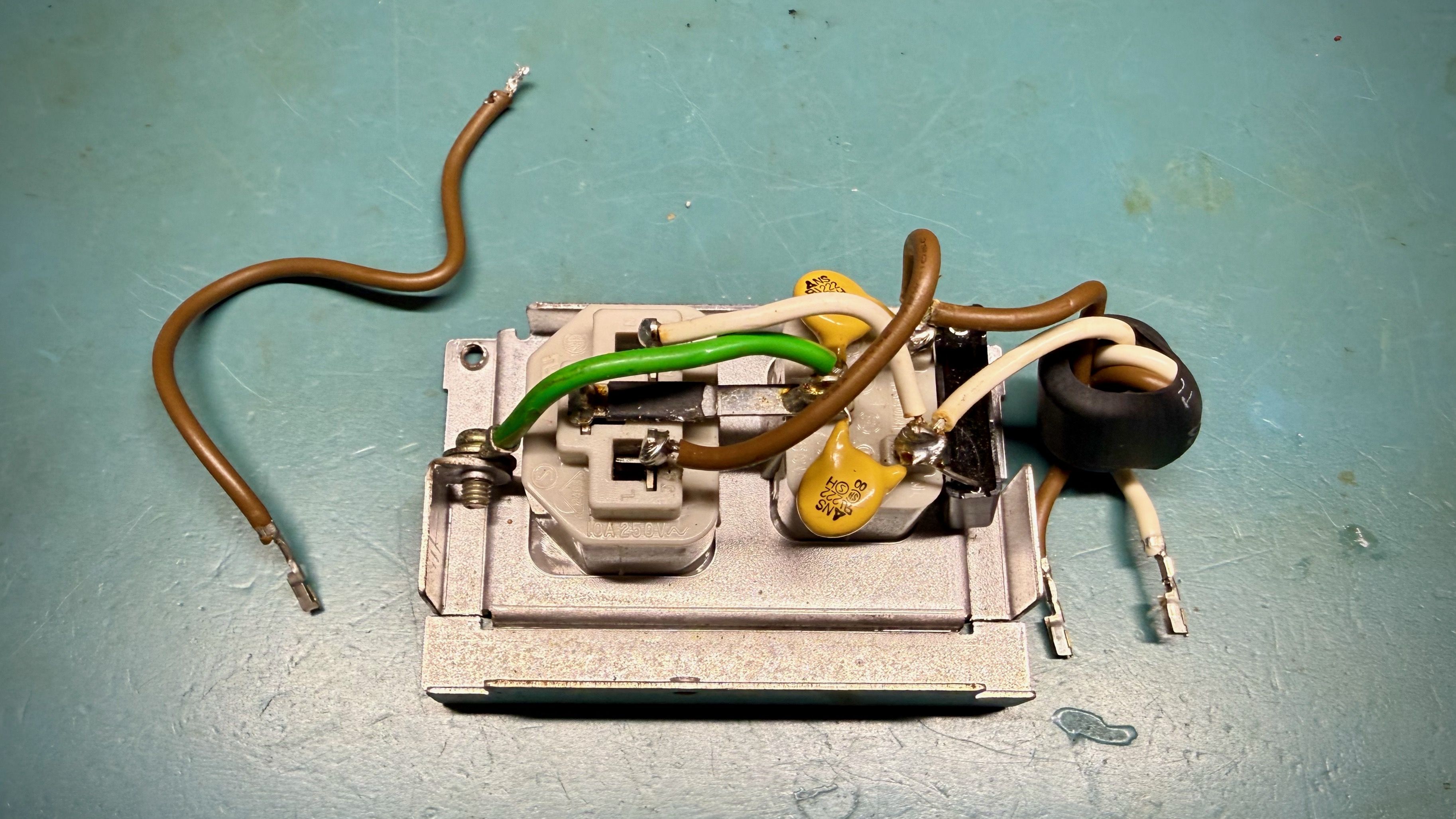

Then I harvested four power connectors from the old PSUs. I depinned each to clean up any corrosion and added ferrule connectors to the ends of cables. I then soldered them onto the PCBs.
Then I tweaked the mains plugs to wire the monitor receptacle so it was always hot, since the new PSU could not switch it on with soft power.
Finally, I put each into one of the original PSU cases and tested them. I was pleased that each provided good voltage and the IIsi passed all of Snooper 2's diagnostics while running on each of the PSUs.

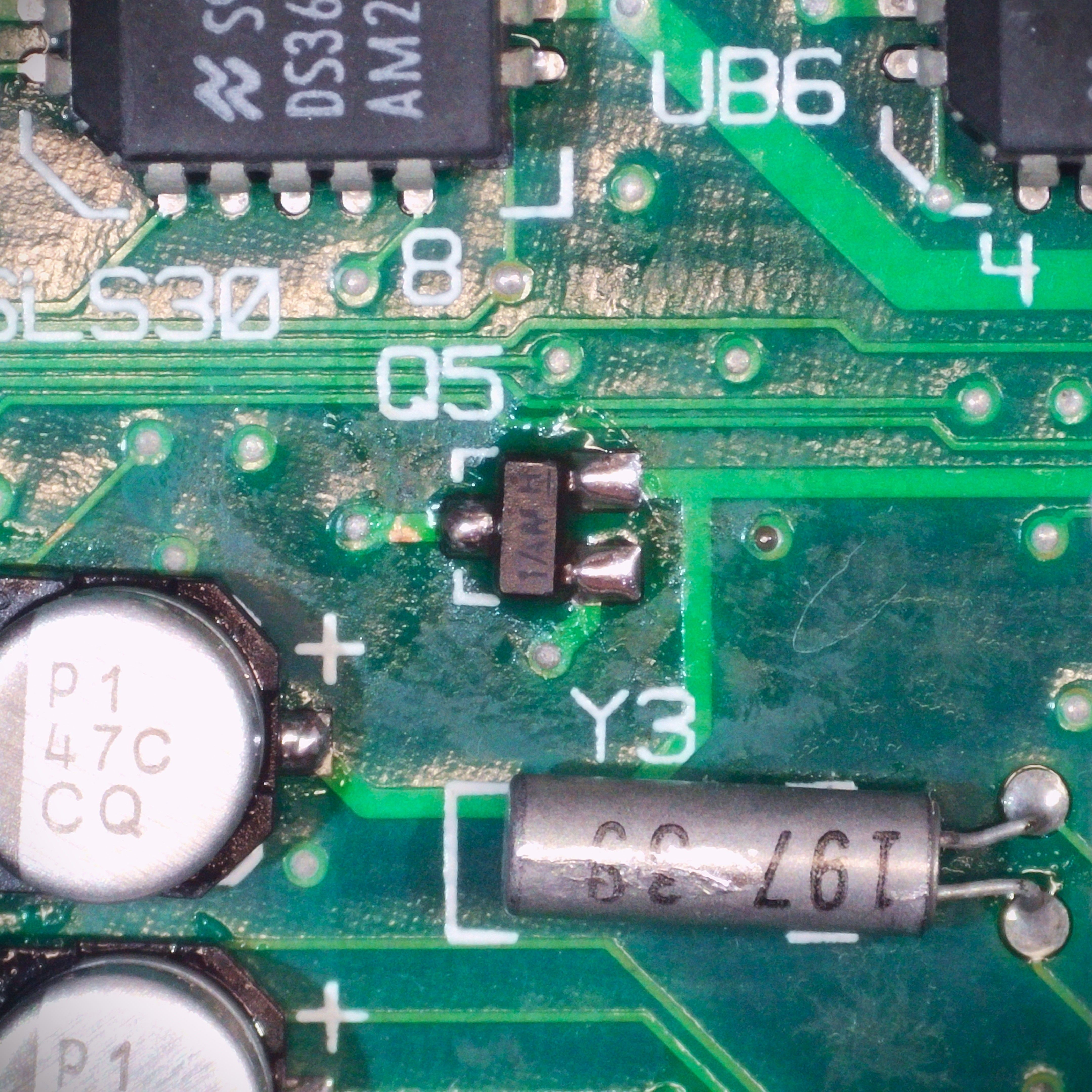

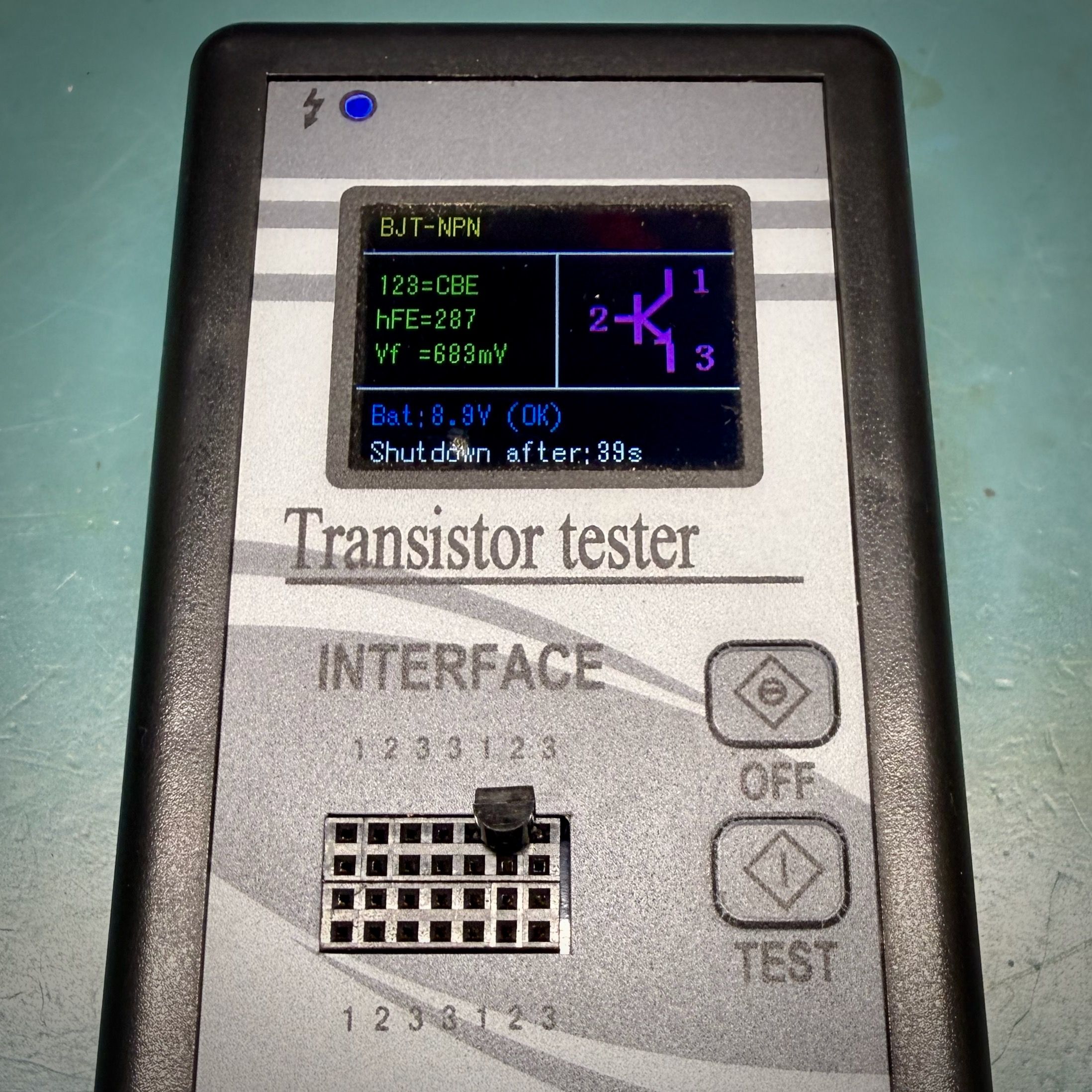

I pulled the PSU apart and checked every solder joint on the PCB and every connector. I could test if it would power on by sending 5V from pin 10 (Trickle) to pin 9 (PFW), which triggers start-up. From my new working Power Up IIusi, I knew I should hear the relay click and the LED on the PCB light up. After a considerable amount of time redoing most of my work, I was down to the transistor and resistors. I swapped the Q1 transistor with another 2N4401, but still nothing. So I pulled each resistor, which was a pain once the wiring harness and Mean Well units were installed. I checked each resistor's value, and they were fine. As an act of desperation, I decided to flip Q1 backward from the silkscreen since that had worked on the earlier IIusi design, and... it worked. The relay clicked, and the Mean Well units sprang to life.
I had tried earlier to test the transistor in my component tester before installing a replacement, but because of the close spacing of the through-holes on the PCB, the legs were too short to fit into the tester. However, after my backward replacement transistor worked, I soldered legs on the kit-provided transistor to test it. When I did, I found it had the same configuration as my replacement transistor. That means the placement was also backward from the silkscreen. This issue bit me again! I was not expecting this since I was using the transistor that came with the kit, and the other Power Up IIusi kit was just fine. Apparently, I received two different transistors with opposite leg configurations.
The lesson is, if you have an issue with the Power Up IIusi (either version), the problem is likely with the Q1 transistor.
