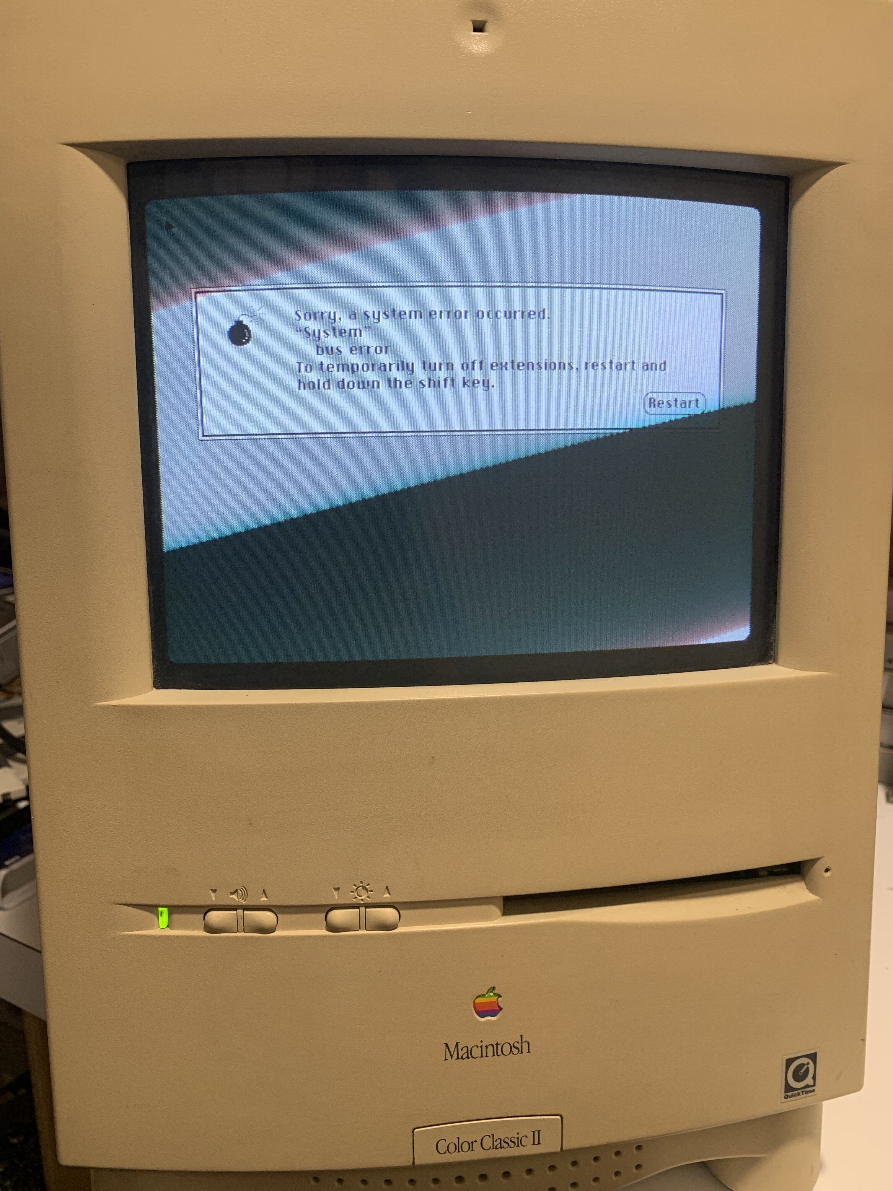

I purchased a Macintosh Color Classic II earlier this year and thought the 68030 33mhz would be enough for me. While it was great, I really wanted to try a 575 board in it (to make it a “Mystic”).
The board I bought looked clean and was promised to be working yet when I received it, I would get system bombs on boot. So I set it aside until today, when I was looking for something to do.
I recapped it. Letting it dry now. We’ll see if it works after.
I don’t plan to do the 640x480 alteration to the Color Classic chassis/analog board. I am first trying out the enabler hack to see if it works. If that doesn’t make it work I will be doing the resistor swap on the board to change the resolution.
Any input welcome as I’m new to the Mystic side of tinkering.

I thought I had a hacked system folder for this but I’m getting a bomb on boot.
Could the hack not have applied or do you think this is a hardware problem?
Since my LC575 board is a spare I purchased just for my CC to swap in I did the resistor mod to lock in the resolution for that board. I can still swap in my CCII board if needed and it keeps the chassis ready for testing customer boards as well.

The solution is to remove the 000 resistor at r116. I managed to also remove the pad by accident. Oops.
Then install a 4.7k ohm resistor at r109. I stole a “472” resistor from a dead LC475 board. Apparently you can also use a 000 resistor here but I chose to go with the desired method.
First boot it worked without any ResEdit hacking. Just how I want it.
The Color Classic II Mystic upgrade is complete and a success. I can now boot into any standard OS install without hacking the system file first. Bliss !!
