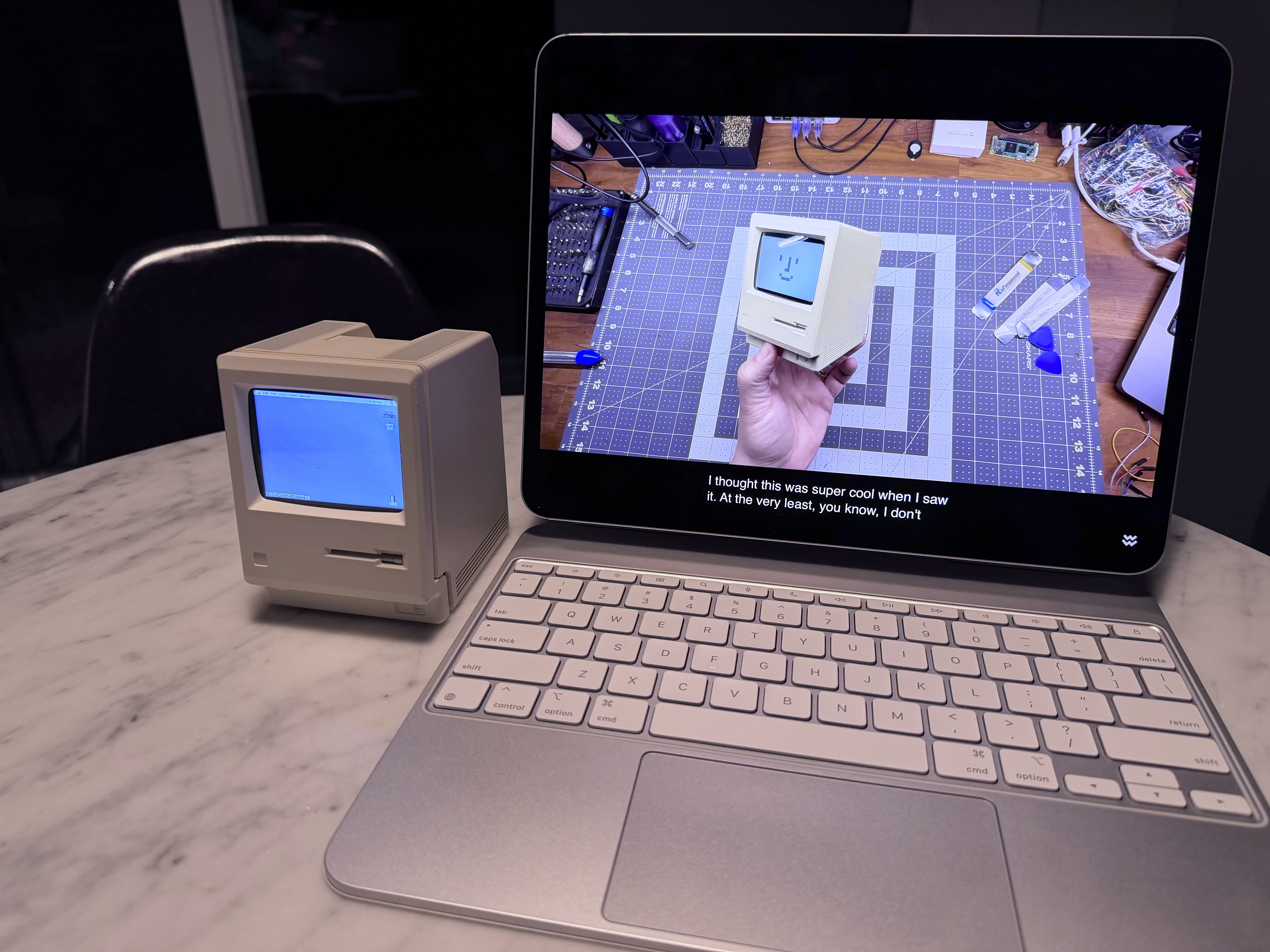

I was hoping to share during MARCHintosh but sharing now that I finally got things over the finish line.
Similar to others (notably Sideburn and Colin, and others I'm sure), I built my own mini Macintosh using one of those Maclock clocks from AliExpress. I decided to go the route of designing my own custom PCB that replaces the clock completely, and brings brightness control, buttons, sound, and power (both USB-C and battery).

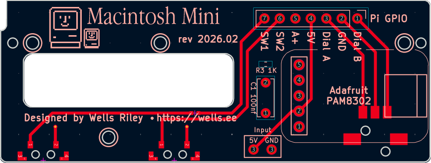

I'm a novice with circuit design, so the implementation is basic and there's certainly a lot of room for improvement. Regardless, I wanted to share my project with you all to hopefully inspire you or help you build your own. I'm not selling the boards or any premade assembled Maclocks, but you can order your own boards from PCBway for a very reasonable price.
I posted a written guide on my GitHub, as well as a full assembly walkthrough video:

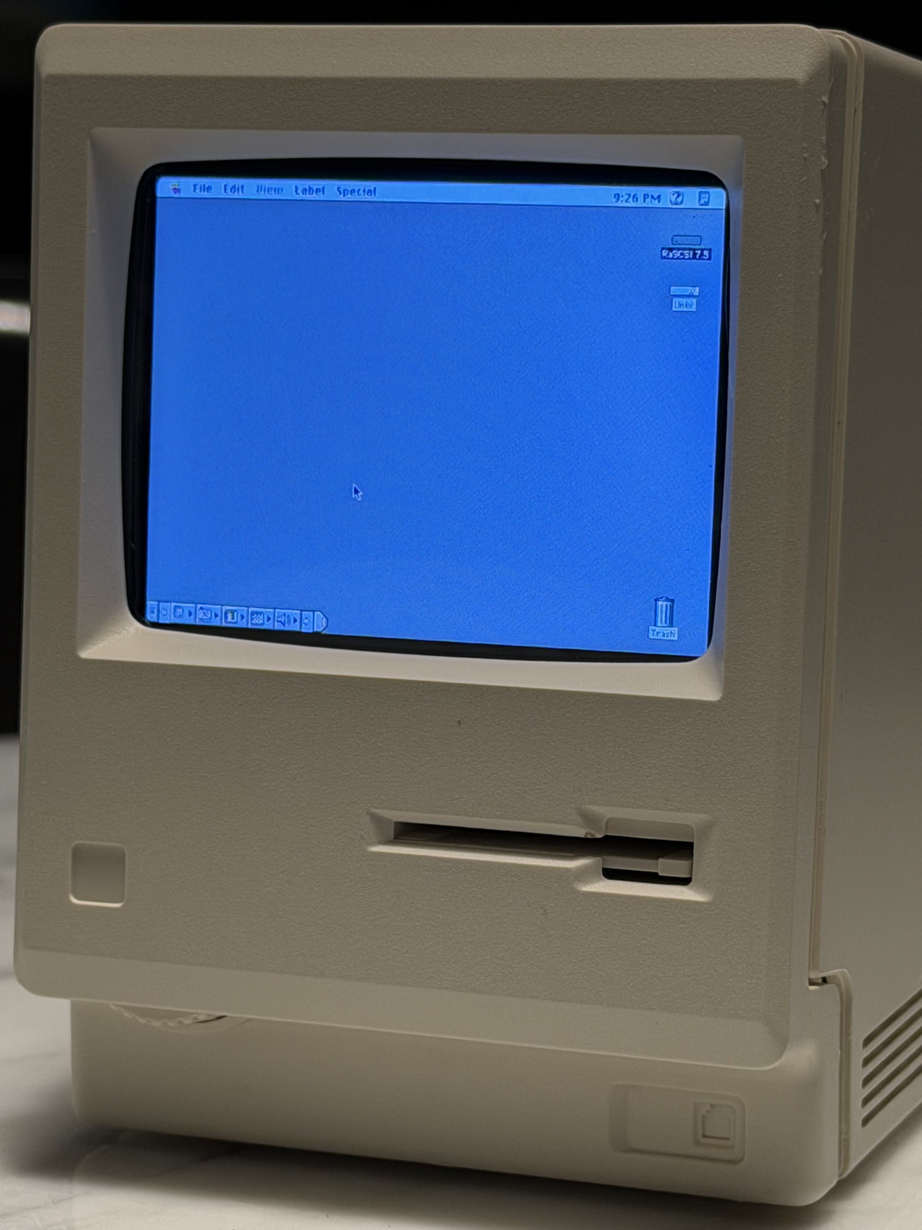

On the software side, I wanted to run a more modern Linux kernel and SheepShaver Basilisk II (see update below) rather than the Mini vMac guides I've seen posted online running on Bullseye. With some doing, I finally got it to run.
If you want to follow the same steps I did, I have my Macintosh Mini install guide, and it includes an automation script that installs the emulator, sets it up to run at boot, adds the button/brightness controls, and even a user-selectable boot chime—all in one shot. (Disclaimer: yes, I did use AI to turn my written guide into the automation script. If that's not your jam, the written guide is just as complete... it just takes longer!)

PS: if there's enough interest, I'd be willing to organize a group buy for the PCBs and passive components on the board.

The video showed up in my feed this morning. You did a great job, both with the project and the video. I was impressed with the thoroughness of the documentation. Very professional. I'd be interested in a group buy, if that takes off.

The use of Sheepshaver indicates this is a PPC emulated machine, and that would explain the use of OS 8.1 in the opening post video. Not an issue at all, just something I noted.
I’ve never been able to get Sheepshaver to work on my modern Macs, but I’m pretty sure it won’t boot into System 6 (just a note for those who even care) because not even Basilisk II (a 68K emulator) will let you boot System 6.

Small update: I finally found some time to experiment with Basilisk II + Performa 580 ROM and the performance is significantly better and more stable than my original SheepShaver implementation. Kudos to everyone who suggested I try this path.
Updated guide and install script here: https://github.com/wr/macintosh-mini
If you've run the install script before, you can run it again to cleanly upgrade from SheepShaver to Basilisk II. You'll need to provide a new ROM file (I used 064DC91D) and possibly a new disk image (if yours is PPC only), but the 8.1 image I was using works just fine.
If you're running it for the first time, Basilisk II will be the default, though SheepShaver is still an option if you need to run PPC apps for whatever reason.

I’m on my way to doing this project. I ordered 5 of your adapter boards from pc way. I just need to find some one who can 3d print a bezel adapter to mount for the screen/lcd … any one ? Anyone out there who can 3d print a few for me ???
DM me your address and I'll send you a few.
I should have posted this sooner. I have 4 extra boards if anyone needs one. However, I'm about to be away from home for 3 weeks, so it will be a while before I can ship. I could also print the mounting frame for those who need it.

Having taken up @wottle on his offer above, I am also on my way with this project using @wells board. I'll post a photo or two when I get a chance, but so far, here are some thoughts:

  2. This has been a good soldering project. The resistors @wottle shared with me were perfect, but tiny. I wear contact lenses and they definitely needed to come out for this part! I don't have a hot air station, but I was able to easily remove the rotary encoder and tactile switches using chipquik alloy. Chipquik is a godsend for making very fast work of components that require you to move the iron around to get everything free. It is a low-melt solder that blends with existing and keeps everything molten for a very long working time. The parts came off with no problem. You just have to wick away any residue so new solder is nice and strong again.

The script ran perfectly, I assume, while I did other things. When I came back the SSH had disconnected but I could see messages that it had finished. The little Mini Mac was flashing "?" which means it worked! I have a dummy disk image.
I was able to mount a network drive and copied over a disk image that worked great. Damn, this thing is cute!
