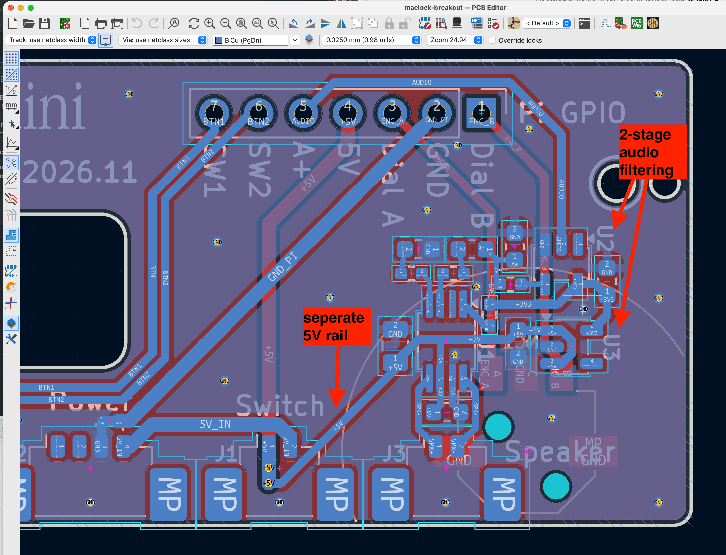

This new interposer board plugs in between the Pi and Waveshare

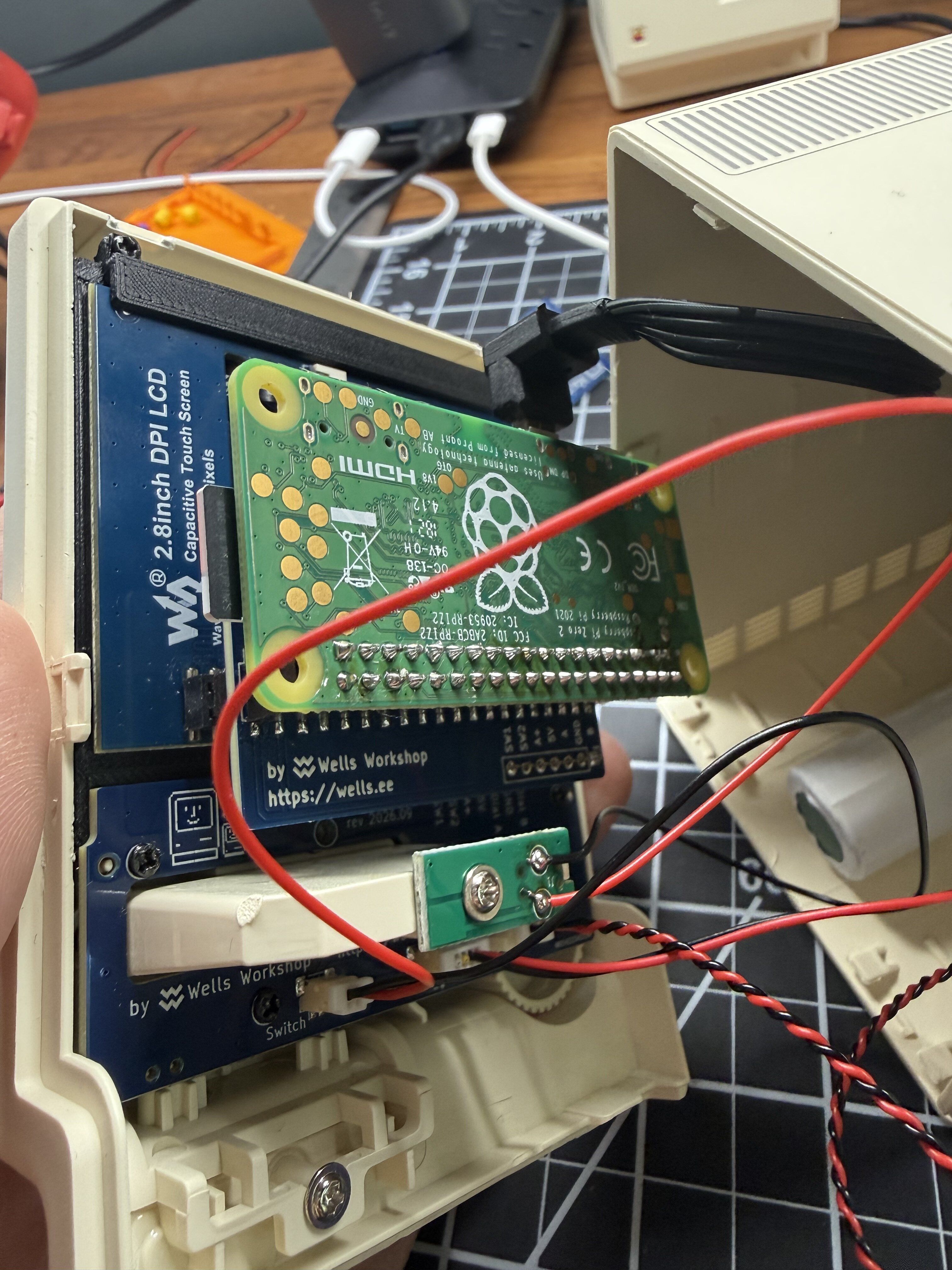

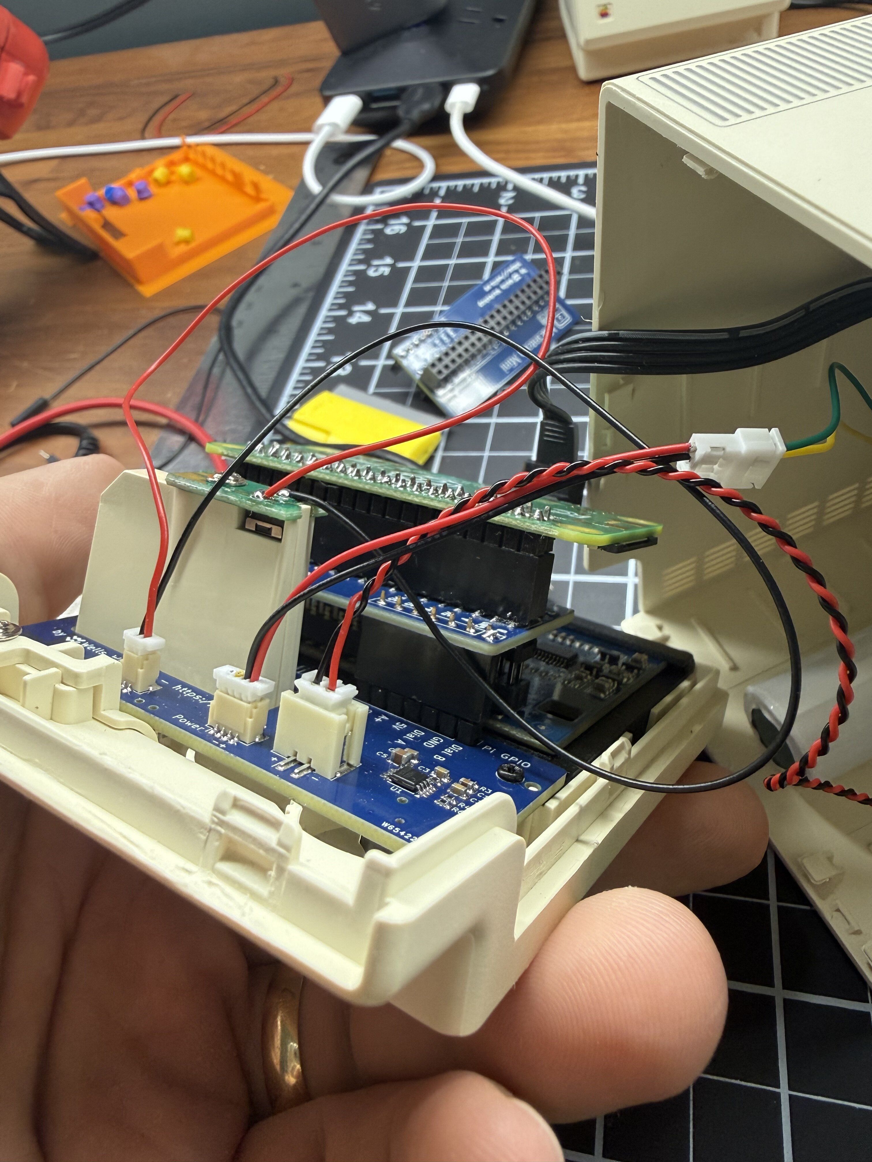

My Pi didn’t have headers, so when I added them, I simply skipped the relevant pins. Then, once attached to the display I went in and soldered my wires in the locations needed. No bending, but certainly fiddly, especially as I needed to reconcile GPIO pinouts with diagrams turned upside-down and backwards. Talk about double, triple, quadruple checking. . . that was my biggest challenge when the only way to know if I did it right was the final test. This eliminates the guesswork. Nice!
