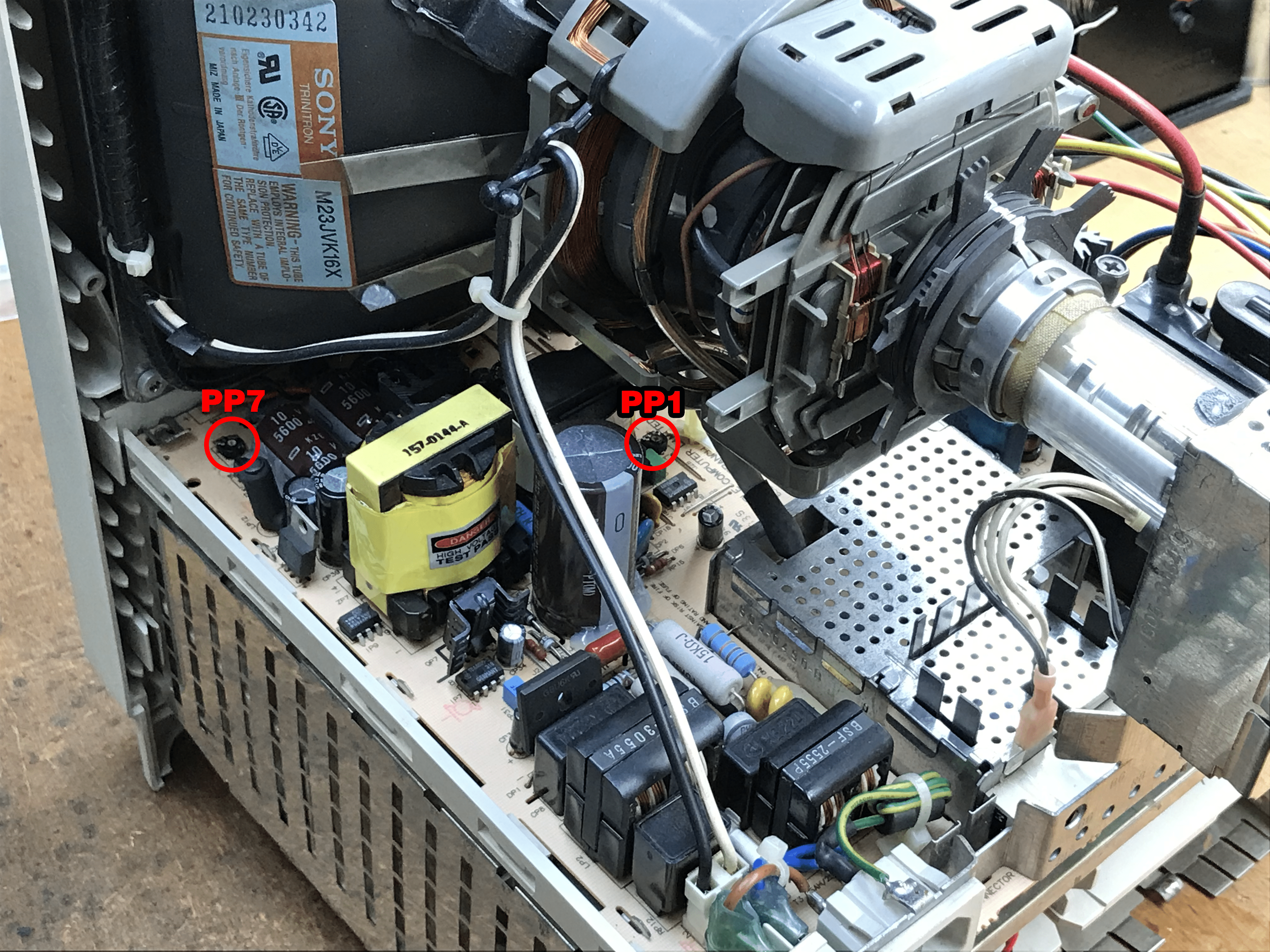

@JDW No, I thought it was impossible to change only 5V. It was a long time ago so I don't remember much, but I think it was the voltage adjustment before the regulator input. In other words, there is no function to adjust only +5V.
I also noticed that rather than taking +5V from the SCSI or SWIM connector line, it's better to take it from the MOLEX 4pin HD connector, it's pure +5V direct from the analog board, with no diodes or fuses. . Well, it doesn't matter which one you prefer.

SCSI TRMPWR should not be used as a measurement because of the diode, but I think @JDW's readings are valid.
I'm not all that interested in what comes off the Molex connector.
What counts is the voltage around the CPU, RAM and VRAM.
@Kay K.M.Mods Though there may not be a control for only 5V, is there one which affects 5V?
Yeah, What I meant is that the Molex HD connector goes straight to the analog board, nothing in between the 5V and 12V. Because of the structure of the Color Classic, it can be taken out from the back, making it convenient for measuring voltage.
I'm not good at English, so I'm sorry if there are any wrong expressions, but I express that we can do whatever we like.
Hummm...I can't imagine anything controlling only 5V...

In an earlier post in this thread, @Kay K.M.Mods said that PP7 changes the 5V rail and something else, but he didn't specify what else. I assume 12V too, but maybe something else also?
Also note that @Mu0n wrote this 68kMLA post about voltage adjustments where he indicates that PP1 changes the 5V rail, but that seems to conflict with what POWERCC says here, which says that PP1 only affects "+60V, +24V & +8.4V". I wrote him a PM to ask for his feedback in this thread, but he hasn't replied, so I will send him PM over the the 68kMLA right now to ensure he sees what I am asking. I want to know all the facts from people with first-hand experience (not just hearsay) before I start fiddling with those POTs. I haven't touched either yet.

I found your 68kMLA post about voltage adjustments. You seem to indicate that PP1 changes the 5V rail, but that seems to conflict with what POWERCC says here, claiming that PP1 only affects "+60V, +24V & +8.4V". Which POT really affected the 5V rail, and did you turn it clockwise or counter-clockwise, and about how much did you turn it? (I'm trying to figure out what PP7 does versus PP1, before I touch anything.)
Thanks!
Hey @JDW. I won't be the one who has the magic solution to your issue, that is a certainty. Whatever progress I've done on the CC has been annihilated in the last months since I can't get my CC's CRT to energize anymore. The best I can do is to get back the correct soft power mechanism going with the keyboard. You should not treat me with any deference on this topic.
PP7 is the one you turn to affect the 5V rail in real time when it's powered. I don't remember offhand if clockwise increases or the other way around, but it was not that extremely twitchy that you'd break things if you mistakenly went the wrong way if you go slow. You can follow its traces all the way into the logic board. I wrote notes on a piece of paper months ago noting where I got GND and +5V, can't find it atm.
I did attempt to turn PP1 a bit out of desperation (trying to get a stable image with all colors), but that got old fast since I never risked it while the AB was installed in the chassis, it's too close to the CRT gun and various other things. I just brought it back close to its initial orientation based on reference photographs in the end.
Thanks for the Feedback. Sorry to hear that. Do you think the problem you have now with the CRT resulted from your fiddling with those two POTs?

No. After fiddling with the pots, lots of reflowing and various other things happened over the course of a few weeks. Then I got a working state for a few days. They are not involved.

Hmmm. Those Sony Trinitron CRTs are built to last "forever." Energizing it should not be the problem unless it is not getting enough voltage. IIRC, it requires over 10k volts whipped up by the flyback to deliver sufficient energy for the firing of the photons. Could the pathways be messed up where the power fizzled before arriving at the photon gun part of the CRT?

Who knows. I don't have confidence in measuring that side of the machine (don't have the tools) and after months of not getting help, I've put that aside. Also, electron gun, the photons happen once they hit the phosphor side.
