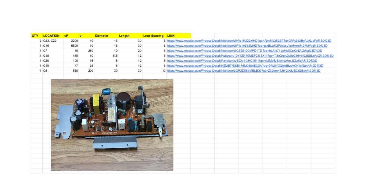

No videos, but have been working on getting a 7100 up and running. Started out with a 7100/66 that I picked up early last month. This was the machine that had the capacitors that had corroded severely, yet seemed to run ok otherwise. I wound up retiring it, and picked up a 7100/80 from Ryan Cook (the guy who's the son of the people who ran Sun Remarketing) that was incomplete. Kludged it together with the power supply, floppy drive, and video card from the 7100/66, a drive chassis from an early IIvx (aka P600), a Quantum Fireball TM 1.2GB drive, and an Apple CD 600e that I bought from Brett B. over at the other site. Had a couple issues when I first got it up and running, mainly my forgetting that the CD-ROM drive needs to be unterminated when the hard drive needs to be, so it would start up, then the hard drive would act like it had sticky bumper syndrome and spin down. But, whenever I'd reboot, the drive would spin up. Got that sorted out, and the machine is running. Hard drive apparently came out of a 6100/66 and has System 7.5.5 on it. It will be getting upgraded to 8.1, and maybe even 8.6, depending on if I can find where I put the 8.6 disc.

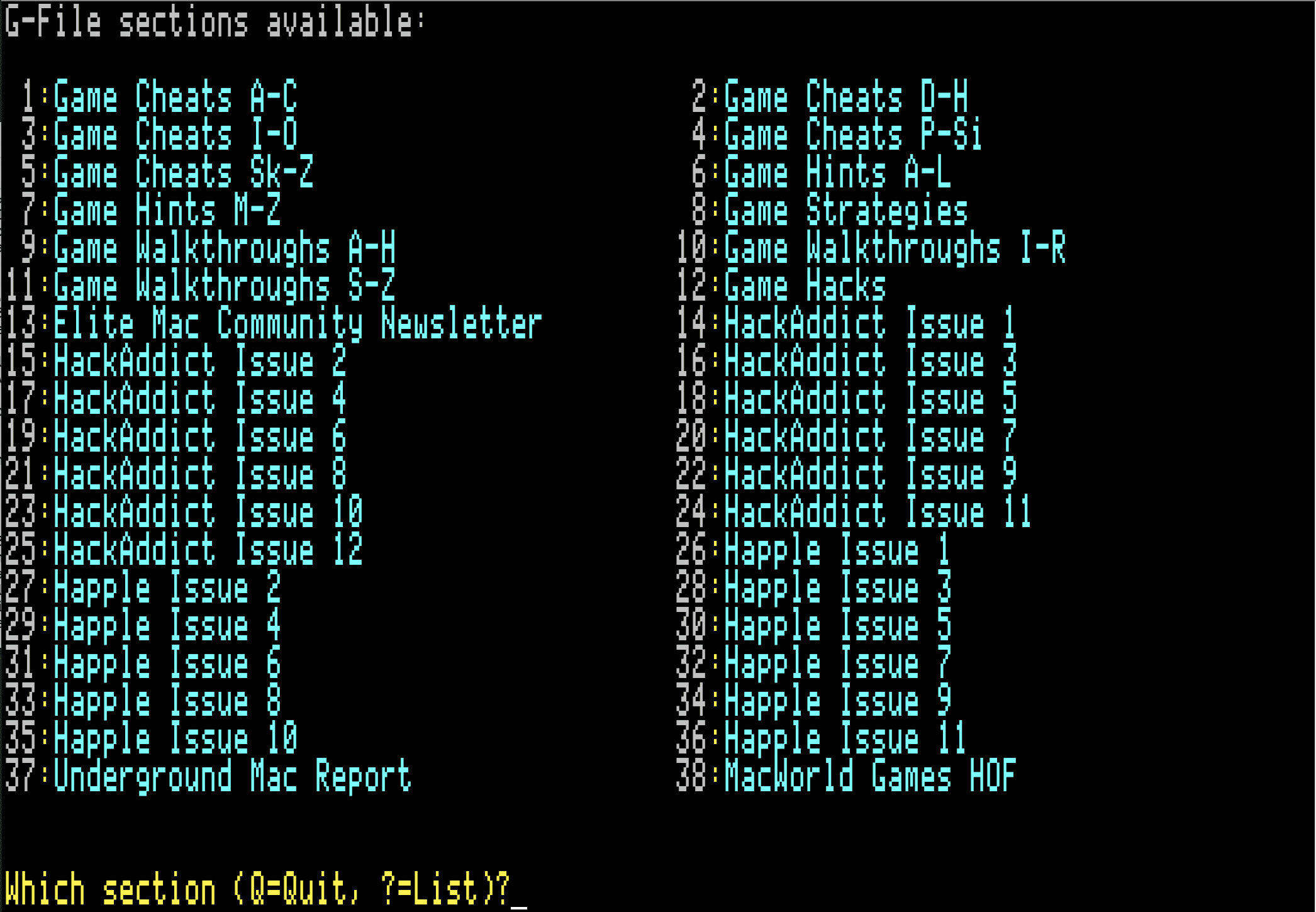

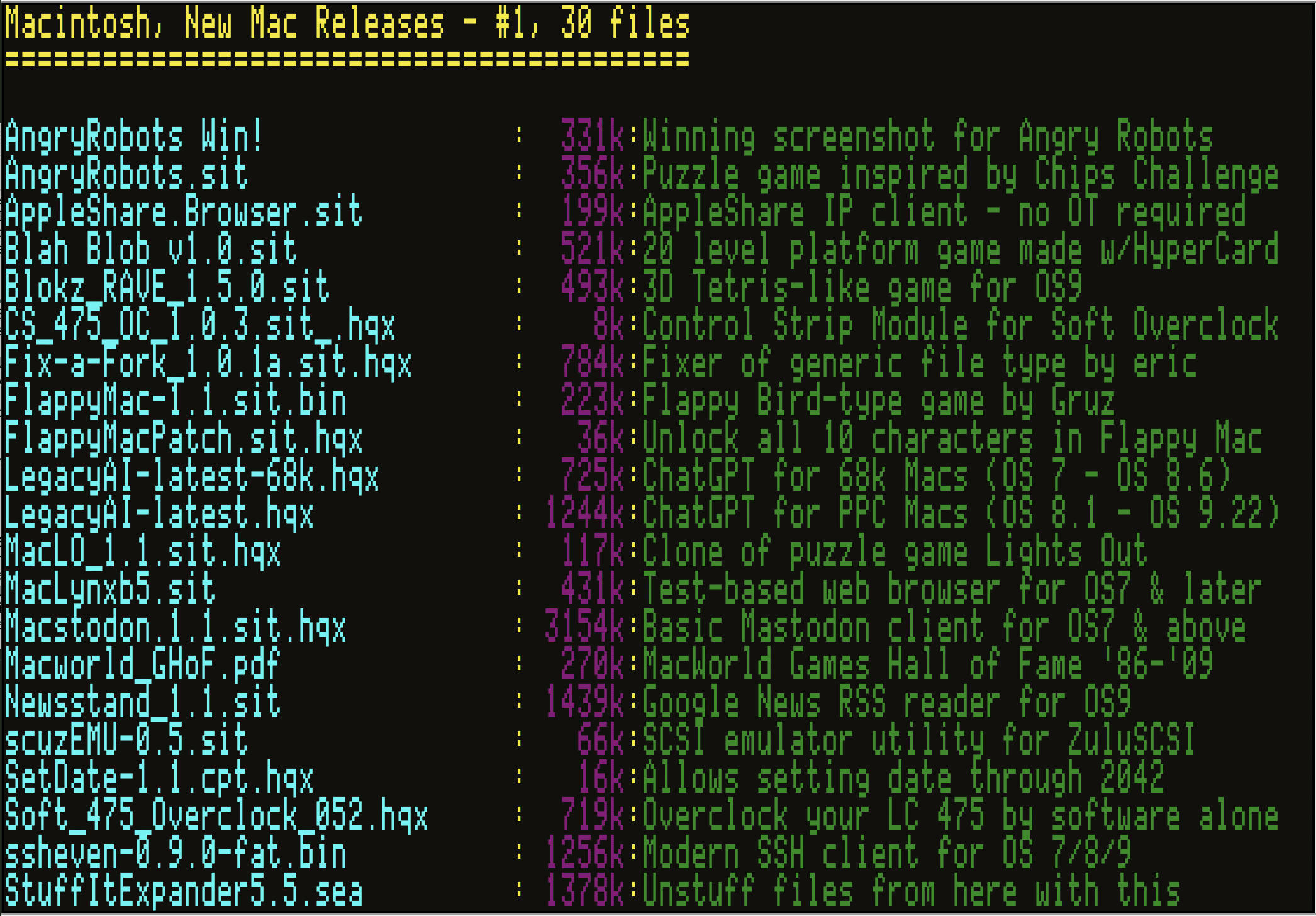

The Crow's Nest BBS, running Hermes II v3.1.1 on my 40 MHz 68040 Carrera-accelerated Mac IIci with six wifi modems hooked up to a CSI Hurdler II 4-port serial NuBUS card, is back again for #MARCHintosh! The same IIci hosts my GlobalTalk zone. The original project is detailed here.
What's new this year?
  • Downloads have been updated with the latest vintage Mac software releases, which I don't think you can find anywhere else in one place. I also finally figured out how to add file descriptions.
  • Added the Macworld Game Hall of Fame winners from '86 to '01 to the GFiles section.
  • There are now a total of 23 original Hermes door games to play in the Externals section.
  • Thanks to Will Price (original programmer who recently reacquired Hernes) and Sidd Hartha, we now have a clean crack of Hermes v3.1.1 so everything works as it should!
  • Got rid of the dial-up modem as nobody ever called it. :cry:
View attachment 20460 View attachment 20462
Node one is up and running now so telnet over to crowsnestbbs.ddns.net:6801 today! Nodes 6802-6806 will be up starting March 1st. As usual, use ZTerm with a wifi modem-equipped Mac, or Black Night with a networked Mac to connect. PM me here if you forgot your password from last year. Hope to see you there!
