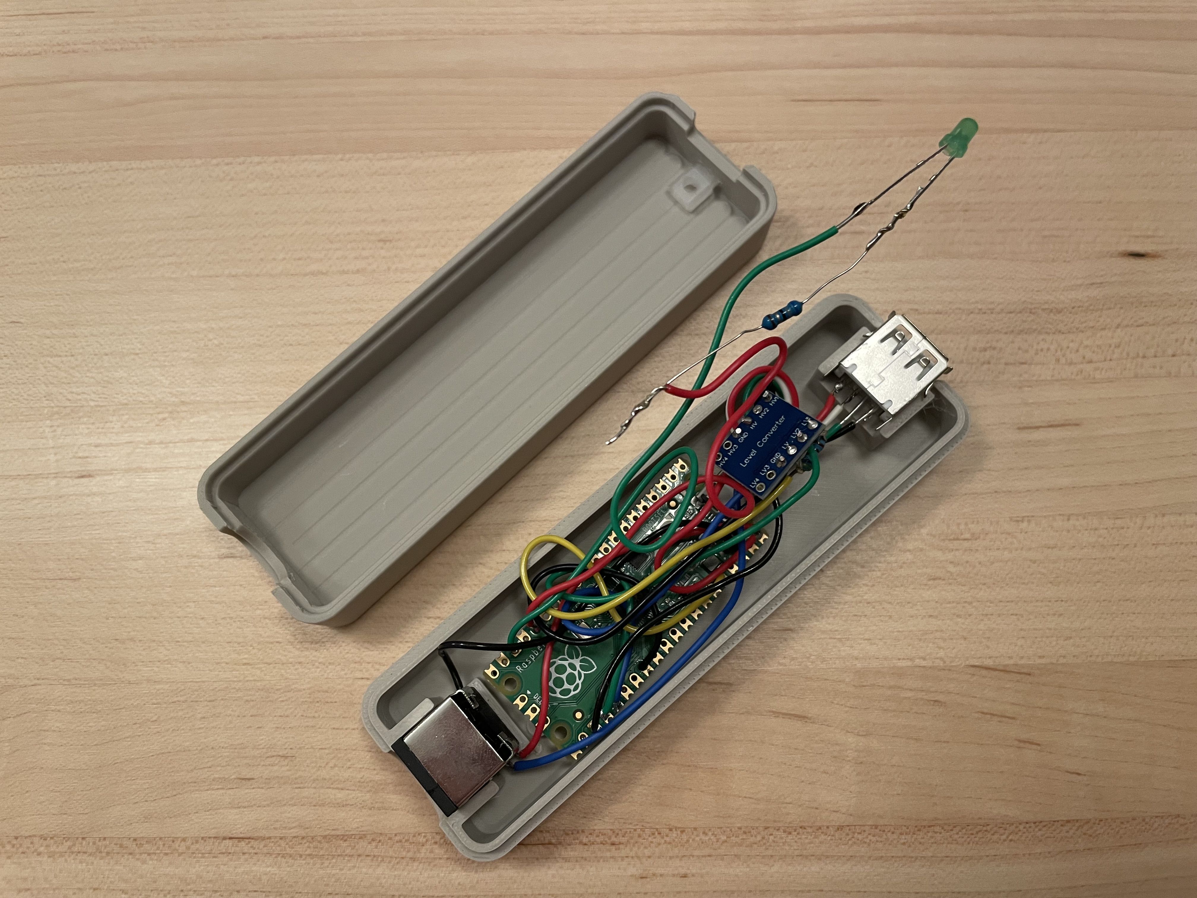

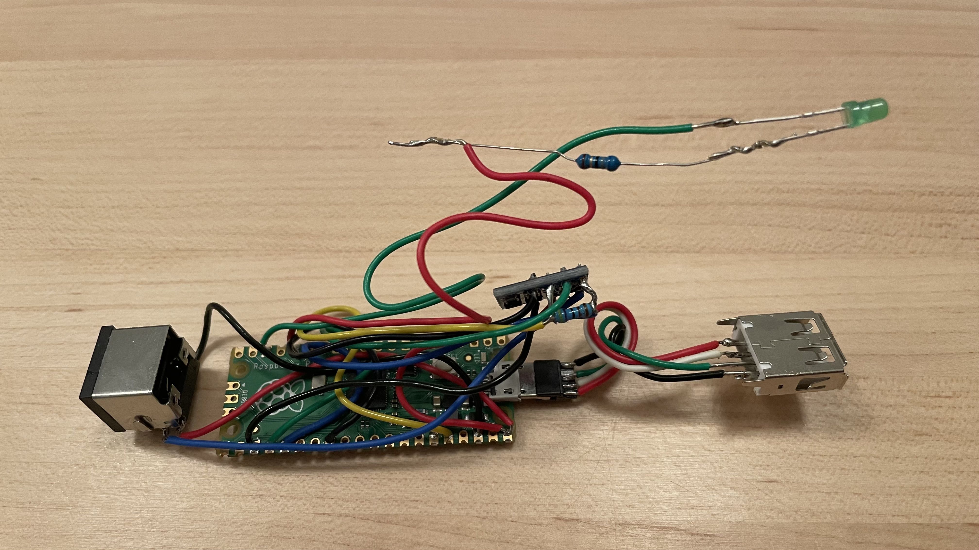

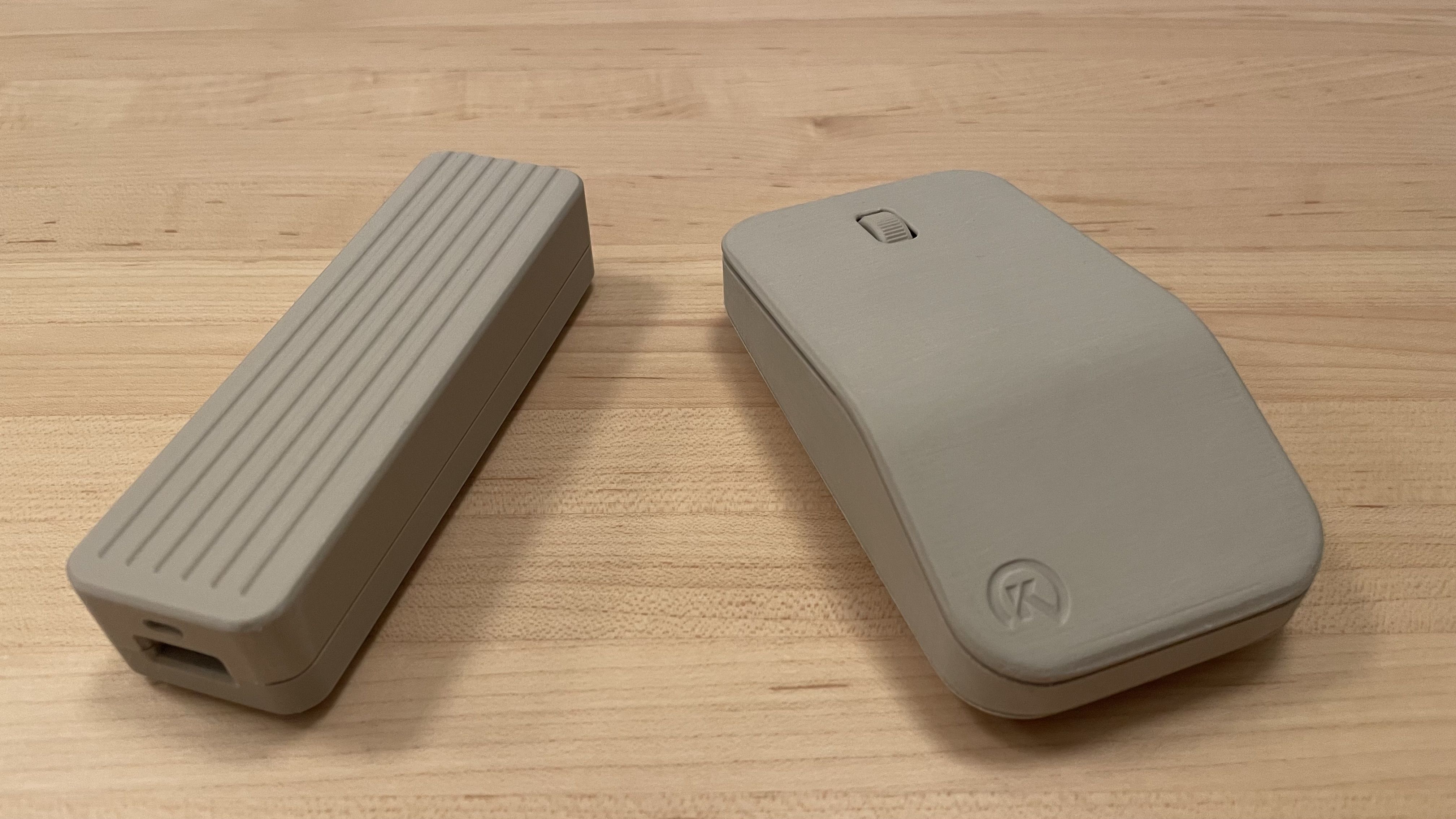

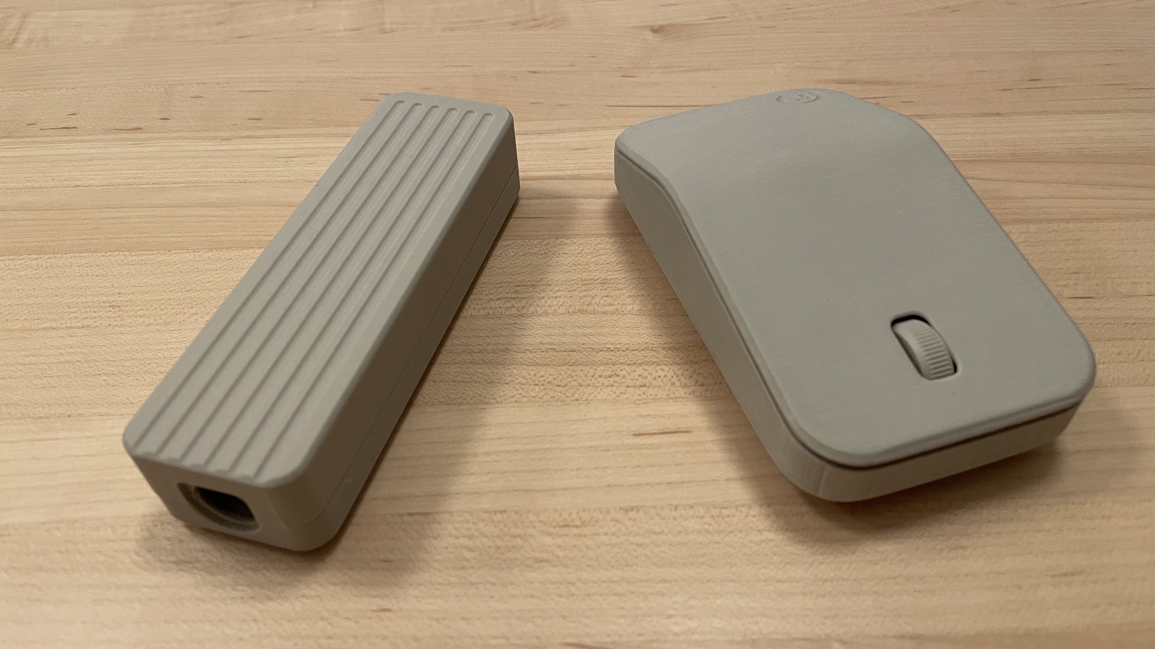

Even though I already have a bunch of projects in various stages after seeing this YouTube video by Kevin Noki on a modernized take on the original Apple ADB mouse I felt compelled to build one! I also built his aesthetically pleasing USB to ADB converter (based on QuokkADB by Rabbit Hole Computing) which was the harder part!) #MARCHintosh!
View attachment 20864 View attachment 20865
After triple checking the wiring, it works! I got impatient tonight wanting to test so that LED wiring/resistor will have to be reworked but yay!

Original Bamboo lab Makerworld MH002 3D Printed Wireless Mouse Model Components DIY Creative Models-Compatible with Bambulab P1P/P1S,A1/A1 Mini,X1/X1C/X1E 3D Printers-Prints NOT Included
Polymaker Matte PLA Filament Muted White 1.75mm 1kg 3D Printing Filament
SUNLU 3D Printer Filament 1.75mm, 1kg Spool, Transparent PLA

I have been looking for a project like this. I finally got the parts and soldered one up, and the LED displays correctly, and it works great with a mouse. But anytime I try to plug in a keyboard, it either does nothing or freezes up the mac. Hotplugging a mouse on the USB side works fine (don't hotplug the ADB side ever). I thought maybe the D+ and D- were swapped so I swapped them... then I get nothing. Any ideas?

I had a similar problem with mine when using with my Performa 575, USB keyboard didn't work when a USB mouse would. Tested with the Bamboo lab MH002 3D Printed Wireless Mouse, a Raspberry Pi USB Mouse, and a a Raspberry Pi USB Keyboard.
Odd thing, when I test with an original LC everything works... Not sure what to make of that but since I mainly intend to use it with the Bamboo lab MH002 3D Printed Wireless Mouse I haven't looked into it further. I did post a comment about its on the Makerworld page for the USB2ADB Converter DIY
I def don't think D+ and D- would be the issue, if they were swapped it wouldn't break differently for a USB mouse vs. a USB keyboard, they use D+ and D- the same way as understand it.
