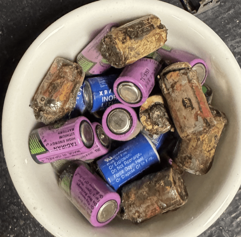

Has anyone every had an exploded Made in Israel TADIRAN?
Honestly, every time I come across them, they are intact. They were designed to survive. Maxell, in contrast, designed them to die. Their battery engineers did an excellent job at that. Not only do they die, they try to take whatever they're attached to with them.

I was thinking the same when I was going through my exploded batteries and the intact ones. All the horrific ones were Maxells.
However, as I was thinking I have never found a Tadiran battery leaking, I did come across one that appears to have started leaking. However, given the state of these machines, it’s possible it was actually in a flood and it wasn’t leaking as much as maybe some residual rusting. I’ll see if I can find it in my bowl of disaster.
There's a special place in 🔥👹 stoked daily for Maxell battery engineers and their managers who approved such horrific battery designs. Those people should be ashamed in light of the collateral damaged they deliberately caused. I highly doubt TADIRAN battery engineers were especially brilliant or use secret materials extracted from the Ark of the Covenant. No, Maxell was cutting costs, giving no concern for the future. I love capitalism and profits, but have some pride in your work, man! Maxell has no shame.

Thank you for the photos!
What I deliberately wrote was based on seeing what most everyone else in this hobby perpetually sees (primarily Maxwell brand exploded batteries which take out many a machine), so my deliberately severe reply reflects the severity of the problem. I don’t think it can be said something was “obviously not deliberate.” We are all speculating based on examples of the problem we have seen personally, which removes “obvious” from the equation. If one brand explodes more than others, there must be a reason, and such reasons are tied to the original design. And if a design made key sacrifices to be lower cost, then it could effectively be argued that lesser design was “deliberate.”
I also disagree with the “no one” speculation because when I design something I really do indeed give thought to how it will hold up decades in the future. Some vintage Mac hobbyists do that in their own designs too, stating how only polymer capacitors are used and not fluid filled caps that will leak.
The bad design decisions of the past (and yes, Apple played a role in that) should not only be condemned but they must serve to instruct us on what not to do moving forward.
While “any battery can leak,” Maxwell seems to be the brand that leaks the most based on my own experience and seeing hundreds, if not thousands of photos of destroyed motherboard photos with Maxells I them. The problem is not exclusive to Maxell, but they top the list.
Even so, we need to find out what percentage of PRAM batteries were Maxell, versus Tadiran, Varta and other brands. Because if Maxell was the brand chosen in 50% of or vintage Macs, then that would go a long way to explain why we see more exploded Maxells.
I do appreciate you posting about two leaky (and therefore deadly to the motherboard), Tadiran batteries. Thank you for that. Those two experiences alone don’t put Maxell in a vastly better light or prove Tadiran are just as bad most of the time, but it does answer my earlier question and shows that at least some of the Tadiran brand can bust through their seals as well. But we would need a lot more Tadiran batteries bomb photos to get a clearer picture of just how many of that brand explode over time versus Maxell. The fact that Maxell batteries have become notorious is not mere talk generated by me but a well know fact based on all the battery bombs we’ve all seen.
It might be good if we dissect unexploded batteries to see how the different manufacturers constructed the body to hold in that fluid.
Simply put, battery bombs destroy old devices. That is severe because not all collateral damage can be repaired, which is why so many brilliant people like @Kai Robinson, @Bolle and others have painstakingly created Reloaded boards.
Brands aside, just as you pointed out, old batteries are all ticking time bombs which are not our friends. And while we need to get them out ASAP, the reality is that due to age, many have already done their damage, unfortunately.
I feel for @wottle right now because he is wading through battery bombs in that huge lot. But it looks like there are some gems in there too which can clean up well, like the IIfx board which thankfully was spared the bomb.

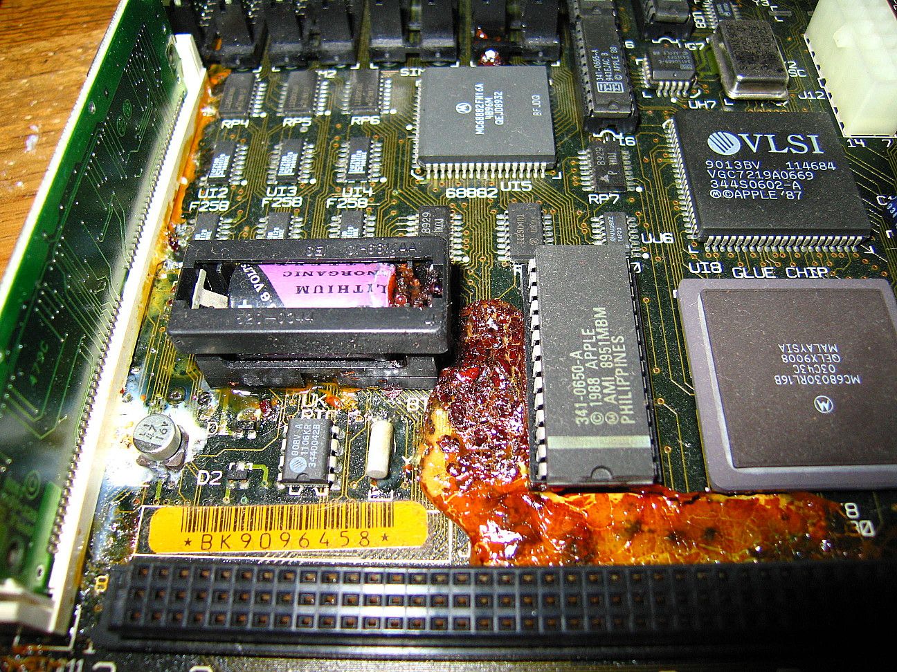

Yes, in one of the SE/30 machines I picked up during my big conquest in 2012. (edit, I see that @3lectr1c beat me to it...lol)
A more blurry image showing what it looked like when I lifted the battery off the board, trying to pull the battery out of the holder...

I definitely agree that the Maxells leak the worst of any of the brand Apple used (I have a page here going over them all: https://macdat.net/repair/kb/batteries_macintosh.html). Maxell and Tadiran are the most common in vintage Macs, followed probably by Sonnenschein (the blue ones) and SAFT (the white/black or white/teal ones). Saft appears to be the next worst after Maxell.
I just think it's doing a lot of speculation to suggest that Maxell deliberately cost-cut something when we don't know what went on in their R&D building back in the day - it could have very well been a design element that Maxell thought would extend the life of the battery that ended up making them leak in the long run. Or another problem in the supply chain that didn't have anything to do with them. Or it could be that they cheaped out on something - we don't know. In any case, just get 'em out :)
