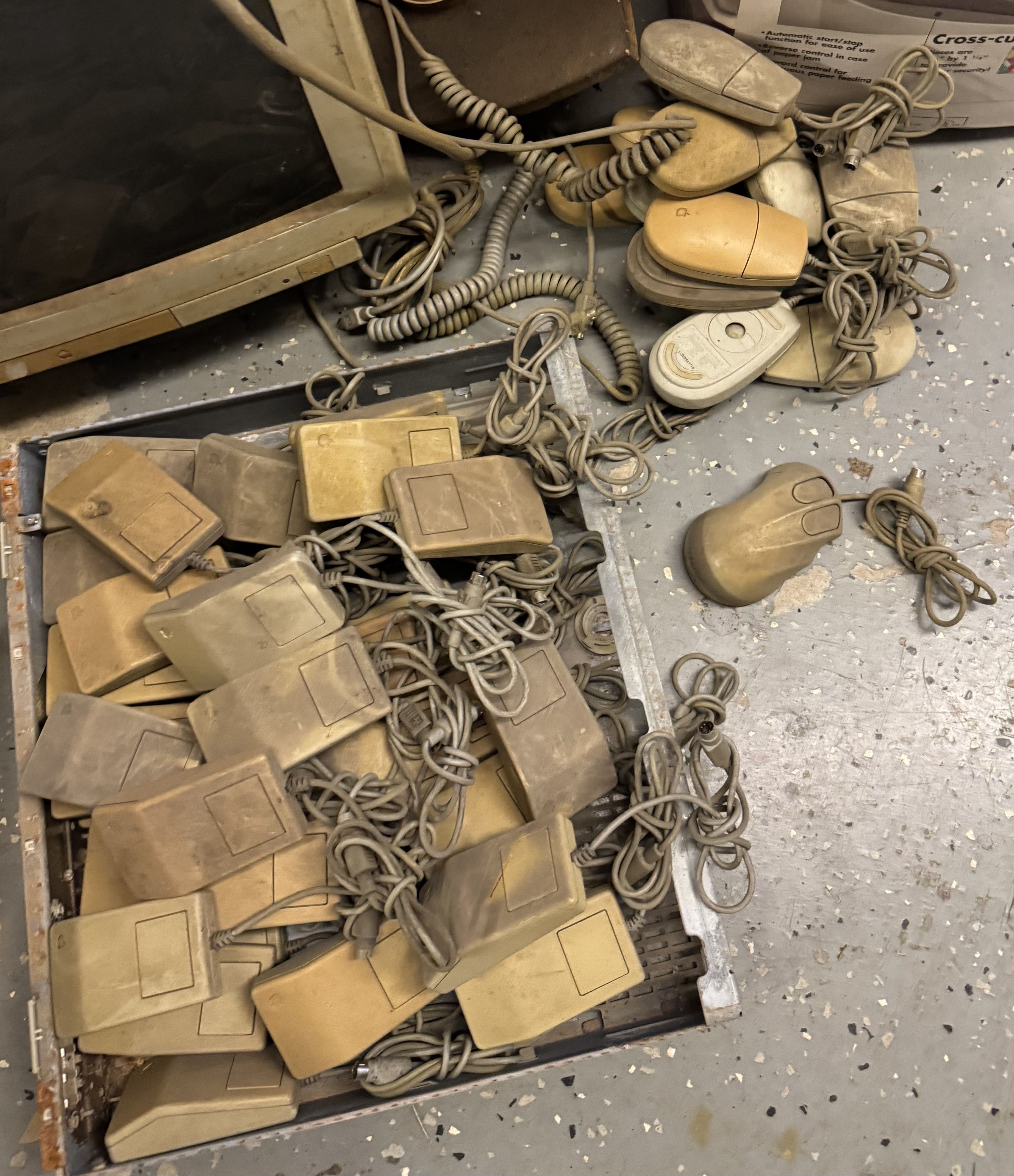

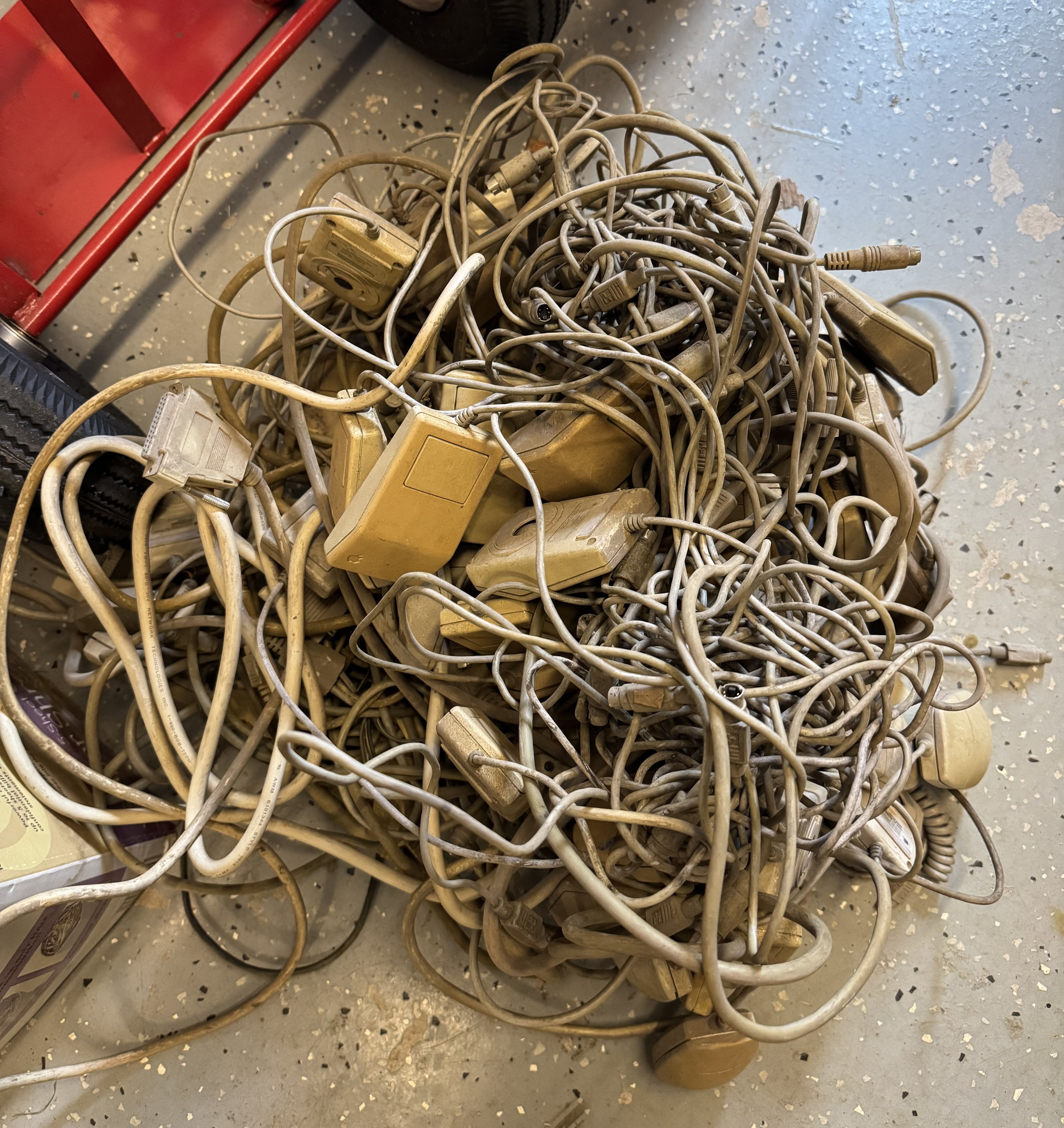

Just a couple of updates. First, for anyone that expressed jealousy about this find, I would just like to remind you what I'm dealing with. Here was the collection of mice that was given to me in an equally dirty box:

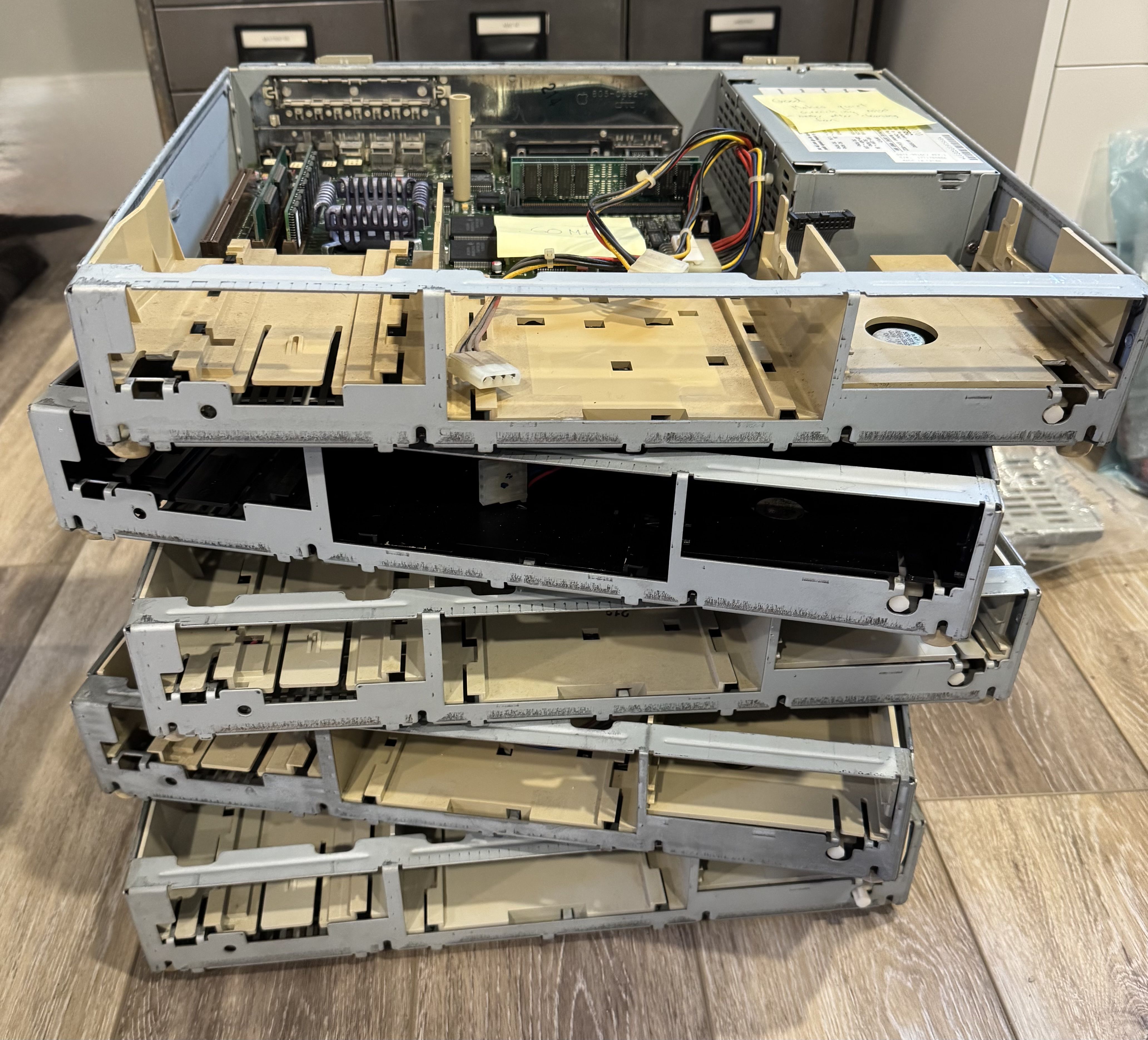

I was able to get them all separated, and will have to spend some time disassembling and cleaning them.Most of them were the original Apple Desktop Bus Mouse, but there were a handful of the Apple Desktop Bus Mouse IIs. Also, a double buttoned ADB mouse that I need to find a ball and cover for the bottom. Also, not pictured, I did get 3 Apple Macintosh Mouses, (1 with no ball or cover for the bottom). I plan to use the insides of those to put in the 3d printed cases (compliments of @Stephen ) that are in the mail on the way. One printed in clear, and one in black...

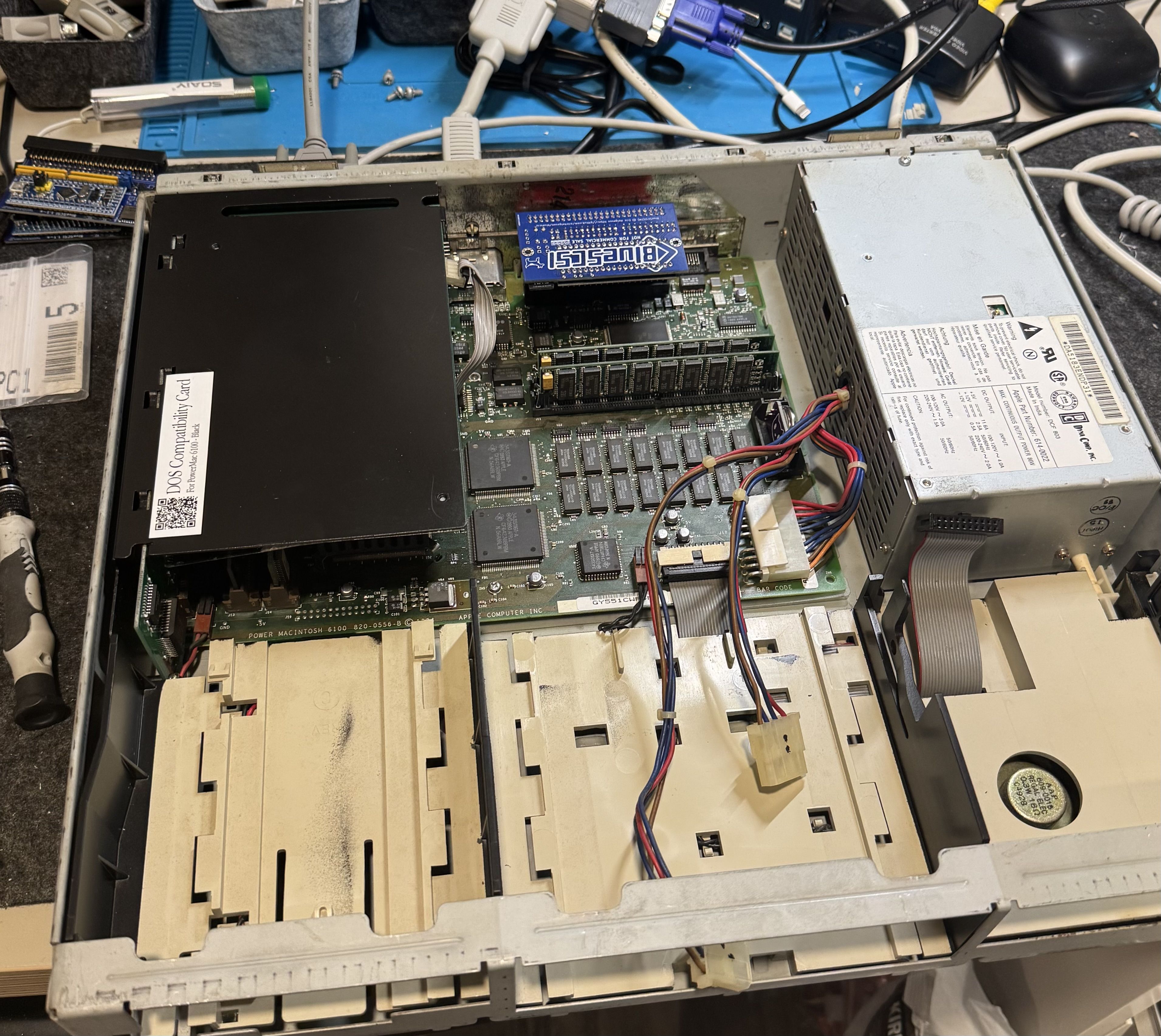

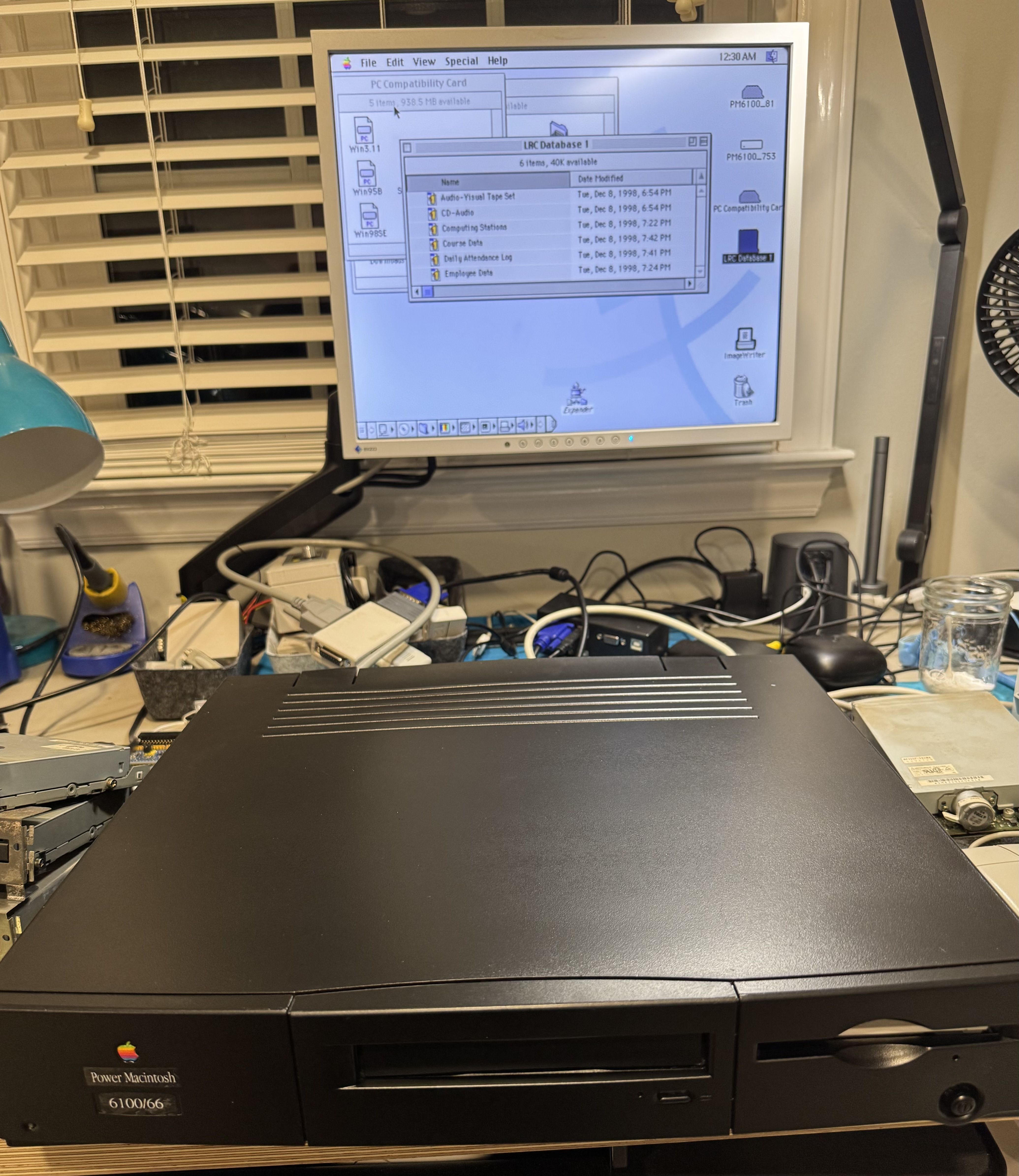

I have my completed black 6100/66 with DOS card in all black (still waiting for my JLCPCB order of BlueSCSI v2 to arrive to hopefully have a hard drive solution. I restored the floppy drive and the CD ROM is working. I will try to come back and recap the CD 300i Plus in it, but I've got to start clearing out some of these machines because the clutter is driving me crazy.
View attachment 19383View attachment 19384View attachment 19386

That is definitely a Rat King of mice!

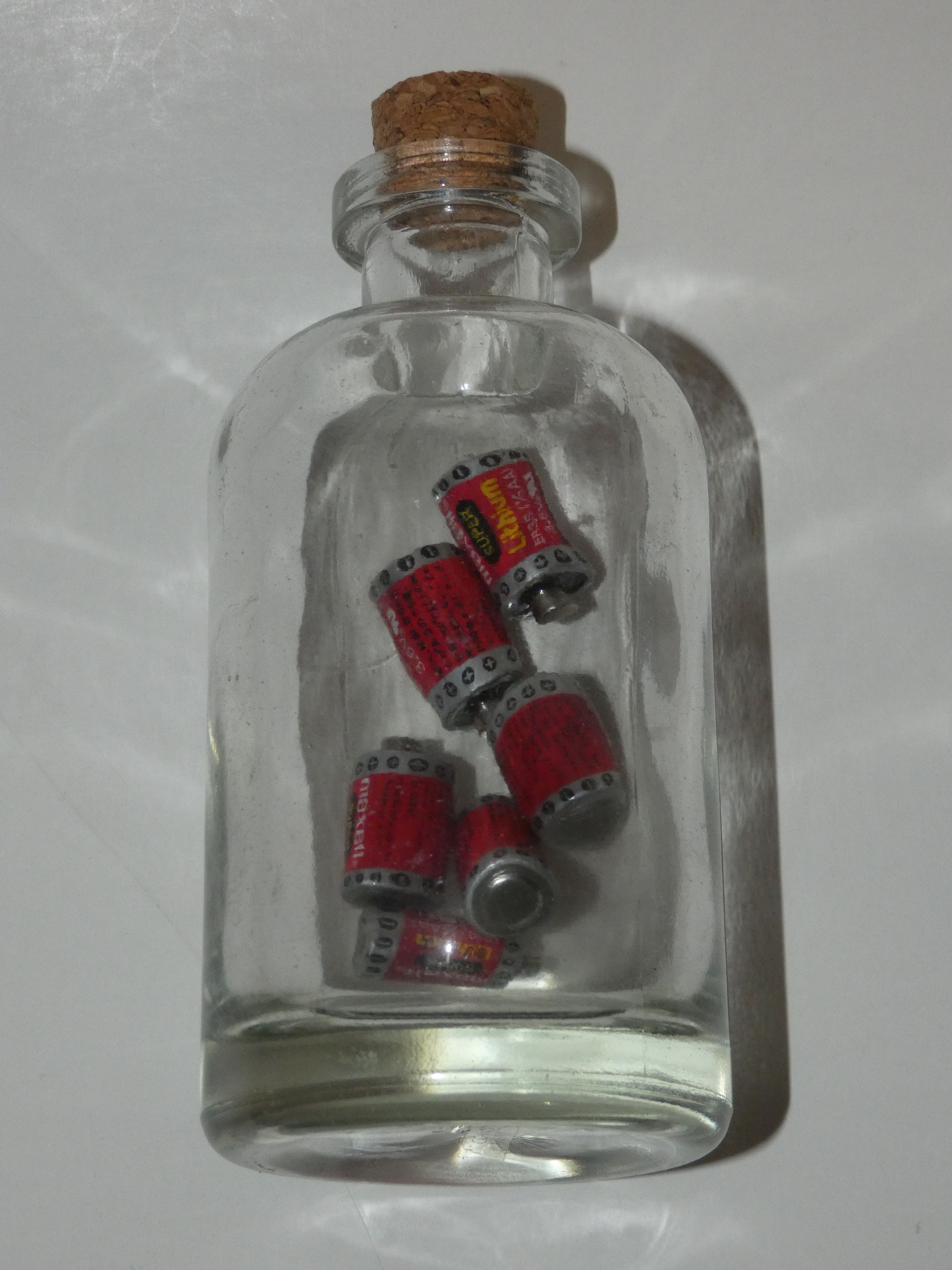

All my MAXELL pulls are in this cork stoppered glass bottle. Been waiting well over five years for the first one to 'splode. Hoping it'll set off a chain reaction in the containment. 🎆
BTW, LOVE what you did with that fx board, fabulous!
Oh, if you want them to fail, you might need to put a load resistor on them. Sat in a jar they're less likely to do anything.

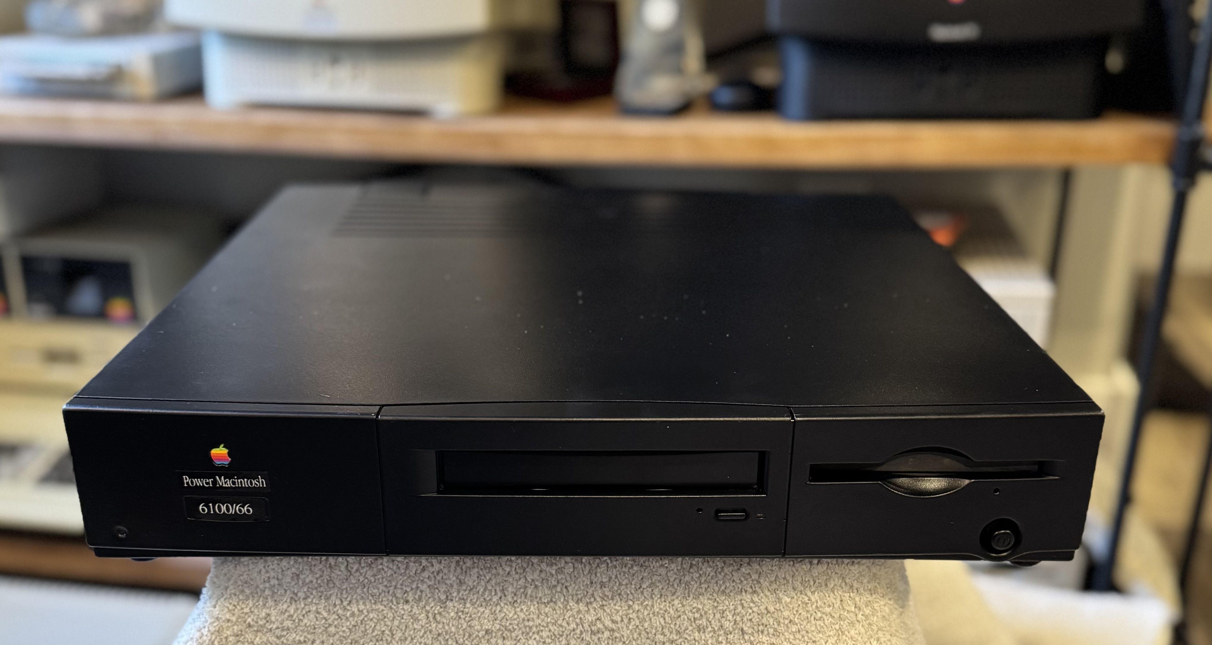

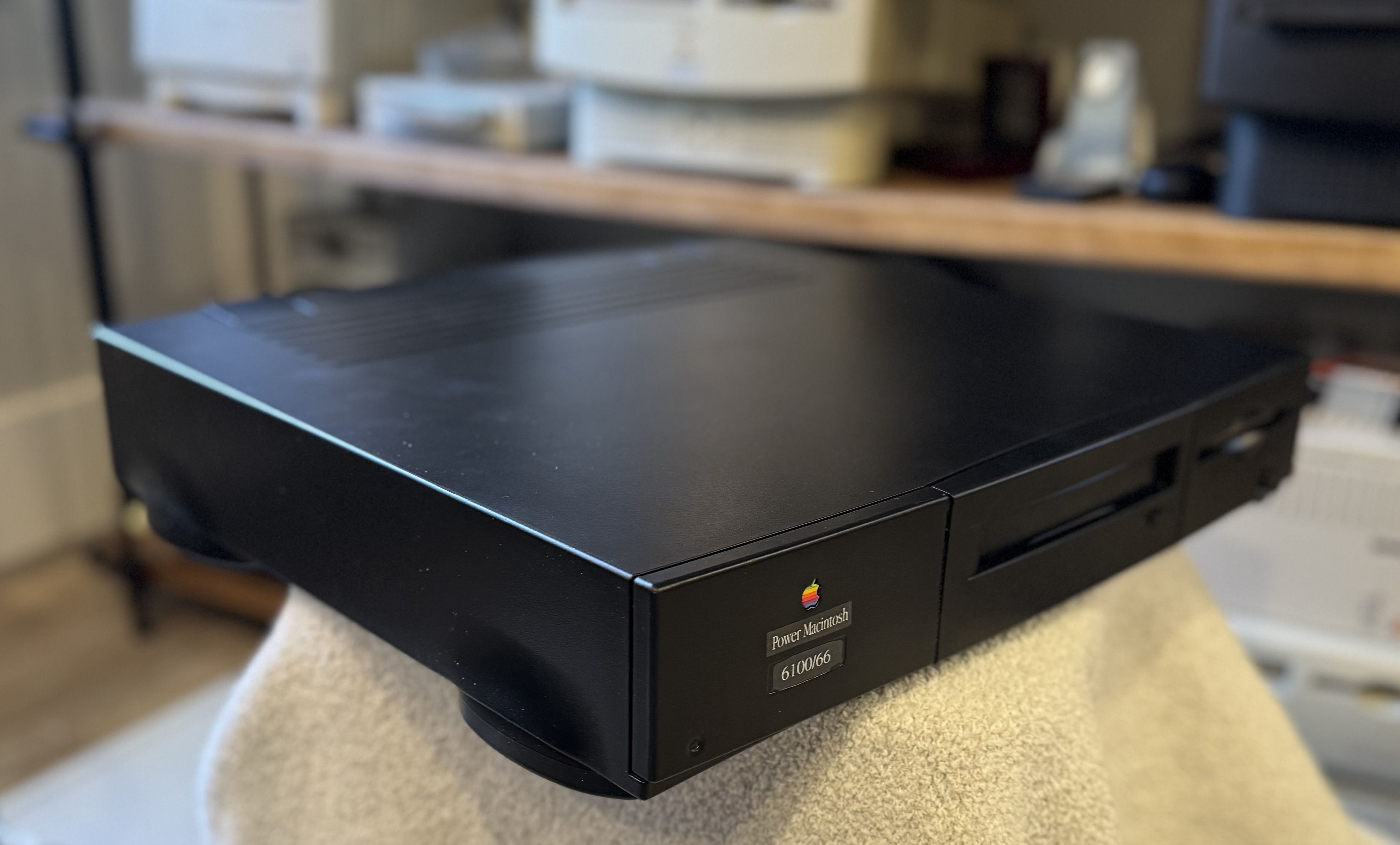

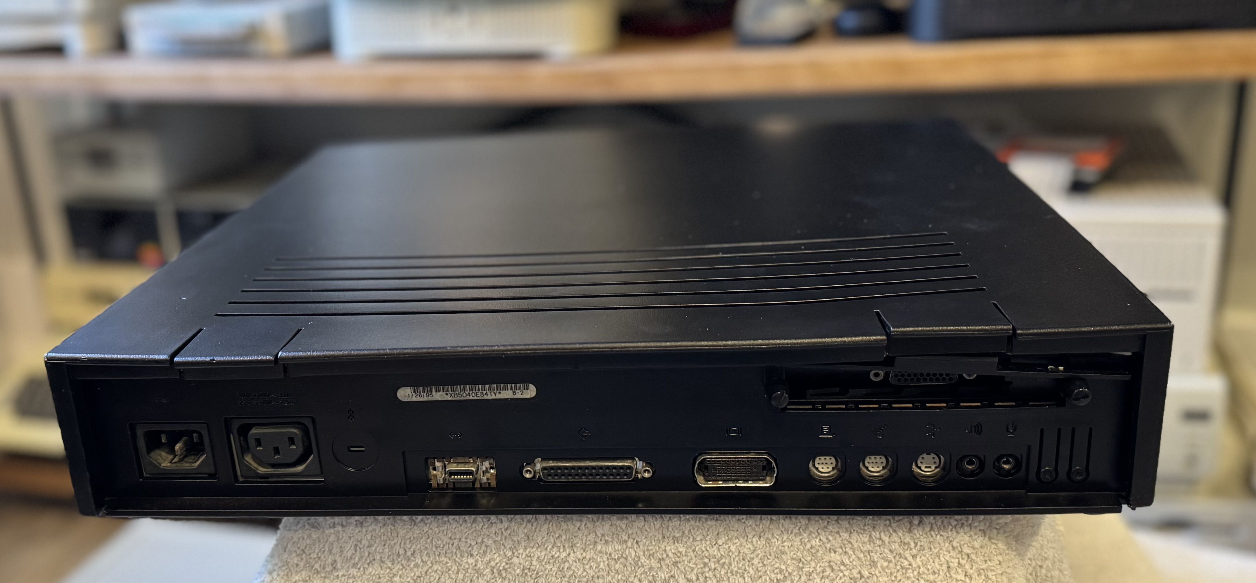

Machine number 2 fully working. I took one of the dirtiest, but otherwise in good shape 6100s, recapped the logic board, cleaned it up and put in one of the DOS Compatible cards.
Since no amount of cleaning and scrubbing seemed to get these cases clean, I decided to turn it into a black Mac, matching my Macintosh TV, Performa 5400, and black PowerMac G3 All-in-One. Pained the case, the feet, the back plate, and the CD ROM drive cover. Printed some replacement labels for the front and reinstalled it with a working floppy, working Apple CD 300i, and a newly created BlueSCSI v1. Working pretty well so far. And I think it looks pretty good. Certainly better than the original, even after cleaning.
View attachment 19211View attachment 19207View attachment 19210
That's a lovely job, did you do a thread about the build anywhere? Sorry if I missed it.

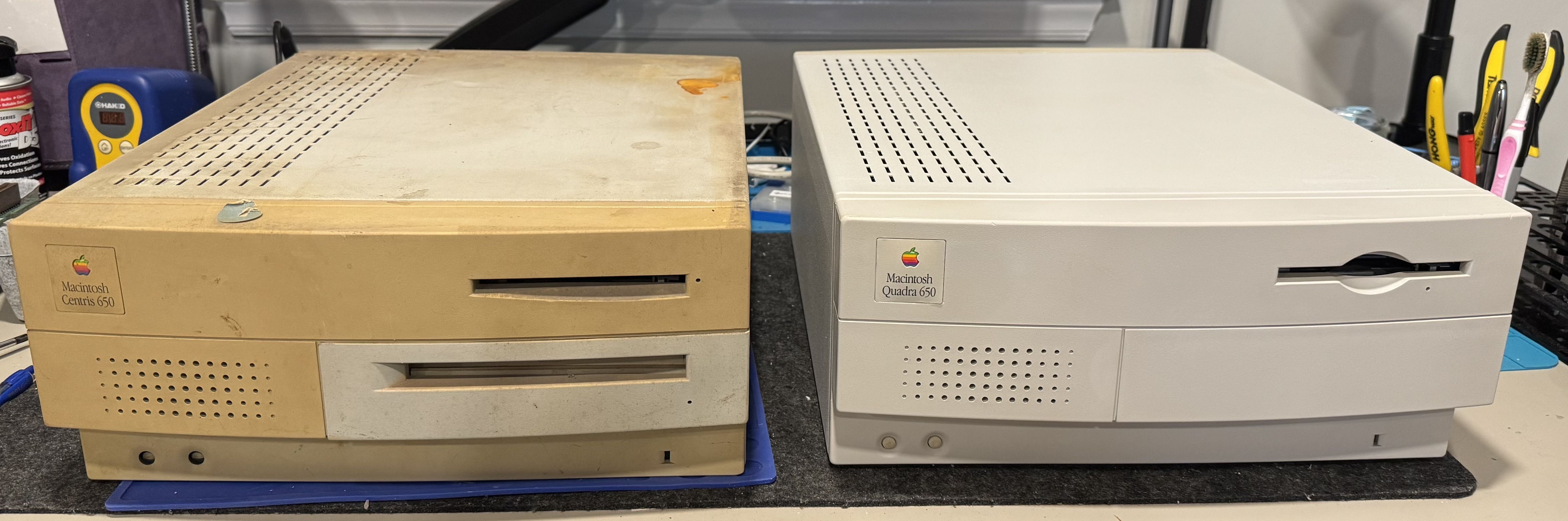

Finally, I finished the cleaning a the restoration of the Quadra 650 with the 586 Reply DOS card. It turned out much better than the 6100 I cleaned, and I think it's because the majority of the body is metal, which seems to clean much better, even the nasty rust stain on the one side is almost gone. DOS cards works well, machine runs smoothly and the PSU seem strong. And, side benefit of this machine is that I can use the DOS card without the need for the awful HDI-45 to DB-15 adapter. Anyway, here is a picture of it next to a similar starting condition Centris 650.
That has also come up amazingly well.
The 650 is the best 68k Mac in my opinion. Stable 40MHz overclocks are trivial by adding one or two SMD resistors and two jumper headers. Its really easy to do. Best thing is you can switch between 33 and 40MHz by just adding or removing the jumpers from headers, without even needing to remove the mezzanine or anything.
Thanks! Got a value I should use? Soldering them on should make the jumble more interesting for the final countdown. Will randomly cris-crossed leads be helpful for the final countdown?
Edit: just looked at the pic I posted. I think I'll make an nice stand to hold the bottle horizontally. Rhymes with "Ship in a Bottle!" :p
I mean, if you want it to happen fairly quickly, 27 Ohm would motivate them with about 100mA @ 3v. I'd probably use 68 Ohm though for 50mA @ 3V. It will just finish flattening them.
You could just put a blue or white LED on them though, that would give you a visual indication (don't use other colours unless the batteries are already under 2V).
The G3 AIO? I did post about it here: https://tinkerdifferent.com/threads...-asked-for-powermac-g3-all-in-one-molar.3189/
Yeah, once I get all these machines sorted, I'm going to have to decide which to keep (and which of my existing machines I need to pass along. I will potentially have a 6115CD, Quadra 650, the black 6100, and I'm considering throwing one of the DOS cards I got into my Quadra 700. And that would still leave me with 3 additional 6100s with DOS cards. I rarely use DOS and really only like it because I always thought it would be awesome to have back when they were new and my friends had DOS / Windows software I couldn't run. So, I'll be selling all the 6100s except the black one, and maybe the 6115. I think the Q650, the Q700, and the black 6100 would be the best to keep.
The black 6100 :)

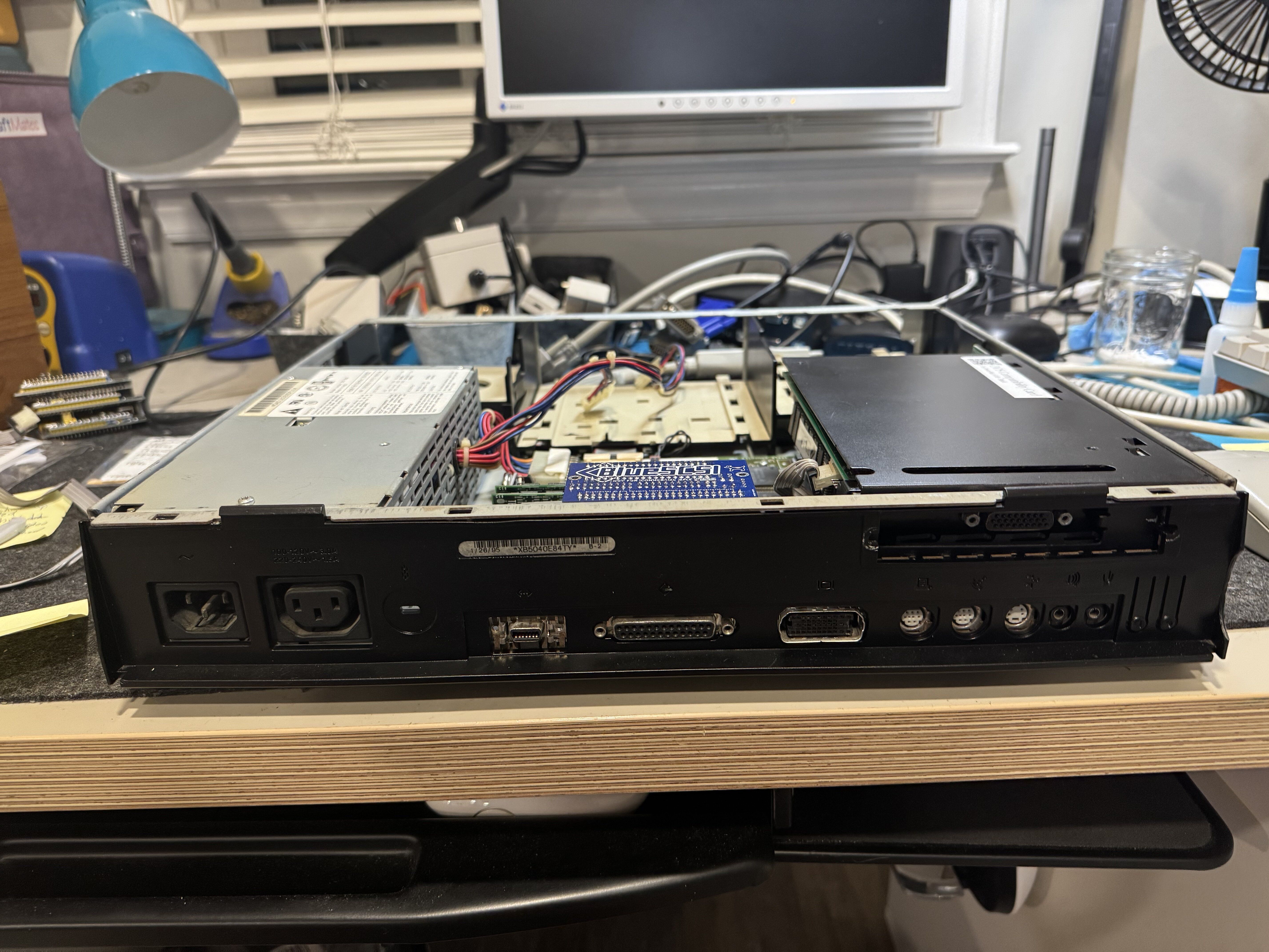

Just to warn you, I believe they clash with the lid, so people have to do a bit of hacking, plus you need an extension like the one you have in the 650.
At least, that's what it says on Jagshouse.

The black 6100 :)
Ah, sadly no, just a footnote in this post. Used the same paint as the G3 all-in-one. I've not done a great job documenting because I'm a bit overwhelmed with projects at the moment. Spending lots of time trying to build a video out solution for the 6100s so their new owners don't have to spend a bunch of money on those HDI-45 adapters. It's coming along slowly, but my lack of any experience building PCBs has eaten up a lot of my time as I've been building a solution. Got some PCBs on the way, as well as the appropriate HD-15 ports for VGA output. Now trying to tweak the solution so that it will hopefully work for the 8100 and 7100 machines as well.
I had seen that. From what I've heard, it may be due to the attempted use of the CD-audio out connector (which the Q700 doesn't have input for, so maybe they wired it to the audio in jack? Maybe later today I'll try throwing it into the Q700 to do a test fit. Also, it could be dependent on whether you have the DOS card's RAM slot populated, as it sticks upward at an angle. As you can see with my Reply card, the RAM extends past the top of the board.
I do have the extension board in my Q650. I may look to build a couple of the expansion PCBs. Although it concerns me that it looks like the design was never updated to address the interference issue, and I don't relish the idea of wrapping it in aluminum foil inside the case...
The Apple Card has audio headers that do stick up past the top of the board, but not the bracket.
