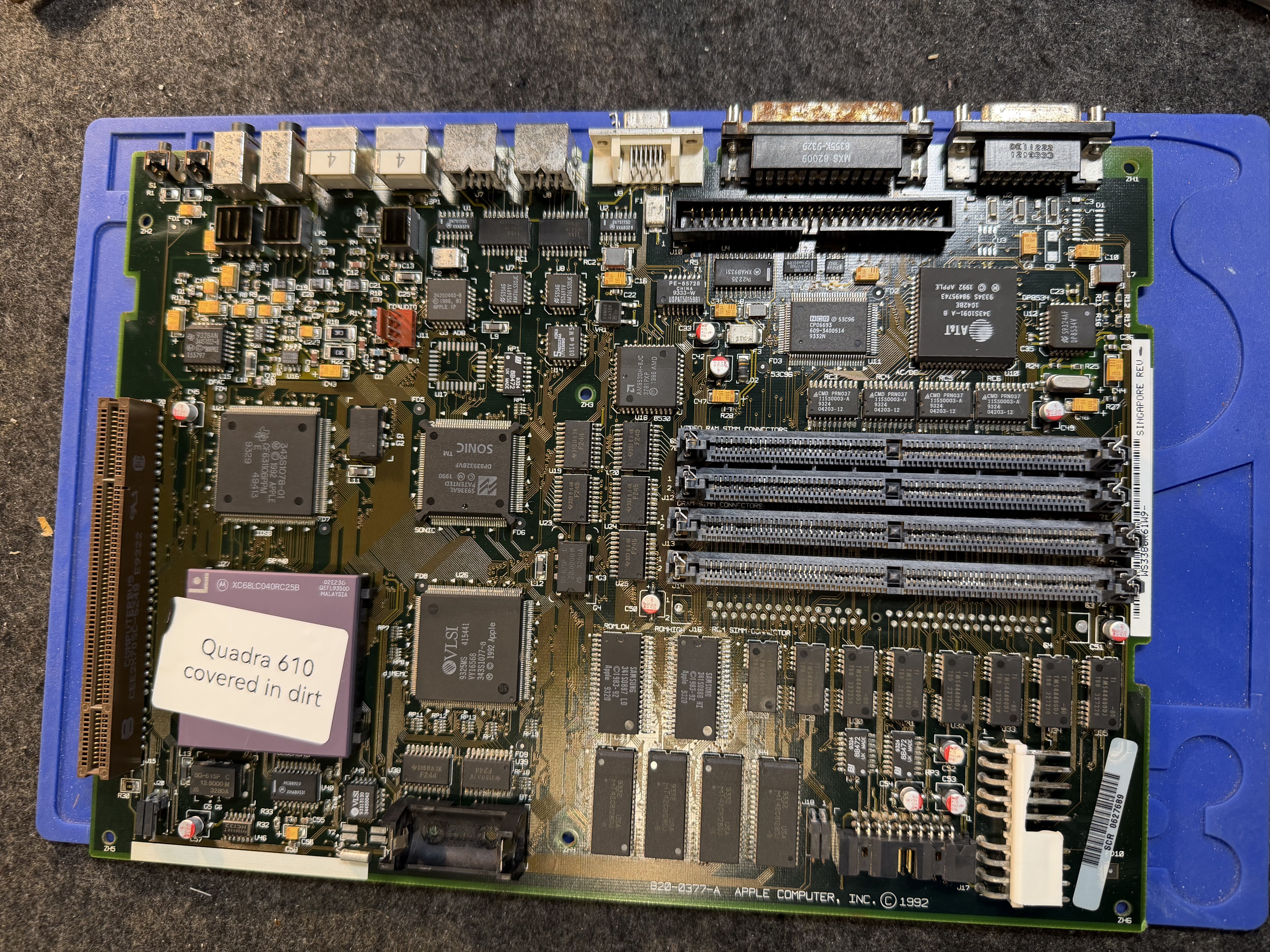

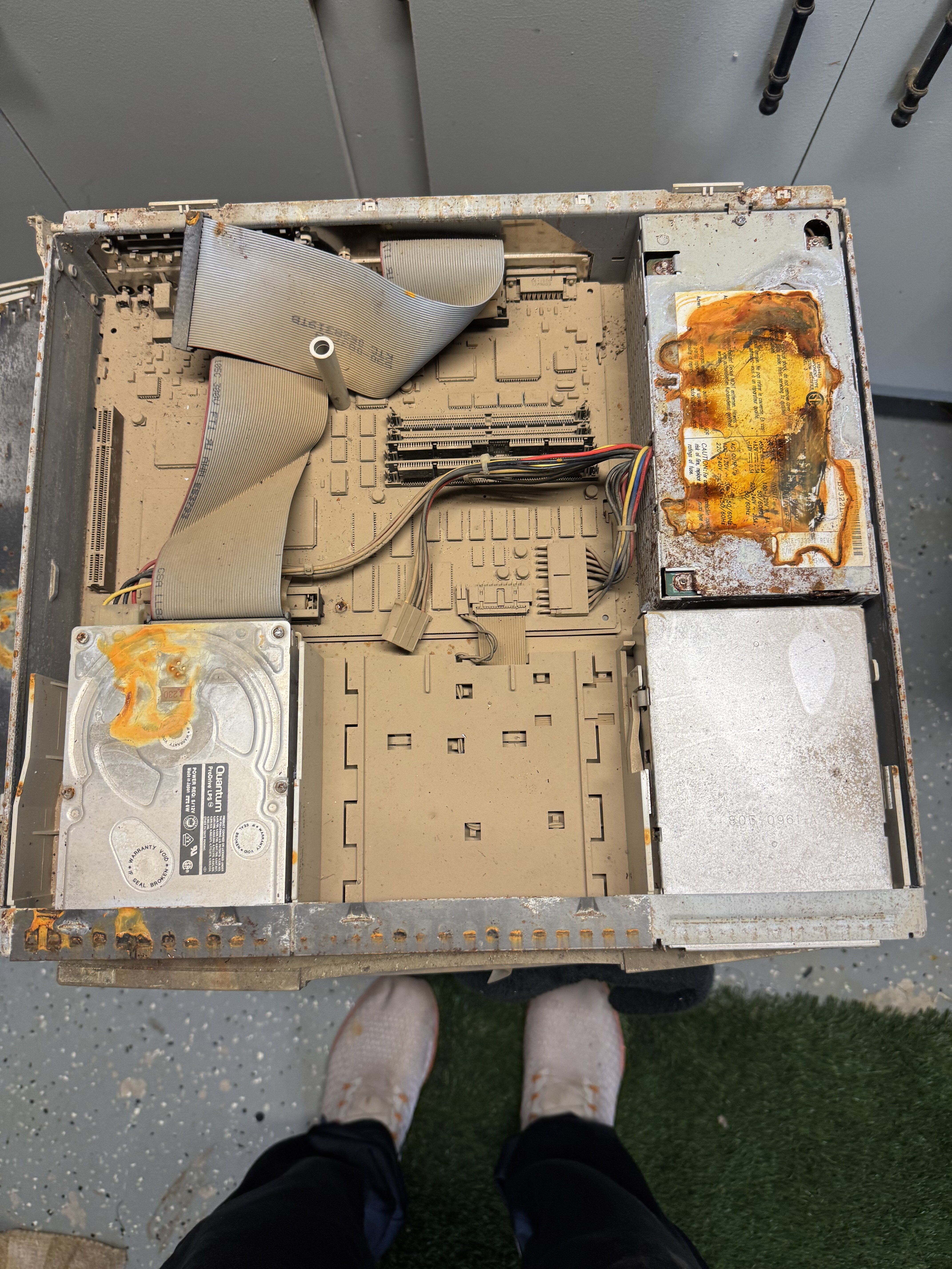

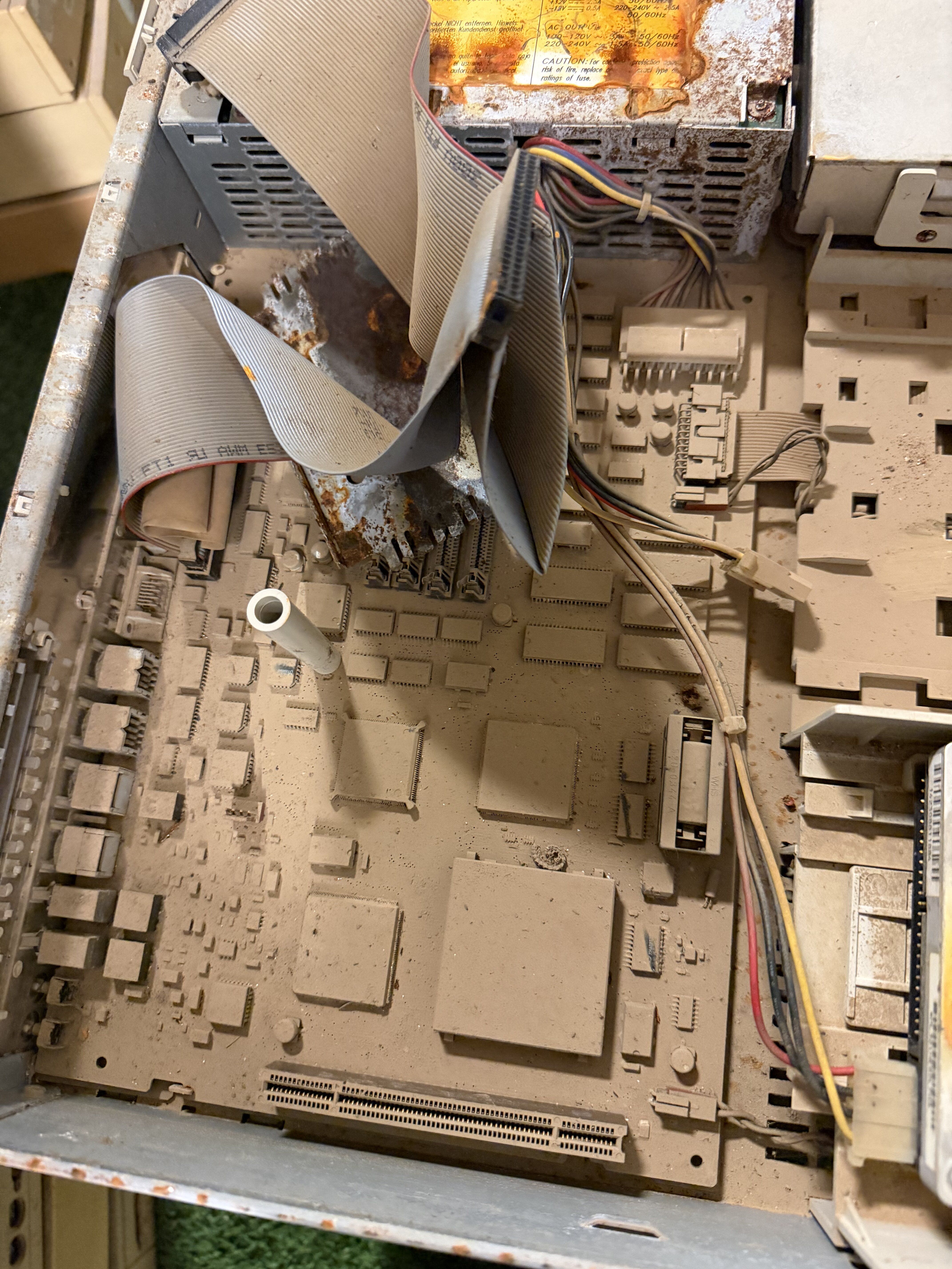

Another minor update. I moved on to assessing the Quadra / Centris 610 machines. While it looks like I had 13 of these machines, I think I'll only get 5 or 6 working machines out of them. However, as I was opening up the machines, I ran across one of the machines I photo'd as a "lowlight" of the haul. It was entirely covered in a thin layer of hardened mud. I suspect it was on the bottom and had the flood hit it and then as the muddy water resided, the dirt was left deposited on the logic board. Here's the photo I took back when I picked things up, as well as the recent picture I took while trying top remove it.
So, as I was going through the 610 machines, many were battery bombed and rusted out. I tried salvaging anything usable, but many had the CPUs destroyed with dozens of pins falling off when I removed them. However, this one was a bit of a mystery. I was curious how it looked under that later of mud. The PSU,. HD and floppy looks shot, so I didn't keep those, but after a wash and scrub in the driveway, I was pleasantly surprised by the condition. After waiting for it to dry, I decided to do a quick power on test. To my surprise, it booted with a nice healthy boot chime, and was putting out video and booting from an external BlueSCSI. However, on the second boot (with the blueSCSI), the sound was a bit soft. So, I decided to recap it and give it a proper cleaning. The end result was surprisingly good.
Unfortunately, the sound problem seems to have gotten worse. I can no longer hear anything from the speaker. And even when I plug in headphones, I can tell it is trying to make sound, but it represents itself as a very very faint change in tone (for lack of a better description). Meaning, I can hear a difference when the machine is playing the system beep. More to come on this machine. Hoping to get it fully working, although I do have some concerns about the RAM sockets - they do not look great, but I'm hopeful with some DeOxit, some fiberglass pen scrubbing, and luck I can get it to accept RAM so it isn't stuck with the 4MB of built in memory.
