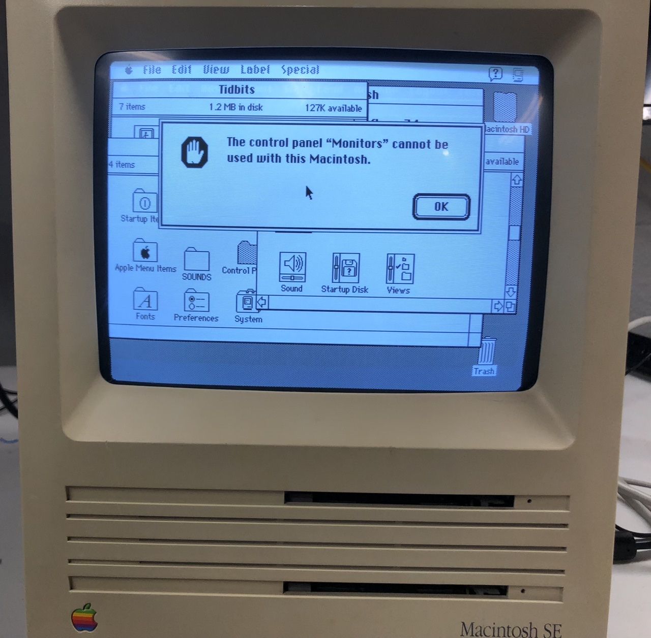

Yeah look here on a stock SE. Can’t use the Monitors control panel and it’s not even included in even the full install for just SE. So if there is a control panel for a display driver, it’s probably a 3rd party one.
Revised edition answer: Any Control Panel for multiple displays for SE and earlier Compacts pre-7 will be third party IIRC.
TLDR:
Going through the thread I picked up on that bit I had addressed, but a little context never hurts? Radius developed the first version of such a control panel for their FPD Card on the "Killy Klip PDS." That was at the dawn of DTP which brought the stillborn Mac to life. Configuring the two screens visually via Control Panel was hailed as a major achievement IIRC. Apple rolled such into System 7 at its intro as I recall.
