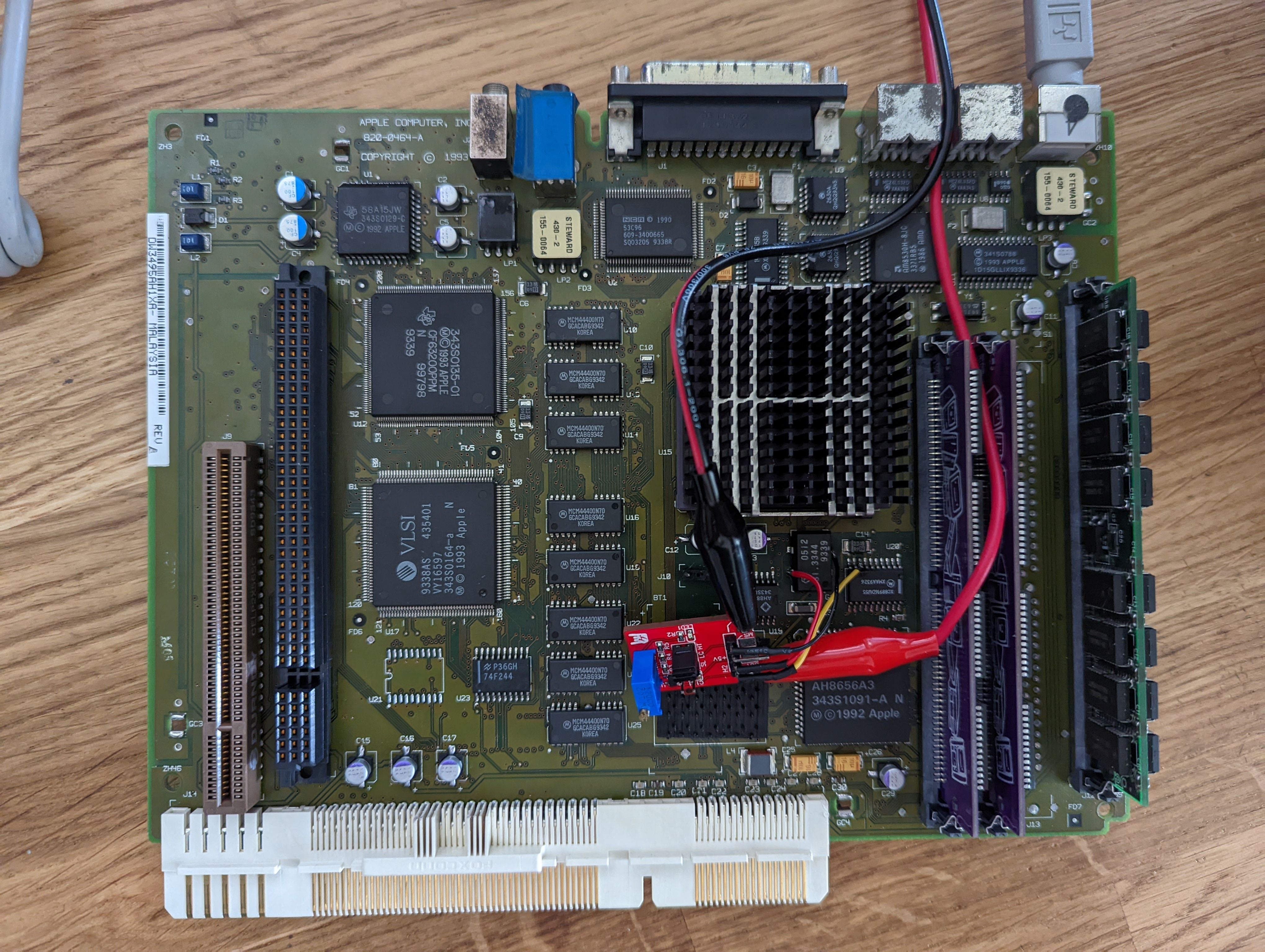

The top view of the 🔥Spicy O'clock🔥unit itself. An adjustable oscillator designed for 68040 based machines.
The adjustable oscillator let's you fine tune the clock speeds to achieve stability and functionality. If you do not have a multimeter or oscilloscope capable of reading frequency then measuring the resistance (while the machine is off) is a second method of determining approximate speeds. You can find Kays chart matching resistance to speeds here: https://ameblo.jp/keroxiee1016/entry-12717260184.html
My Mystic (LC575) board is host already to custom VRAM reverse engineered by @Stephen with designs silkscreened by myself, These sticks are using 60ns chips which have proven to assist in overclocking speeds of up to 50mhz.
A detailed view of the solder points for LC575, Pin 8 of of the clock buffer/driver must be lifted to hijack the clock output signal allowing you to adjust your frequency.
Black - GND
RED (VIN) - +5v
Yellow - OUT

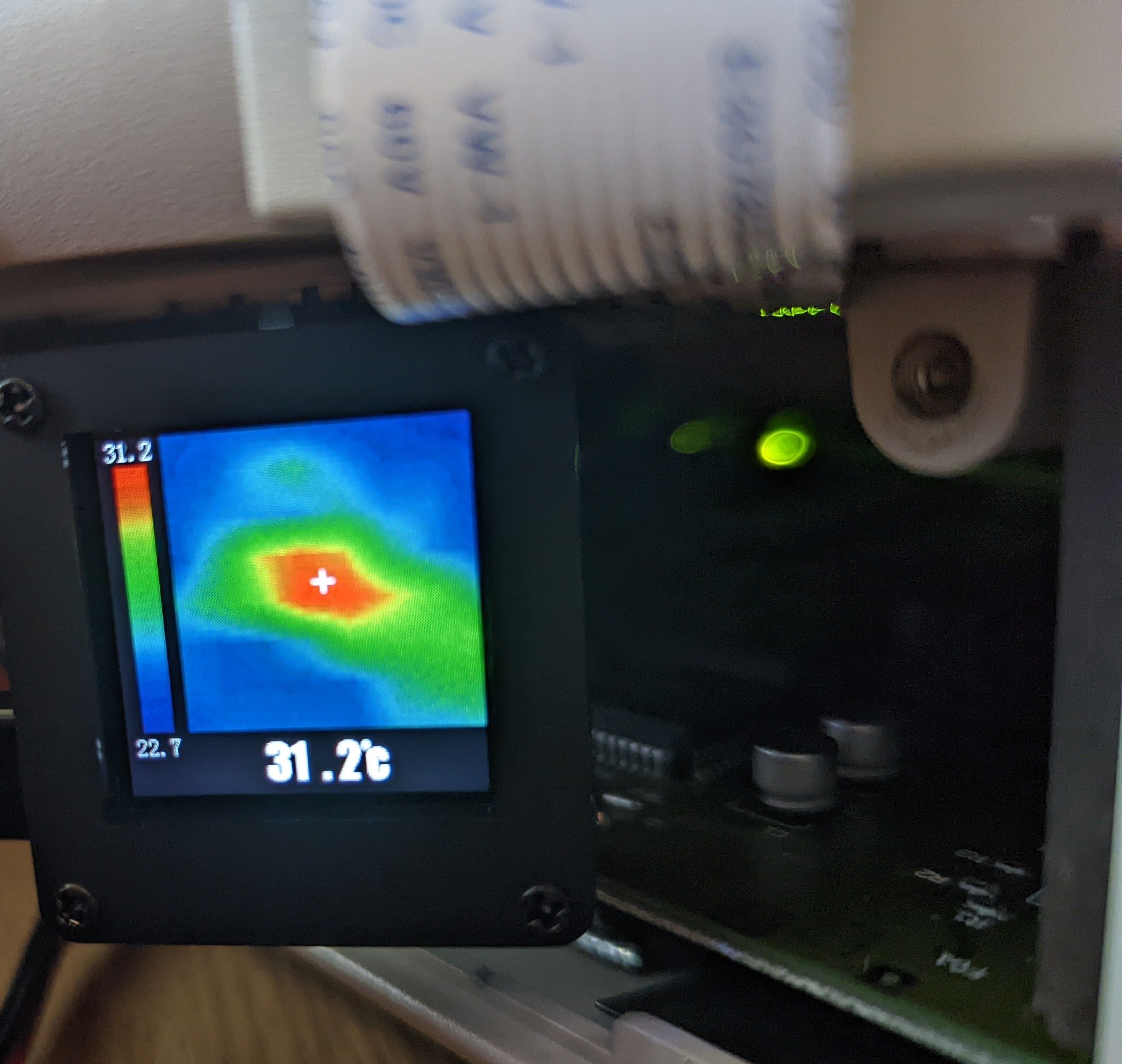

For curiosity sake I did measure the CPU heat output with the overclock running and the camera did show 39.2 degrees with a passive heatsink, I'm certain this temperature is more than safe if not the same as a stock unit without heatsink.

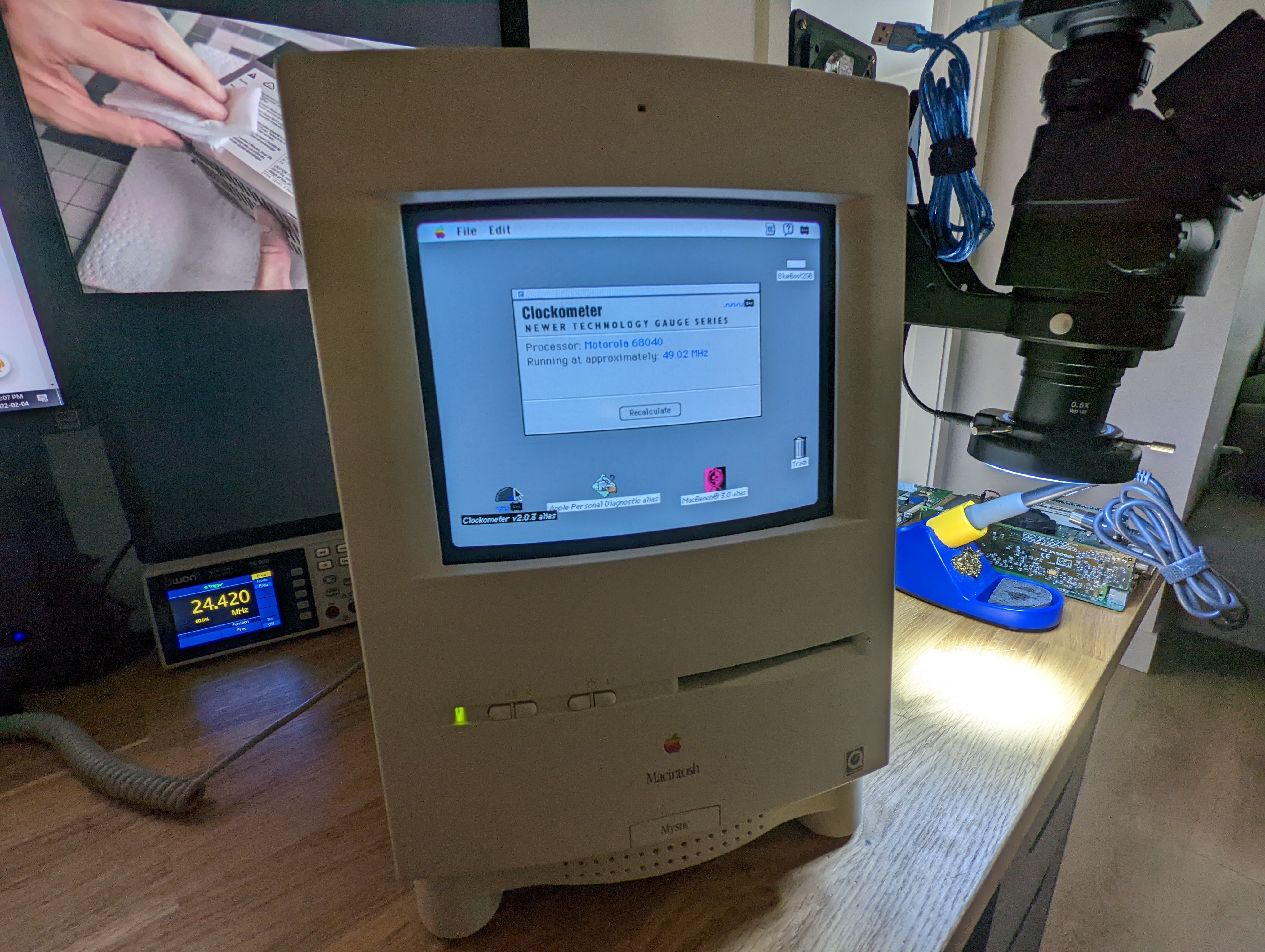

@JDW I tried my best the last 2 days to catch you!
I removed the Kemet tantalum capacitors for lower ESR and stability BUT... I think I have a limitation regarding my LC33 that keeps me at 49mhz and no further!
Frequency readout displayed here at 24.420mhz. While it is MOST stable at 48mhz the machine can almost touch the 50mhz mark with some bus errors. Interestingly I also tried using an RC25 CPU in this logic board which was stable to 45mhz! which makes me hopeful that I may be able to find an RC40! (if any legitimate ones appear online).
The CPU itself also remains cool in this state using a stock cooler from quadra700.
You may rest easy up in the clouds of 50+mhz heaven my friend!

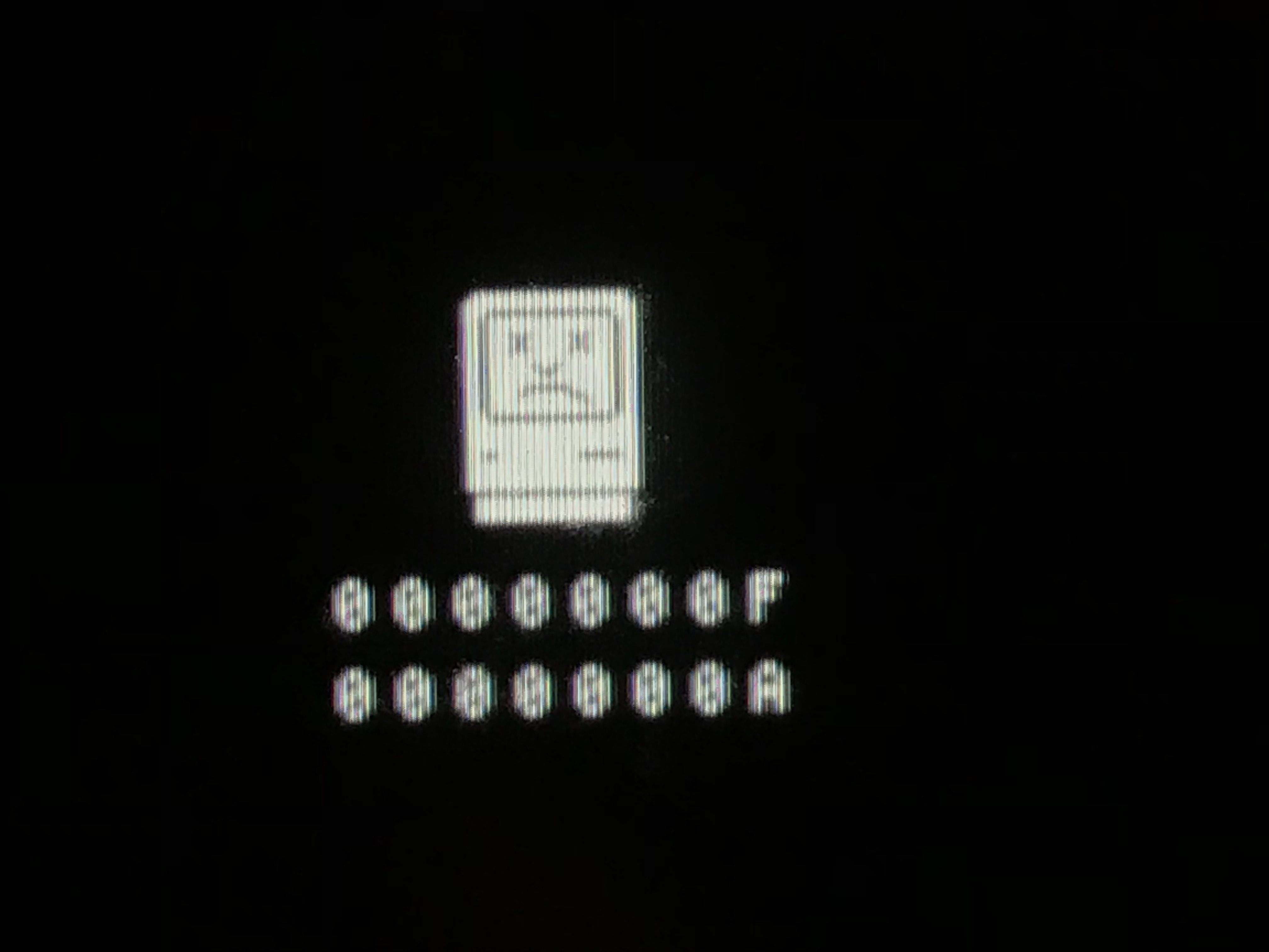

I restarted my CC many times today. Twice, I got the following Sad Mac error immediately after I restarted...
0000000F
0000000A
Not sure what that means, but when I restarted again, the Mac booted normally.

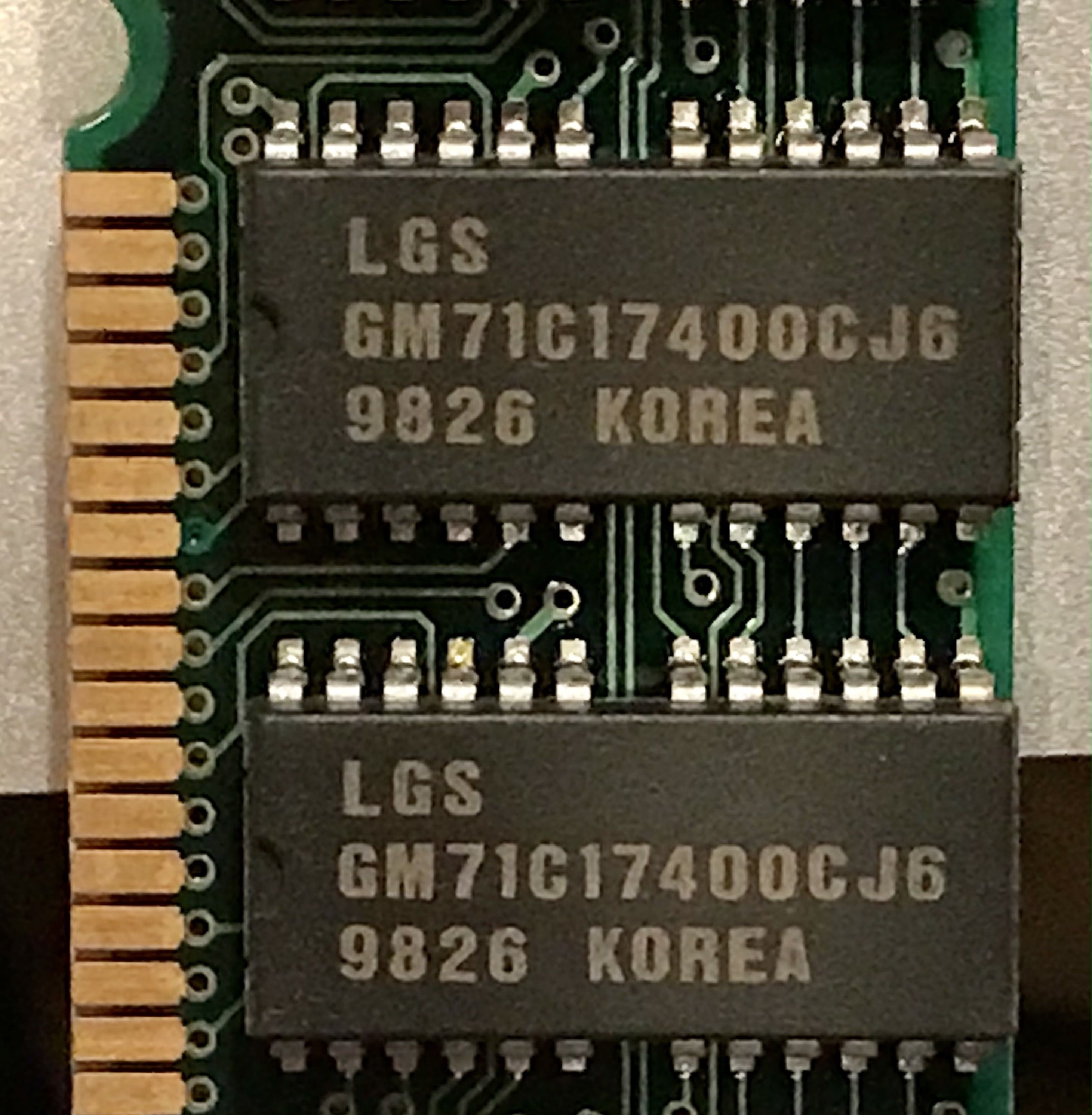

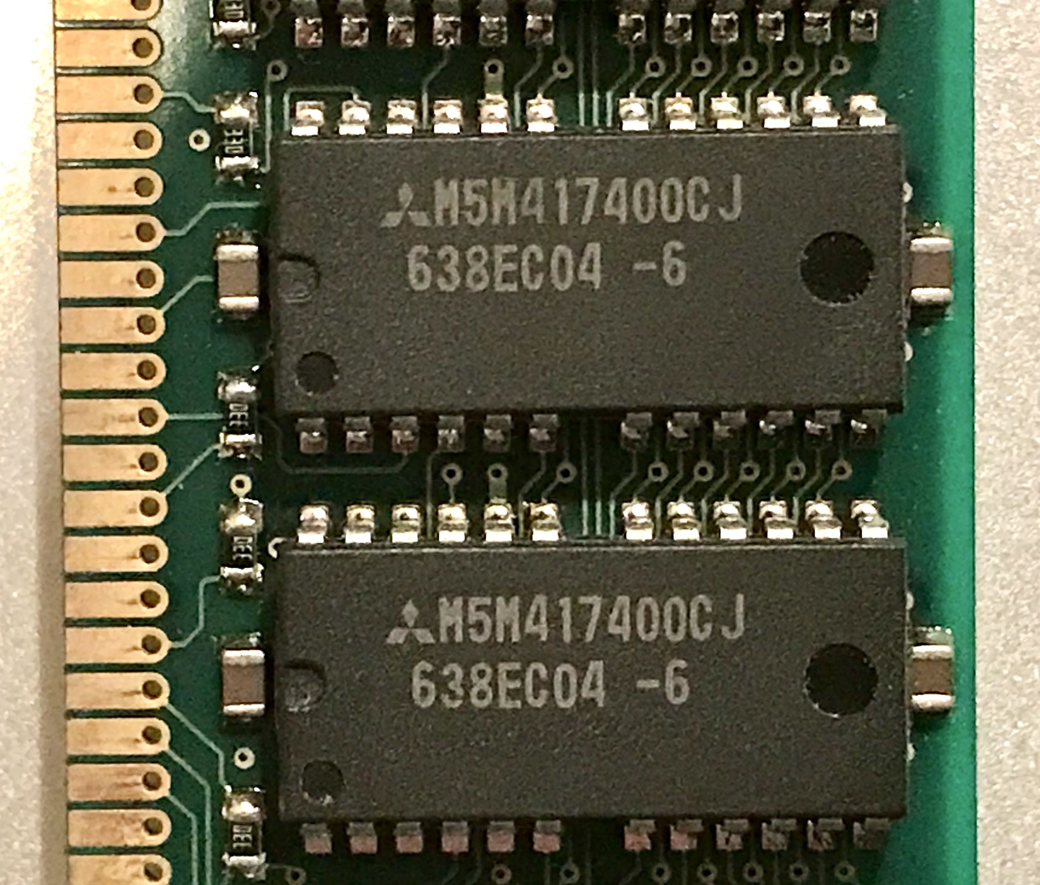

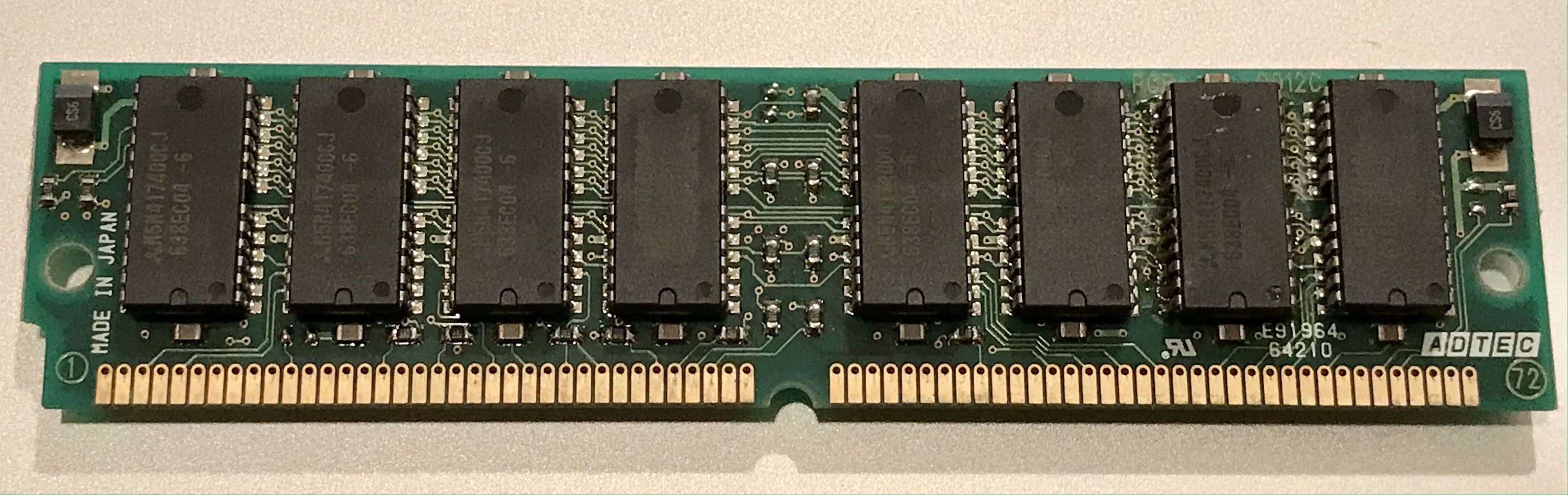

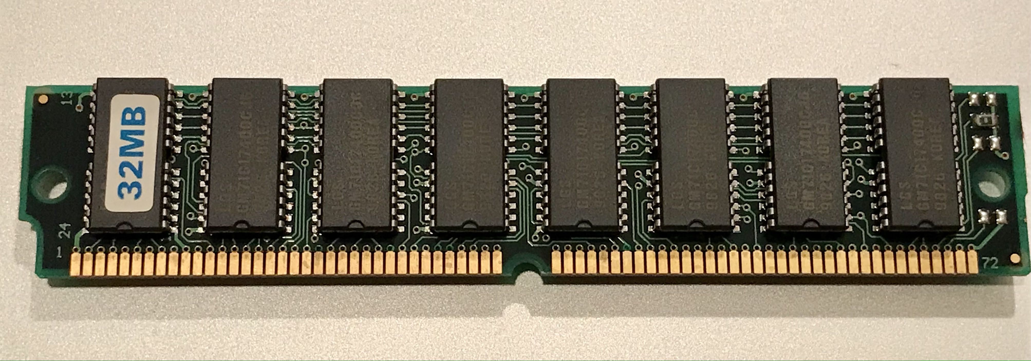

I did my testing today with a stick of 32MB RAM I had never used before in my CC Mystic. I pulled that RAM stick from a working Quadra 630 which had a 75MHz PM6200 motherboard in it. I doubt the RAM is an issue, but I did notice that the stock 32MB RAM SIMM that was originally in my Color Classic has capacitors on it, but the 32MB SIMM I pulled from the Q630/6200 doesn't have capacitors on it. Both seemed to be 60ns RAM as per the "6" in the part number. Photos below.
32MB RAM pulled from Q630 (PM6200):
32MB RAM that was in my Color Classic's stock 16MHz 030 Motherboard:

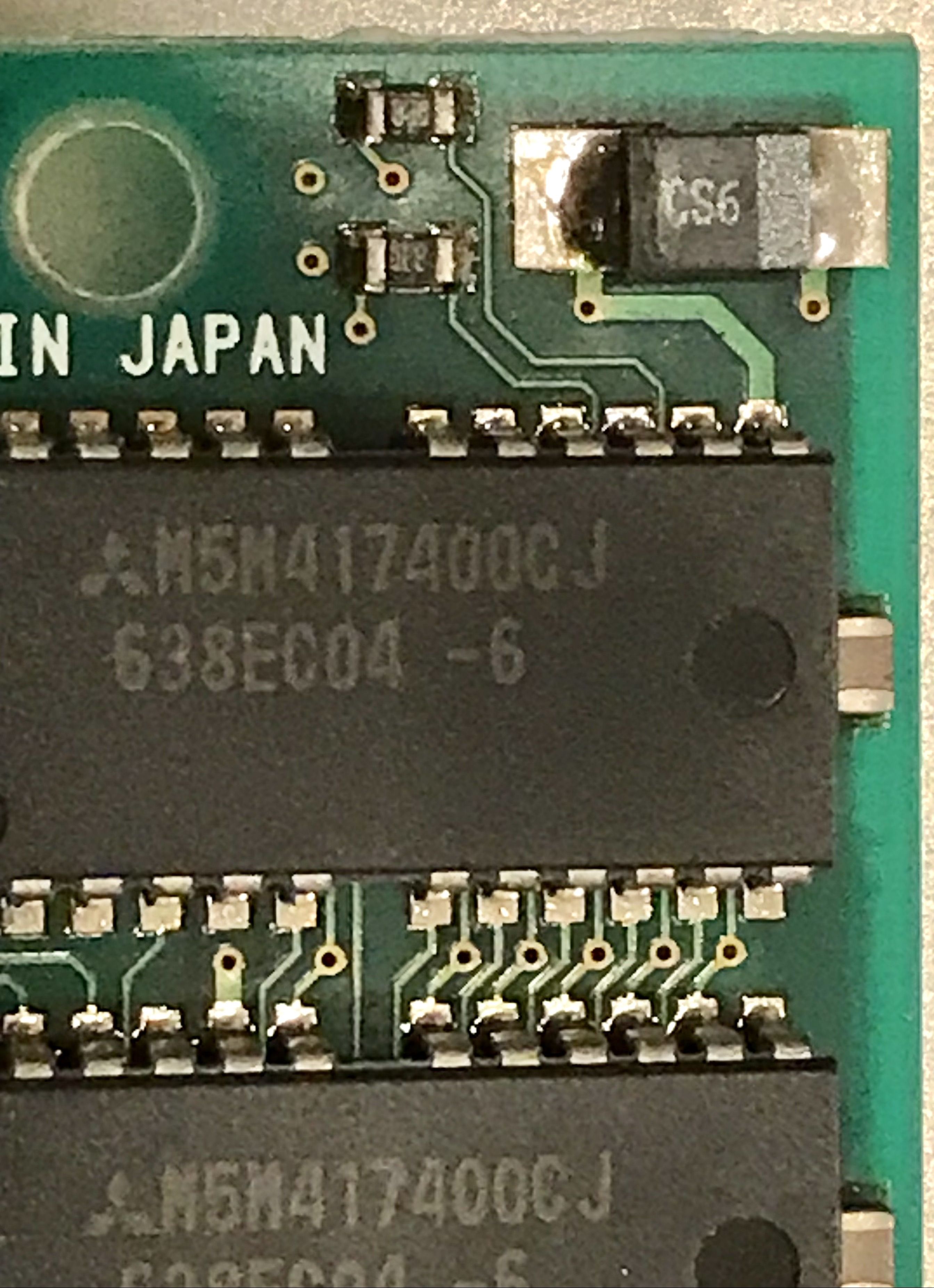

Note the capacitor CS6 (1pc on either end of the SIMM):​
0000000F
0000000A

Hi @Drake ,
The SIMM in the upper left in your photo shows a good amount of capacitance on it, but it also has a transistor too. Not sure if capacitance on the RAM SIMMs really matters or not for stability at super high clock speeds, but since OS-CON capacitors are the ticket to the highest clock speeds with the Mystic motherboard, I am strongly giving thought to that.
