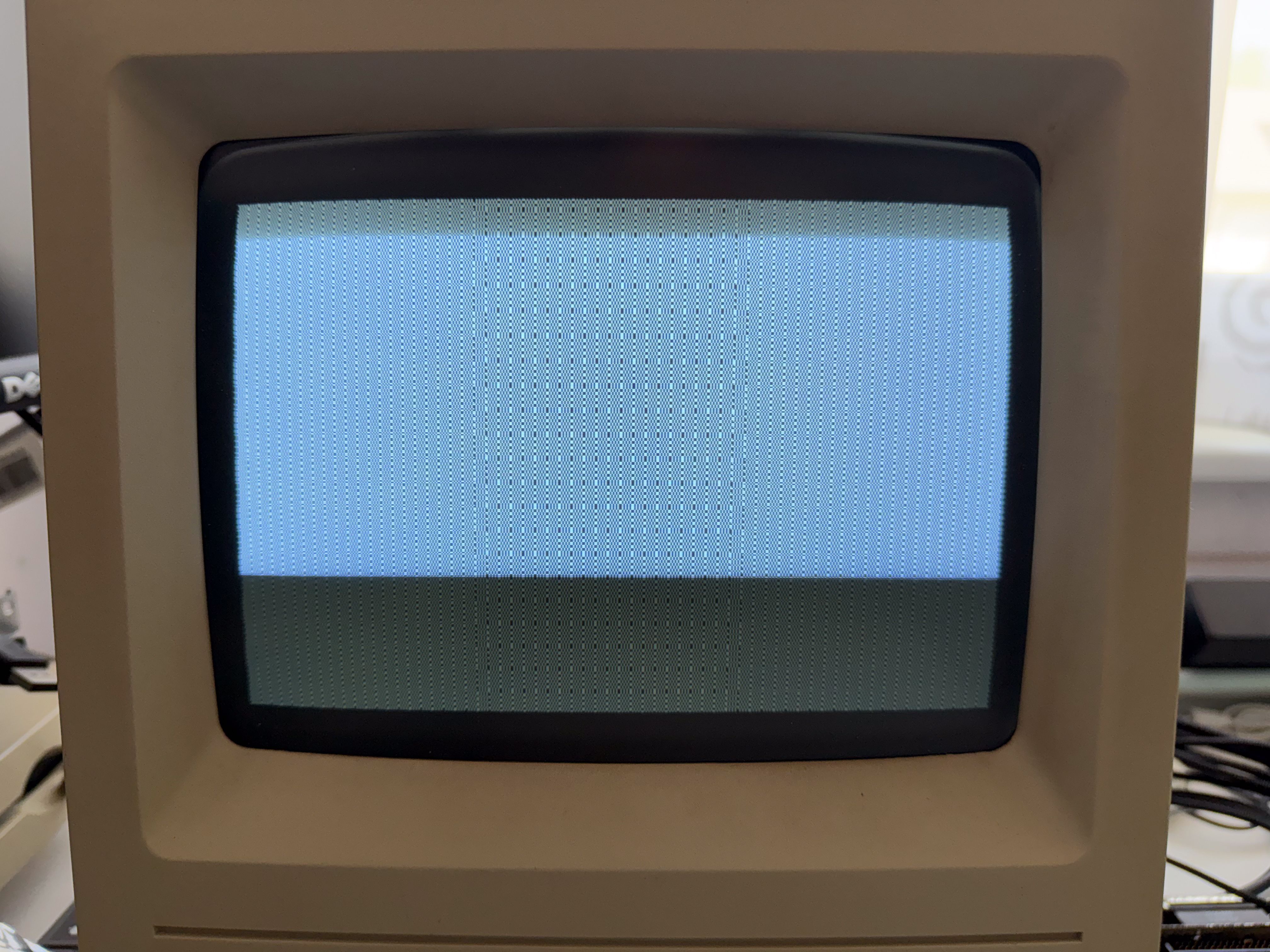

I followed the instructions found here to program a new video ROM: https://tinkerdifferent.com/threads/this-is-what-a-bad-macintosh-se-30-video-rom-looks-like.1446/
To create a new video ROM, I used a GQ-4x4 to program the AT28C64. Then I compared the original video ROM file with the one on the new AT28C64 with HxD. Both were identical. However, the new video ROM gives me this screen on the SE/30? Any hints what could be wrong?
The video ROM isn't 'giving you' that screen per se. That screen is showing the default state of the video ram. Why were you trying to make a new video ROM in the first place? Was it because you saw this screen? If so, you likely have some broken traces or failed IC(s) near UE8.
I fried an original ROM on another logic board (with its own issues), hence now I'm trying to recreate one.

Update: Classical end-user mistake! I followed Will's instructions but didn't select the right eprom type in the programmer device selection:
It worked this time without a glitch. Thanks all for steering me towards the solution of the issue.
