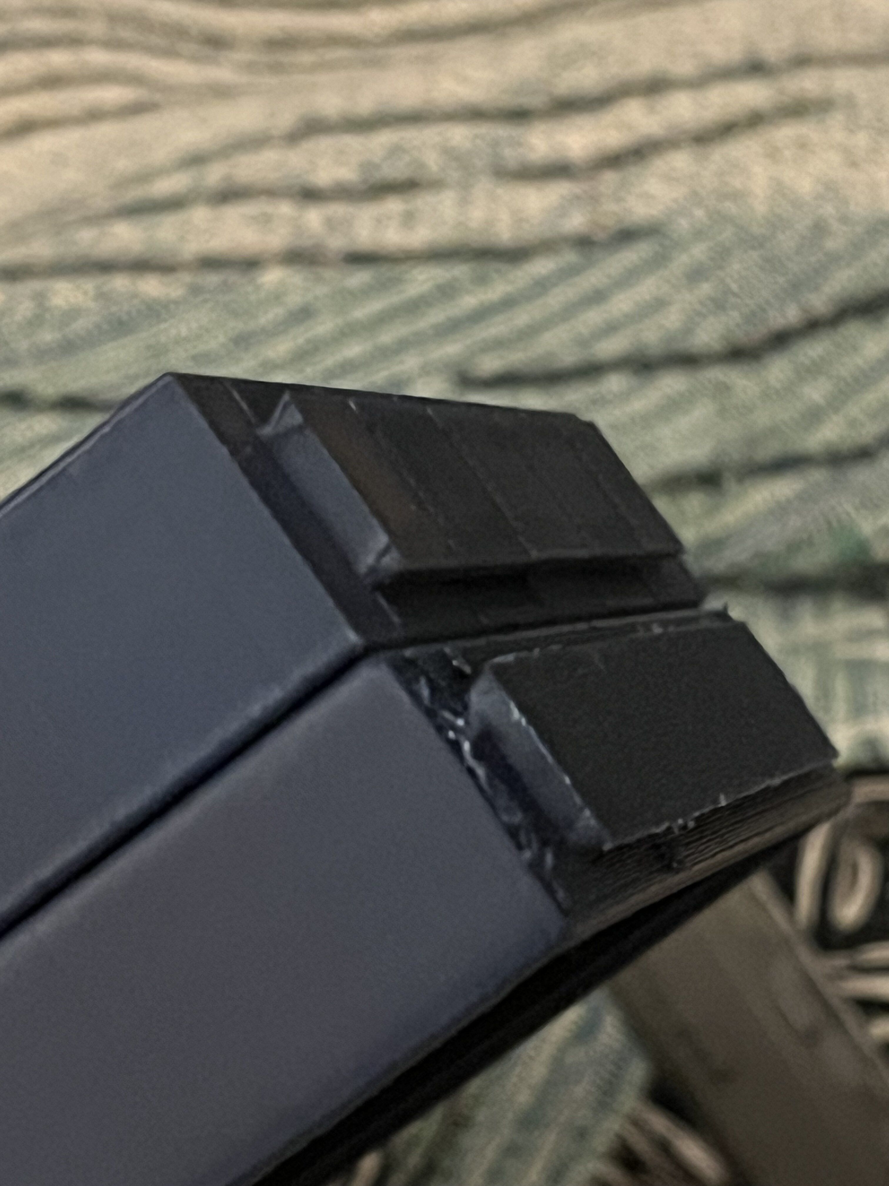

I’m printing out some cases for 170 batteries for someone to build for me. Just got some power grey today (this was a test in deep space blue)

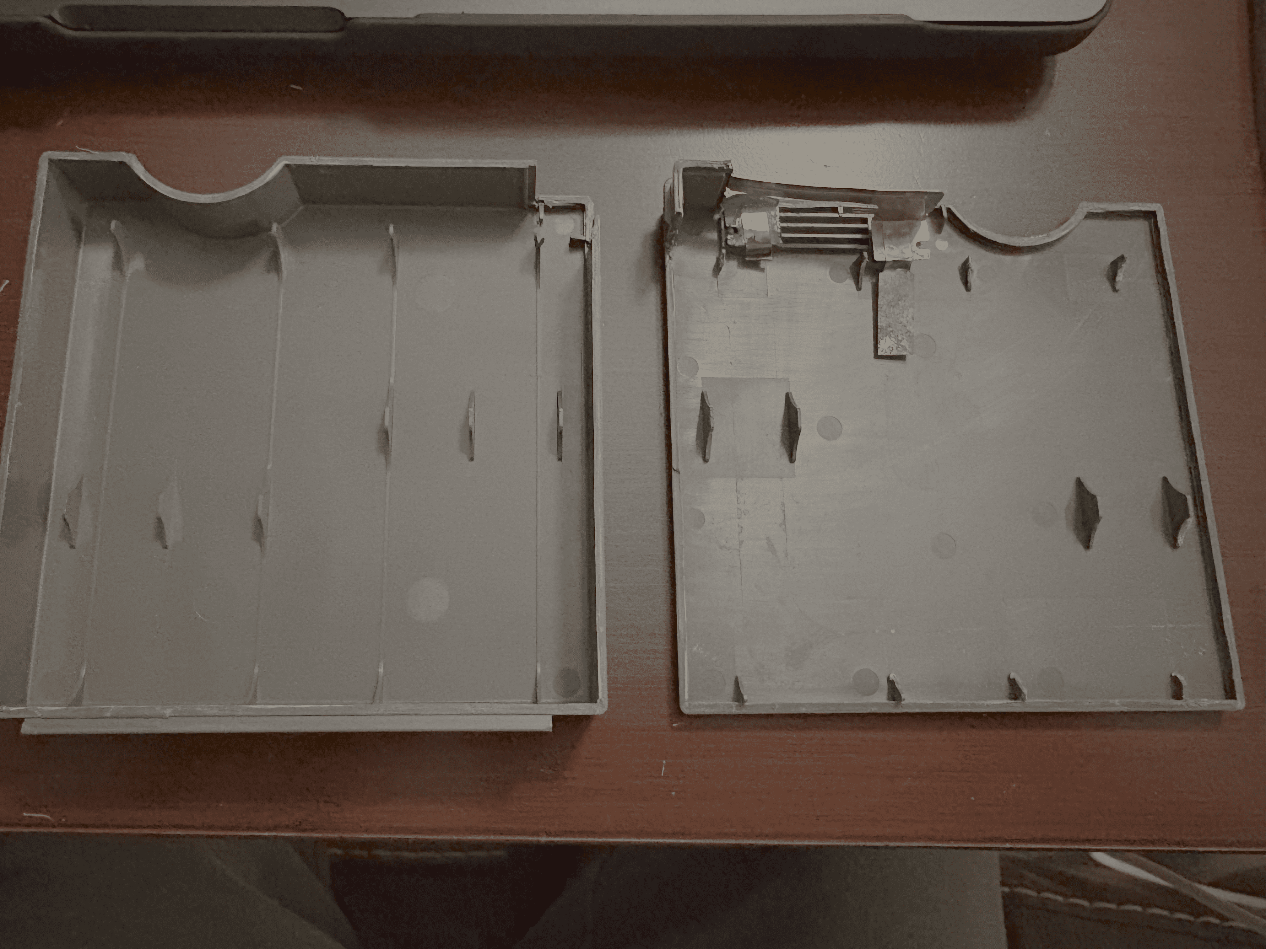

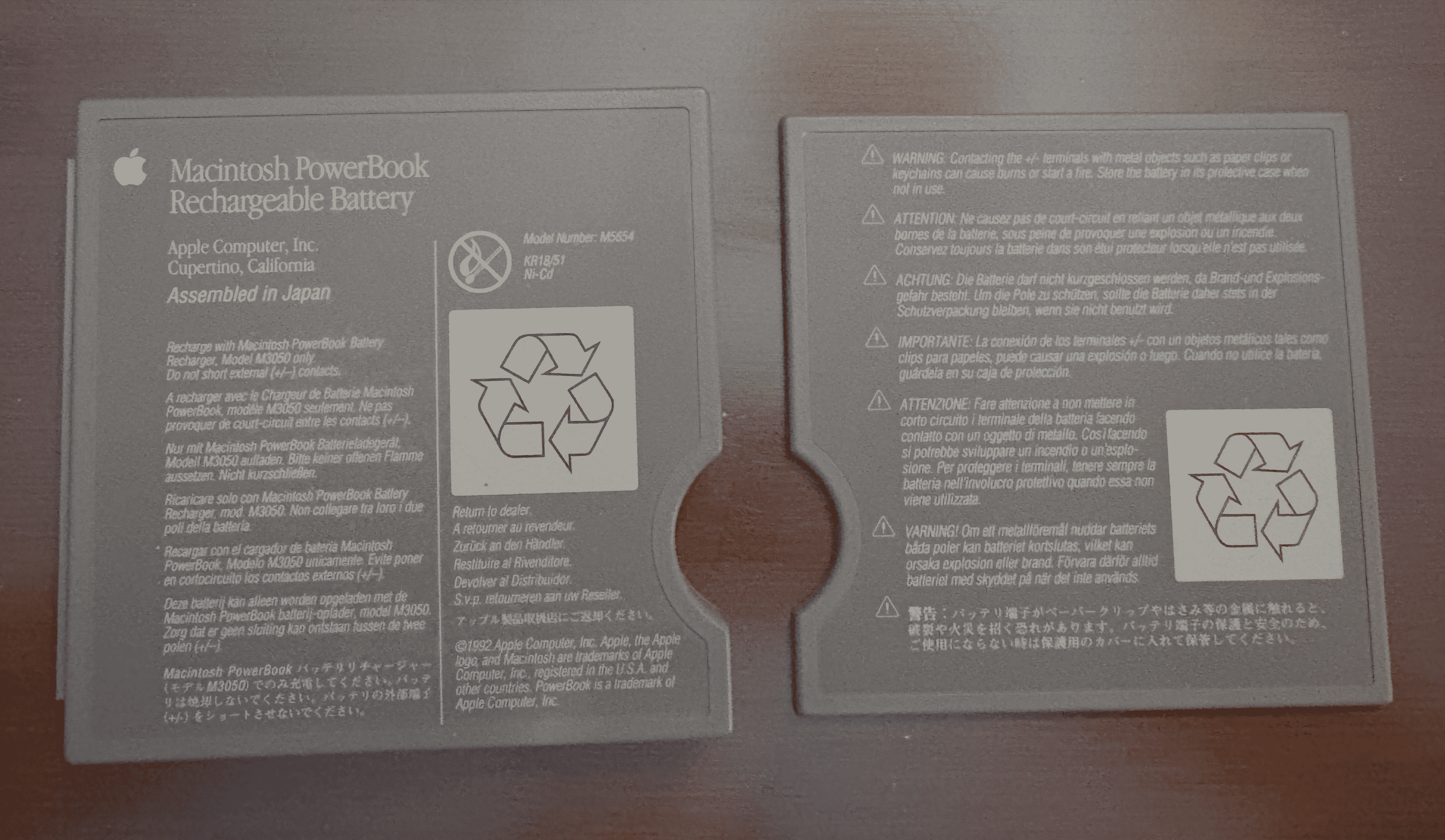

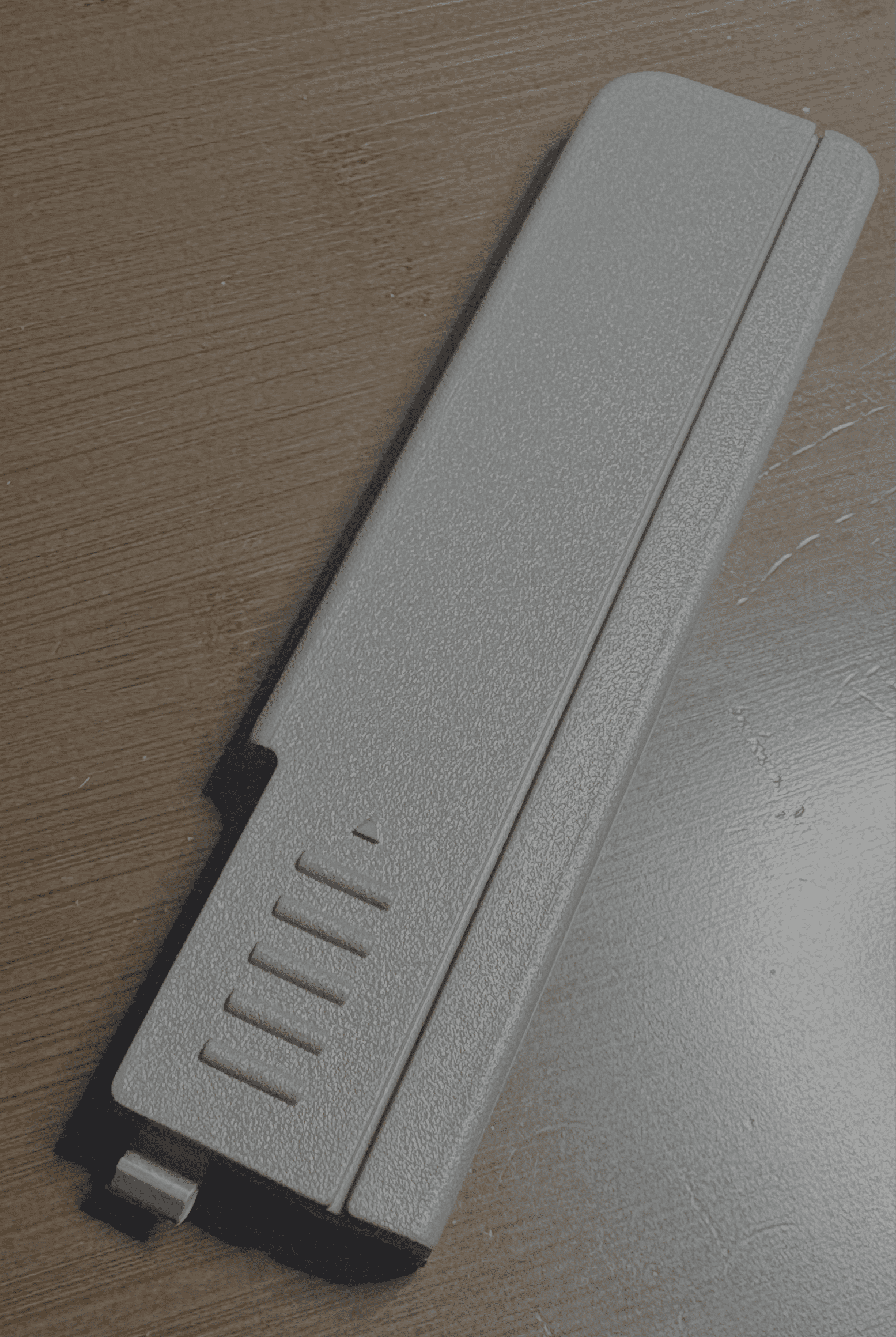

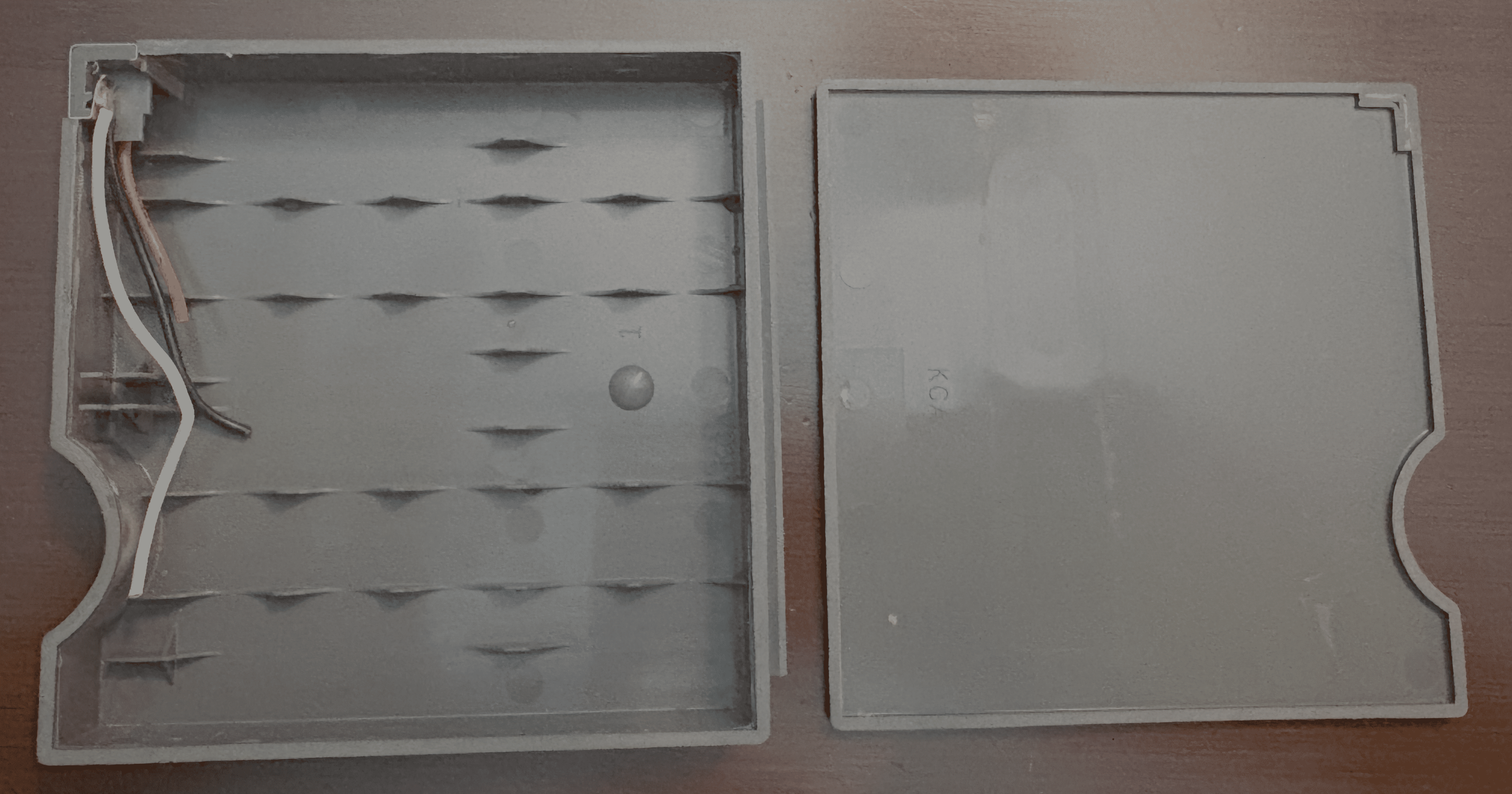

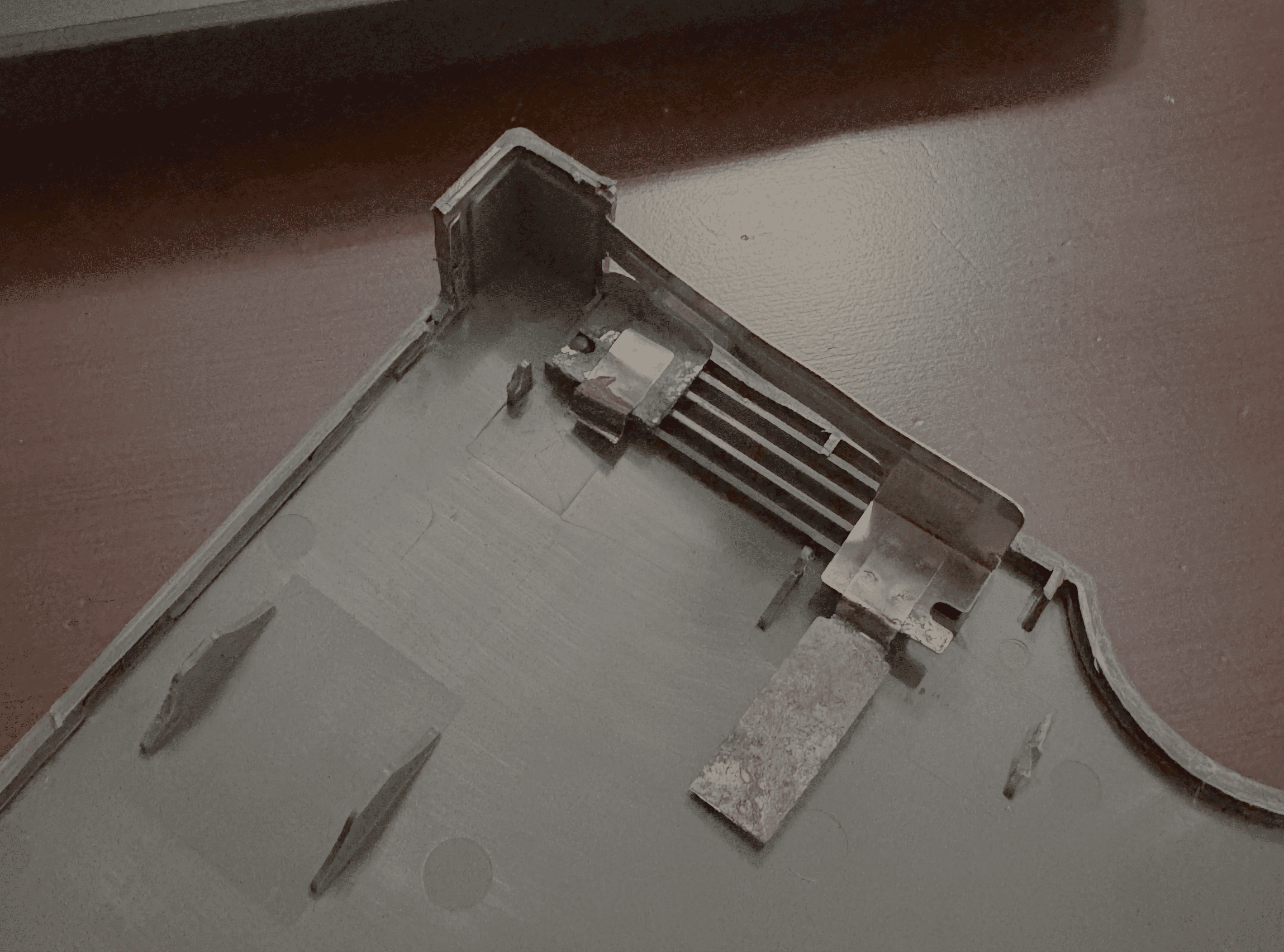

I also considered 3D printing a new casing, but decided to disassemble and use an M5654 battery instead. IMO, the M5654 case is preferable over the M5653 as the terminals are simplified and easier to cut through. Of course the M5653 terminals can be simplified. I'm currently on the hunt for an affordable location to buy the replacement cells... but I'll save that for a later thread, I don't want to hijack yours. In fact, I'll probably do a thread of my own when I've finished everything.
Here are some photos of both casing, for reference.
Hope you share your full battery build.
(y)
M5654 Battery:
M5653 Battery:

Yeah, opening them is definitely a pain. As I'm sure you know, the top and bottom halves are sonic-welded together, so there really isn’t any way to just pop them apart cleanly.
For mine, I used a fine X-Acto blade and just worked my way around the perimeter very slowly. I probably made 40 to 50+ passes before I finally got all the way through and the two halves separated. I do a lot of fine-scale modeling and prop replication, so I’ve had plenty of practice making cuts like this without completely butchering the plastic... which is very easy to do.
I still have to decide how I’m going to put the two halves back together (screw, clips, etc.), but that’s a problem for another day. For now, I’ve still got plenty of computer work to do.
I also have a few 3D printers and considered printing replacements. I may, eventually, model one up and give that a try, but for now I’m sticking with the originals whenever possible.

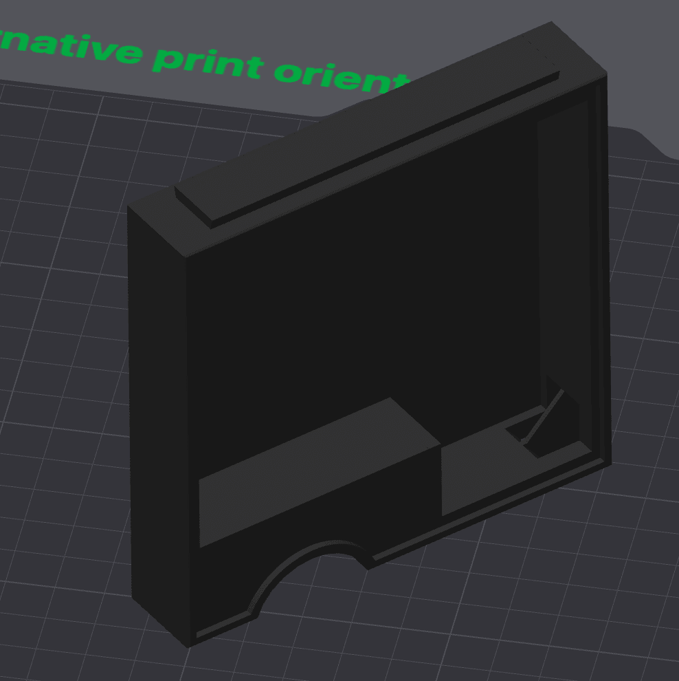

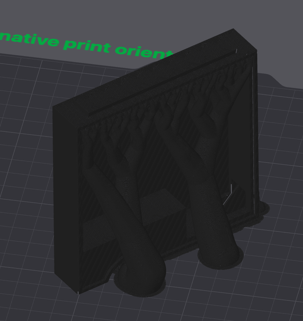

Turns out the printing requires a bit of finesse. Printing flat on the bed make the cover attachment track unusable on my printer so I’m trying an alternative orientation with supports.
the door model I found has some geometry I wanted to tweak as well for stronger track runners.

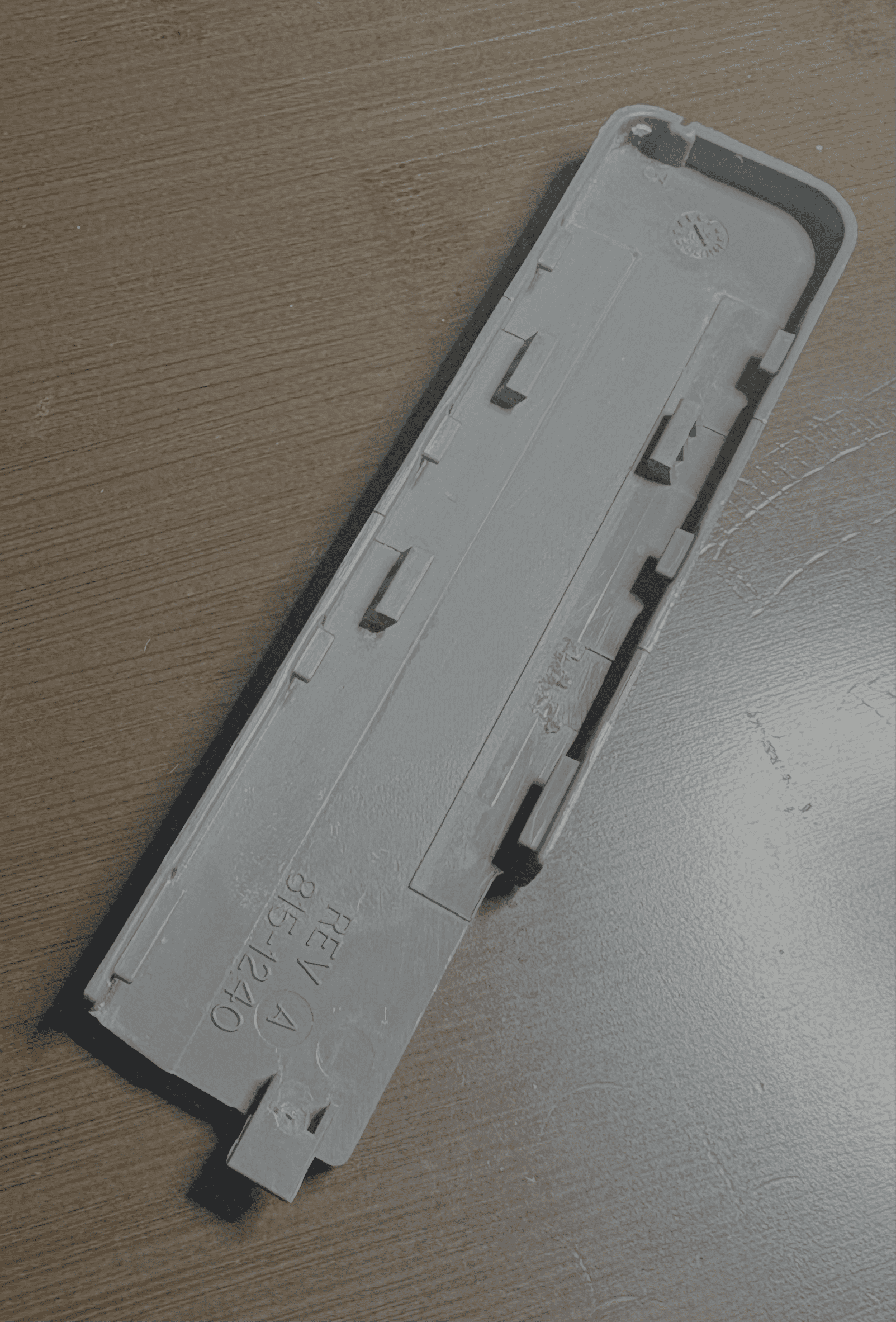

I'm printing PLA which, now that you say it, is probably not the best material long term, but it's what I have for the moment.
The model I am using is from Printables. I'm noticing the model is slightly different than the real thing.
This is the clip. I was trying to model the interior clips as skewed rectangles.
Just noticed, however, that RonsComputerVideos made a version. It looks better already — definitely looks like it was scanned or used photogrammetry.
I'm definitely not skilled at this. I was going to try and learn something like Fusion360 at some point, because tinkercad and Bambu Lab are limited in what they can do, still I thought I could try and ge tit to be good enough. Personally I care mostly if it's functional, not whether or not the textures are right, not that it wouldn't be grand if it did.
It'd be great if you wanted to try and tweak the model!

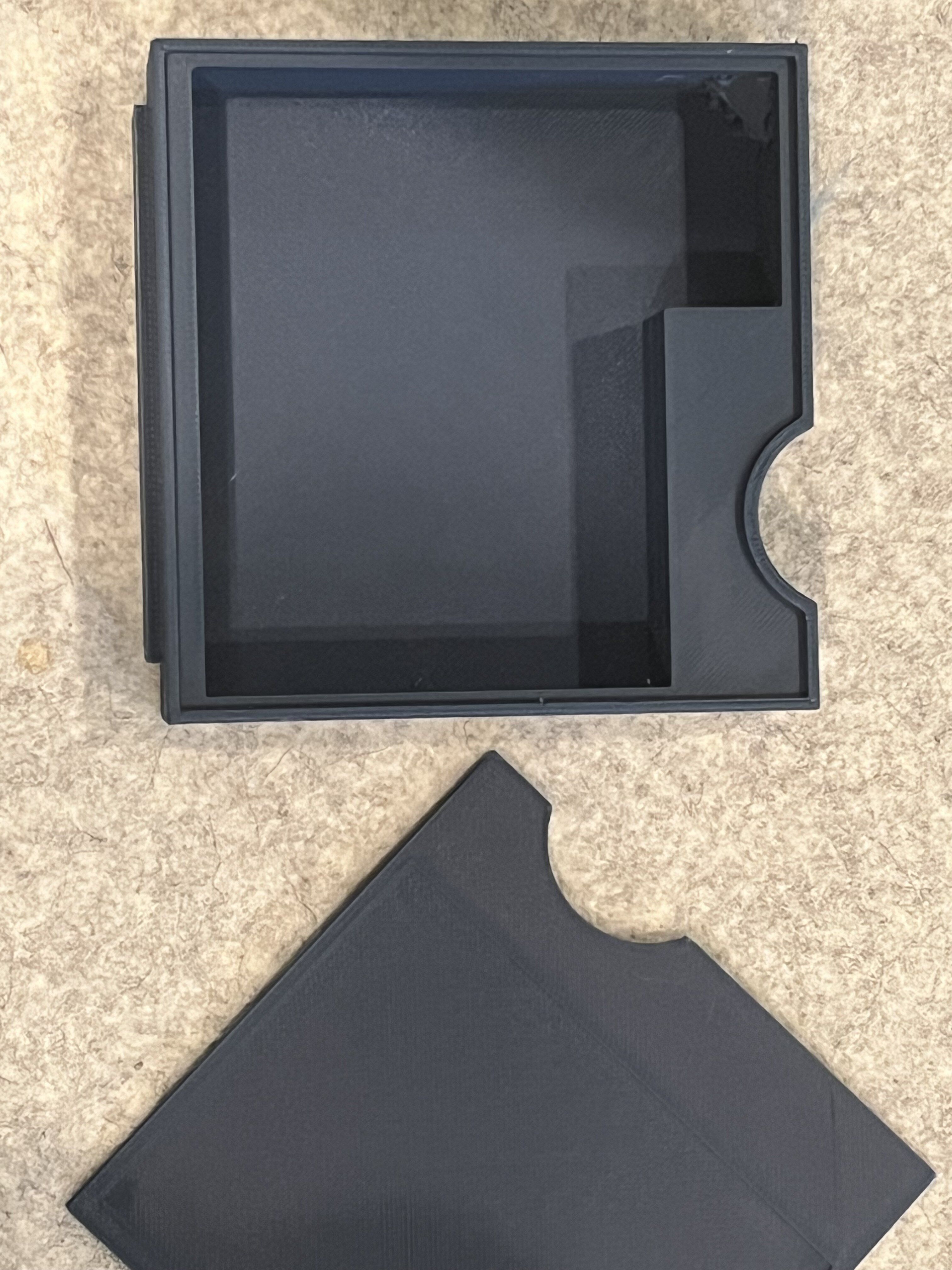

Ah, success. Printing with the sliding wedge face down or up required some supports but it printed much better. I can use the OEM door and it works perfectly. The printed door lock is a bit weak on the joint and they snap off. I’m hoping that Ron’s version is stronger. (Printing that now)

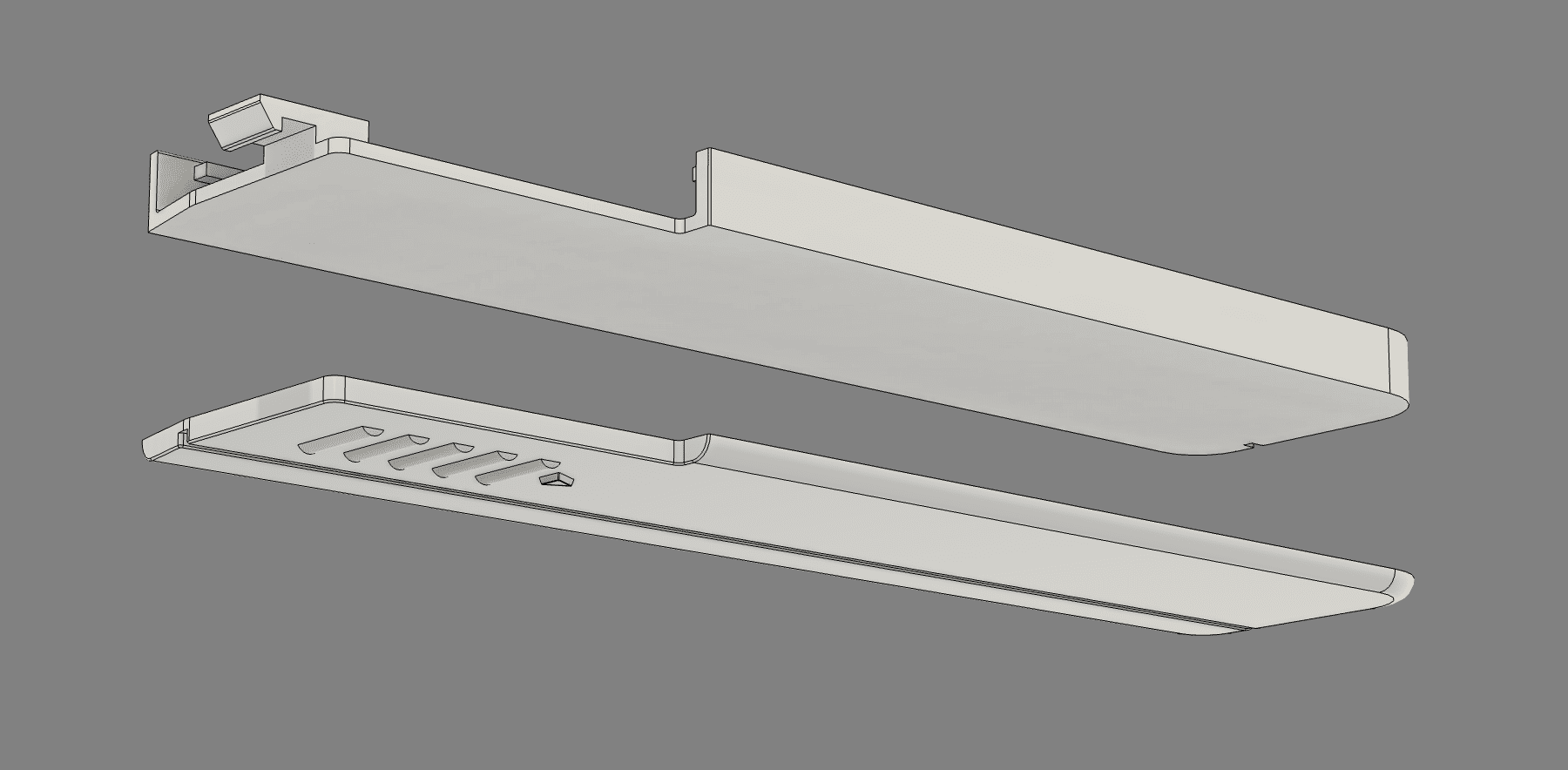

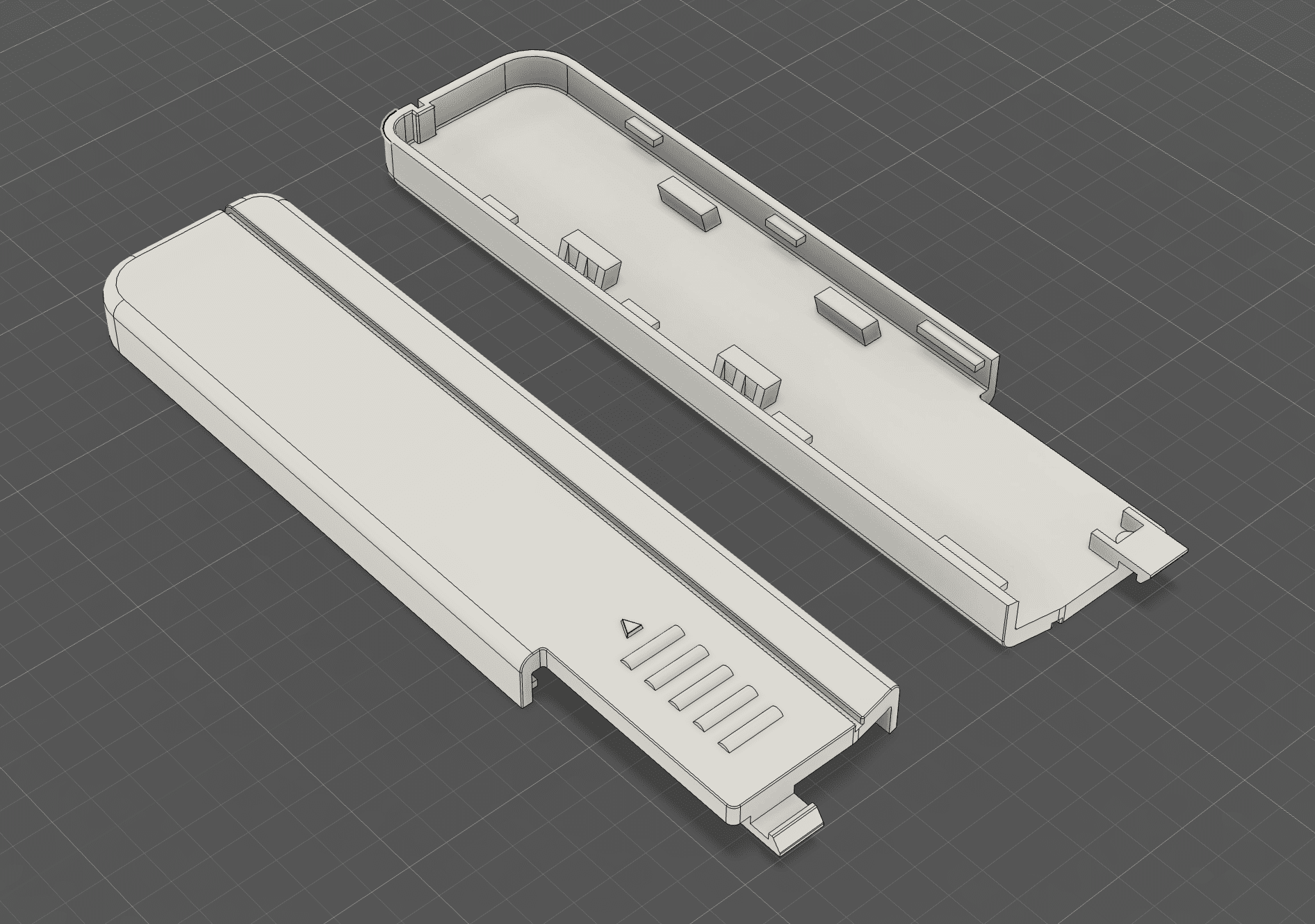

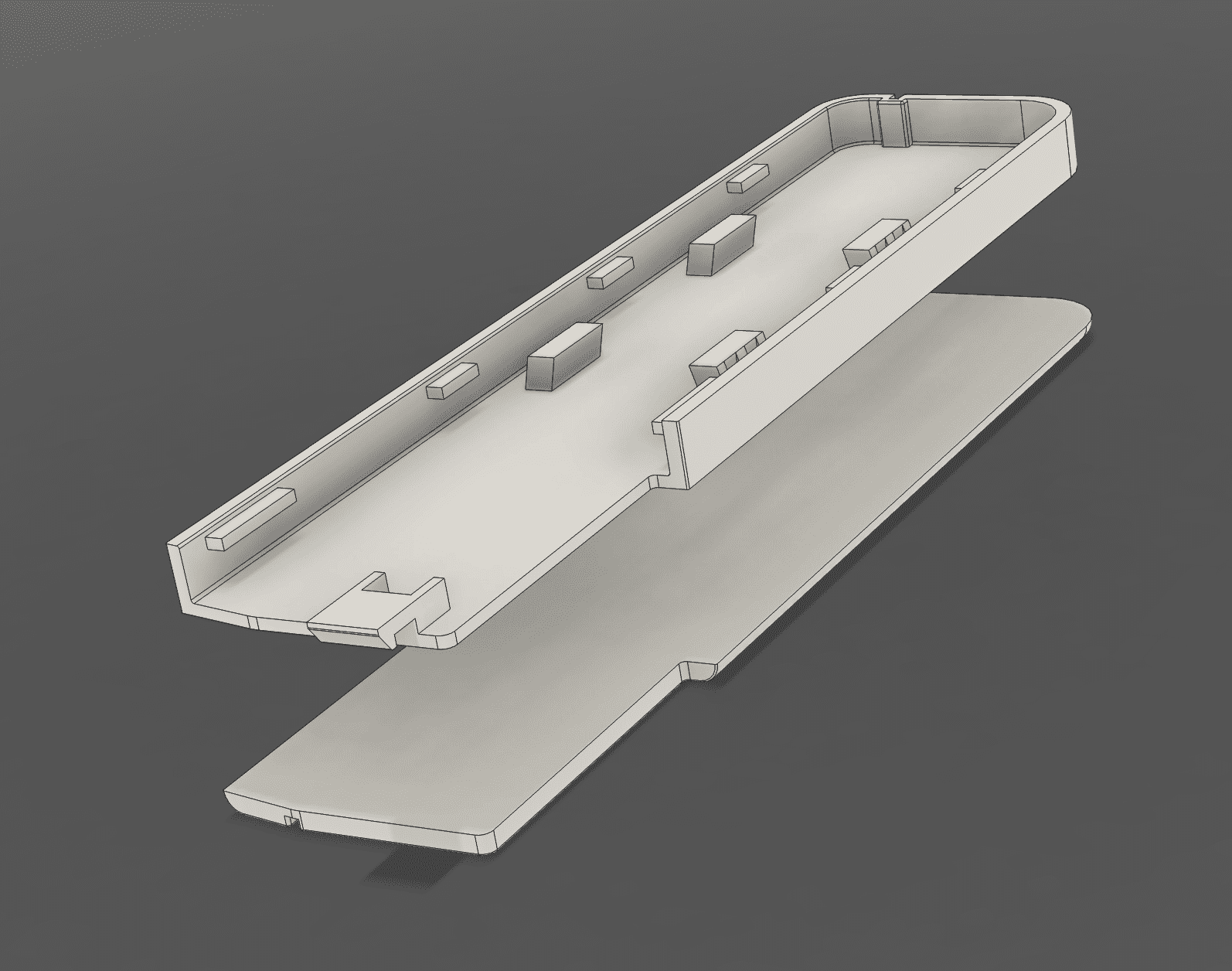

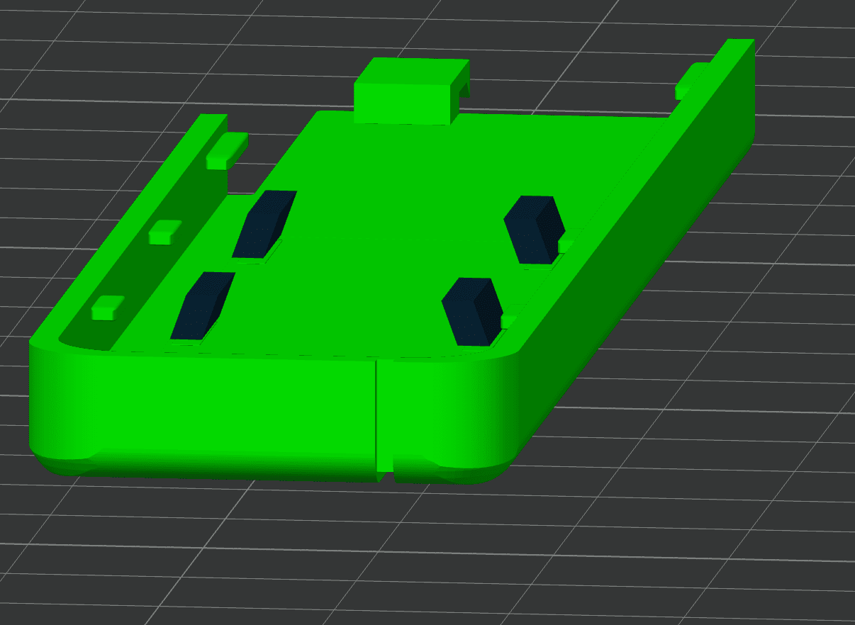

I use a combination of Illustrator and Fusion. Here's a rough model of the door.
If you're printing it with FDM, I'd recommend splitting the cover in half and then gluing the two pieces together like this. It should make the print a lot cleaner and easier to manage.

I can definitely do that. Looks great. My 0.2mm print wasn't turning out great with Ron's model. Will you share it on printables or here?

Thanks, but my model still needs a considerable amount of work before it’s ready to be released. This version, while fairly accurate, was really just made as a visual reference for our discussion.
Before I’d consider it “print ready,” it needs to be printed, inspected, adjusted, and reworked as necessary. That could take several passes before I’m completely happy with it.
That being said, I’m happy to play around with it this weekend and keep working on it until it’s finished, although that could take a few weeks. Once I’m satisfied with it, I’d be happy to share it here and/or over there if anyone finds it useful.

No rush. I have OEM doors that work and the case prints themselves are mostly ok, if a bit rough around the edges. The vertical orientation preserves the fidelity of the door lock slide at the top better.
It would be great, though, to also be able to print better port doors.
If it helps, I'm happy to do some test printing.

Mostly the sliding door at this point: I think the case is solid and I just needed to figure out how best to print it.
Anything to improve the printability of the door would be great.
For the moment I may rely on the OEM doors I have but I think it worth while to find a printable solution.
