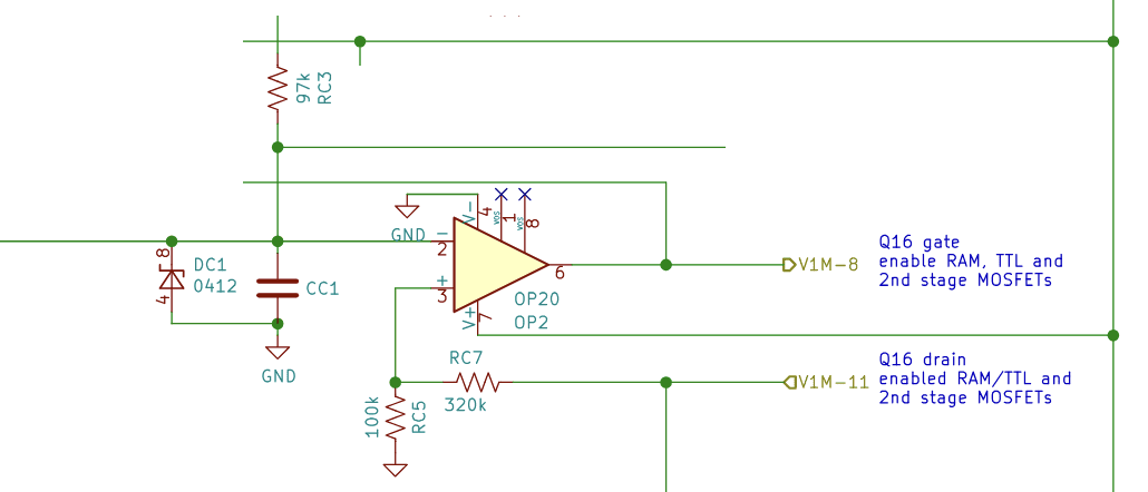

Thank you. BTW, I based my 5126 analysis largely on the PowerBook 100 schematic that appears on your macdat.net link. I then compared it to my 5126 motherboard to be sure.
The 5120 recreated hybrid schematic largely reflects the 5126 analysis. Input voltage (6.3B or 7.5V) comes in through RC3 to voltage reference DC1. I assume this is a 1.2V reference. Capacitor CC1 keeps that reference steady. RC3 limits the amount of current that DC1 has to handle so it doesn't heat up and change value.
The 5V rail output voltage comes in V1M-11 through the voltage divider RC5/(RC5+RC7)=0.238 which is about the same as the 5126. So, if the 5V rail is 5.0V, then OP20 sees 0.238*5.0V=1.19V on input pin 3. OP20 sees 1.2V (from DC1) on pin 2. It compares these two and turns on Q16 if the 5V rail is too low, or off if the rail is too high.
What this means is, it doesn't matter whether the input voltage is 6.3V or 7.5V, 1.5 amps or 3 amps. The divider and voltage reference will still generate a valid 5V output to the chips.
They improved this slightly for the 5126 and PowerBook 100 by adding hysteresis through a feedback resistor back into their version of the OP20.
Let's say corrosion on the hybrid module causes damage or disconnect to DC1. Then, CC1 will rise to the input voltage (let's say 7.5V). OP20 will see input pin 3 is low in comparison and turn on Q16 constantly, destroying the Portable logic chips. Likewise, if RC7 is corroded/aged to a higher resistance or cap juice conducts across RC5, then pin 3 voltage will drop, causing Q16 to turn on constantly, destroying the Portable logic chips. Or, more simply, what if OP20 becomes damaged by cap juice and stuck 'on'.
This last paragraph explains why an old crusty and juicy hybrid module is so dangerous to the 5120 portable. There isn't any protection if V1M-8 -> Q16 is constantly enabled. A simple crowbar circuit would fix this.
