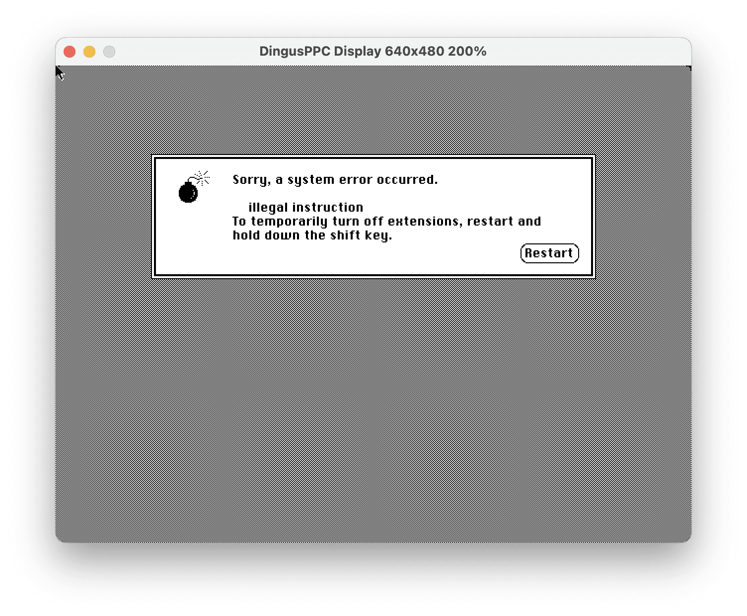

The pm7100 machine setting boots but only 8MB of RAM shows up. I'd like to be able to emulate my PM7600's discontiguous RAM layout
I'm currently running the original 6100/7100 ROM. My PM7100 has the later ROM. DingusPPC boots on this later ROM when --machine pm6100 is set but takes an illegal instruction trap booting System 7 with --machine pm7100:
I'm also not seeing the floppy drive accessible by DBOF. Booting into MacOS, an image mounts fine (after use of the ffd debugger command) but DBOF sees nothing (using boot or dir or whatever). I this a known issue?

That's a branch to self = infinite loop?
DingusPPC floppy doesn't work.
One more thing to fix.
