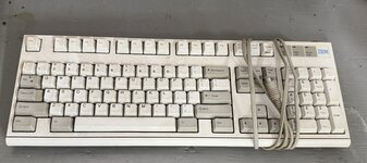

However, as you can see, it appears to be throwing some error codes and requesting I press the F1 key (I think). I found that the 101 and 103 codes are likely because the CMOS battery was dead and there are no settings. I did put a new coin cell battery in the machine, but I guess it requires you to create initial BIOS settings after the battery dies? The bigger problem is the 303 error, which indicates a problem with the keyboard. That also likely explains why nothing happens when I press the F1 key as requested.
Anyone with familiarity with the PS/1 2121 system to give me a starting point. Is it likely the keyboard itself? Something on the main logic board? Also, is there a specific type of PS/1 keyboard I could get to replace it? It sounds like these keyboards may also have a problem with bad caps, so I will probably see if I can crack it open and replace any caps inside.

I have several of these systems myself, the good thing about the keyboard error is that you can use any kind of PS/2 keyboard to test whether it's that or the computer itself.
Once the keyboard is working you will be able to progress further; one frustration many have with this machine is that if the floppy drive dies (and the hard drive is out of commission) you can't easily start up the BIOS configuration software, which relies on a DOS command.

OK, I was able to take the keyboard apart and the Caps were in very bad shape. I got them removed, but don't have a 2.2uF 50v cap on hand, so it will have to wait. Tip for anyone disassembling a IBM M2 keyboard, remove all the keycaps, then while unclipping the plastic tabs that were underneath the key caps, flip it upside down before releasing the clips. It will allow the plastic pieces with the springs to stay in the right spots, so you won't need to reload them all. It's a bit annoying because there are more slots than springs, so you need to figure out when ones should stay empty.

Finally got a chance to put the other cap on the keyboard. Unfortuately it took 3 or 4 areassembly attempts of the keyboard to get it assembled and all keys working (it's a membrane KB and there was something, a crumb maybe, under the where the D key that was causing it not work after reassembly. However, after that and setting getting into the BIOS, the machine is working again. It has a really odd system where it offers you a 4 pane menu to launch DOS, MS Works, An Information guide, or "Your software" which seems to just be a a way to launch .exe files on your hard drive. But the hard drive sounds healthy, although I'd like to image it to a solid state IDE drive. I just am not entirely sure how to do that with DOS.
