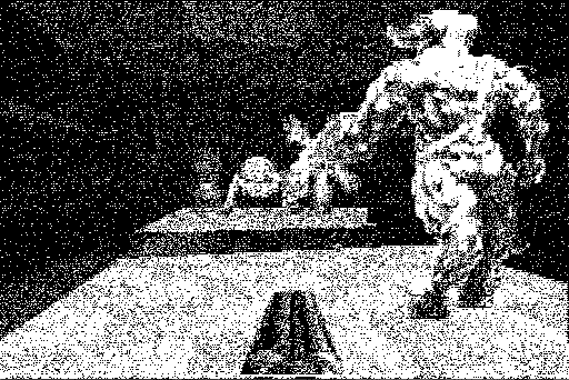

Playing with dithering algorithms:
Not on real hardware yet, and it does depend on an 8-bit framebuffer. I just got Retro68 compiled. Will try building soon.

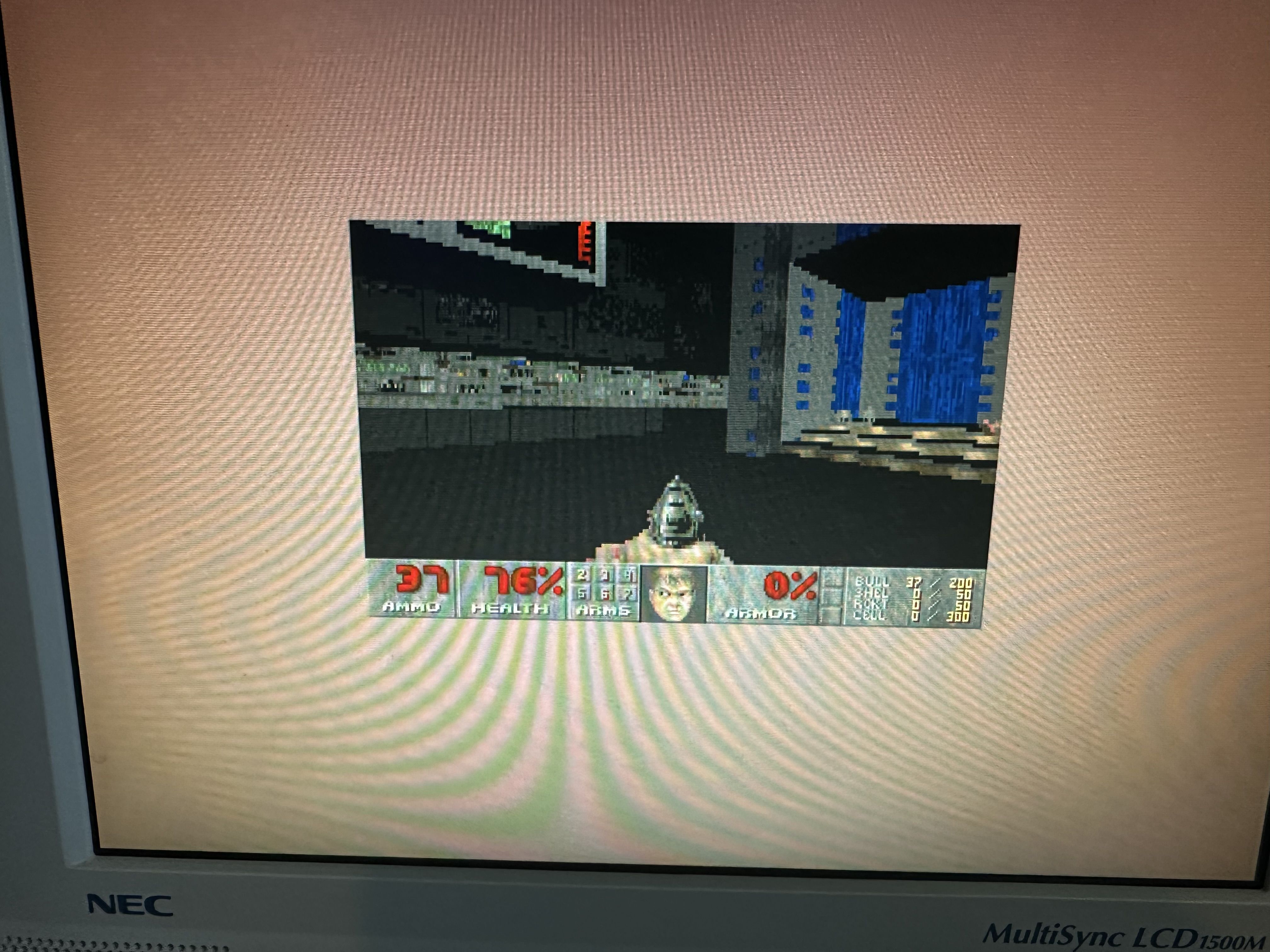

This is running on an SE/30 with System 7.1, a Carrera 040 accelerator, ROMinator, 128MB RAM, and a Bolle grayscale card. 256 grays is selected in the Monitors CP, and the screen resolution is 512x384. The first video is default settings, and the second has all of the quality-related options maxed. I did have to pretty much max the CRT brightness to see anything, and this tube is still really bright. None of the in-game adjustment keys for gamma, etc seemed to do anything, but maybe I'm missing something? 🤷‍♂️ Also, a way to quit the application without having to launch the game would be nice. Still super cool...I look forward to working full-screen :)
MacOfAllTrades
Oct 5, 2022
257
261
That is blazing fast niiiiiice!
Yes the color mode and grayscale (same thing, game knows no difference) do not respond to gamma options etc. I added color as the very last thing so far so sadly the options are really tailored to the black & white (original intent) of the game. Same goes for the full screen mode — only works for black and white. Note that black and white at high quality is an experience in and of itself — try black and white by setting colors to black and white before launching app (max settings if you want) and then the FULL screen mode will work. But I’ve been meaning to get that full screen mode to work in colors so i’ll get on that.
And yep yep - heard on the quit app without launching the game. There’s a hidden way to do this (just press escape in the opening dialog box - the one with Pick wad.. Options… Play - and the game quits without having to launch further. I mean to add a cancel or quit button.

After watching the two videos by @KennyPowers , I was just wondering if there would be a way to make the background dead space (all four sides, outside the game area) be black rather than white?
