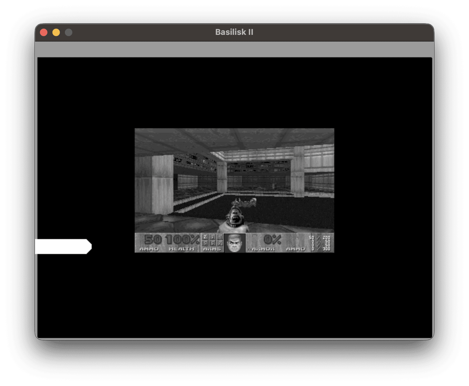

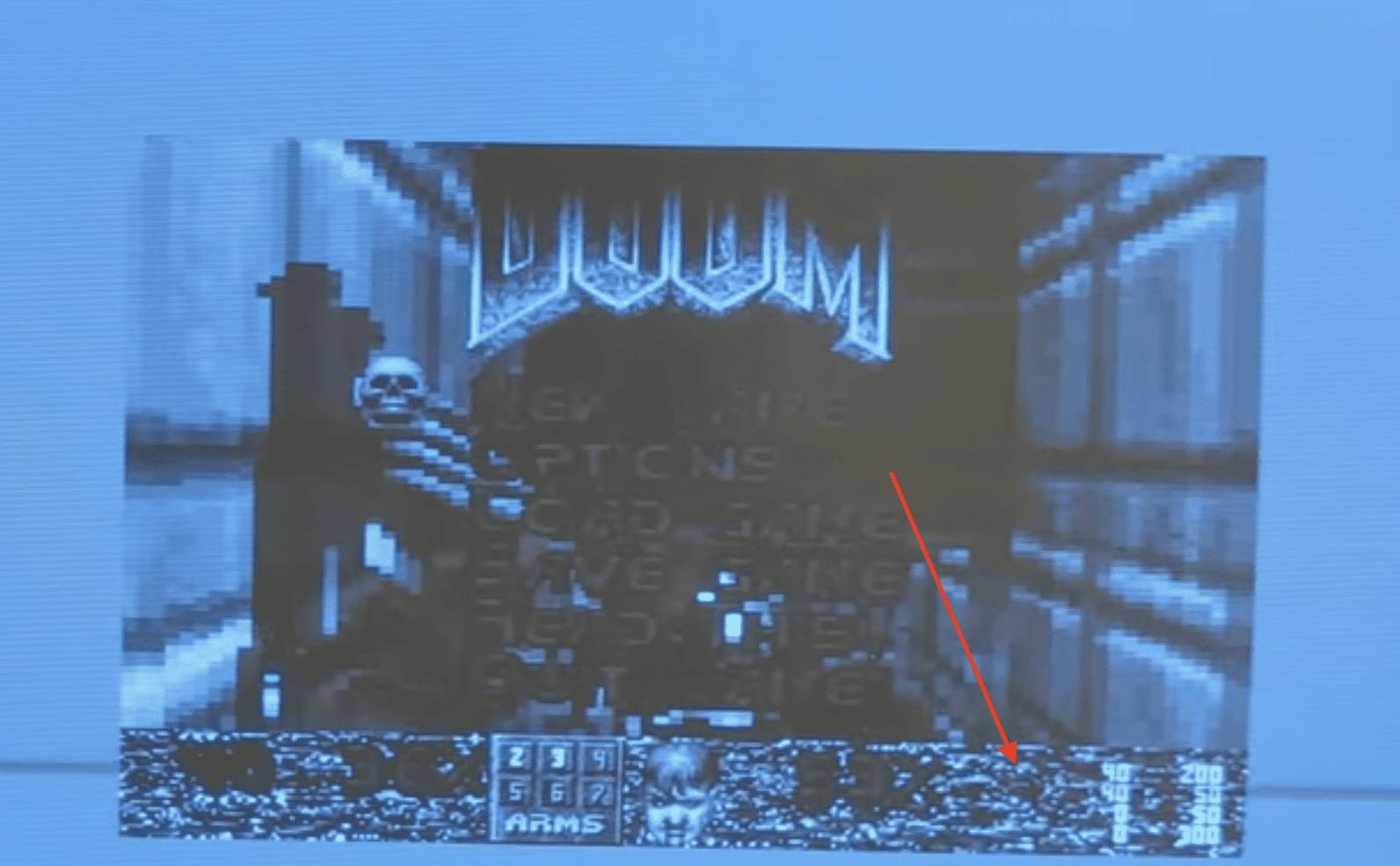

Similarly strange, I see on your video @KennyPowers that the HUD (ammo/weapons/keys bar) the background is showing up garbled in some way. Very strange.
This is a screenshot of 256 grays mode on my Basilisk II:
Something is def up. I’ve no idea if it’s due to your (sweet sweet) upgrades somehow (??).
Could have something to do with those. I also see that 7.5 is listed as the minimum OS version, and like I said in my previous post, I'm running 7.1. Until I cranked the CRT brightness, the game content and the border were all very, very dark...too dark to see much of anything. Other grayscale content looked fine at the more reasonable mid-range brightness setting I usually leave the CRT at.

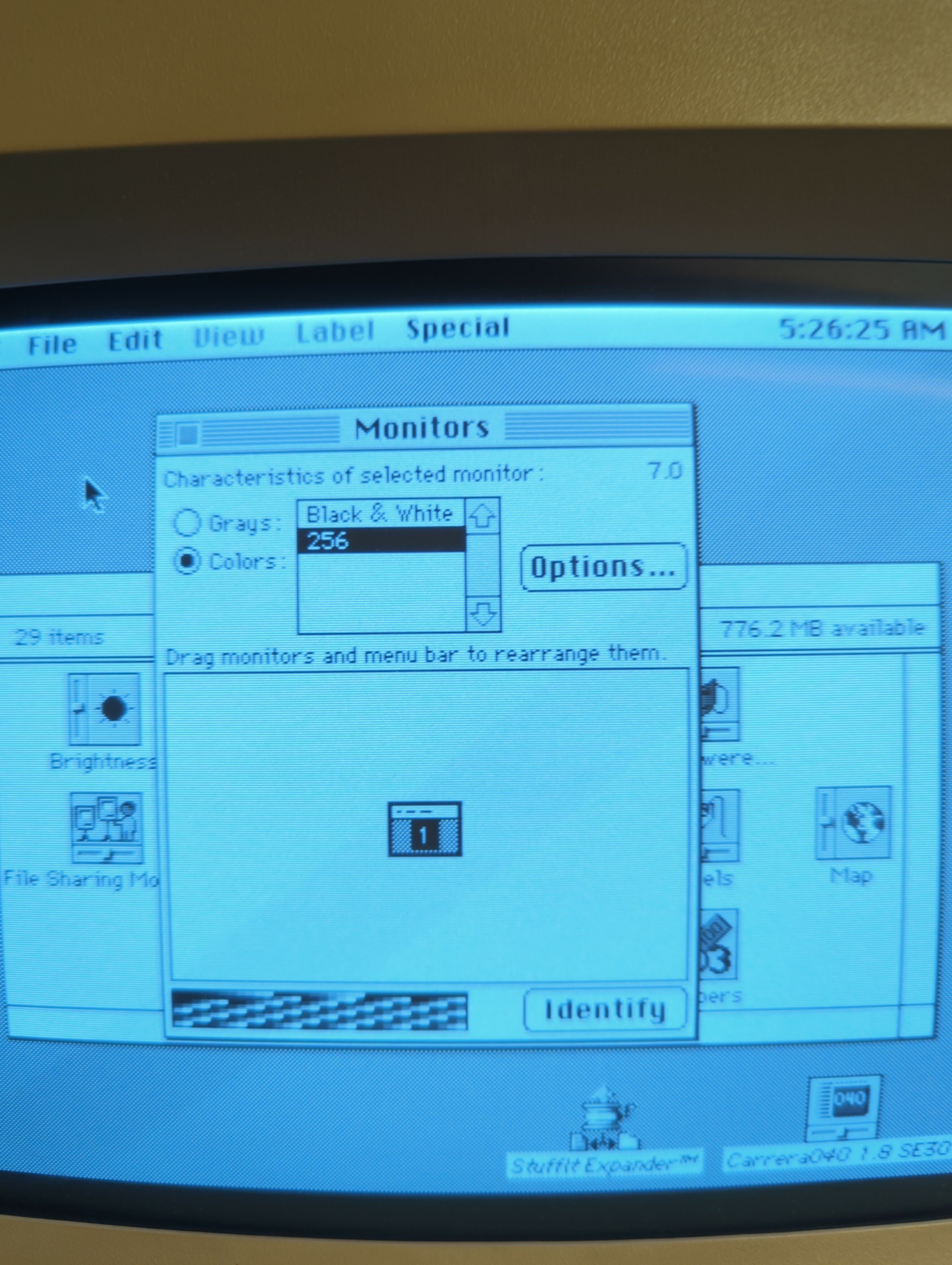

@MacOfAllTrades So I misspoke earlier when I said the border was black for me. It's light gray, even with the CRT brightness at a reasonable level. Here's a video of a complete run at default settings with the system set to 256 grays and the CRT brightness slightly higher than where I usually keep it, but not maxed:
I briefly turned the brightness up and then back down at about 50 seconds into the video. Also, after exiting the game, notice that unobscured parts of the desktop background were set to white and weren't repainted.
I poked through the code and noticed some special paths in i_video_mac.c when Gestalt identifies the machine as an SE/30. I was curious if maybe it didn't like it when g_color_depth != 1 and machine_type == kMacModelSE30...maybe that's a scenario that hadn't been exercised yet? So, I used Wish-I-Were to make the machine report itself as a IIsi...no change in behavior. I also tried hard-coding s_use_copybits to 1, but that was mostly just to see if I could build the project (which I could!). Nothing I tried changed anything.
Again, this is on System 7.1

Just played your latest video. Not news but I still am confused by the HUD artifacts (junky background on the HUD). Did that get any better with copybits? I may have to just acquire the same awesome hardware setup like yours to make sure I solve these problems and have a convenient test bed :p

My biggest evidence was a @KennyPowers screenshot of their Monitors control panel where the 256 colors looked like a bunch of tiles which is completely different than what 256 grays’ looks like in the same panel. What I don’t quite get is why using 256 grays mode doesn’t produce visually the same thing 256 grays does elsewhere (Admittedly only tried in Basilisk and in SNOW emulator. I trust snow though). It’s like somehow having the Bolle/Xceed card is activating the game to push colors when I would have expected QuickDraw to be doing the conversion to grays… but I’m not an expert in how the system is handling the color change to gray except that the game doesn’t know the difference so I’m ass u ming QD is handling this (maybe it’s done in hardware and I just don’t know it and since the true Apple hardware handles it differently that would explain it all).

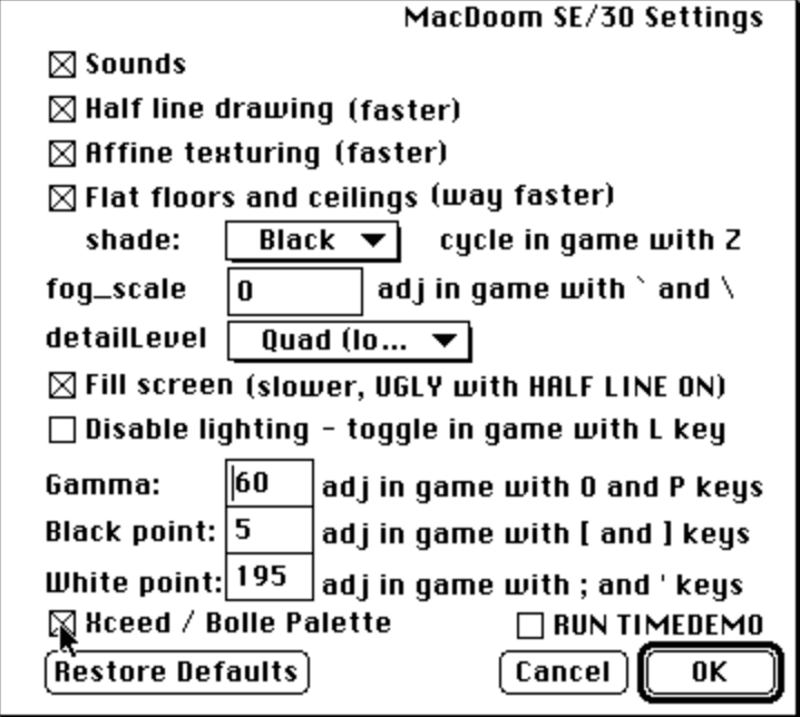

@KennyPowers — OK try this one (just a link to the .bin file from the repo, unbin it and replace the application you had before).
In the options screen i shoehorned in one more checkbox labeled Xceed / Bolle color palette — it just consolidates all the RGB into the blue value
Let me know if things look more correct — brightness should be way better but let me know if it’s OK. But I’m not sure what is causing your weird HUD background still (example below, from your video earlier)— I haven’t been able to recreate that but it’s not just the xceed blue issue.
Anyway - there’s the new option:!

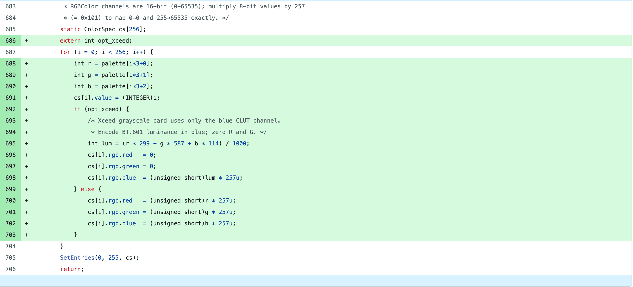

Ok, video of that build (temporarily maxed CRT brightness about 40 seconds in):
As you can see, it's much darker than before...about what you'd expect if two of the three color channels were set to zero:
I then altered the code shown above to set the red and green channels to the same computed luminance value as the blue channel on lines 696 and 697 to make a true grayscale palette. That resulted in the exact same thing as my first video...a darkish game window surrounded by a light gray border. So, as you said, Quickdraw is clearly doing color->grayscale conversion when the system is set to grayscale mode. The code shown above was basically asking Quickdraw to reapply the luminance formula on line 695 to a bunch of blues where red and green were zero, resulting in the super-dark output in the video. When I added back the red and green channels, Quickdraw was then converting grays to grays (essentially a no-op), resulting in the same output in my first video. So maybe this is a gamma correction issue, and that's why the unaltered code looks dark?
We should also try to find some other people to test this on both Bolle's card and ZigZagJoe's to rule out problems with my specific system and make sure the problem is specific to Xceed and/or Xceed clones.

Wow thanks so much for that wealth of info. Very confused about the status bar.
glad you messed with the code on the color channels. That’s what I would have done and suggested. Well I could just add a true grayscale support or at least try using a true grayscale clut. I’m confused why, given Bolle’s description about how grayscale works picking up the blue channel only, this doesn’t work.
I think I have an idea about the status bar maybe. The black and white code adjusts the status bar with a different dithering setting to really jack up the contrast. Maybe that is somehow being done on the color mode status bar too. No idea why I don’t get it in snow or basilisk but it’s probably it.
you could always play with the blue channel there a lot in the code like you did. Multiply it by 2 and see if everything is really twice as bright.
Theres no gamma settings that I’m aware of in color mode. The gamma stuff was added for the b&w dithering algo but you don’t have a need for that in grayscale or color but I could be wrong.

The QuickDraw documentation says this:
When Color QuickDraw displays a color on a grayscale screen, it computes the luminance, or intensity of light, of the desired color and uses that value to determine the appropriate gray value to draw
Clearly QuickDraw is doing color->grayscale conversion when the screen is set to grayscale in the Monitors CP because MacDoom always does exactly the same thing whether the screen is set to 8bit color or 8bit grays. We can also assume that QuickDraw is doing this using a similar luminance formula to the one you used:
Grayscale = 0.299 * R + 0.587 * G + 0.114 * B
Now what do you get if R and G are always zero in that formula? A really low (dark) value.
I now suspect my original darkness issue is mostly due to a lack of gamma correction, which @zigzagjoe mentioned the Micron-based cards don't apply. I may experiment with applying some gamma correction to the CLUT that MacDoom is creating and see if that brightens things up a bit :) It was also kinda dark in color on my Color Classic's CRT...
