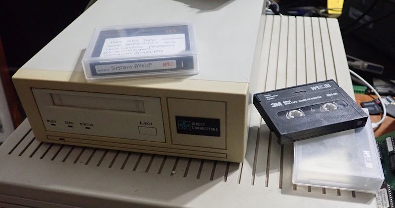

Back in 1992, I borrowed a DDS tape drive from my day job to back up all of my Macintosh hard drives at home. I stored the tape in a safe deposit box, until years later when it was relegated to the bottom of a storage box in the basement. Upon reviving my interest in Macs about five years ago, I encountered the tape. Given that I never owned a DDS drive and I hadn't documented which backup software I had used, I set the tape aside assuming I could never restore it. Every time I visited my basement boxes, the tape haunted me.
Recently, while looking for something else in my old utilities collection, I ran into a folder containing Retrospect 1.3B, circa 1991/1992. That was enough to warrant trying to restore the tape. I ordered a Sony SDT-7000 in an external SCSI case from eBay, along with some new-old-stock tapes for practice.
I first used the practice tapes to determine that the tape drive was functioning and was not going to eat my backup. Then, after inserting my real backup tape, I was greeted with the following dialog:

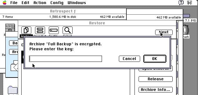

Oh no! What password did I use 33 years ago?
After trying the usual passwords, I decided to crack the software. I've done this on many other programs from that era. Usually, they do a simple comparison against a plain-text stored copy of the password, or better ones compare it to a hash. Simply replacing the fail condition with a NOP or changing the success branch to an unconditional BRA is enough to crack the program. For example, this technique works with HDT drivers because they don't want to incur the speed penalty of encrypting/decrypting the hard drive sectors.

Retrospect no longer showed the 'Wrong password' dialog and instead proceeded to ask me what I wanted to copy and to pick the destination. Hurray! The tape whirred. It stepped through each of the files, and 15 minutes later gave me a full list showing nothing was copied. Either I entered the wrong value, Retrospect uses the hash only for a quick check and needs the full password to perform the actual encryption, or it recomputes the hash at a later stage. In any case, this approach failed.
Brute Force
I decided to brute force the password with Basilisk II, as that runs at a much faster speed. So, I copied the HASHBLOC routine into Metrowerks, and then wrote a routine to step through all possible passwords. It outputs any password that produces a matching hash. With over 4 billion hash combinations, I figure not many random passwords will match. I'll either recognize or try each password it produces.
A Strong Password Is Always a Strong Password?
I was too tired that night to check my work before running the brute force routine. As I lay my head on my pillow, I chastized myself for not writing down the password or even a hint on the label. What password could I possibly have chosen that I thought I wouldn't need to write down? Then... after 33 years... I remembered.
The password is "Golden Slumbers".
That's 15 characters in length. It is estimated that it would take over a year to brute force an alpha-character-set password of that length. A dictionary-based attack would be much faster -- but I didn't code for that. Good thing I remembered my password.
