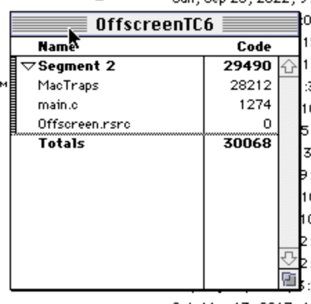

Is it a linker error or a compilation error? I get that linker error if I don't link against the MacTraps library. Did you link against the MacTraps library?
It is a linker error, but MacTraps is there...
Side note:
if your project name is OffscreenTC6.pi (where 'pi' is the pi character that you can make with ctrl-p) or something easier like OffscreenTC6.pr
and your resource file in the same folder as the project file is called OffscreenTC6.pr.rsrc,
then you don't need to link your resource file manually in the project linker window at all like is seen here. Think C will connect it for you.
i've actually caused an error when i tried to do both(on accident, i didn't understand this feature at the time) Think C will think i'm trying to link the same resource file twice and yell at me.
at least thats what i remember.
