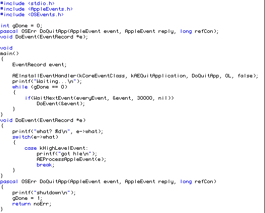

I'm trying to install an event to handle shutdown/restart - from the book it seems like I need to register a method to do the needful. But it seems to never fire when I restart. Also I dont think the events I'm using and referenced in the book are in System 6
That looks to be doing the same as my EventTracker code (the code from book pretty much), and when I restart with EventTracker running, its kAEQuitApplication handler fires. I'm running 7.1 though. Does AEInstallEventHandler() return noErr for you?
