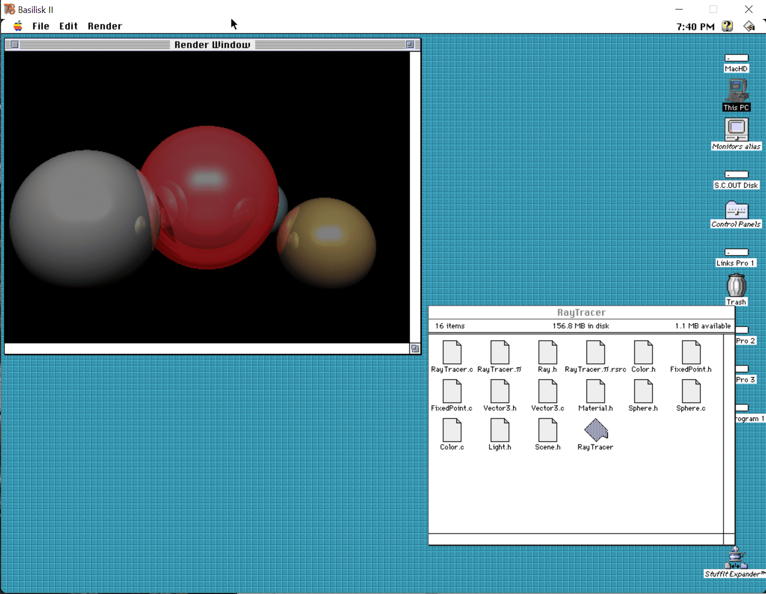

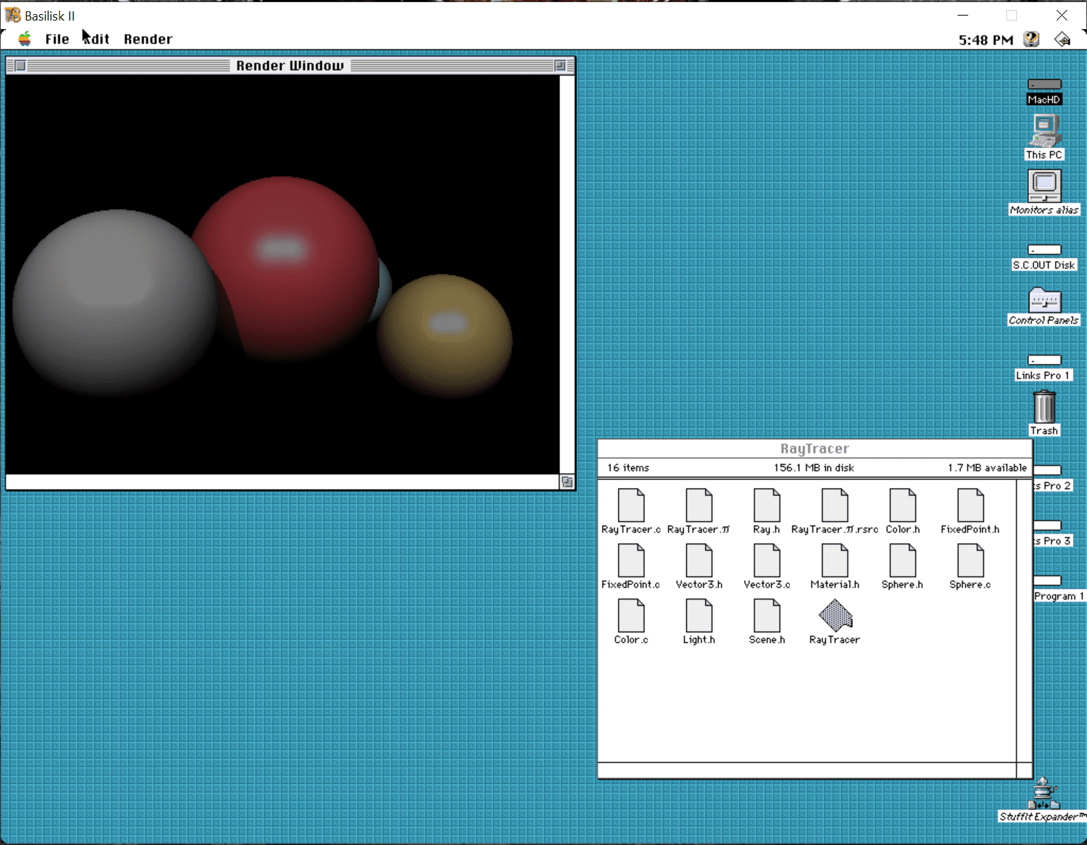

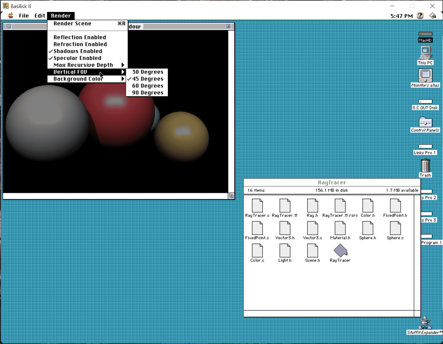

So my "project" after chapters 4 & 5 was a simple ray tracer that allows configuring rendering options via menus. It currently only supports spheres (cause they're easy), and supports diffuse and specular shading, as well as reflections, basic shadows, and basic refraction/transparency. Refraction/transparency doesn't look quite right, so I've probably got a bug in there somewhere, but it's honestly too slow to be practical anyways :) Also, it exclusively uses fixed-point numbers (as opposed to floating-point). I kind of just did that for grins...I don't know if it's any faster than it would have been with floating-point math (obviously the floating-point capabilities of the machine would play into that), especially since several of the fixed-point math functions I'm currently using are very very sub-optimal. I also haven't put much effort into optimizing the rendering code. Still, it's a neat toy project that I can augment as I work my way through the rest of the book by adding things like file I/O, etc (the PICT-related menu options don't currently do anything for example). Also, the scene with the four spheres is currently hard-coded, so the ability to specify or import scene definitions would be another thing I could add.
This was developed entirely on an 040-accelerated IIci with a RasterOps PaintBoard Prism GT video card for 24-bit color support. The included code has only been built with ThinkC 6, and I'm not sure how portable the project file is. Still, you can always just make a new project file and link all the .c files and the MacTraps lib. Add some more spheres! Change material properties! Go nuts and make your mac melt! A built executable is also included. Note, by default, all of the optional render features are ON, and the number of recursive ray bounces is MAXED. I recommend turning everything off/down before hitting "Render" for the first time and then incrementally enabling things unless you want to sit there forever (it's pretty fast under Basilisk II though). Shrinking the window will also reduce the render time (fewer pixels = fewer rays). Don't drag anything over your rendered image either after waiting for it to complete...this currently draws directly to the window's graphics port, so there's no offscreen rendering available to repaint the window :) Resizing the window will also clear the current rendered image. Also, it'll obviously look best in "millions" of colors if your machine can do it, but "thousands" or 256 will just have the usual banding.
RayTracer.sit.hqx was created with Stuffit Deluxe 4.5.

Very pretty! I believe the fixed point routines (which incur function call overhead) are typically slower than floating point if you have an FPU or an 040, though it probably depends on the use case.
KennyPowers
Jun 27, 2022
333
369
I assumed as much. Also, some of those routines can apparently be hand-optimized. And my implementations of things like sqrt(), pow(), and exp() are very simplistic and rely on some limitations (integer exponents only, etc). I remember using look-up-tables for some of those things, as well as trig functions, a long time ago when doing pre-iphone games on Symbian phones. This also made me miss C++'s operator overloading and inlining, as well as being able to templatize the number of fractional and integer bits. The maximum size of a sphere is also limited by using 16.16 fixed-point numbers. Since I store the squared radius of a sphere as an optimization, and the max value of a fixed-point number is 32767, weird visuals will happen with spheres having a radius larger than around 150 or 160 units :) The large red sphere only has a radius of 4.

Hey, cool having more people interested in this stuff. I just downloaded your project and tried it on Basilisk... very nice!
Yes, I'm using QuickDraw primitives after all the 3D space is transformed and projected, but basically only painting filled or hollow polygons (triangles only, in fact). My plan is to implement Gouraud and/or Phong shading, and then I'd be just painting pixels, but for now I'm painting the triangles in flat shades.
Both the camera and the objects use transformation 4x4 matrices. In the case of the objects the transformations are the typical (translation, scaling, rotation), and the camera allows pitch, yaw and roll.
How long it takes you to render one of these three-balls sample images in that upgraded IIci?
KennyPowers
Jun 27, 2022
333
369
Depends on the settings and window size :) Let's assume the default window size for consistency. Then, with the following settings:
- Reflection = ON
- Refraction = OFF
- Shadows = ON
- Specular = ON
- Max Recursive Depth = 10
it takes ~47 seconds to render on the 040 IIci. Turning reflection off drops that to ~40 seconds. Turning refraction on?...well, go take a nap :) That makes sense since the ray will be bouncing around several times inside the red translucent sphere and generating additional reflective and refractive bounces. Lowering the max recursive depth therefore speeds up rendering with refraction on, but refraction is currently ugly anyways, sooo :) I'm sure there are some additional performance gains to be had, but I haven't focused too much on that. It's too bad parallelism isn't trivial on this platform, as this is an embarrassingly parallel problem. Running a similar algorithm using 32 threads on my 5950X renders the same scene in the blink of an eye :)
